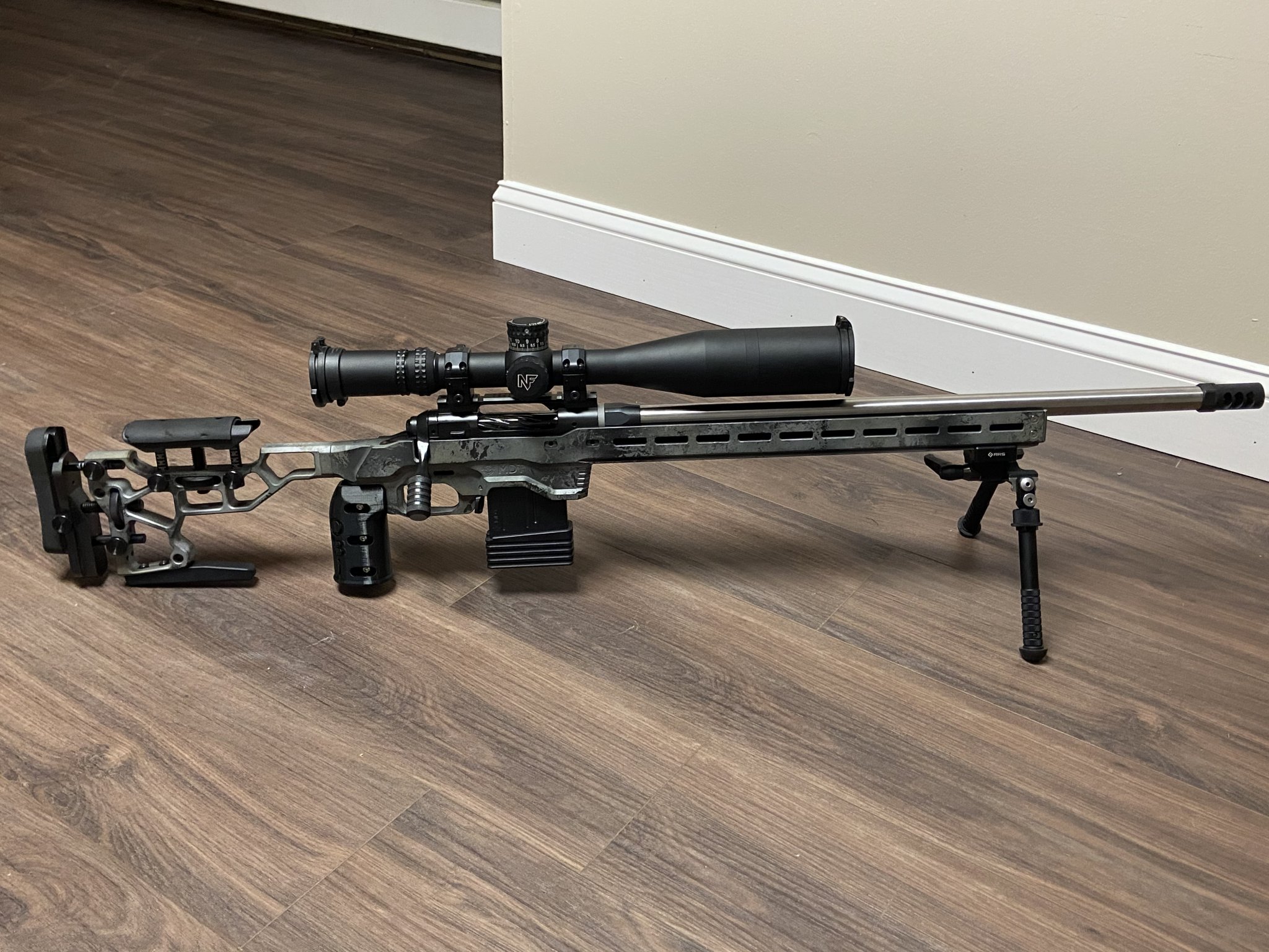

When you go down the upgrading route with a savage you end up with something like this and it’s shoots as well as anything out there
sweet setup! Which barrel? What group size can you get from it? Lastly, what made you do these upgrades vs buying/building another rig?
For me, if you look at the last post on page one. Was because I had the rifle which I probably wasn't going to shoot much, if at all. The barrel which was a 7mm-08 didn't shoot well. I also didn't have anything in the magnum crowd so I started looking at my options for short actions. Then like most my ideas and projects, they snow ball. Next thing I know I have an avalanche with more money sunk into something than I first intended.
It’s a 24 inch xcaliber m24 contour barrel. Gun will shoot 5 shot groups under .25 inch when everything falls into place but under .5 inch pretty much anytime you take her out on the town. Honestly the build started when I got back into shooting long range. Had a surgeon action custom build back in the day. Long story short sold that when I had other things going on and years later got interested again so I bought a savage to mess around cheap and it slowly evolved into this. Now the only factory parts are the action and bolt handle but even when it was straight from the factory it was a sub .75 moa gun. Even though the money invested is in the neighborhood of a custom rifle it was a shooter from day one before the upgrades so it’s a good platform to start out and build over time as funds become available. It’s fun to be competitive with an underdog rifle so I don’t regret it plus I learned a lot about how to work on the rifle with this platform rather than just buy a full custom again. This is a target from a recent range trip doing load testing so these are six loads from 41.5 grains up to 42.5 grains so it likes multiple loads as most fit inside roughly a dime. You won’t be undergunned with a savage if you get your fundamentals down and get out and shoot. Im not knocking a custom gun and this isn’t my only rifle so I’m guilty of buying some big names also but top tier results can be had with practice and a savage.

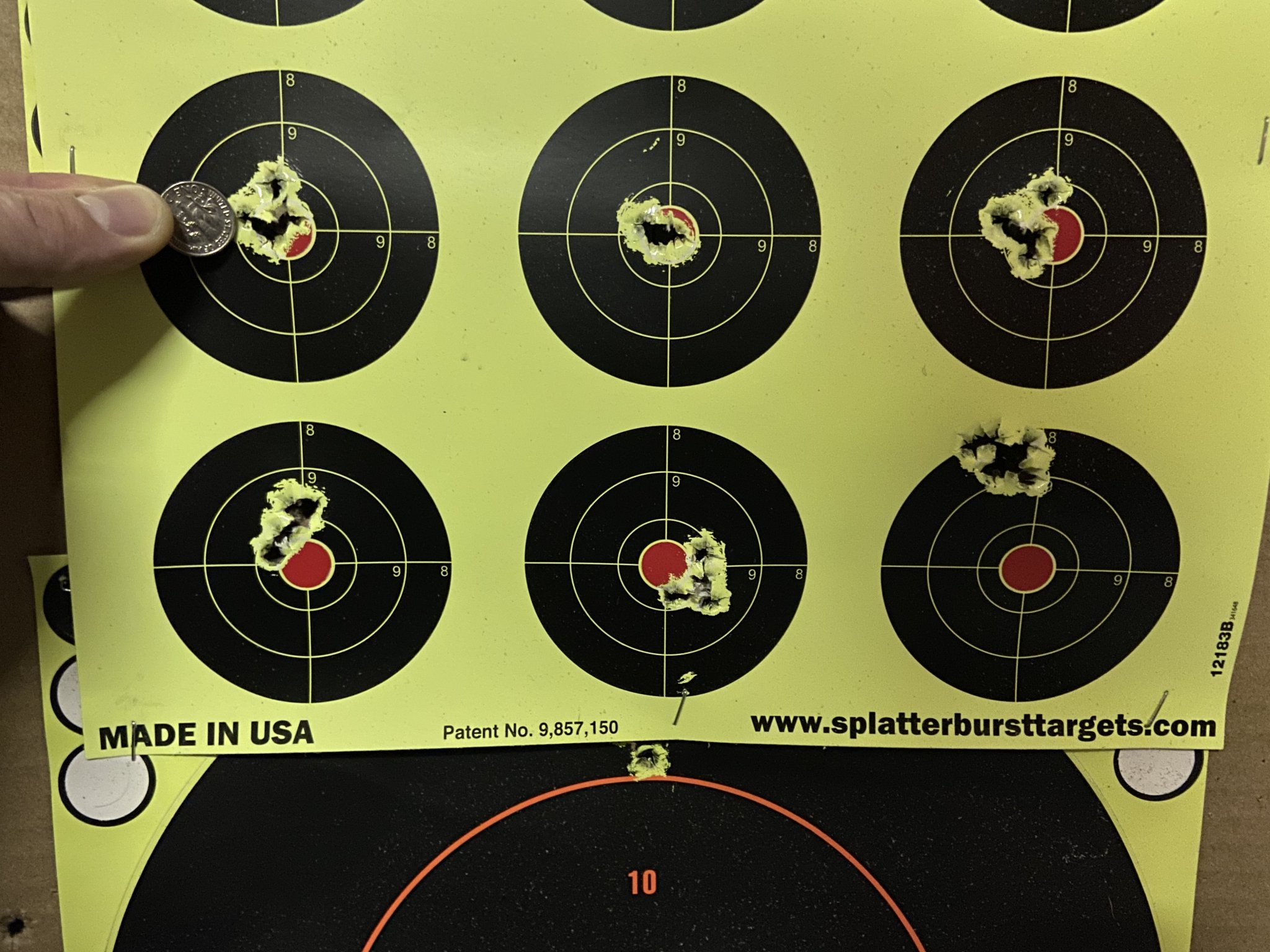

This is from a 12FV with just a ashbury chassis for an upgrade using 120amax factory ammo @ 200yds 10 shots. That is a Nickle under my finger for reference. IN my rifle the ammo runs 2910fps and is about 1" high of my zero with 147's @ 2765fps
The old finger/nickel covering the flyer trick!!
I like to use my caliper! 😎

I don't cover flyers. When I have them they are horizontal as a rule and about 3"left. THey are from my heart beat which is how far the rifle moves when I don't shoot at the bottom of my breathing.
