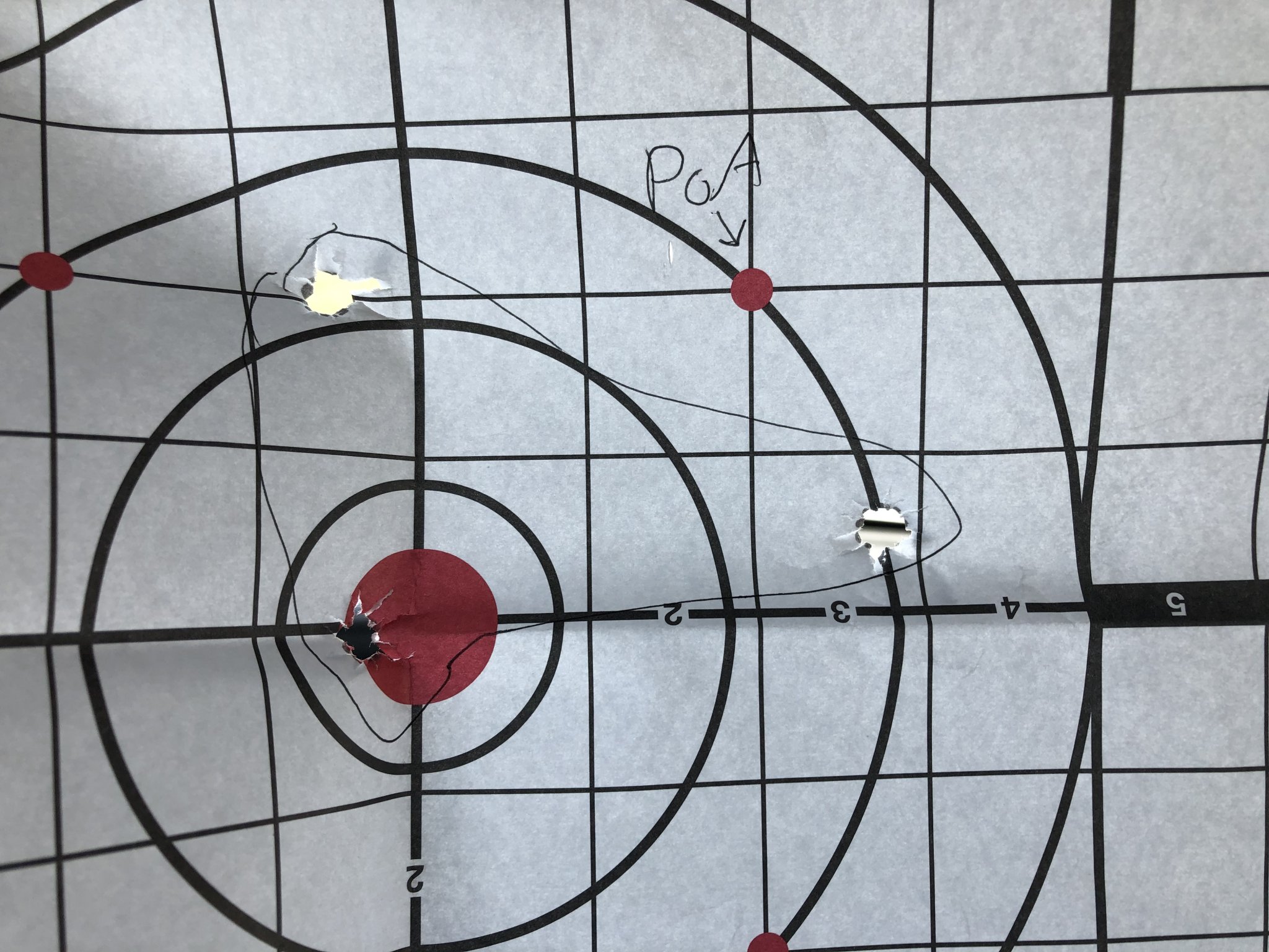

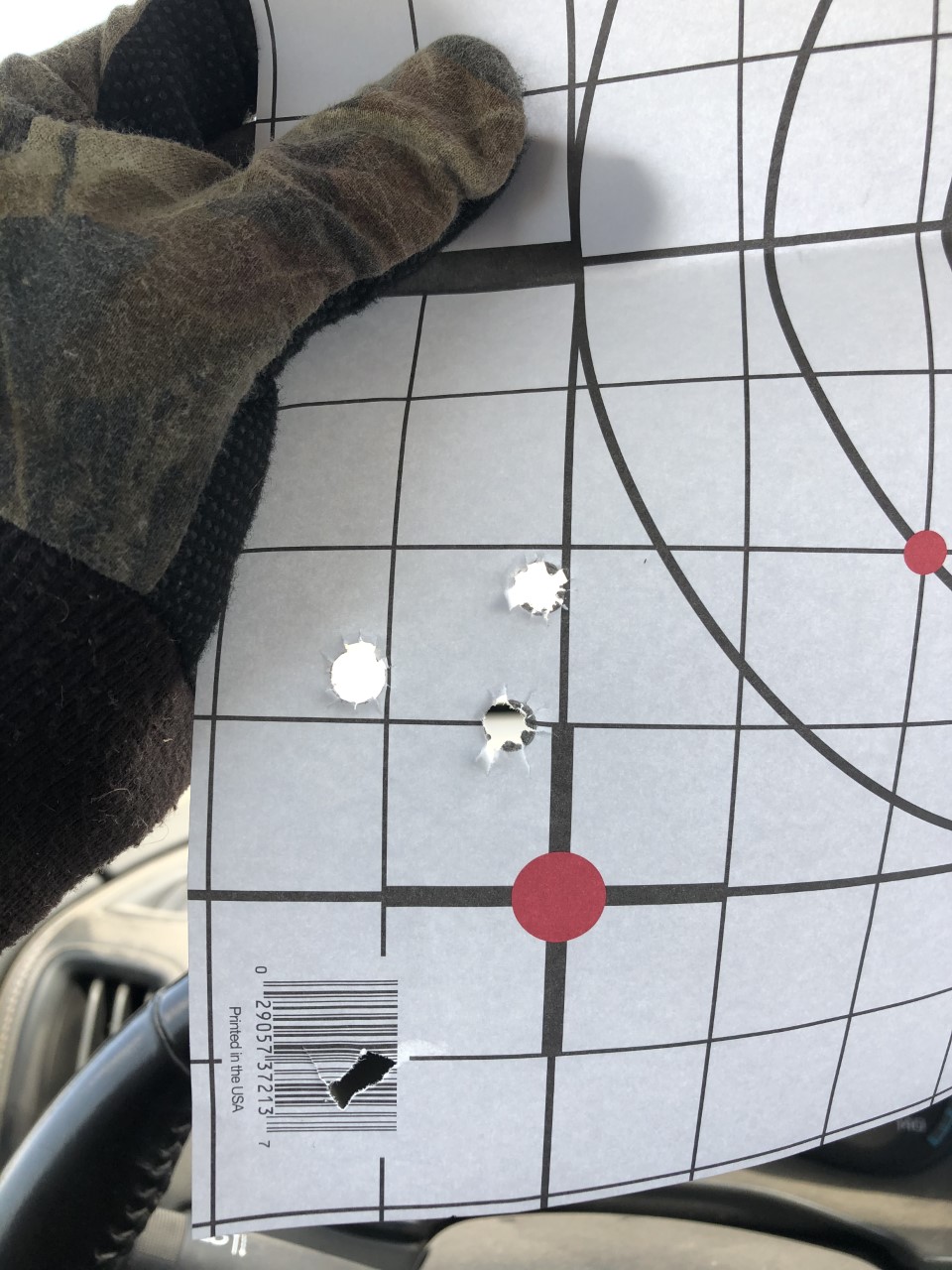

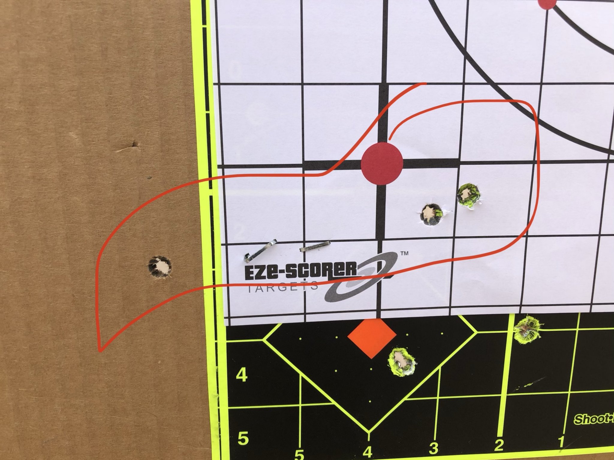

I have a huge stack of targets that I wish I had labeled better. But these are a few groups with my 300 WinMag with a cheap $400 Aztec scope

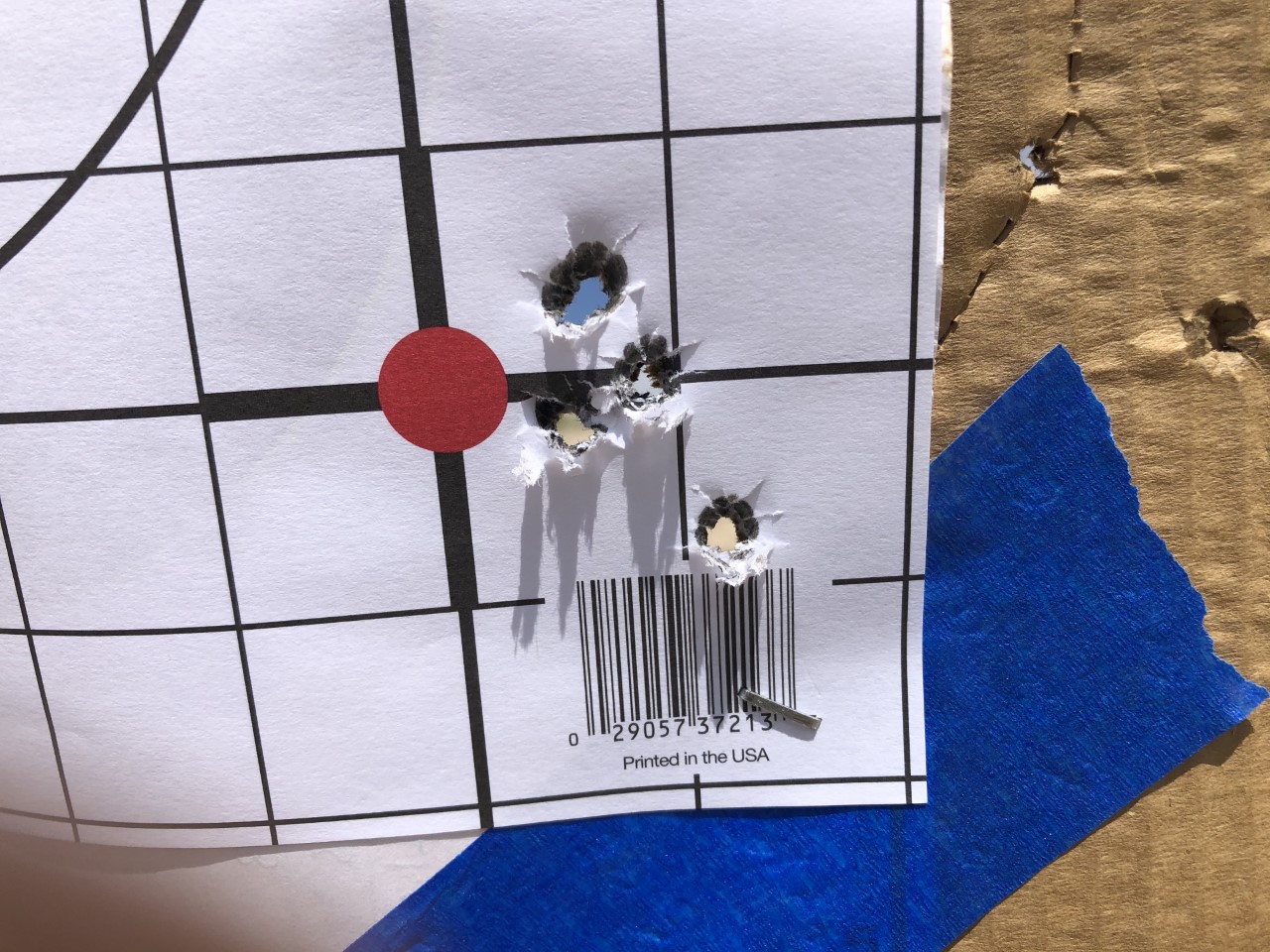

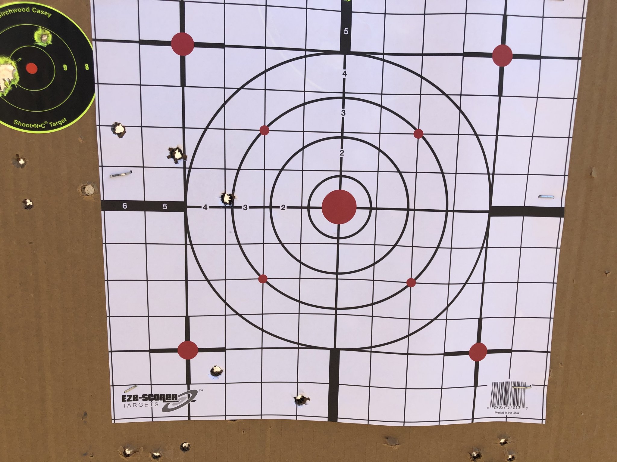

These are with the NX8 using the same factory load. The same load Seth shot at the PRS match for me. The rifle didn’t like it but the group was 2x as big for him. I changed nothing but the scope. Which once again was mounted by a NF dealer who I physically watched use a FAT torque wrench set to 25 in pounds for the ring screws and a 68 in pound torque for the cross bolts.
