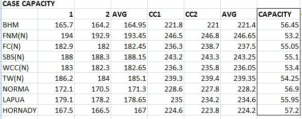

Lapua brass definitely holds less powder than brass like Winchester. You have to be real careful with Lapua brass as it often doesn't show some of he early pressure signs like an ejector mark or hard bolt lift like some of the softer brass does.

I haven't had any commercial WIN cases to work with, but I believe that they make the BHM cases so they should be very close to Commercial WIN.
Case Capacities in Grains of Water:

You'll be roughly 0.7 gr less powder in Lapua vs Win/BHA brass for same pressure / velocity due to smaller case capacity, emphasis on roughly 0.7 gr less. I'd start down 1.5 gr from Win brass in Lapua and work up to desired velocity, accuracy w/o seeing any pressure signs to be on safe side.
