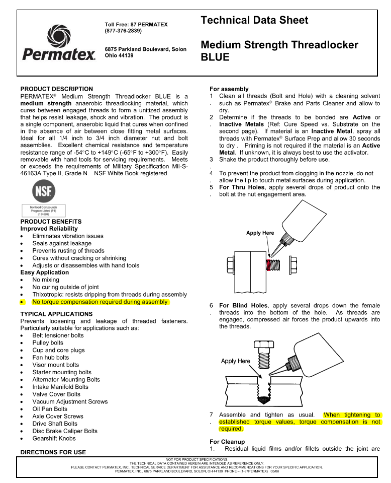

So! I have done some research on Loctite with two engineers and want to fix something on my list here:
https://www.snipershide.com/shooting/threads/ive-been-vortexd.7184035/post-11160691
Both said that adding blue Loctite to scope ring caps probably wouldn’t change the bolt torque in a way that would damage the scope. Probably. It might, given certain surface finishes, but probably not. Every joint is different.
But I’m giving Formidilosus a pass here and will adjust the earlier critique.

What's the k factor for loctite? You know so that I can correct the slope of the torque/strain relationship by accounting for the lower frictional losses in the joint.
GTFO.
Ah....I believe I asked for mech engineers to weight in....not much insult in that, eh? Yeah, I cited @308pirate because I understand that he was/is a manf engineer with a background in fastners.
And did you catch the "et al" which is short for “et alia,” which means “and others.”
I say again...when you see a torque spec for...e.g. ring bolts...with the exception of ARC you have no idea if the design engineer generated this spec based on an assumption that the end user would or would not lubricate the thread and bolt head.
So, you a mechanical engineer...maybe part of that "et al"? No...didn't think so.
Now go away and bother someone else.
Studies done tell me if they aren't lubricating their fastens they should be. I am not sure if you didn't read, didn't understand it, or if your are just being obstinate.
Table 2 – Typical “K” values
Substrate​
Lightly oiled​
Lightly oiled and Loctite 243​
Dry, degreased​
Dry, degreased and Loctite 243​
Steel Fastener​
0.15​
0.14​
0.20​
0.20​
Phosphated Steel​
0.13​
0.11​
0.24​
0.14​
Cadmium Plated Steel​
0.14​
0.13​
Stainless Steel 404​
0.22​
0.17​
Zinc Plated Steel​
0.18​
0.16​
0.17​
0.15​
