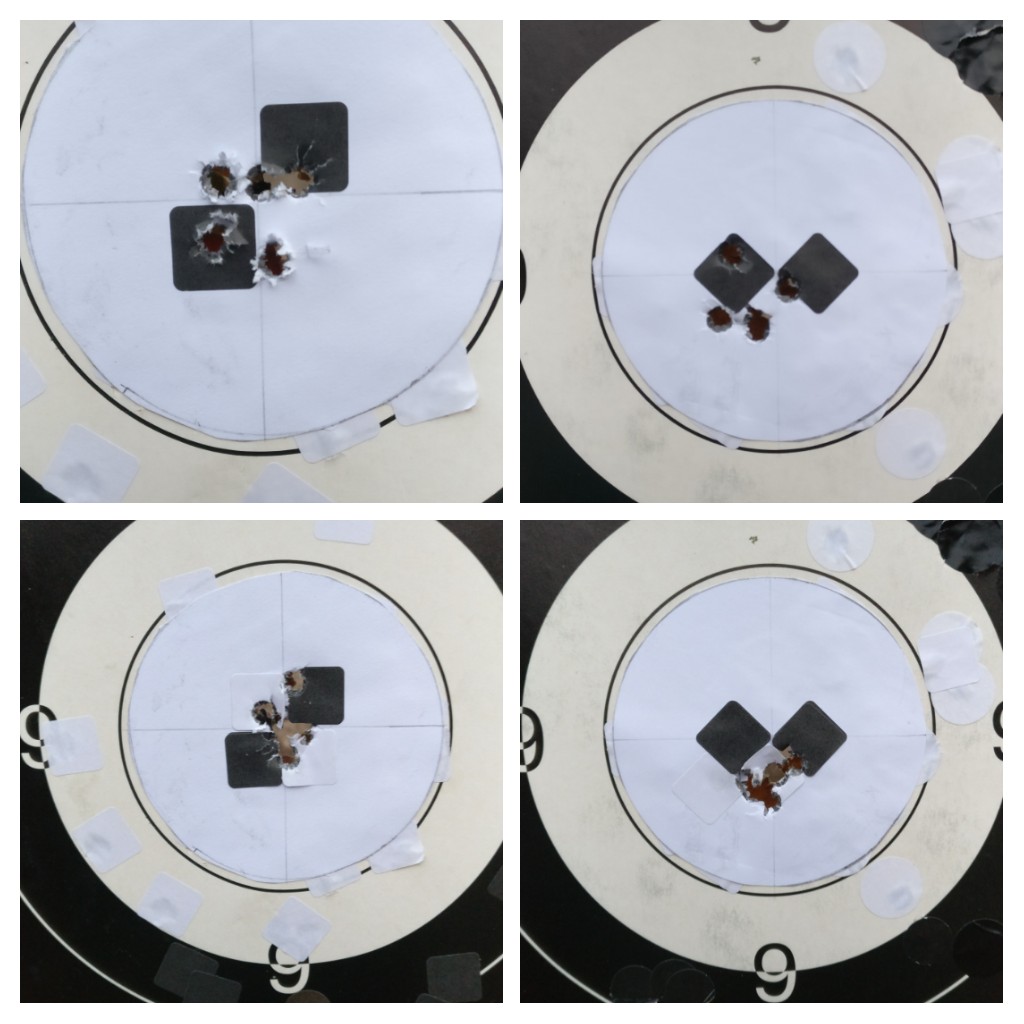

EPILOGUE
Rifle and shooter are both fine. redneckbmxer24 point about burr would fit the symptoms, thanks. Rifle now shoots consistently between 0.5-1 Moa with reasonable ammo, bad groups are between 1 and 1.5 moa – both well in line with my skills.
I bought more GGG's 175 smk, which seem to be pretty consistent, reasonable value. Enclosed today's four consecutive groups (100m, temp at freezing point, no wind), measuring 21, 20, 20 and 13 mm (c. 0.7 and 0.4 moa), very typical.
And no, even relatively light .308 semi-auto is not at all difficult to shoot (at this level). Maybe needs a little more attention and firmness but nothing beyond fairly basic rifle skills.
Lesson: do not give up easy. Test shooter, ammo, scope + mount, clean the barrel, and repeat. Thanks for all the comments.

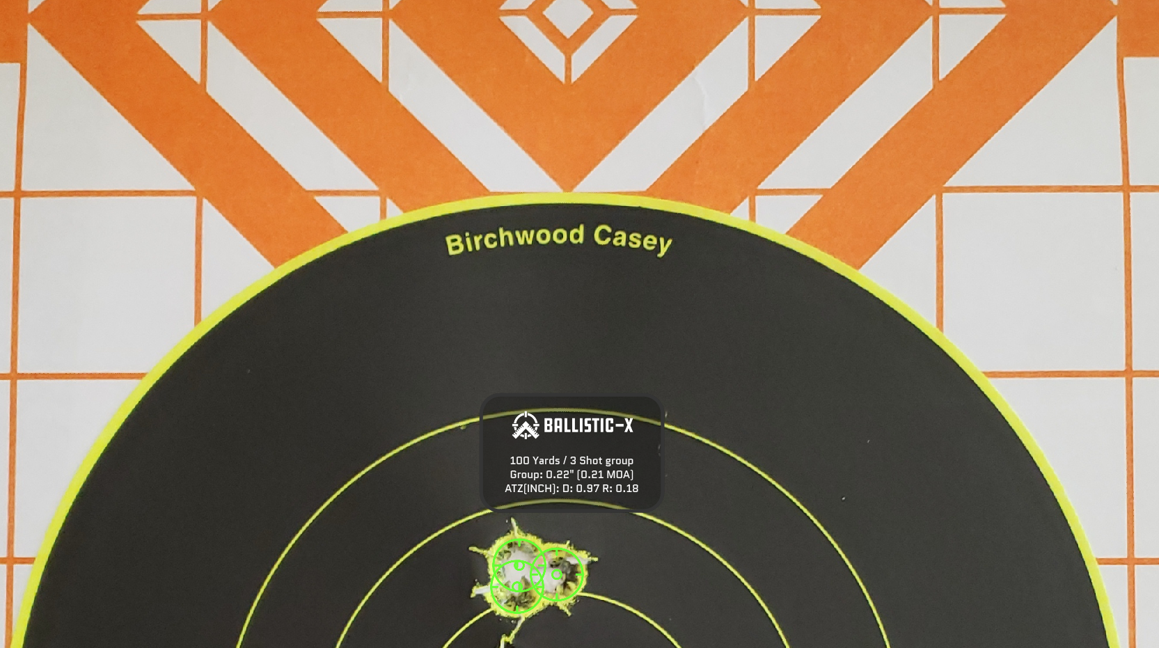

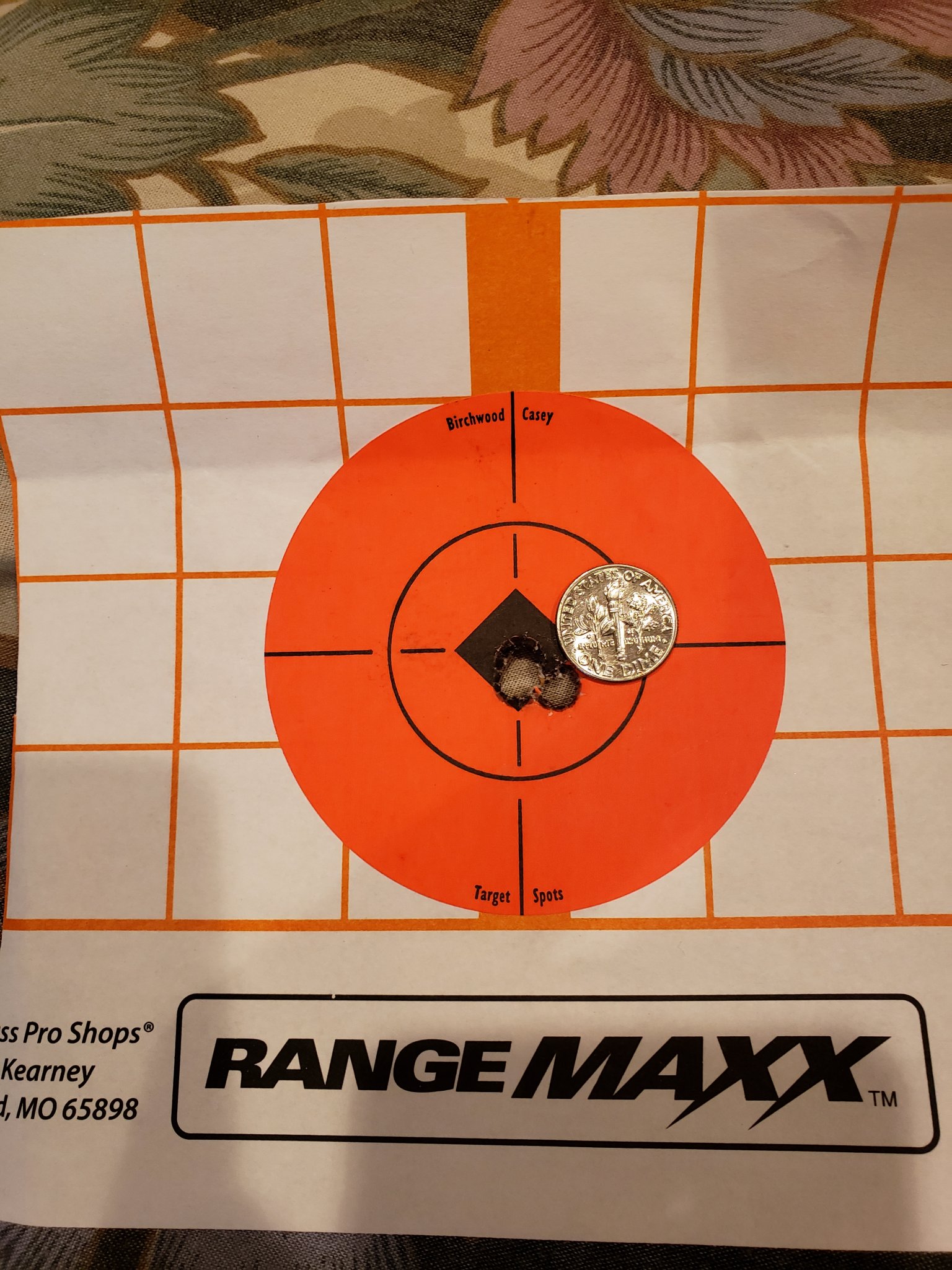

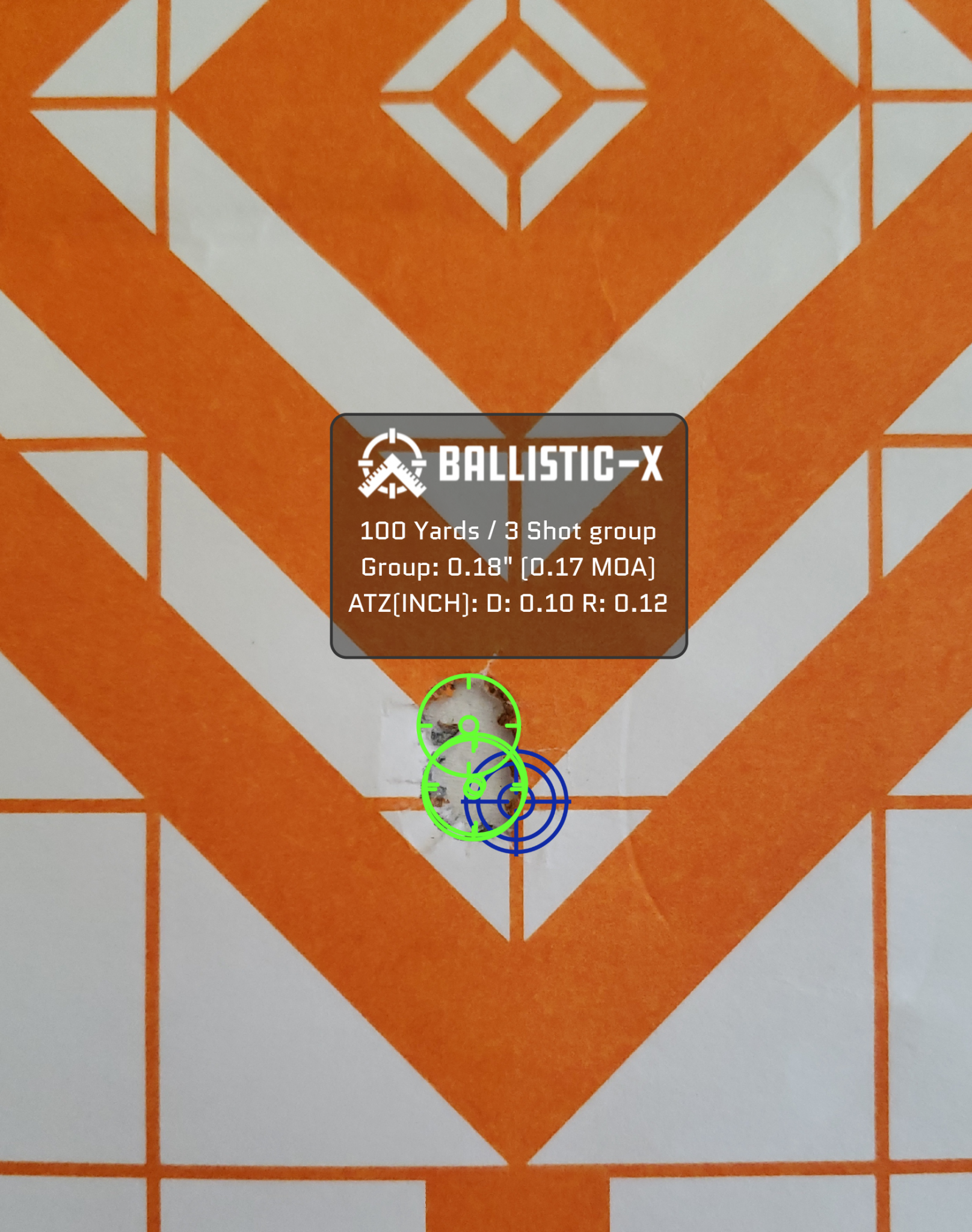

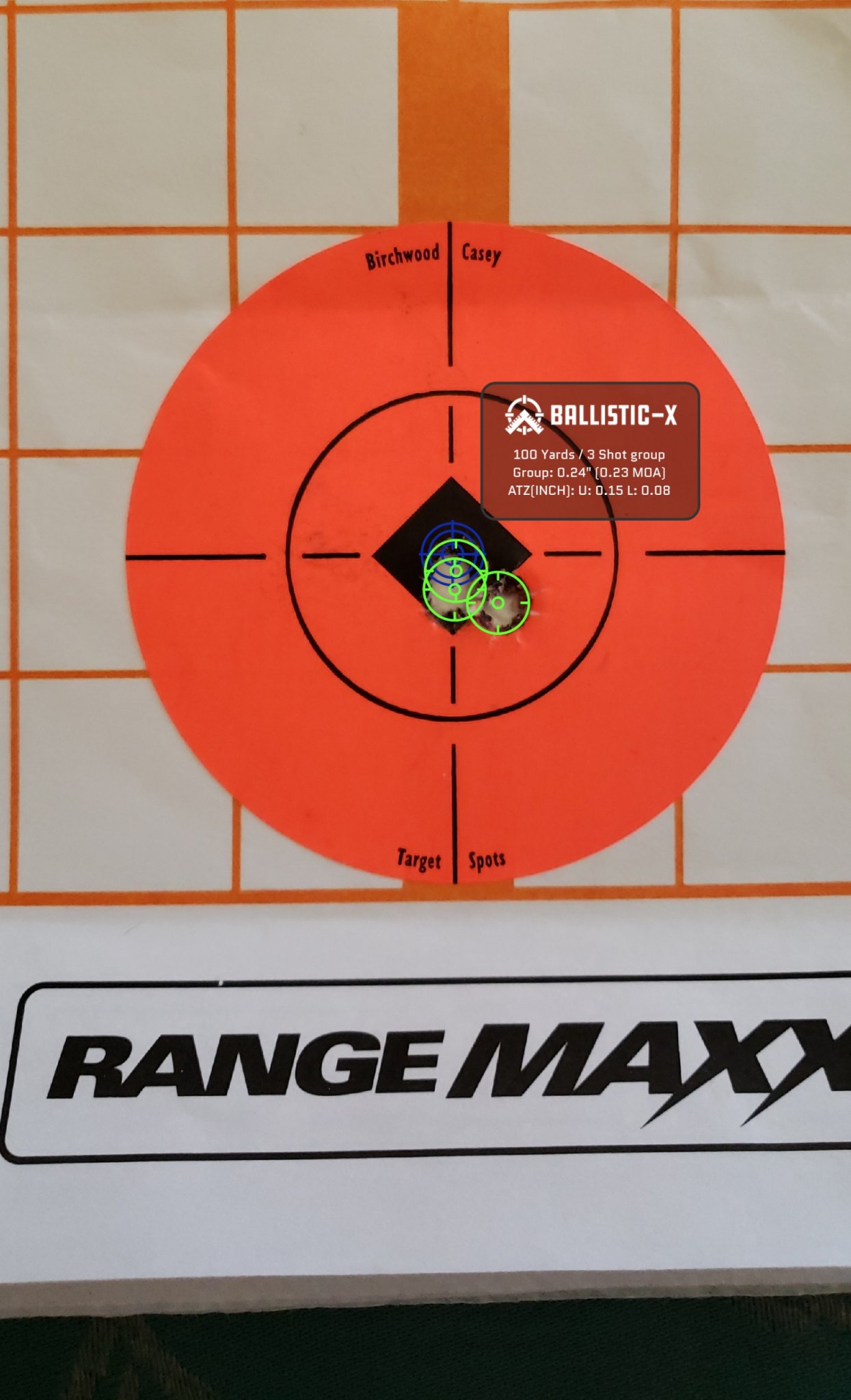

Update: accuracy issues resolved.
168gr FGMM is the factory specified load for JP AR 308s. 175gr FGMM is known to them to deliver mediocre performance.
With the 168gr, my groups went from 2–3 MOA to <1MOA consistently, with 4/5 holes touching in 3 of 5 200m test groups. Readjusting the gas system for this specific load helped as well. Pretty significant transformation.
Reactions: Malcolm31
168gr FGMM, JP LRP-07 .308, no excuses, train your fundamentals. Shooter input into the rifle and marksmanship fundamentals are the biggest variable with precision shooting in my experience training. excellent fundamentals paired with a excellent rifle, optic and ammo WILL result in sub half MOA groups. I typically shoot between .2 and .35 MOA all day with FGMM 168.

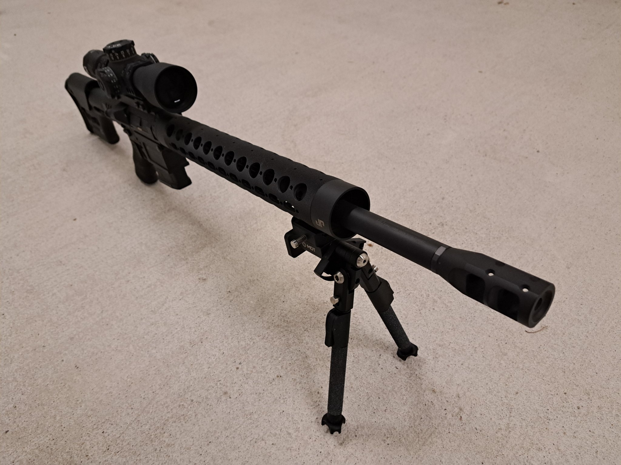

Have a shorter barrel LRP-07, one of the early builds, in 6.5CM. I cannot get it to shoot reliably at 0.75MOA or less at 100 yards.
Tried a few Hornady off the shelf selections and Prime, but still no help. Tried all kinds of things.
I am sure some of it is my issue with how to operate a semi vs my Tikka bolt in same caliber.
Also, in terms of group size, I never rate myself on a 3 shot group. I think to really get to a rough idea of the practical group size limit, for sure 5, but more like 10 is going to reveal the achievable practical group size.
