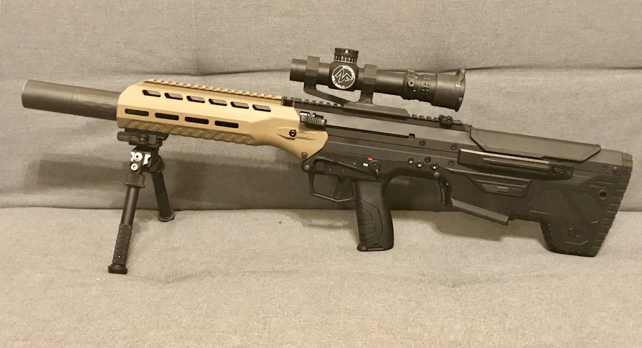

So despite the weather’s best effort at delaying UPS from delivering yesterday , I received my ATACR 1-8 today!
I’ve only had a chance to unbox it and give it a once over so far but everything seems to point to it being a winner. Glass is very clear and illumination is BRIGHT. From holding it in hand and playing with the eyebox (that sentence sounds dirty) it looks promising. I like the reticle quite a bit, 3,6,9 o’clock stadia and the center “dot” are the only thing visible at 1x. At 8x the reticle, in my humble opinion is very nice for the magnification level.
I look forward to getting it mounted and placed on an upper to get a better feel for it. Hope everyone has theirs showing up soon.
Huge thanks to @jb1000br for the fast turn around on shipping!
Doing it from mobile so I don’t have the embedded link to the photo, here’s a link though... [edit to add: pic seems to work]

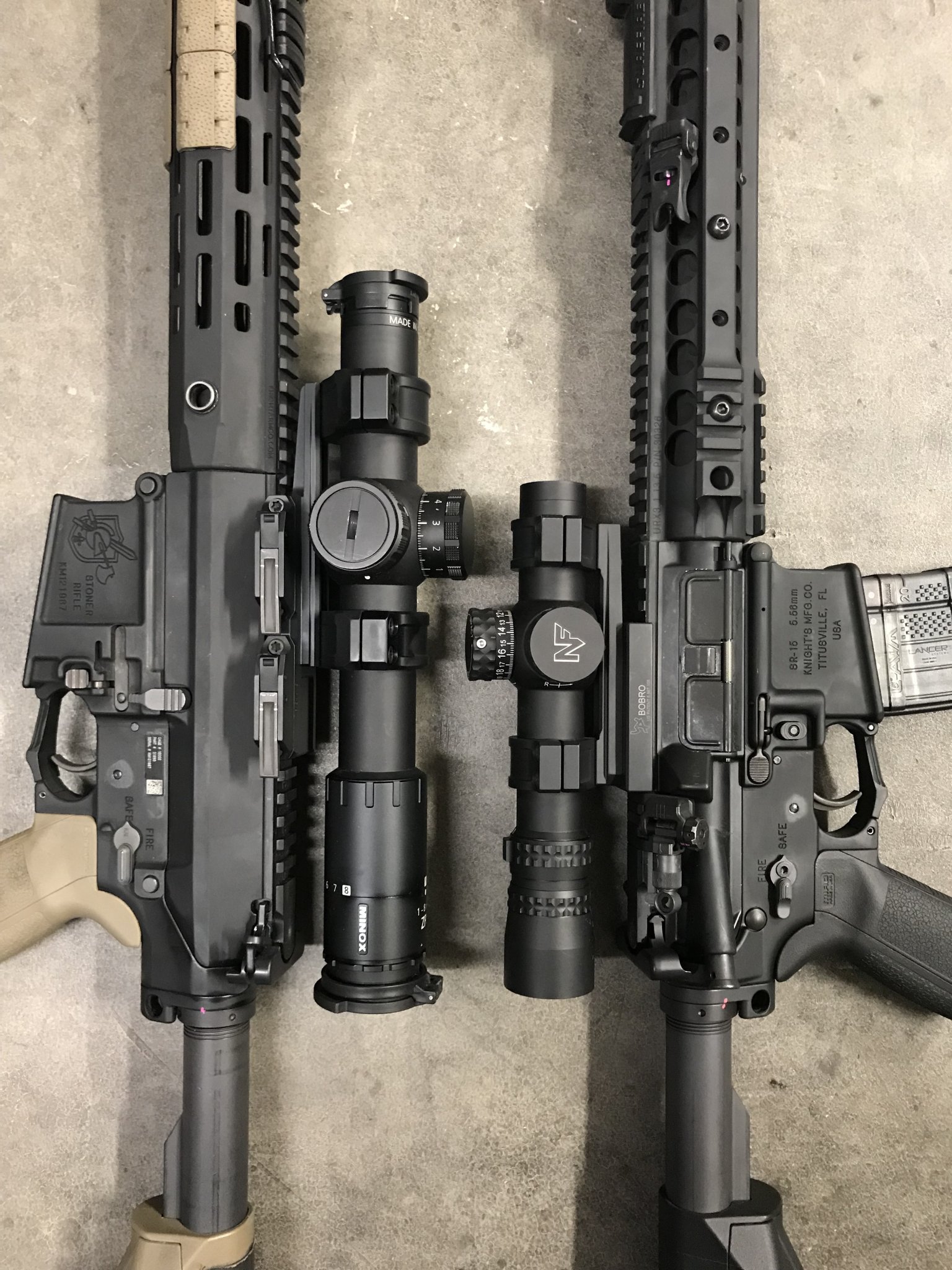

Little size comparison between the Minox 1-8 and NX8 1-8.
