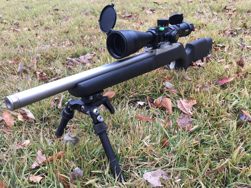

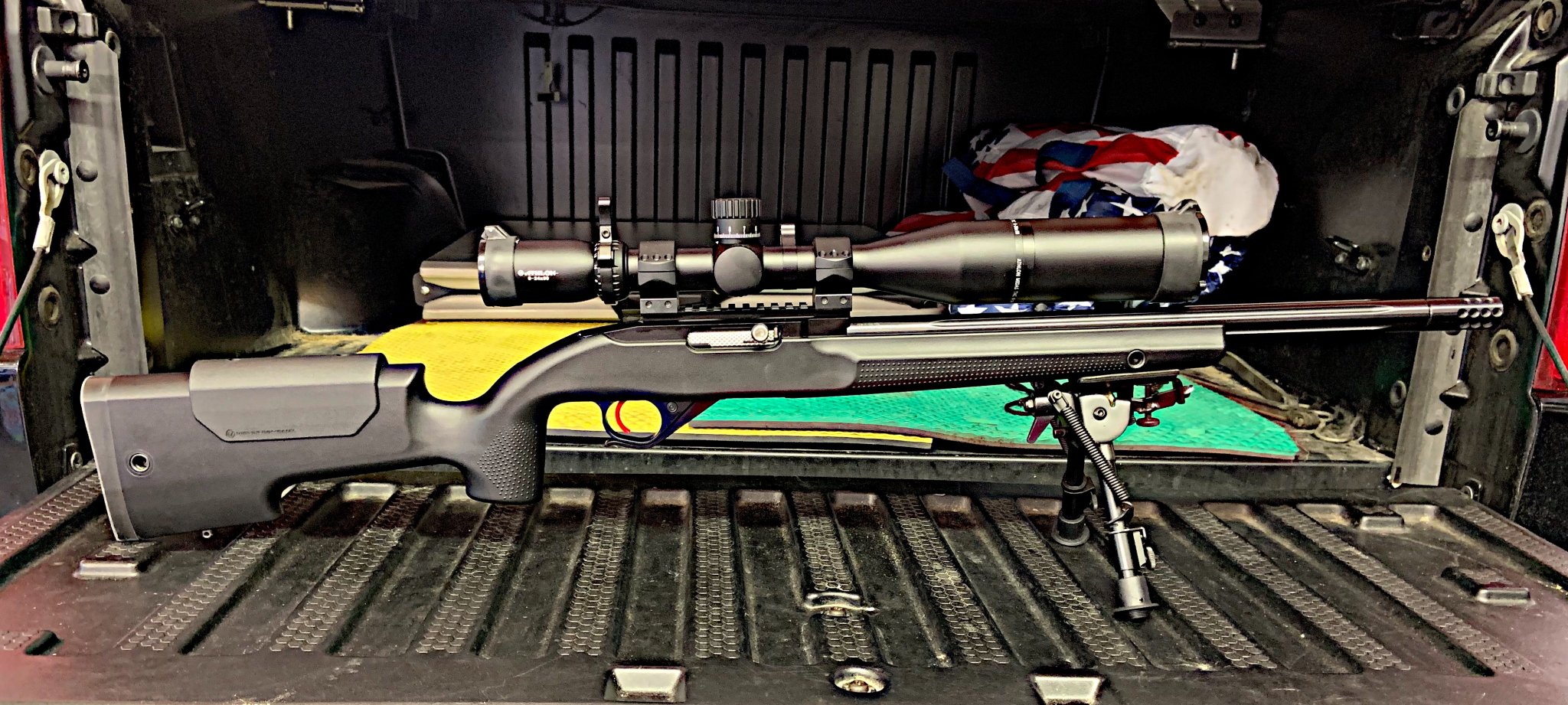

Victor Titan stock, Kidd everything else...
Reactions: RandomWAguy

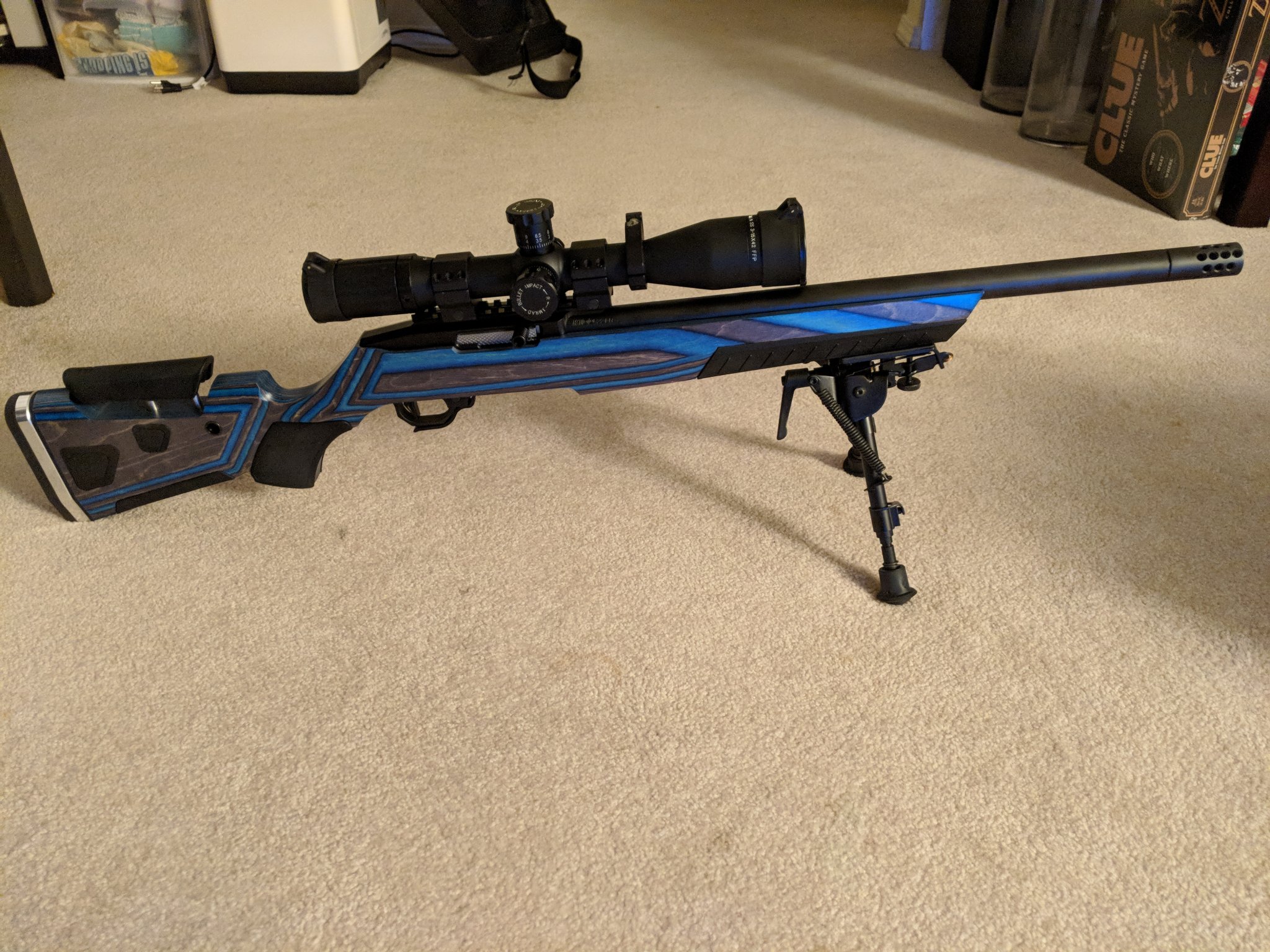

Yes, supergrade is easily swapable while the slipfit is like the traditional receivers. I got the supergrade as that way if I ever want a different barrel its a quick switch and I can pull the barrel for cleaning easily.
Reactions: MarkCZ

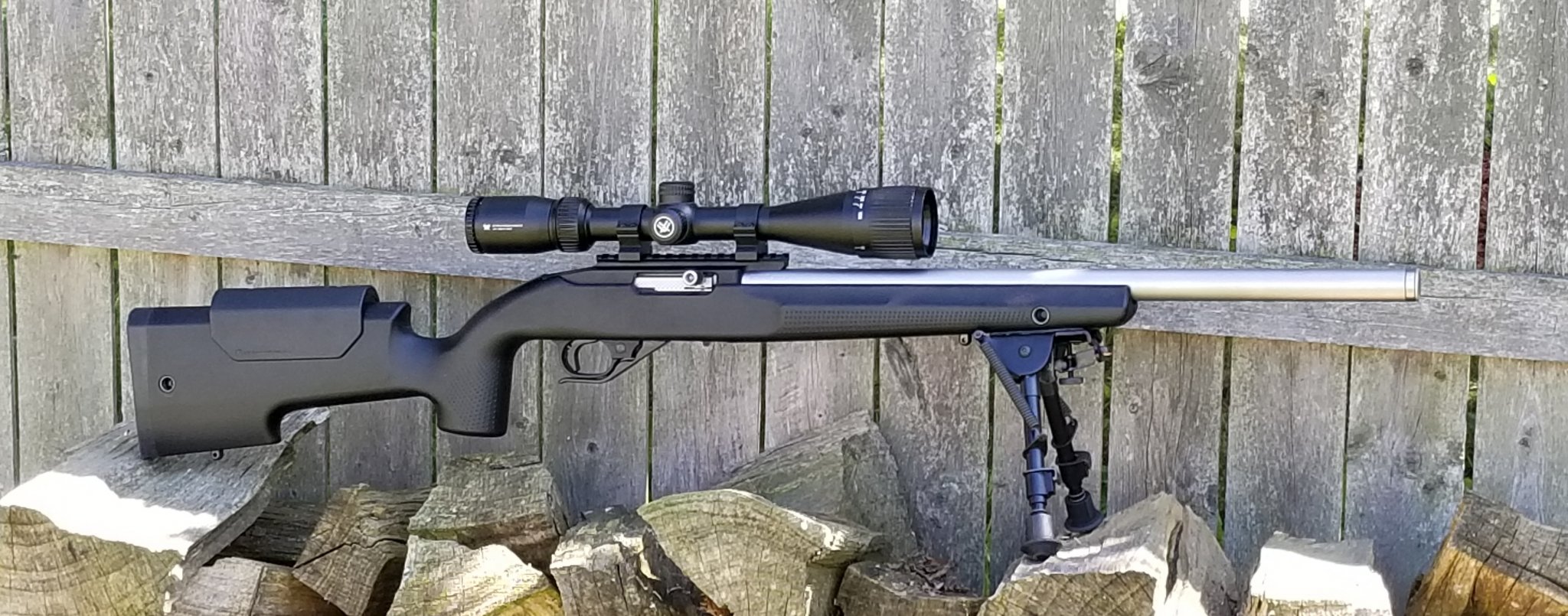

Archangel stock, Brownells receiver, Fedderson barrel, Kidd and Ruger guts. Vortex scope not shown in pic. Extremely accurate.

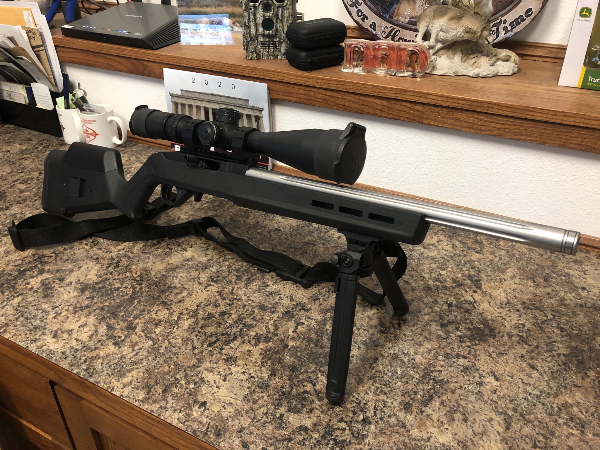

i bought the kidd super match with kidd 2 stage trigger n the magpul hunter stock....complete rifle from kidd.....hope to zero it today for 50yd. optic is vortex razor amp....

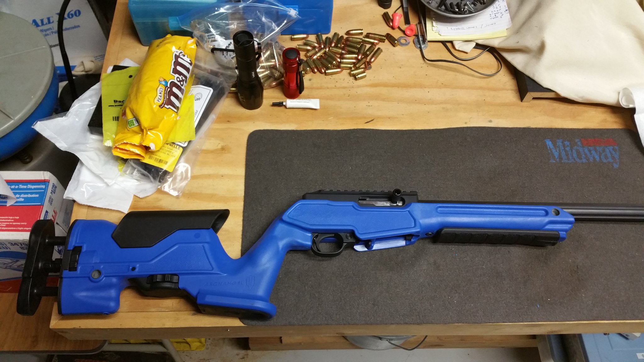

So here's mine, Kidd guts w/single stage trigger (the single stage is a very nice trigger too FWIW) Titan stock and Liberty Pinnacle 2 bbl. which is a cored out Green Mountain NM barrel with 4"bbl. left and 12" of suppressor core. NO frp, just some action noise, that's it. It's ridiculously quiet. It's also pretty damn accurate and the rifle itself is just a joy to use. I have an M2HB too, but this one actually ties place with it for "most fun weapons to shoot". Not kidding about that either.
Just so you know, the Kidd rear tang won't work with the Titan stock, you have to use their tang, so make sure you get the right one because they ain't exactly cheap.

I took three different 22LR brands/loads along with me to sight in. Some Winchesters from a 555 pack, a couple boxes marked Browning and a box of CCI Std Velocity. Saturday was 40 degrees with a slight breeze. It only took a couple shots to dial in using the CCI STD velocity. Then after trying the other ammo, it was evident the rifle preferred the CCI STD.
Here is sight in target...
The rifle came with a 0 moa rail, so I installed the 20 moa rail, and the higher comb for the magpul stock. Then put the optic on. Shooting from bipod with a rear bag. I ordered a good selection of the ammo many of the members suggest works for them and will be doing a test to see which works best in this rifle.
