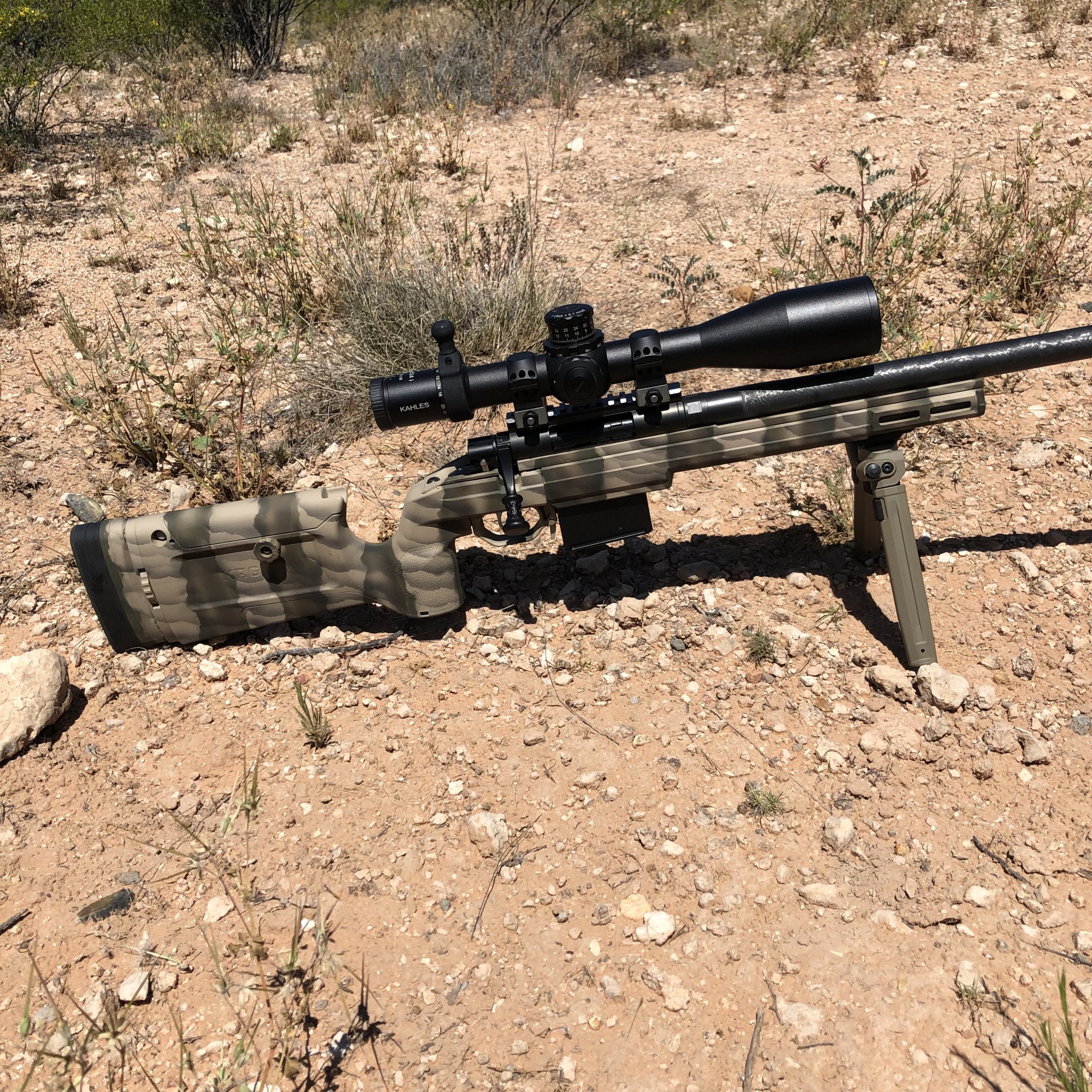

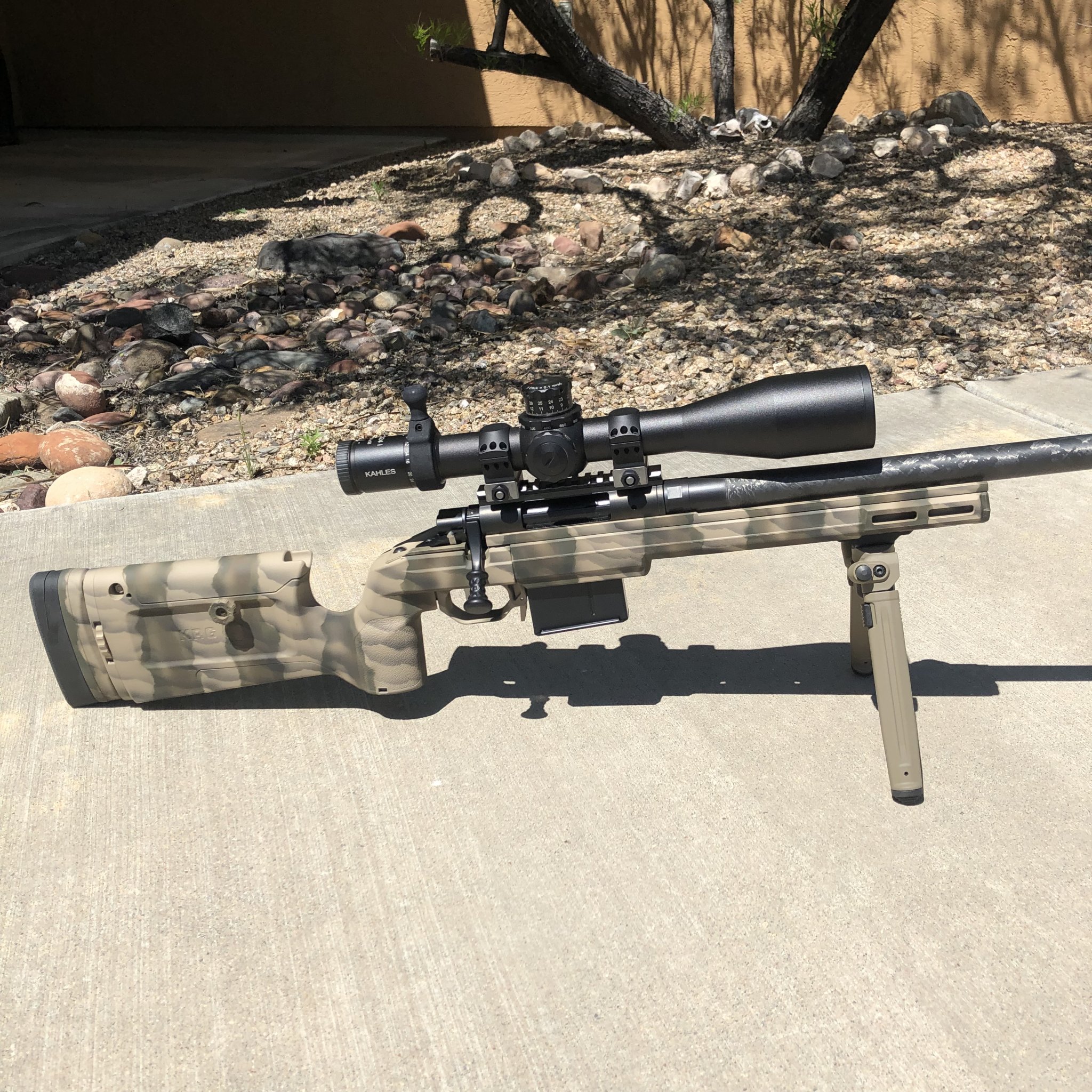

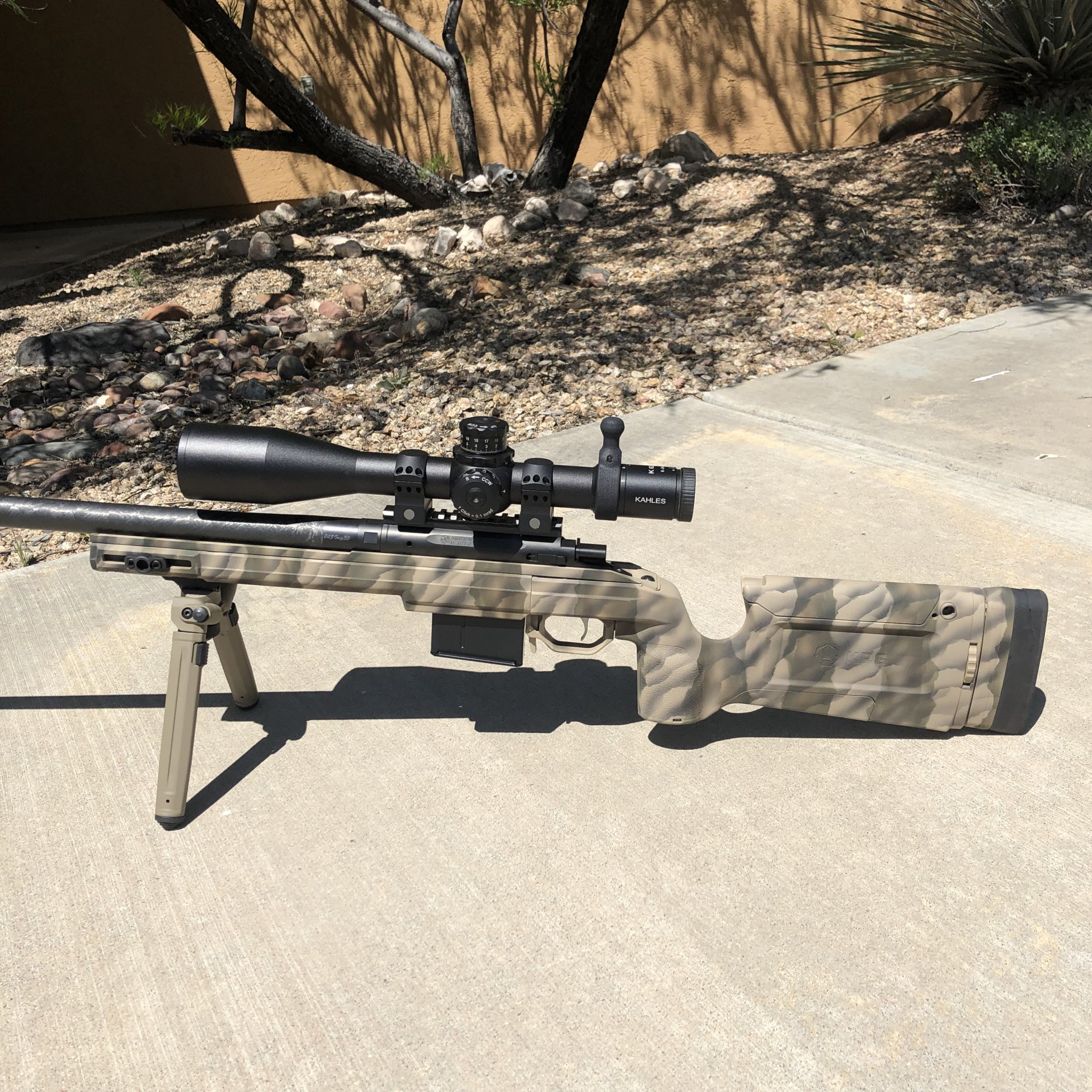

I played around yesterday with a freehand camo pattern on my Bravo and I think it looks pretty interesting (if unconventional). The pattern uses H series Cerakote, pattern is four colors.

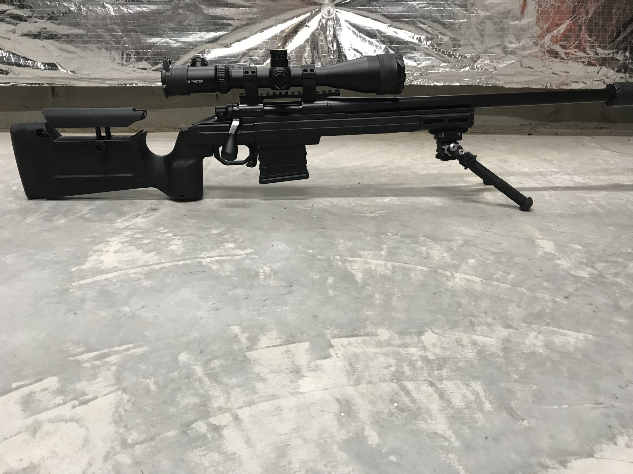

Picked up a Bravo and the Brown truck delivered it today. Let me start by saying I’m a huge Manners fan and honestly do not care for most chassis (just a preference). I’m very impressed by the Bravo. The feel is very close to my T4A. I dropped my Rem SPS tac 223 in it without an issue. Getting the rail on for my Atlas took a bit of fiddling, but no big deal. All my magazines (Accurate, ARC and MDT) slide in and lock with ease.
I got this for a future rifle build, might end up leaving this on and picking up another for that build.
Thumbs up, KRG!
Reactions: Massoud
Yeah, getting the rail on (correctly) is a PITA. That being said, I guess that's why they're moving to the rail being an integral part of the fore end now.
