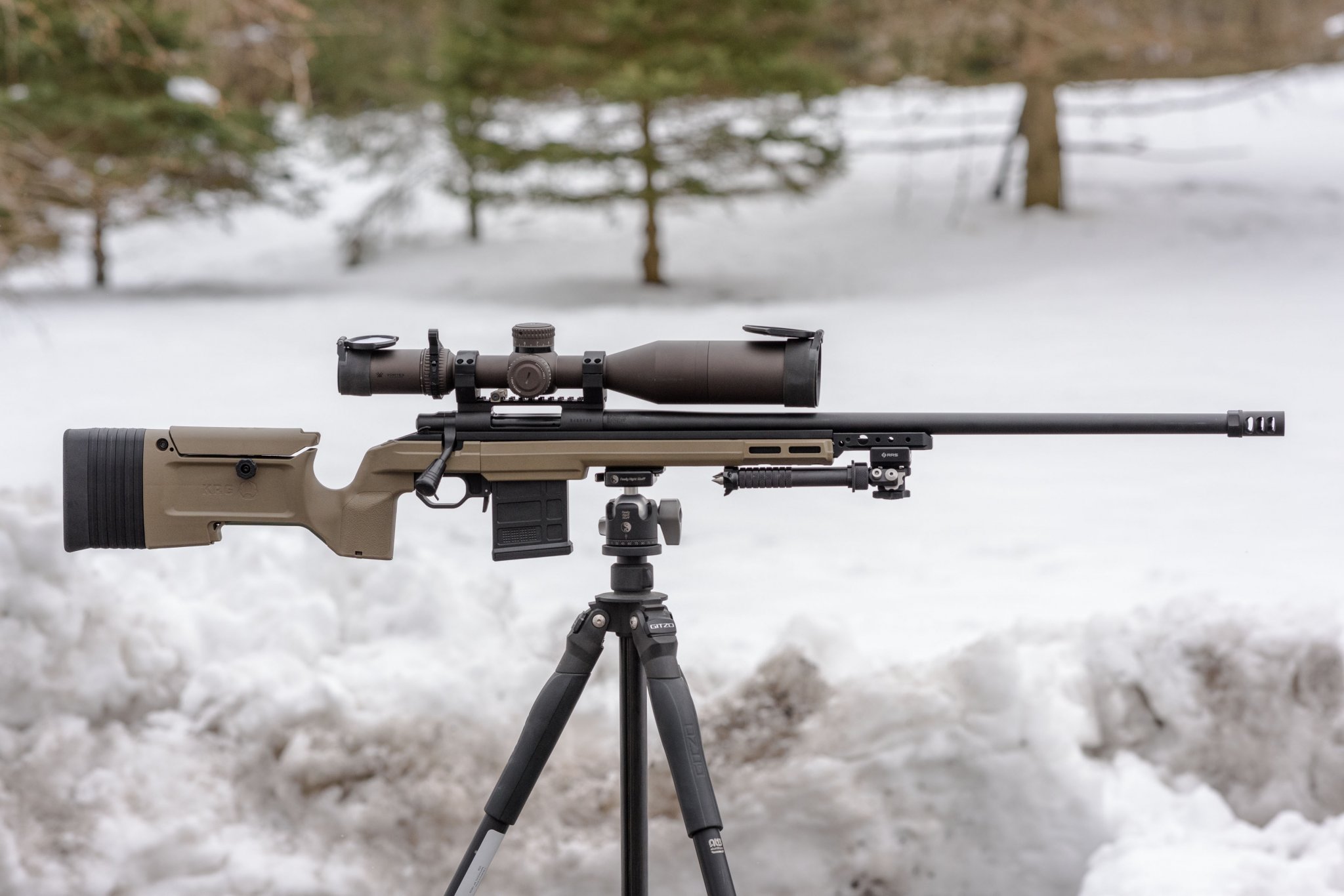

I just ordered the Arca spigot and QD for my Howa Bravo... was waiting on the Arca base plate but realized I probably wouldn't be sliding my tripod around as much as I like the idea of being able to.

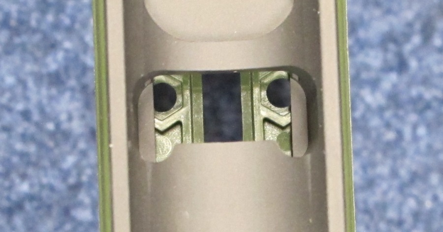

For those of you who have these already, is there a compartment in the pistol grip? There's a little cutout at the bottom of the grip but I can't tell from any pictures if that's what it is

Howa Bravo in FDE, 26" 6.5 CM. I need to take some of the LOP out. Spigot mount out front. Yes there is a secret compartment in the grip but you still need a hex key to open it, unlike a Magpul AR grip. Otherwise you can see the shared Magpul design heritage. Used a MLOK Arca base plate for the too small #2 series tripod. I like the bag rider cut out when you remove the cover piece. The line of the plastic forend is slightly wavy next to the perfect barrel, also the joint between forend and the housing around the action do not line up perfectly. You have to remove the cheek riser to remove the bolt. Trigger is two-stage adjusted down to 2.5 lbs and crisp. All is solid and the overall impression is excellent but it still reflects its price, albeit a good value. I don't see where spending more on the chassis gets you any more performance but perhaps more convenient adjustments, nicer build quality, and pride of ownership. I'm not very experienced but same for the Howa action, it feels nicer than the Rugged, Savage, or Remington for a stock action. I haven't tried a Berega but I bet I'm not losing anything.

-The area in the grip can be used to store things. You can remove the screw that holds the cap on and just use the cover with the snap hook. There is always a bit of play in anything that uses a snap hook, and also we don't trust snap hooks over the life of the shooter so we added the screw.

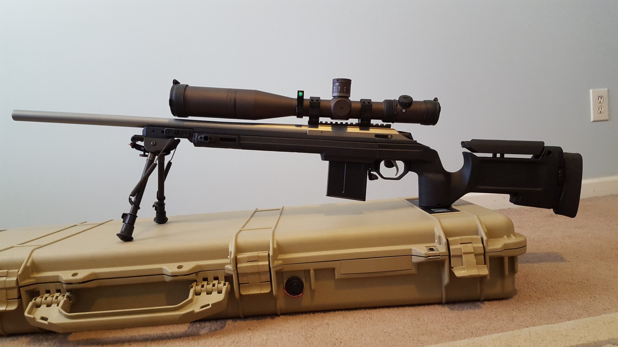

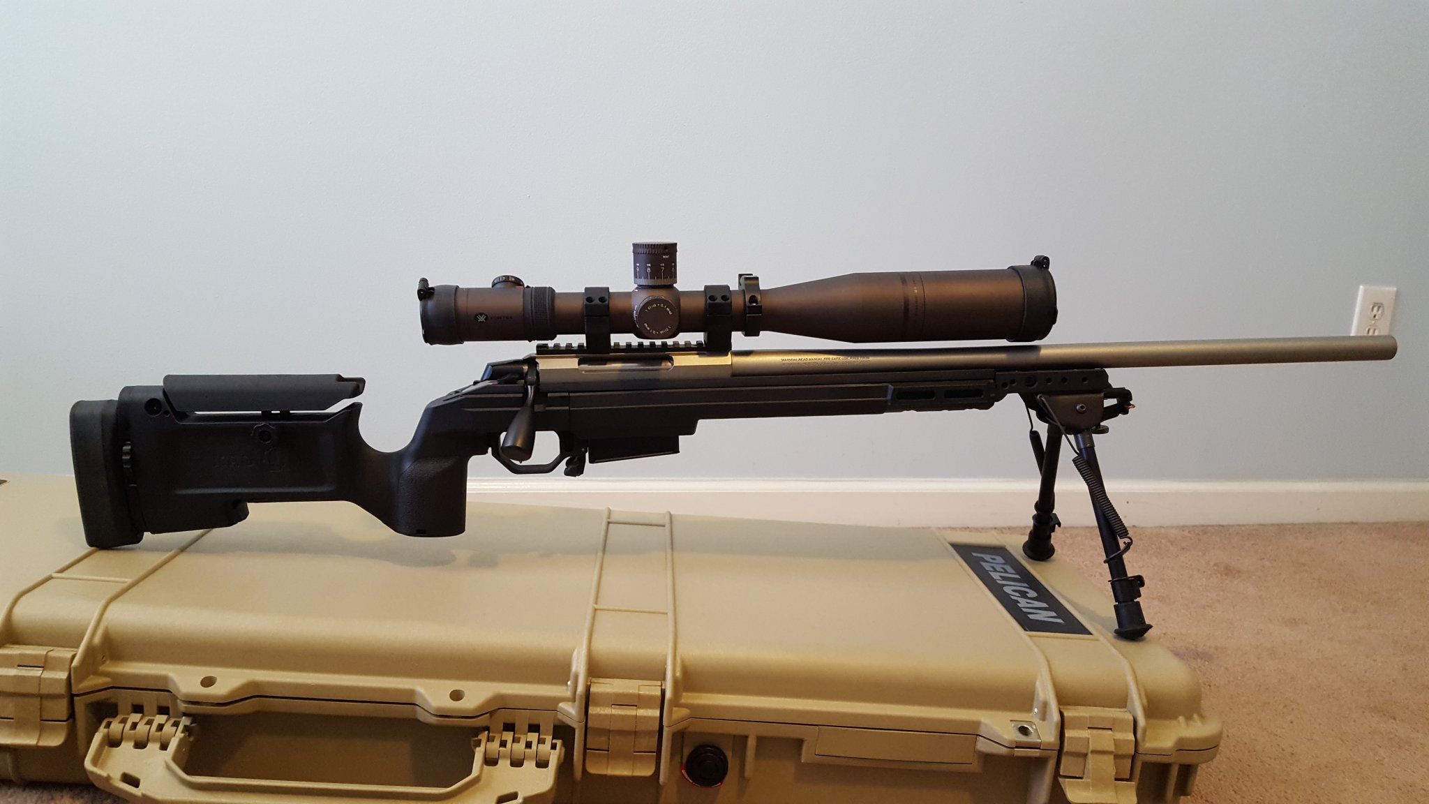

Here's my Bighorn TL-2 in the Bravo. It is very rigid and so far I like it. It weighs 13lbs as pictured and recoils like a pellet gun with 75gr 223 loads.
I have big hands so it is taking a bit of getting used to compared to my AIAT. I may get the X-Ray back end at some point for it.
I have shorter rings on the way as these are a bit tall for my taste.
Nice. Barrel length & profile?
Thanks!
It is 20" long and a Light Palma profile.
I bought the barrel and action off of the EE here a couple months ago and Bighorn Arms went above and beyond in helping me get it ready and get the action updated with the latest revisions of the TL-2 as this action is #40X and was still from Colorado but it wasn't ever used. I got a fantastic deal on it to where it was cheaper to get a TL-2 than an Origin action.

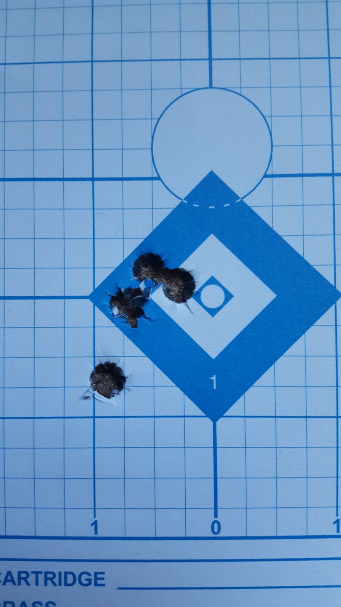

The barrel was made by Josh at PVA and it appears to be a shooter capable of under half MOA 5-shot groups except for when I screw them up :LOL:

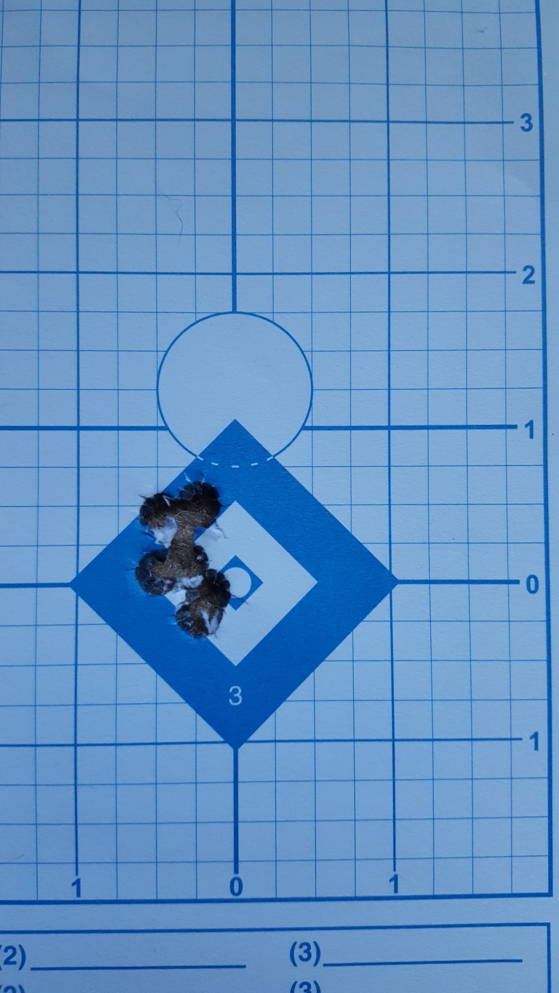

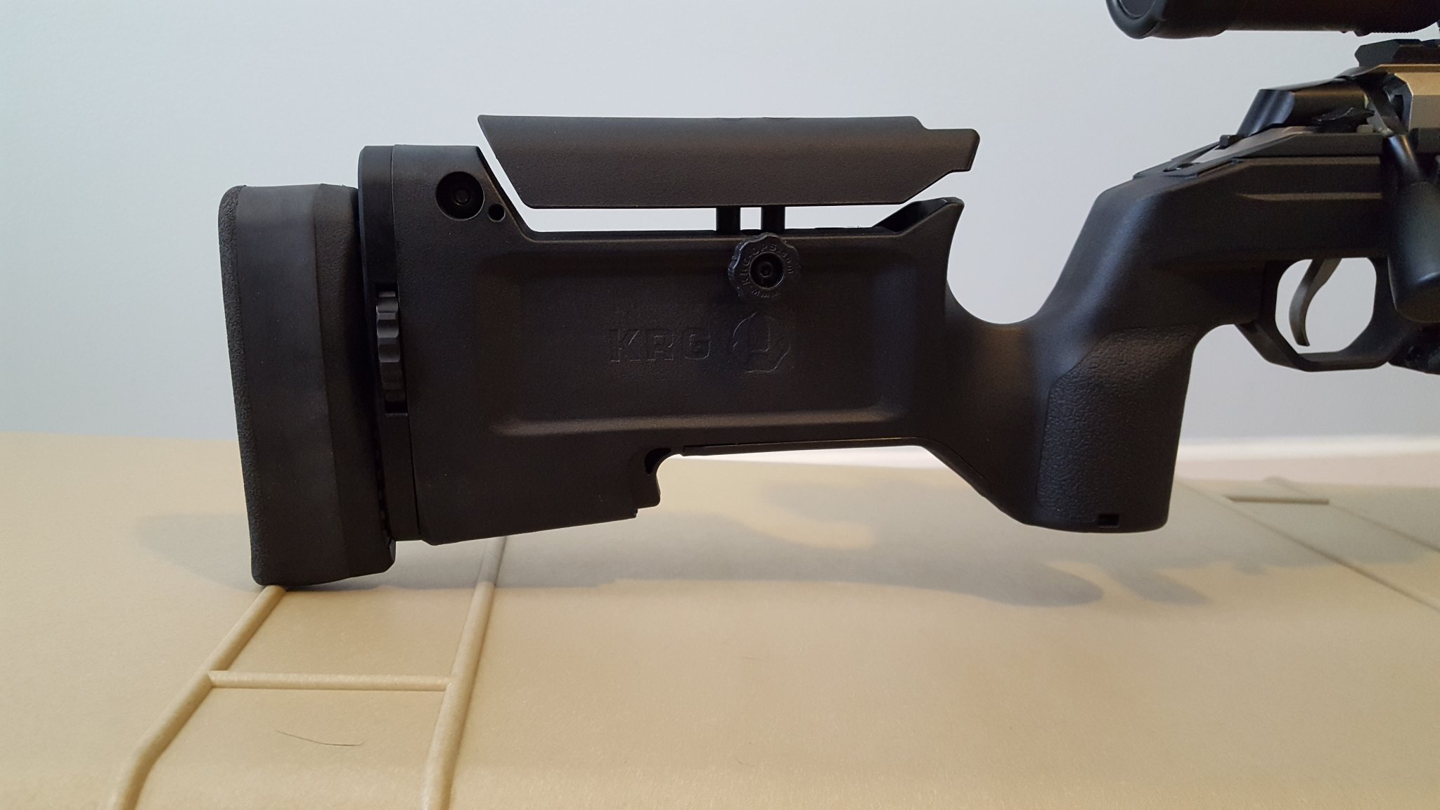

Finally got out to the range to sight in today. The rifle is very comfortable to shoot at 12.8 lbs unloaded (this recoil pad is great BTW), and the layout of the controls is intuitive and makes the rifle easy and quick to operate. The KRG mags were smooth and cycled flawlessly and everything fits together tight like it should.
The tool-less buttpad height adjustment mechanism was sitting in my mailbox when I got home (they were backordered when I ordered everything else-go figure it gets here after I go to the range). Made some small adjustments to the foam in my Pelican 1750 to fit it; without any LOP spacers the tool less buttpad mechanism adds about 1/2" to the LOP-about the same as two spacers, so I took out the spacer I had in there. Once the Tikka specific cheekpiece is out and I can get another 1/4" out of the comb it will be perfect.
I got it all dialed in and included two groups that I fired after I sighted in. The first group is 7 rounds at about 1 MOA, and the second is 5 rounds with one flyer that opened it from about .6 to 1.5 MOA. That was all me though, I haven't shot scoped rifles in about 2 years so I definitely have room to improve and tighten things up, and the wind today didn't help.
