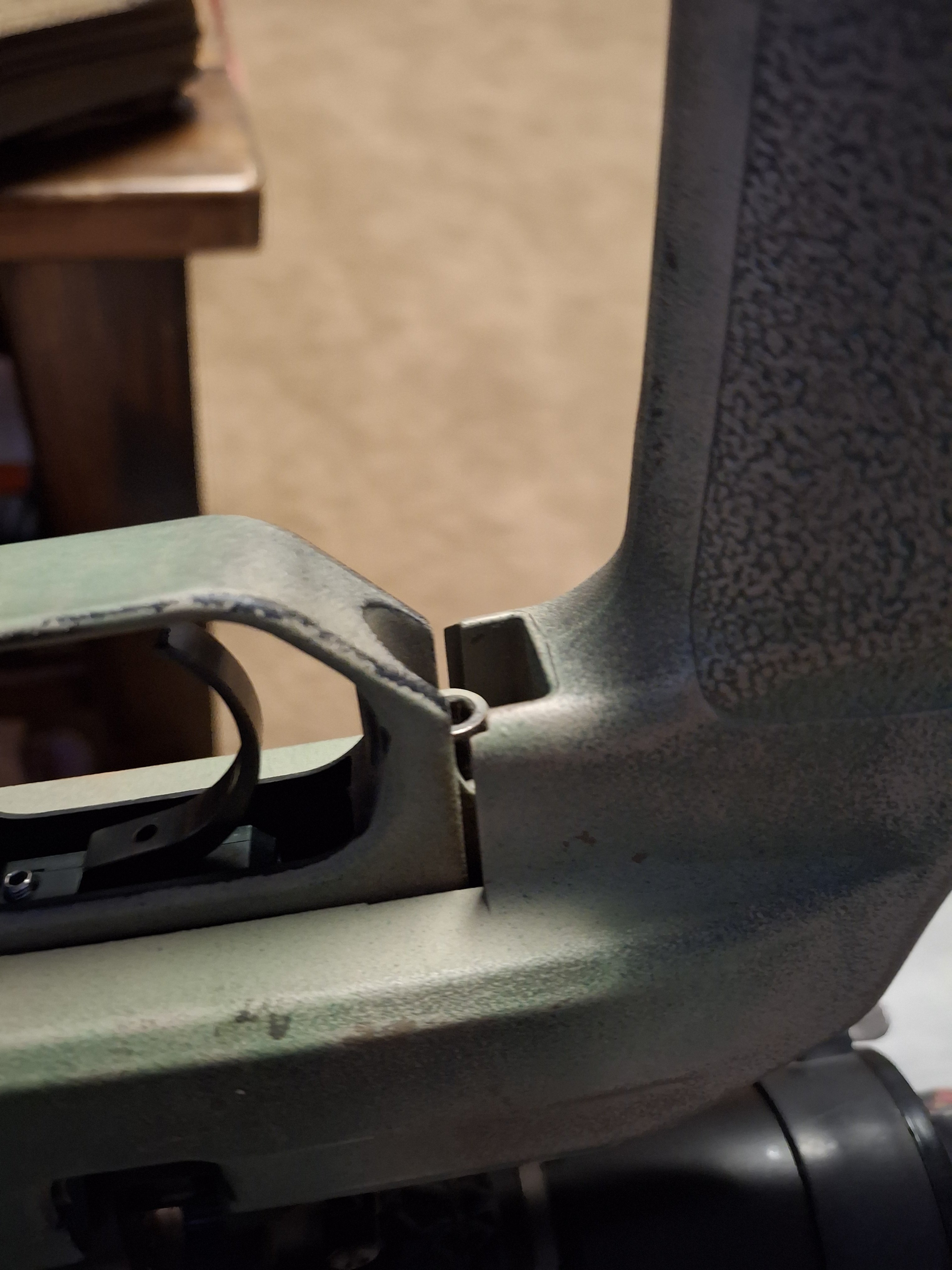

Hello all! Did a search and couldn't find anything really about this. Have KRG Bravos for three of my rifles (PRS/NRL/.22) and love them. For reference, I've been using the Bravo chassis for over 6 years and have no intentions to change but I've consistently had a hot spot on my middle finger from a part of the design right between the trigger guard and the grip. Because if how the action screw seats, the gap where the screw goes in lends itself to a couple pressure points. Normally I just wear a band-aid to help prevent the issue, but a more permanent solution would be nice. Pictures below to show the area in question.
I'm sure I can finagle a solution, but wanted to see if anyone else has this issue and what they may have done to alleviate it. Thanks in advance!
Had a similar issue on a McMillan - I filled the spot with Play-Do and ran a narrow strip of moleskin over it. That way if I need to remove the stock and access the screw I can just peel the moleskin and dig the Play-do out. As always, YMMV. Good luck. (y)

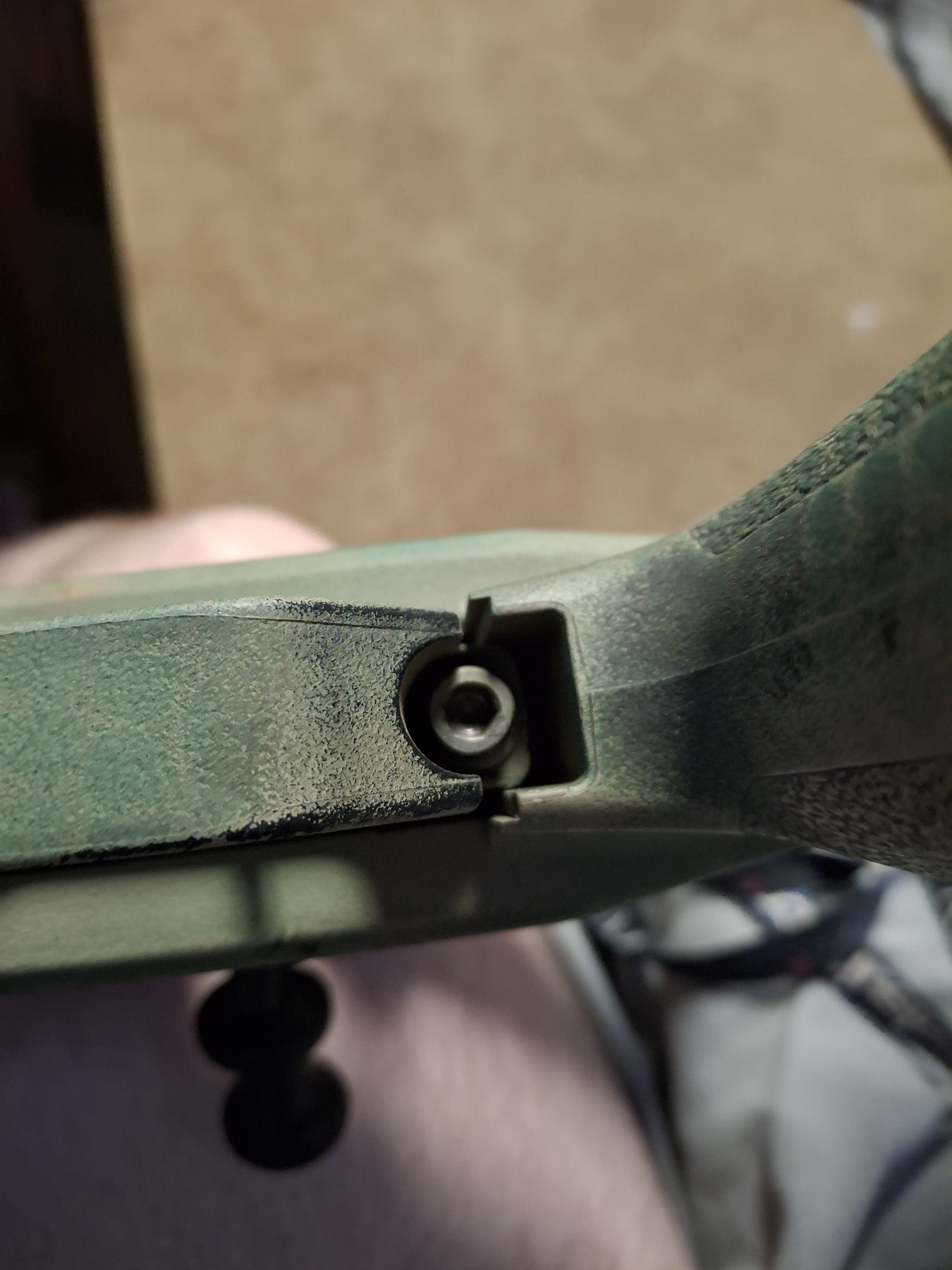

View attachment 8694025View attachment 8694026
I used the clear silicone ear plugs from a local drug store.
Reactions: Llamas Waffles

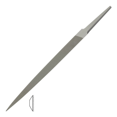

Swiss file and use it to 'break' (chamfer) the sharp edges
Used some fine grit sandpaper to do that previously and still get a hotspot, unfortunately.

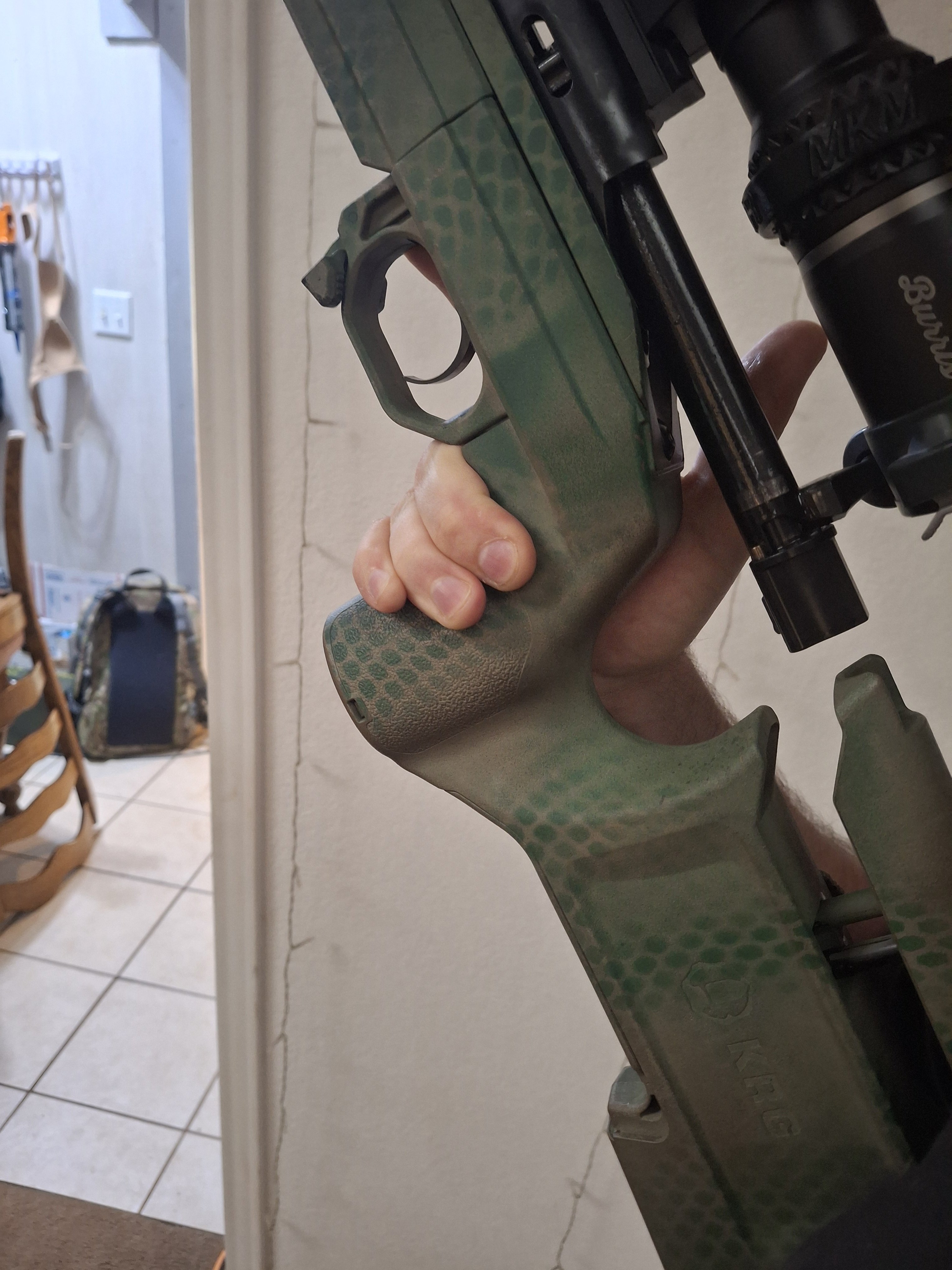

Definitely see what you're saying; that spot isn't an issue for when actually pulling the trigger. It's when I move the rifle around on a stage that it cuts in. Front hand grabs bag off of the tripod/prop/etc. and rear hand grabs rifle by the grip, putting the whole weight of the rifle into one hand and pressing the spot in question on the middle finger while moving.
I've got tiny hands, so when pulling the trigger my other finger tips barely touch the grip at all to maintain a proper grip angle.

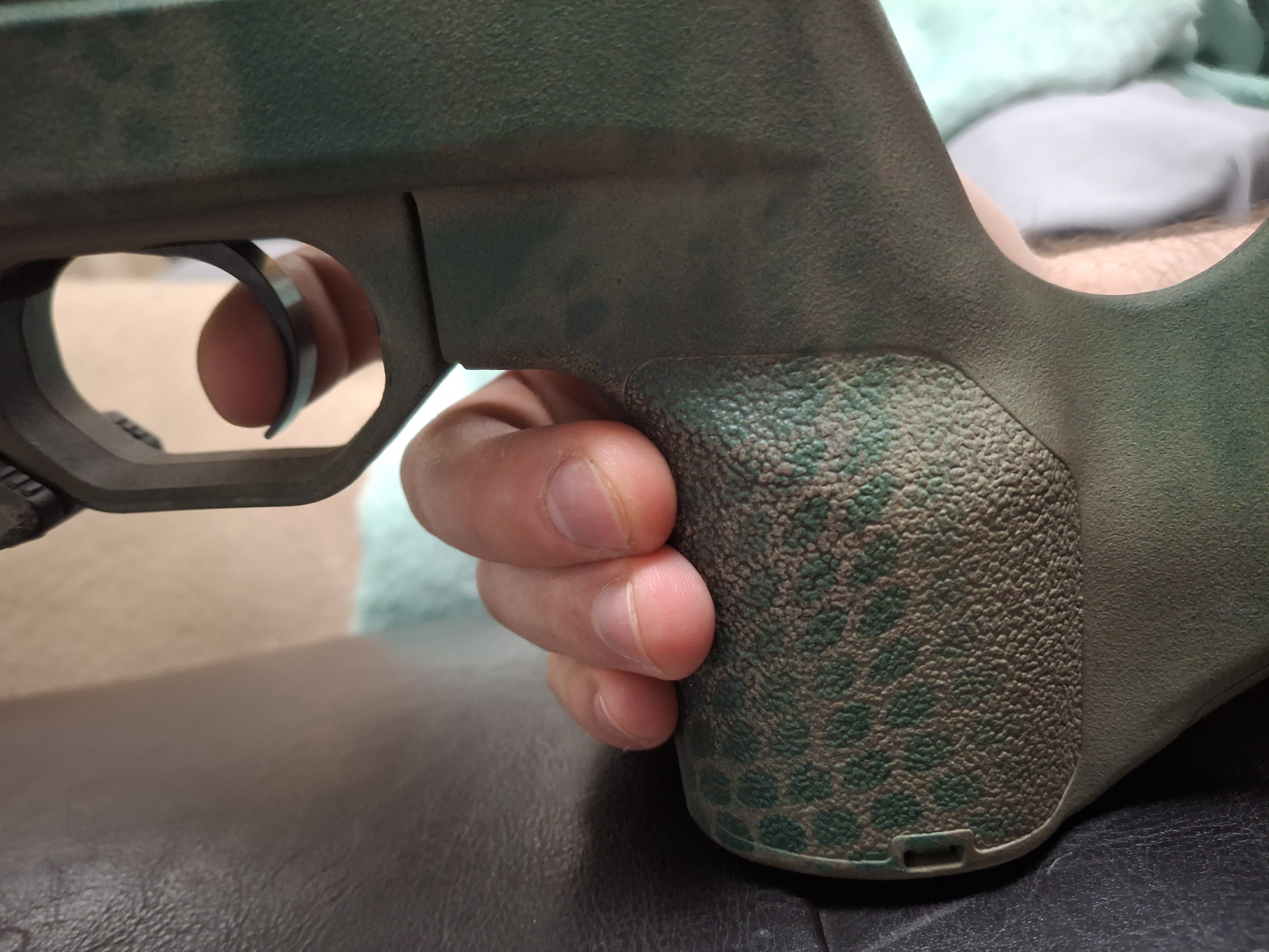

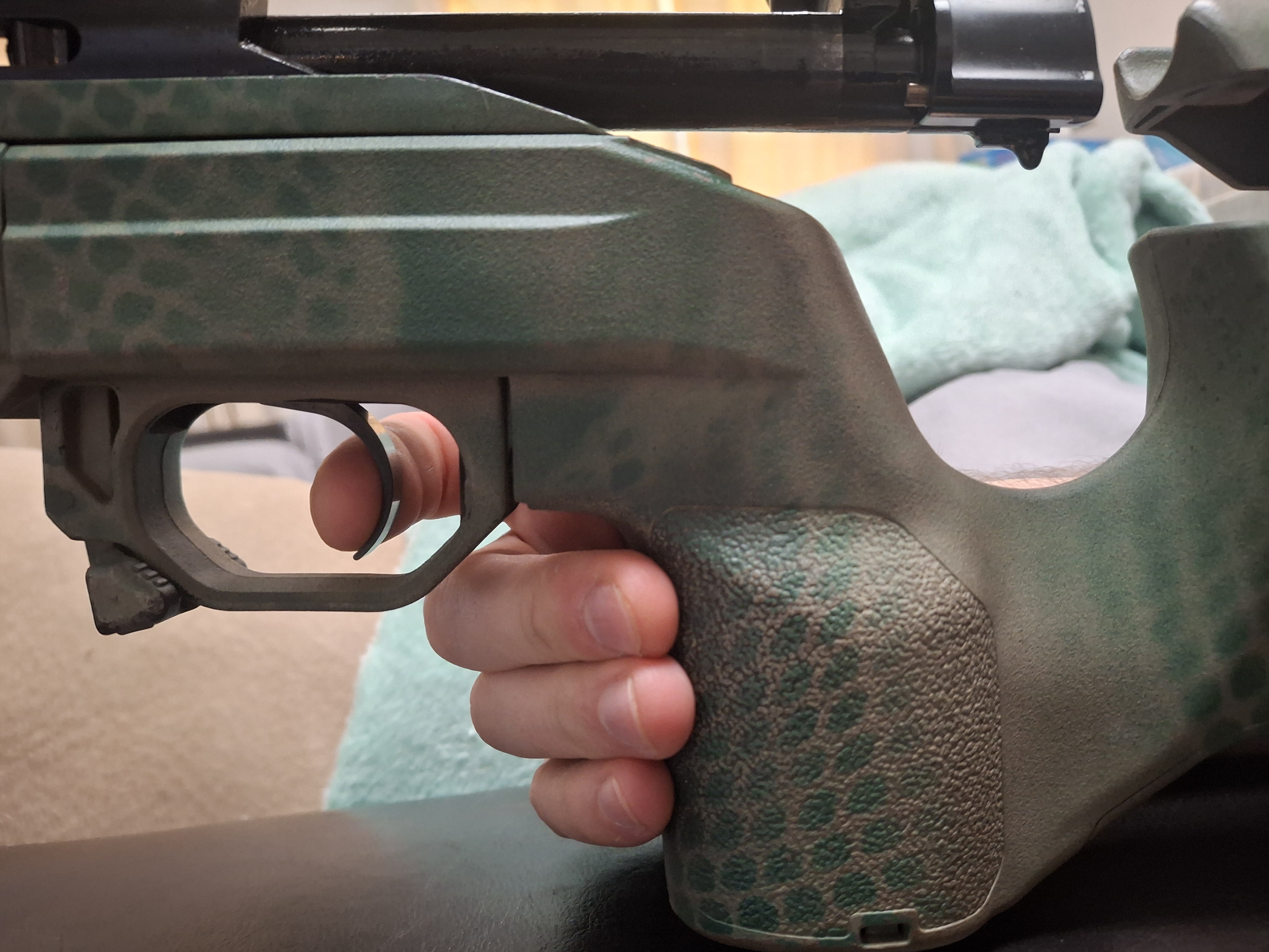

Since there seems to be some confusion on how this even occurs, homeless these pictures help.
When firing, no contact and no issues:
View attachment 8695273View attachment 8695274

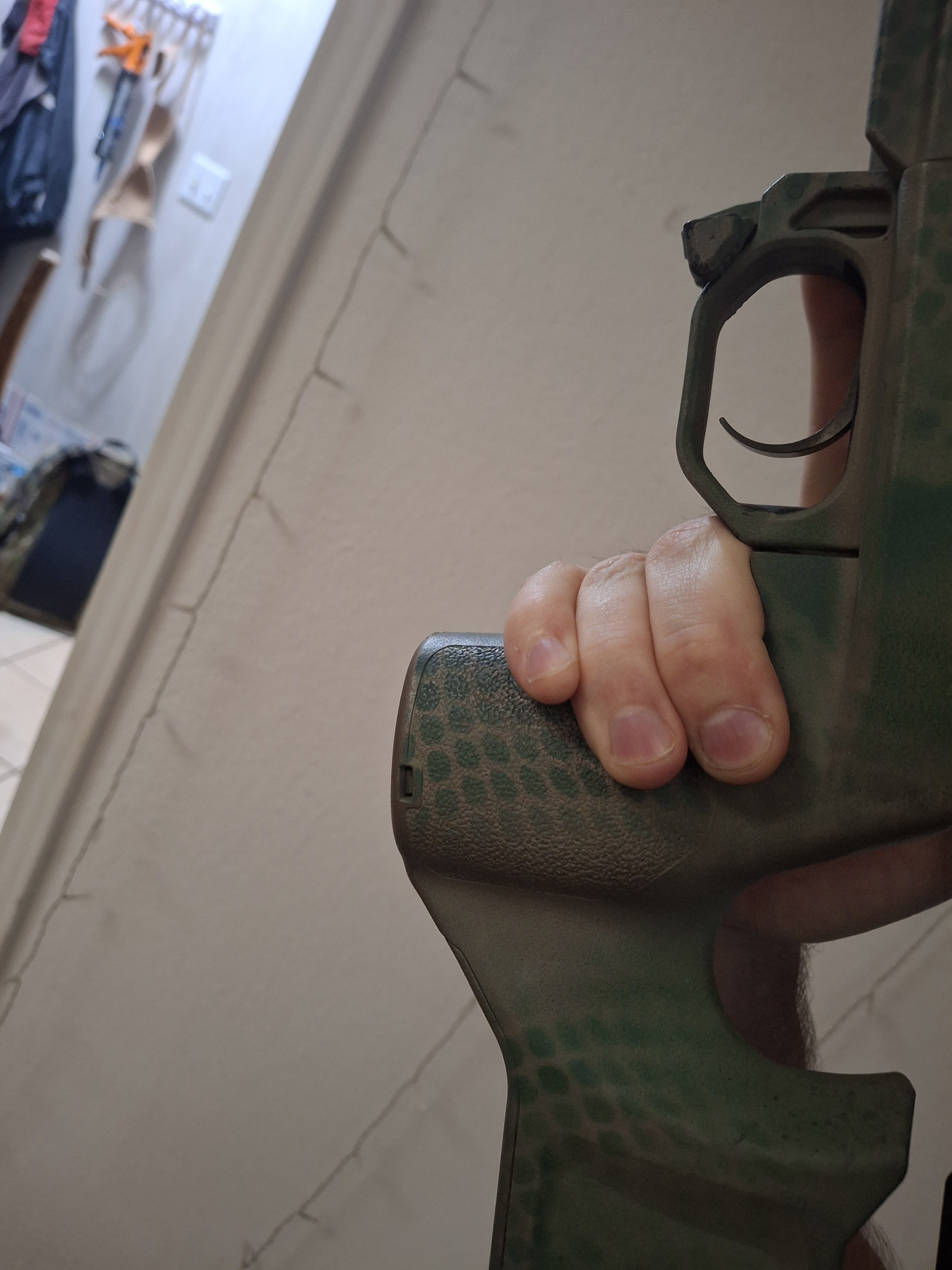

When carrying/moving one-handed on a stage while other hand is carrying bag/tripod:
View attachment 8695275View attachment 8695276

If it were me I would attempt to cover that area with JB weld and then drill a hole through it to still be able to remove the action screw. Might look like shit when I got done with it but it should work lol.
I considered that, including sinking a hollow post in it where the bolt goes instead of having to drill it out, but my luck I would end up JB-Welding something together that shouldn't be stuck 🤣
