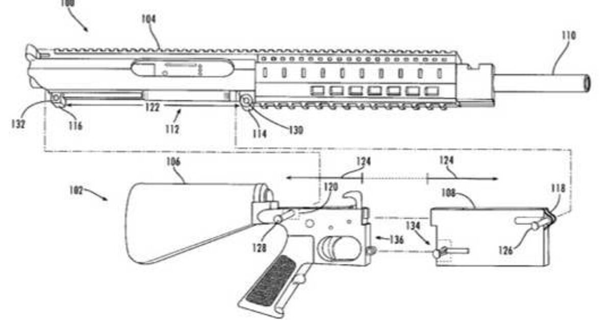

I'm in, also. Would LOVE to see you guys make a Bravo that will accommodate long action cartridges for the T3/T3x, also (i.e. with TRG 300WM mags). I'd buy two. In addition to the CTR mag-compatible Bravo.
Neat idea. I'm not an engineer, but I wonder if that could be accomplished with a universal inlet on the bottom of the stock, and then different adapters are used to accommodate AICS, CTR, and TRG-300WM mags.
Only one stock is manufactured. Just replace the bottom adapter to fit the mag system you want.
That would make great sense if possible.
Would most likely end up wider than if it was all built in. Also if they did that only parts that were made for that would work. No reverse compatability.
Also depending on how broad existing patents are written. There have been similar things done for ARs
Not that Jallen exists at this time.. but that was how their system worked as far as i was aware.
One chassis, but had separate parts for Long or short action.
