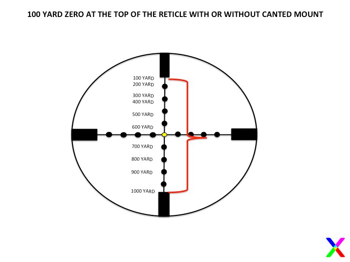

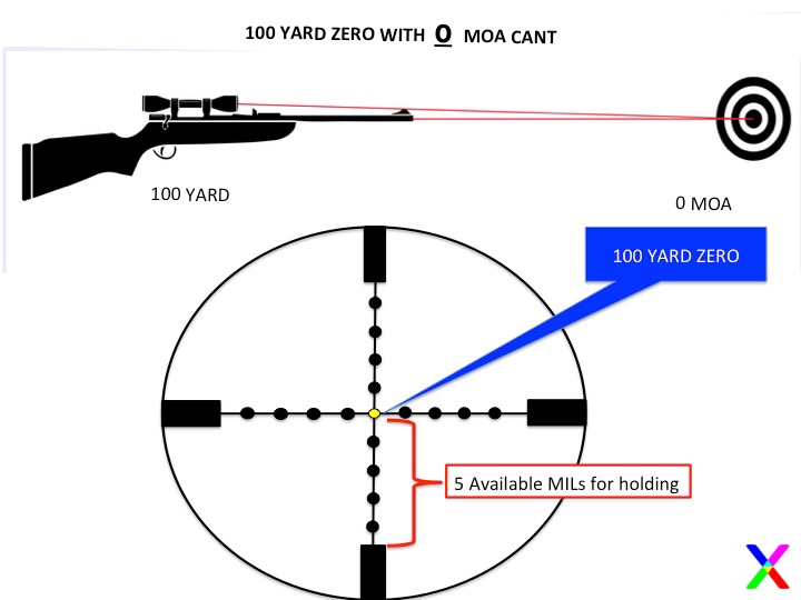

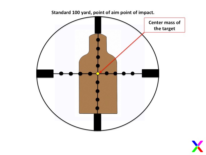

The standard method of zeroing one’s rifle is to use the center of the cross-hair as the 100 yard zero (point of aim / point of impact.

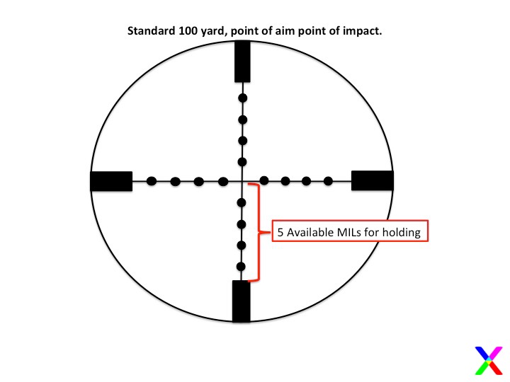

Using this method provides the marksman with only 5 MILs of available range/elevation hold.

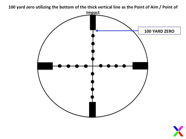

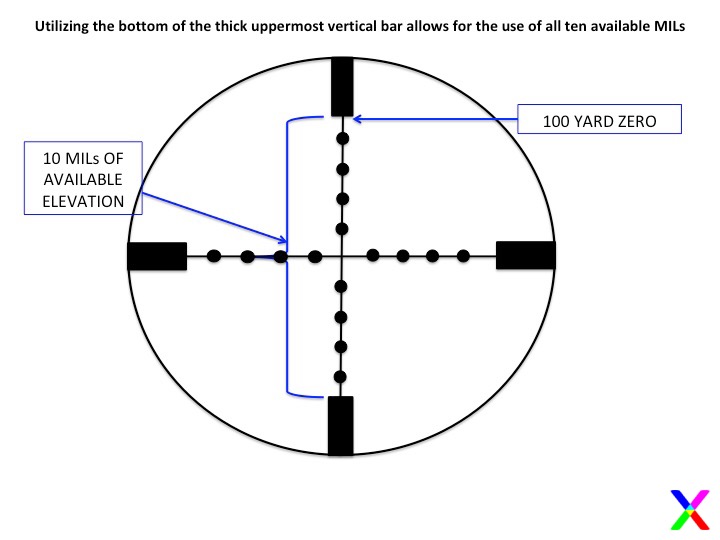

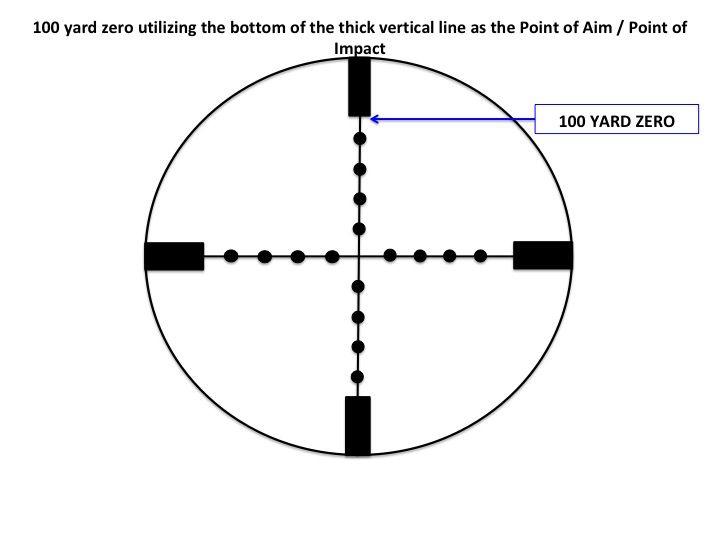

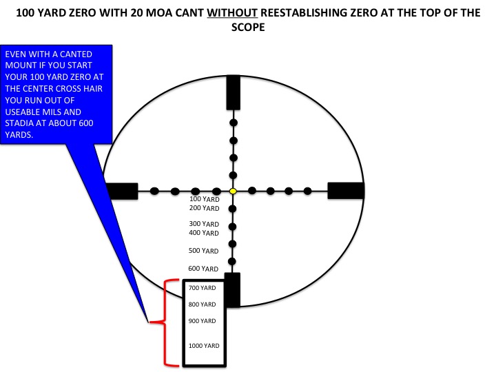

There is a method of readjusting your 100 yard zero in order to harness all TEN available MILs in range/elevation.
The method is to utilize the bottom of the thick vertical bar of the upper vertical cross-hair as the 100 yard zero point.
Using this method allows the marksman to harness all TEN available MILs of range/elevation.

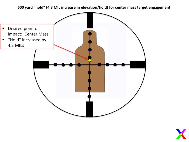

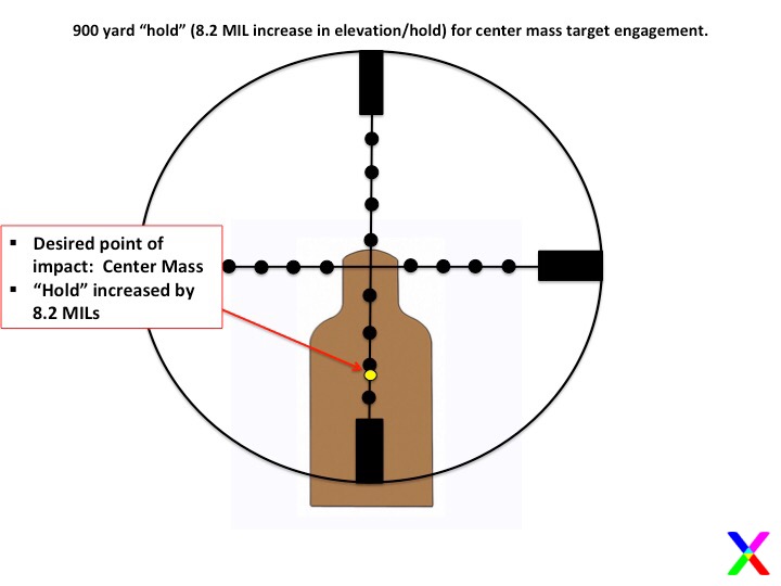

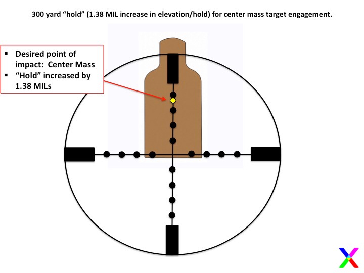

How would this ten apply?

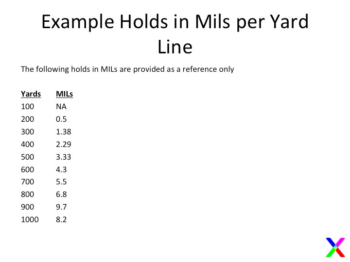

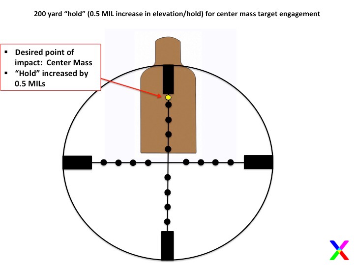

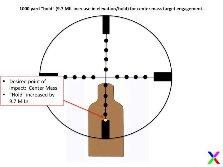

I will use the following EXAMPLE range data in order to demonstrate the technique. To note, your range data and holds may differ from those used in this example.

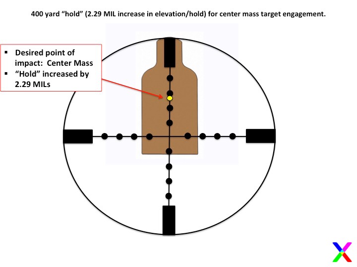

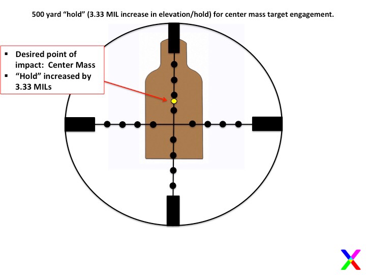

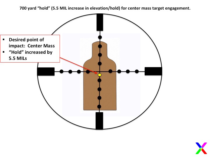

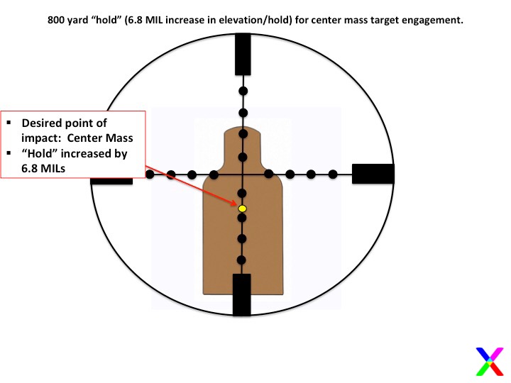

TAKE-AWAY
Does this solution solve all of the issues of range and elevation marksmanship? No. Not at all. It does however provide a means to engage a target from 100 yards to 1000 yards without having to dial on range.

What if I don't have a reticle with the thing that goes up? Am I out of luck?
I think that is possibly referred to as a vertical stadia line. I could be incorrect. And unfortunately, if you do not have one, then it would be very difficult if not impossible to utilize this TTP as there are no visible reference points.
-Krieger
Reactions: rlsmith1

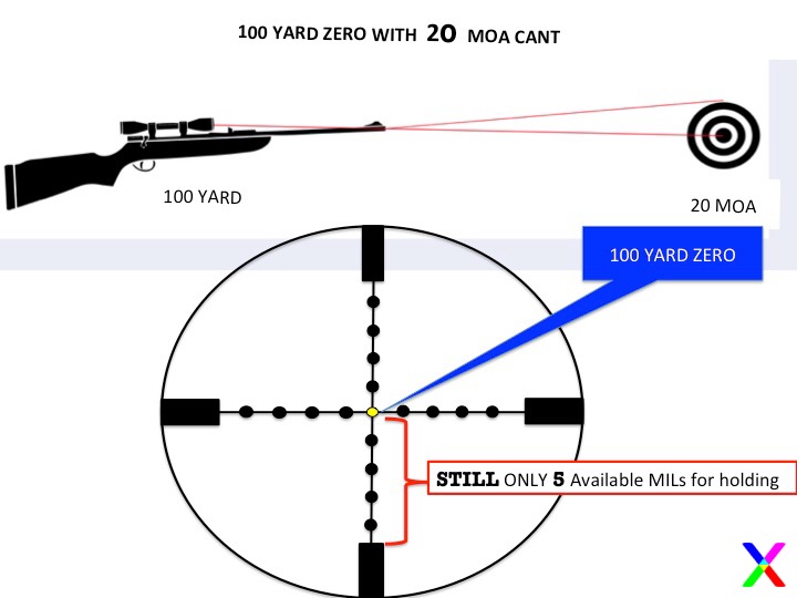

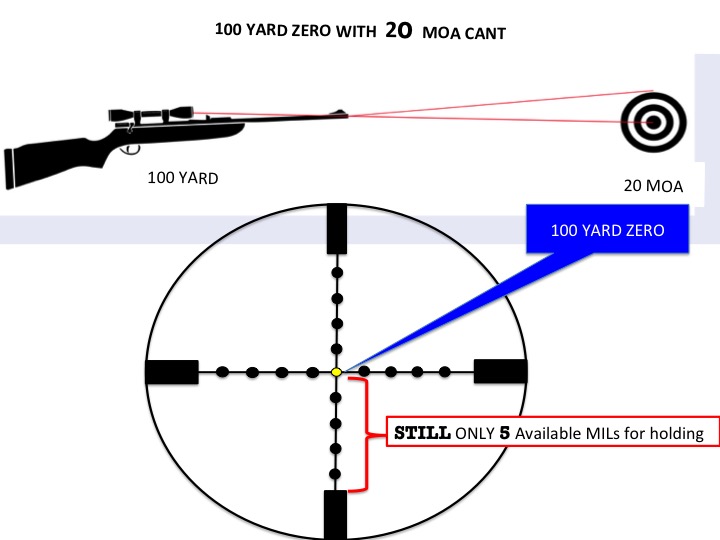

@Krieger_Tactics or you could use a canted mount.
You could use a canted mount. But if your 100 yard zero is centered on the cross-hair, you are still only able to employ 1/2 of the available elevation of the scope's reticle.
As well, if the marksman did not know of your option and has already purchased their rifle, scope and mount they would have two options:
Option 1. PURCHASE A CANTED SCOPE - AT ADDITIONAL COST.
(A) Purchase another scope mount which would result in additional cost.
(B) They would also then have to remove the rifle scope.
(C) They would have to take the mount off.
(D) They would have to put the new mount on.
(E) They would have to mount the scope again.
(F) They would to reestablishing the level of the scope.
(G) They would have to re-zero the scope, which would leave them with an un-zero'd scope until this occurred.
(H) They would also have to decide what to do with the old scope mount; Sell it? Keep it for a rainy day? Discard it.
Option 2. APPLY THE TTP AS PER THE POST
(A) They would have to...re-zero the scope
(B) The scope would go from their current zero to the re-adjusted zero in minutes as opposed to days, weeks or months as in option 2.
(C) There are not parts being unused.
(D) There is no additional cost in this option.
-Krieger

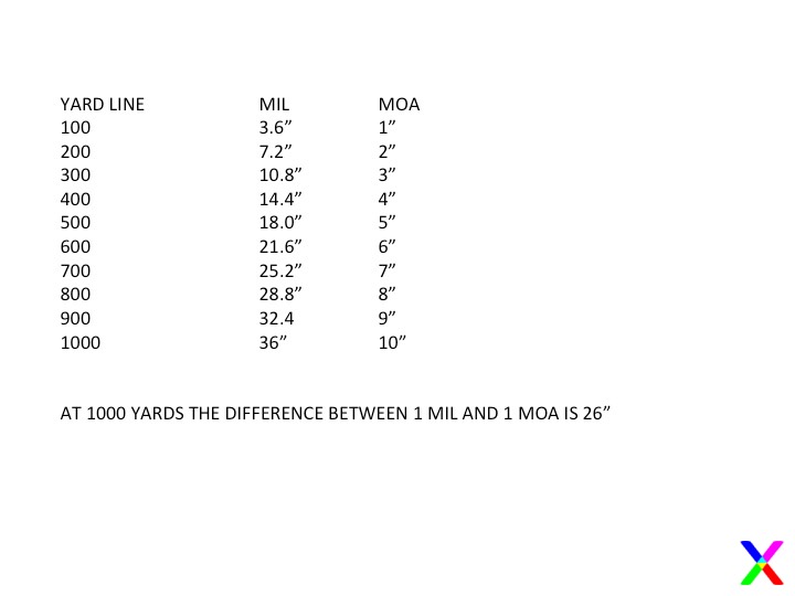

I beg to differ. Please feel free to provide graphical information to disprove the following:
As is graphically demonstrated, it is nigh impossible to utilize the MIL dots or vertical stadia above the center crosshair for holding at a range greater than 100 yards when the 100 yard zero is established at the center cross hair.
-Krieger

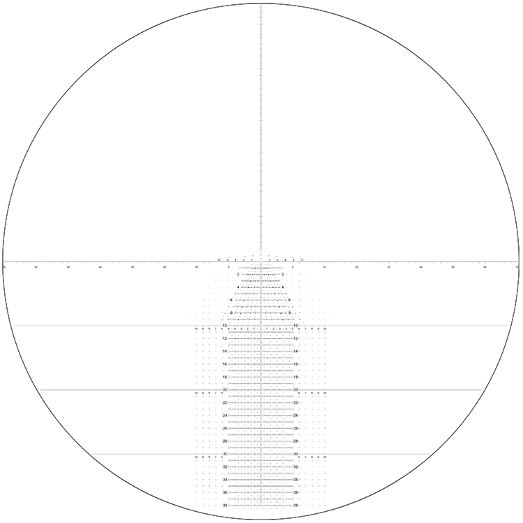

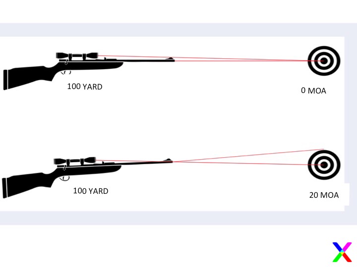

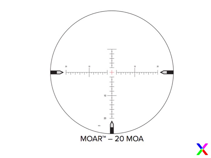

The idea is the 20moa rail is to get adjustment inside the scope to start all the way down. So it still lines up with the target and the barrel, but the interior adjustment is all the way down/up so you can use the full adjustment to dial up/down and you aren't starting in the middle of the adjustment range within the scope.
Holy shit. It finally makes sense. This is actually Todd Hodnett. The poor man’s horse. Of course!!! I mean let’s ignore the fact that we have reticles with 20 mils below the center and use an old ass mil dot reticle and zero at the top instead of the center where the best optical clarity is.
How could I have missed this all these years.
Reactions: Baron23
Please send me the name, not a link, but the name of the scope that has 20 MILs of elevation below the center cross hair.
-Krieger
I don't understand what you're stating, but I would like to.
In order to assist me in understanding, where in this scope that is utilizing a 20 MOA rail is the 100 yard zero?
Is the 100 yard zero at the center of the cross hair?
-Krieger
It's fucking obvious you understand neither how a scope's internals work nor what a longitudinal inclination of the mounting base does to mechanically shift the zero point inside the scope.
Yes, the 100 yard zero is still on the center of the reticle when you mount the scope on an inclined base. No, that 100 yard zero is no longer at the MECHANICAL center of the erector system.
Take your obsolete knowledge and GTFO
Nightforce MIL-XT
Well, I can provide some insight.
1. The post discusses MILs not MOA.
2. To note the difference between a MIL (which this and my other posts are discussing) and an MOA is 2.6 inches at 100 yards and grows exponentially with range. In fact the difference between just one MIL and one MOA at 1000 yards is 26 inches. Please see the attached graphic.
3. The Nightforce MIL-XT has 20 MOA of elevation below the center cross hair. It is NOT graduated in MILs. Please see the attached image.
4. The question I asked was what scope has 20 MILs of elevation below the center cross hair, not MOA.
As I asked earlier by chance are you able to provide the name of a scope that has 20 miliradians of elevation below the center cross hair?
-Krieger
-Krieger
What?
The MIL XT is a MIL reticle. It’s in the name. MOA is gay. It even rhymes. The reticle you attached is the MOAR which is an MOA reticle.
You should also check your math on how many inches are in 1 MOA at 100 yds.
Edited to add....I have a Nightforce ATACR 5-25 sitting right here (C579 model witha MIL-C reticle), i can see 27 mils below the dot.

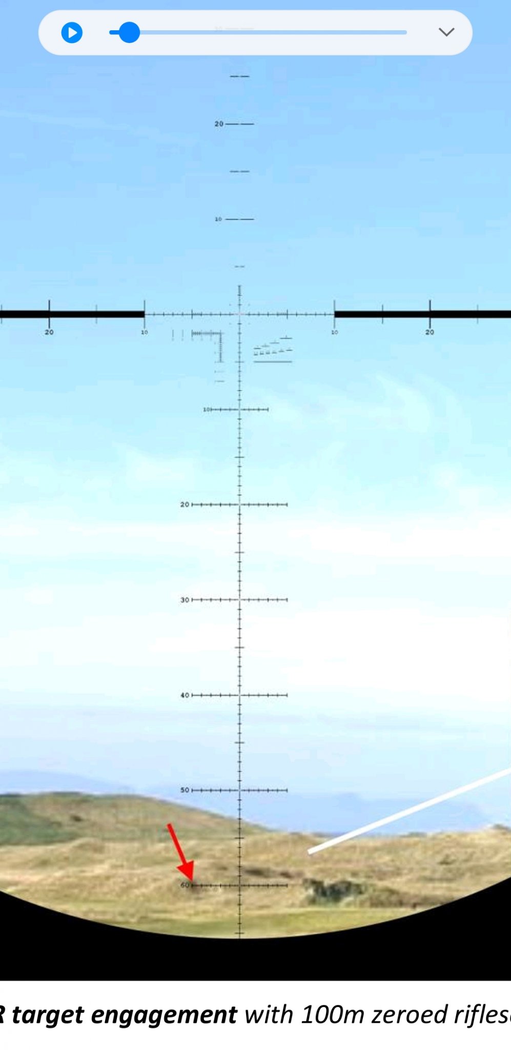

Horus H59 reticle has over 35 plus if I remember.. so NF ATACR, NF BEAST, Houston Scope, Leupold has thr Horus and many others
From the Horus website:
"Due to popular demand, the legendary H59™ is now calibrated in Minute of Angle (MOA)."
We're looking for a reticle graduated in MILs. Reasons being, please see above post re difference between MIL and MOA in measurable distance.
The Horus Tremor 3 only has 17, MILs, not 20. I didn't look the others up.
Point being, even if it had 20 MILs of elevation below the center line, which it does not, you would still have about 9 MILs of elevation ABOVE the center line that you're not harnessing, but you could if you.... reestablished your 100 yard zero above the center cross hair.
-Krieger

You are indeed correct.
From the following website: https://www.nssf.org/shooting/minute-angle-moa/
A Minute of Angle (MOA) is an angular measurement.
A MOA is 1/60th of a degree.
1 MOA spreads about 1″ per 100 yards. (actually 1.047″)
In Long Range Precision Marksmanship everyone I know rounds down to 1 inch.
-Krieger
-Krieger
Actually, its offered in both, MOA and MILS but nice try. I also have an H59 in an a Bushnell scope sitting here. Its in Mils.
-Krieger
my mistake. I mis interpreted that you were showing the difference at 100 not saying 1 MOA is 2.6 at 100. thats my mistake. the rest is true. you are showing an MOA reticle which the MIL-XT is not. the MIL-C is not. The H59 can be had either way. my SKMRs are MIL everything is MIL. You keep using the mil dot reticle in your examples. no one uses those anymore. not competitivly and not tacticaly (except some police agencies because beuracrats are idiots). If you want to gain credibility you need to use modern examples and modern technology. We have learned a lot since the ML/MOA reticle/turret days.
-Krieger
Different model, the original is MIL:
As to Tremor 3, 17 MIL at maximum zoom (iirc 20ish, at 35x it would be ~ 7 mil), the scale extends down so far you most people can't even clearly read it at minimum zoom.
image-png.6940242
Reactions: waveslayer
-Krieger
Lol! Are you serious? H59 is in Mils. By popular demand it's now offered in MOA. I'd give up if I were you. Save some dignity
