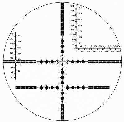

USE OF MIL DOTS
MIL dot reticles can be utilized to measure objects, estimate range, measure for corrections of round impacts, etc. For those who may not be familiar with the MIL dot reticle, there is one depicted in the first slide attached to this post.

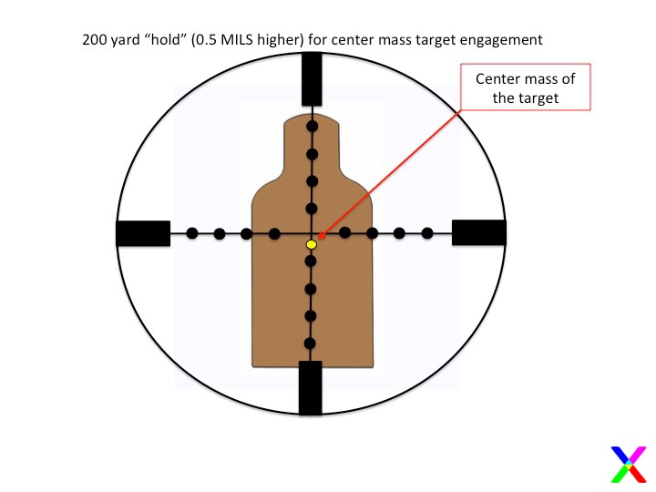

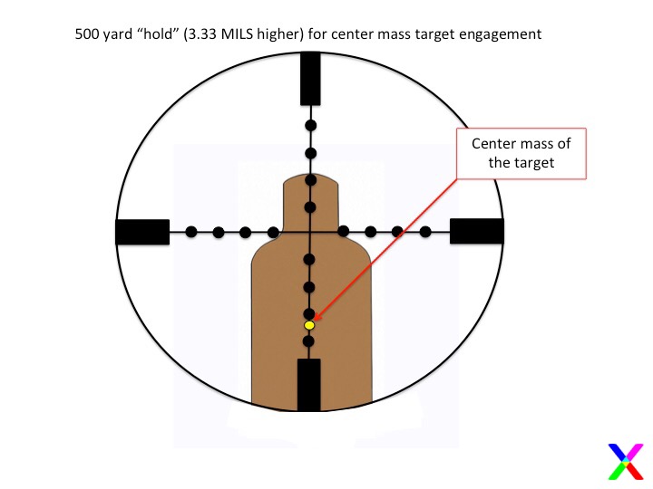

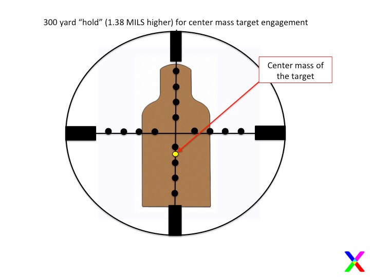

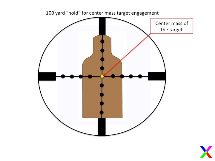

Once the marksman has determined the distance to the target the marksman can utilize the Data On Previous Engagements (DOPE) that has been gathered and recorded in the marksman (sniper in military terms) log book in order to identify the MILs that must be “held” off of the center cross-hair in order to allow/bring the bullet onto the center of the target.
An example of this process is captured below in writing and in the visual aids attached to this post.
Based on a example .308 175-gr trajectory for the M118 (which I used many years ago) a marksman would apply the following MIL holds for a 100 yard zero (https://www.snipershide.com/.../specifications-for.../)
METERS: 100 MIL HOLD: 0.0 point of aim/point of impact
METERS: 200 MIL HOLD: 0.5 higher than center mass/ desired strike of the round
METERS: 300 MIL HOLD: 1.5 higher than center mass/ desired strike of the round
METERS: 400 MIL HOLD: 1.95 higher than center mass/ desired strike of the round
METERS: 500 MIL HOLD: 2.9 higher than center mass/ desired strike of the round
VISUAL EXAMPLES
Slides 2-6 provide a visual graphic of the "holds" as noted above. The center of each target is identified, as well as the location of the cross-hair as it is being held in order to demonstrate visually how each subsequent range necesitates a "higher" hold. These graphics provide you with the ability to note and understand the "holding" process described above.
To note, I created these graphics utilzing powerpoint and thus they are not 100% to scale, however I feel that they are close enough to accomplish the intent here - which is to provide the reader with the ability to visually identify the holding for elevation (range) process.

Mil-dots are soooo 2007. We all use this reticle here, so can you explain how you would use it in real life?
Also, what kind of rifles were the two shooters using? Caliber? Scope?
Hello again TheBigCountry,
I appreciate your query. I have no idea how to use the reticle that is pictured in your response.
If you are asking me to explain how to use a MIL dot reticle in real life, I will be providing that information in subsequent posts.
The other rifles were both Remingtons... One was a 6.5 creedmoor and the other was a .308.
