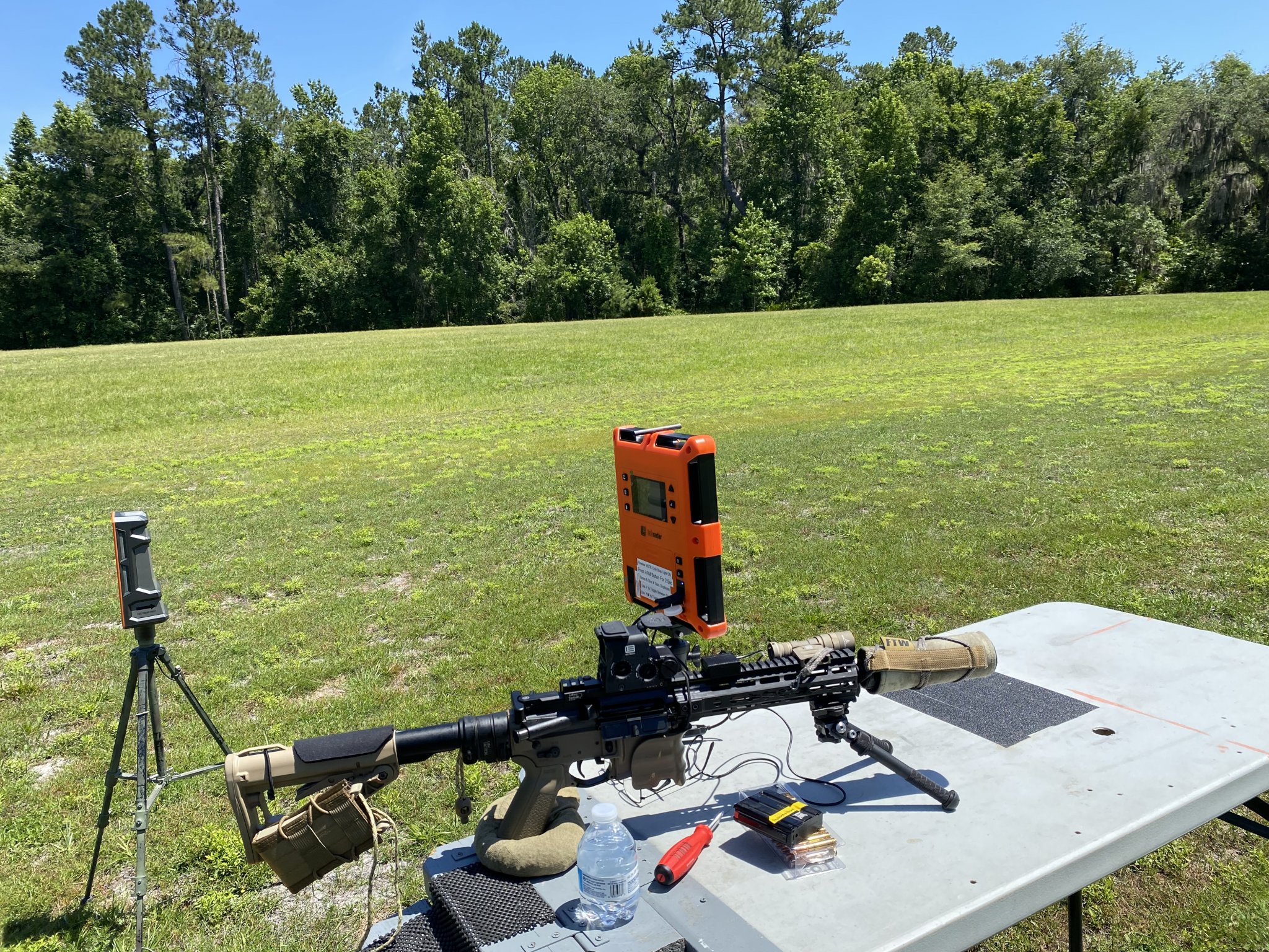

What annoys me about the Labradar is it's sensitivity to any structure downrange. This is a range I sometimes use, but it won't reliably track bullets. Sometimes it does, sometimes it doesn't. It's 100M with a hanger starting 50 metres downrange with a bullet trap at the end. Some guys have resorted to using the old Chrony. I'm open to any ideas that might get the radar to work.

Tried lowering the output power?
Yes (have the model with both high and low power)
I've been thinking about the vertical eliptical bias in the emitter. I might try a manfrotto tripod and have the radar at right angles above the scope/barrel. So the beam is wider than it is vertical.

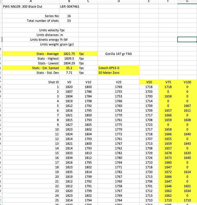

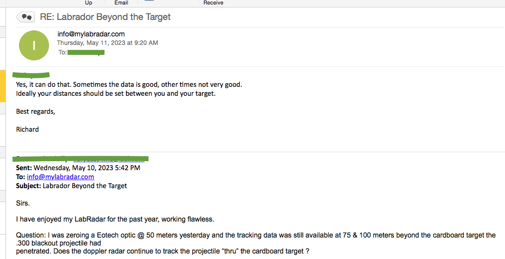

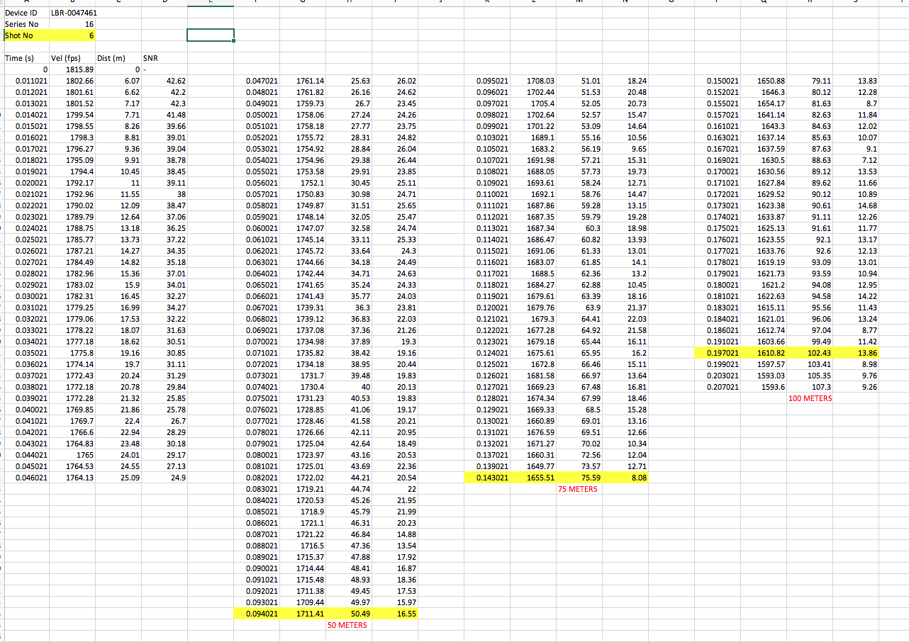

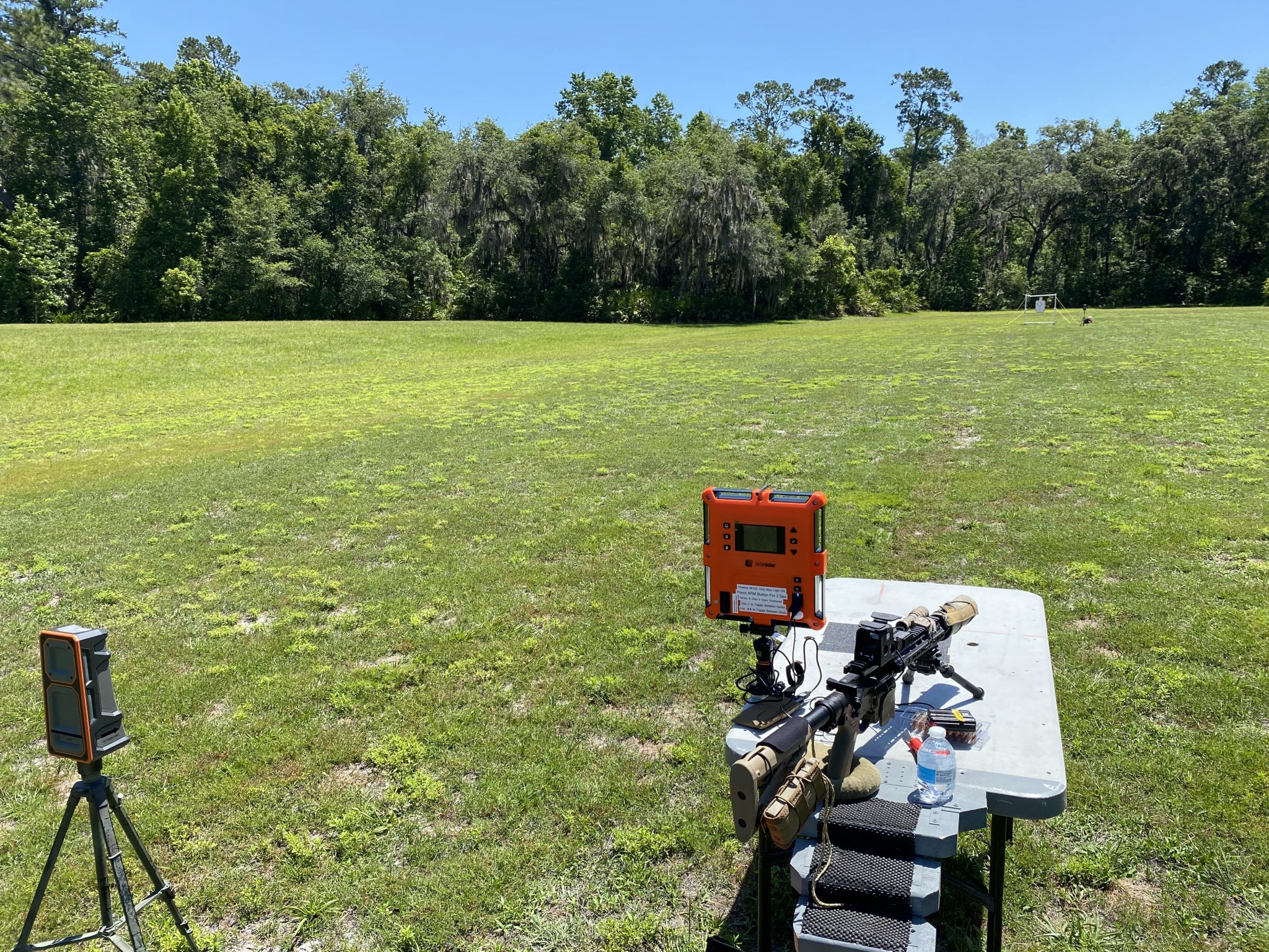

I don't think it is so much a matter of confounding the velocity measured, it's measuring time of flight from the reflections off the bullet. More getting the unit to "accept" that a reading is the tracked shot and not noise. On a "quiet" range my unit typically gives it's first reading at 6 yards for slower projectiles and 19 for faster. Their guide state 25 meters minimum target distance for best results, IMO that's a misnomer and is more the backstop distance if a non-reflective target is used (wood/paper).
As an example here's one with a target frame at 50 yards and I had tracking to 189 yards (on a 200 yard range) with .22 LR
Time (s)Vel (fps)Dist (yd)SNR

This far exceeds what they claim it can read a .22 at, but it's a good range and the conditions that day were exceptional.

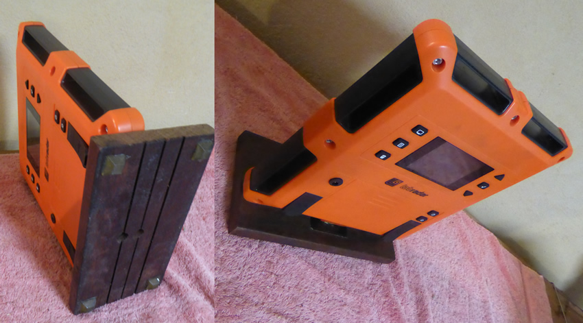

For a sturdy stand when shooting off a rest I use a piece of hardwood with rubber feet glued at each corner. It gets the radar down low so it's level with the muzzle. More of the stand is to the front is so you can push the buttons without it tilting forward. I leave it permanently attached in the carry box to save time setting up. Labradar's screw to hold the plank is the standard, 1/4"x20.
It doesn't shift on the bench when I shoot 6.5 and if it did I'd probably weigh it down with some lead sheet. Thinking you could probably do the same with your tripod; wrap some roofing lead around the legs.

I was zeroing a Eotech XPS3-0 @ 50 meters mounted on a PWS Mk109 .300 BO. The LR has tracking data at 75 & 100 meters. Could the doppler really be obtaining data 25 & 50 meters beyond the hole in the target ?
IMG_7088PWS Mk109 .300 BLKO Eotech Zero 50 Meters Cracker Swamp 05.08.23  copy.jpg
IMG_7089PWS Mk109 .300 BLKO Eotech Zero 50 Meters Cracker Swamp 05.08.23  copy.jpg
The #6 shot in the Series is the first to track 75 & 100 Meters. I still think its improbable that the device can track the projectile thru a 0.30" hole for an additional 50 meters while the projectile is continuing to drop below the axis of the hole in the target!
The #6 shot in the Series is the first to track 75 & 100 Meters. I still think its improbable that the device can track the projectile thru a 0.30" hole for an additional 50 meters while the projectile is continuing to drop below the axis of the hole in the target!View attachment 8138746
Isn't through the hole, is through your target if it isn't radar reflective.
I find if you set your longest radar distance slightly less than the target it is way more effective than setting it at the same distance as the target. So if the target is 100, set it at 90 - the target then is not structure interference.

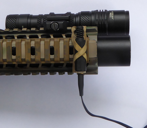

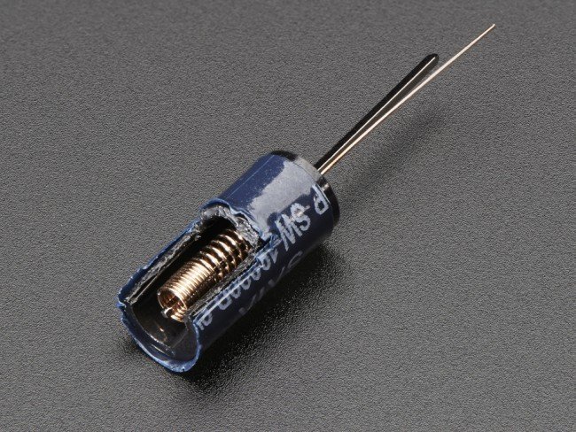

If the Piet is held against the gun with Velcro then maybe adding a tight elastic band will hold it firmer so the recoil is not dampened by the Velcro. If there is no vertical jump with your heavy gun then it does not matter if it's forward nearer the muzzle, or back on the scope or action - but in your case the attitude of the switch important for it to function at its most sensitive.
With the Piet in a rectangular plastic case if you cannot open it to see how the switch is oriented, you could play around with it and figure it out that way. Shake and flick it with your finger at home while watching the orange light going off and on registering shots. Figure out which attitude of the switch is the most sensitive to movement. Then fix it to your gun along the line of recoil that way.

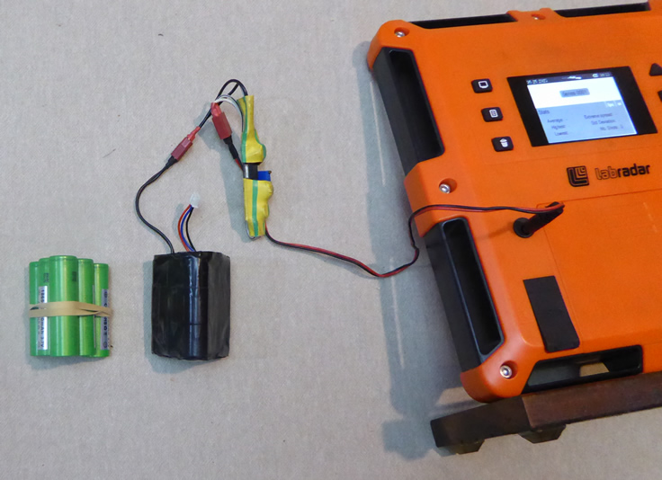

Panasonic Eneloop AA NiMH batteries are 2Ah and give 1.2V each. The radar's compartment is configured 3S2P (I have opened it up), so six Eneloops give 4Ah and 3.6V. You can get Eneloop Pro's which have a slightly higher capacity, 2.5Ah each but they are all only 1.2V. At 3.6V total the current draw by the radar could be higher to compensate, meaning their drain will be quicker than an external battery, or it could be that the radar is not as powerful at the lower voltage. 6xAA Eneloop's are about $20 with charger. NiMH is old technology and long since replaced by Lithium which is more energy dense.
Labradar's external lithium battery is 10Ah and provides 5V. Their $25 battery is more than double the grunt of using Eneloops.
Everyone has the radar emitting for different times so it's difficult to compare. But external packs have so much power that you may as well set the auto sleep timers to the longest and enjoy. And much cheaper than using the internal compartment.
I use an external Li-ion pack made out of 6 Samsung laptop batteries configured in 2S3P, giving 9Ah and 8.1V. It is regulated down to 5V (the yellow thing in the photo) so it doesn't cook the radar. And yes, like others with external packs I don't have to recharge it for several sessions. External packs are definitely the way to go.
