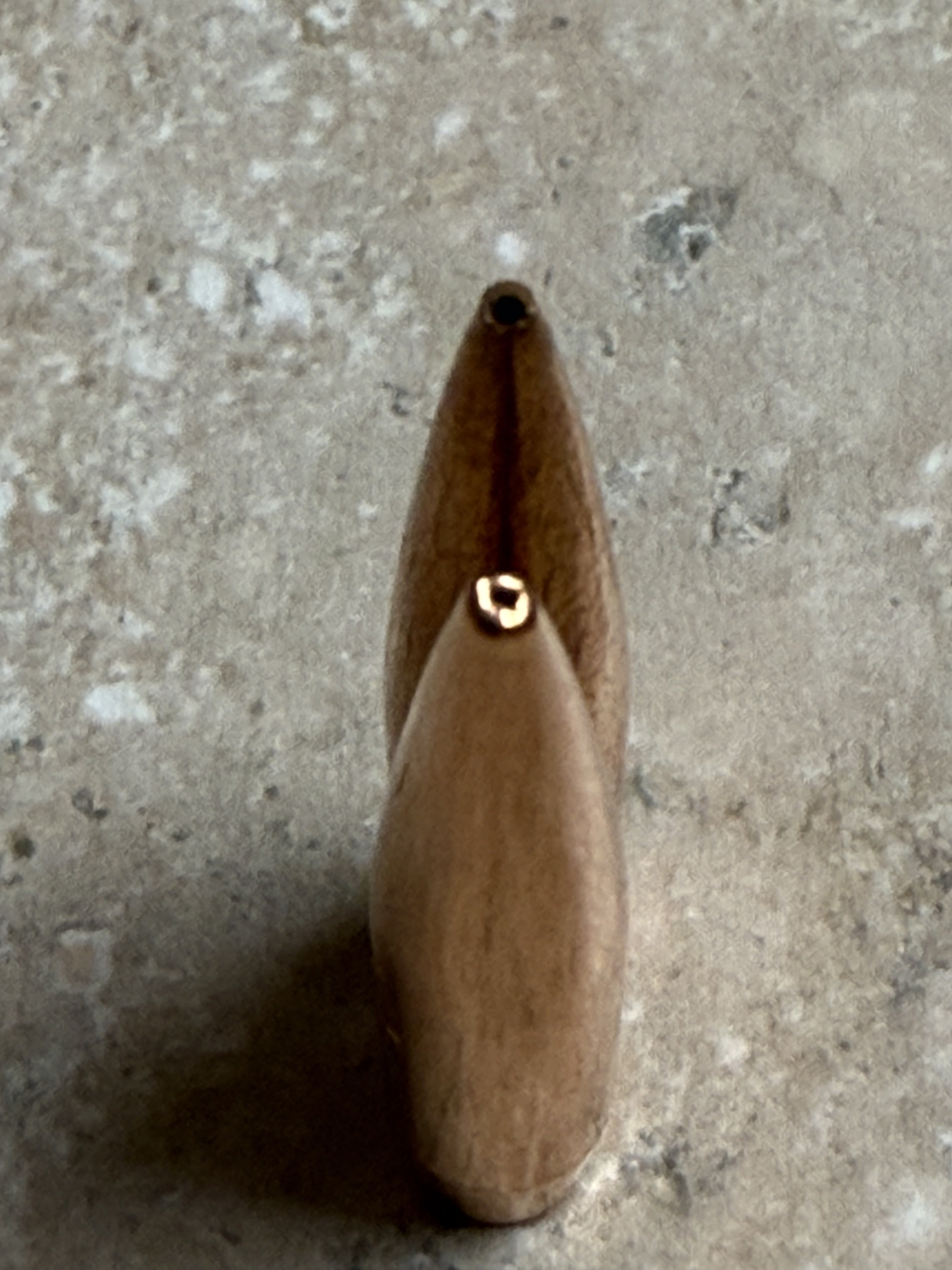

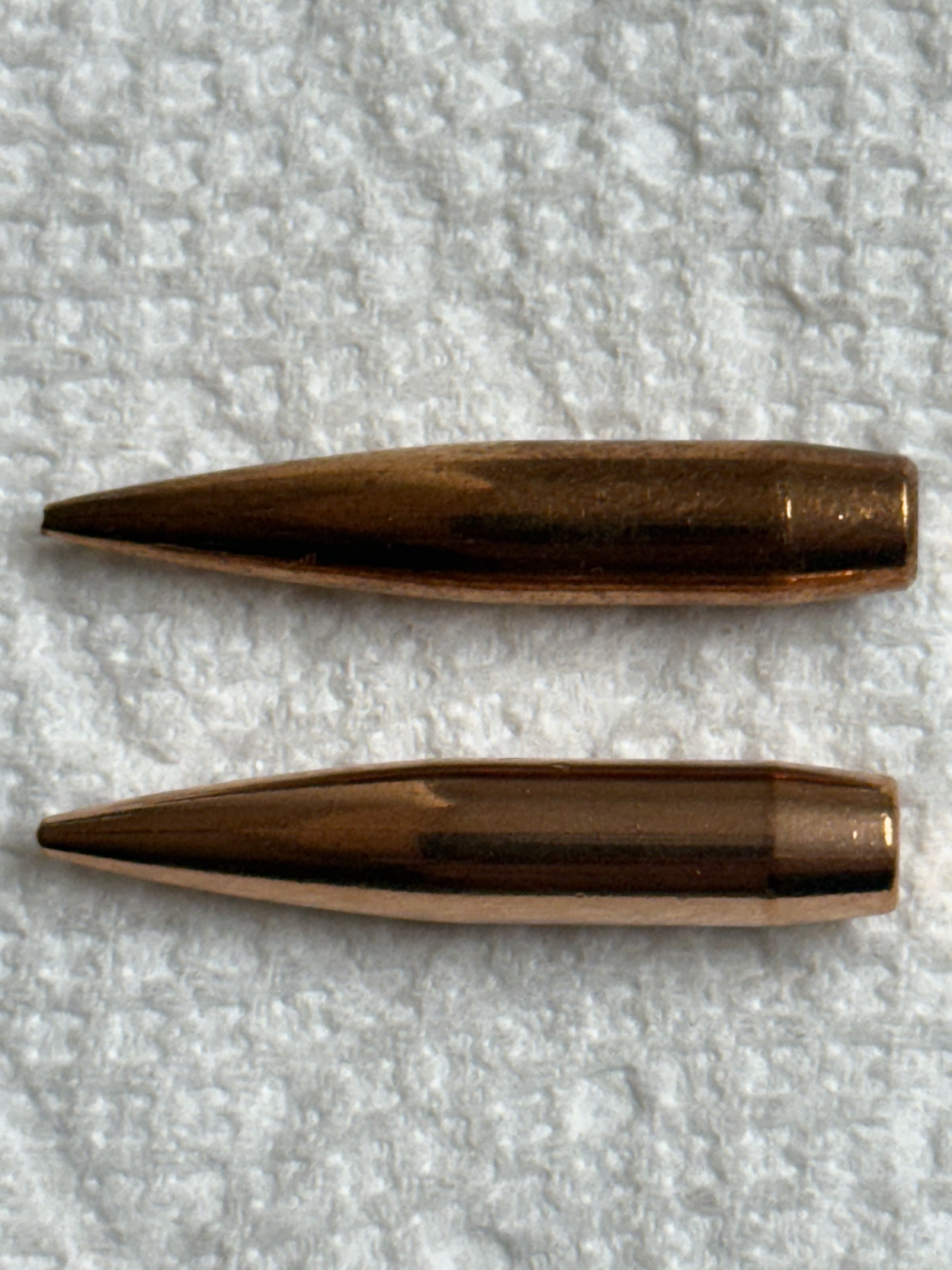

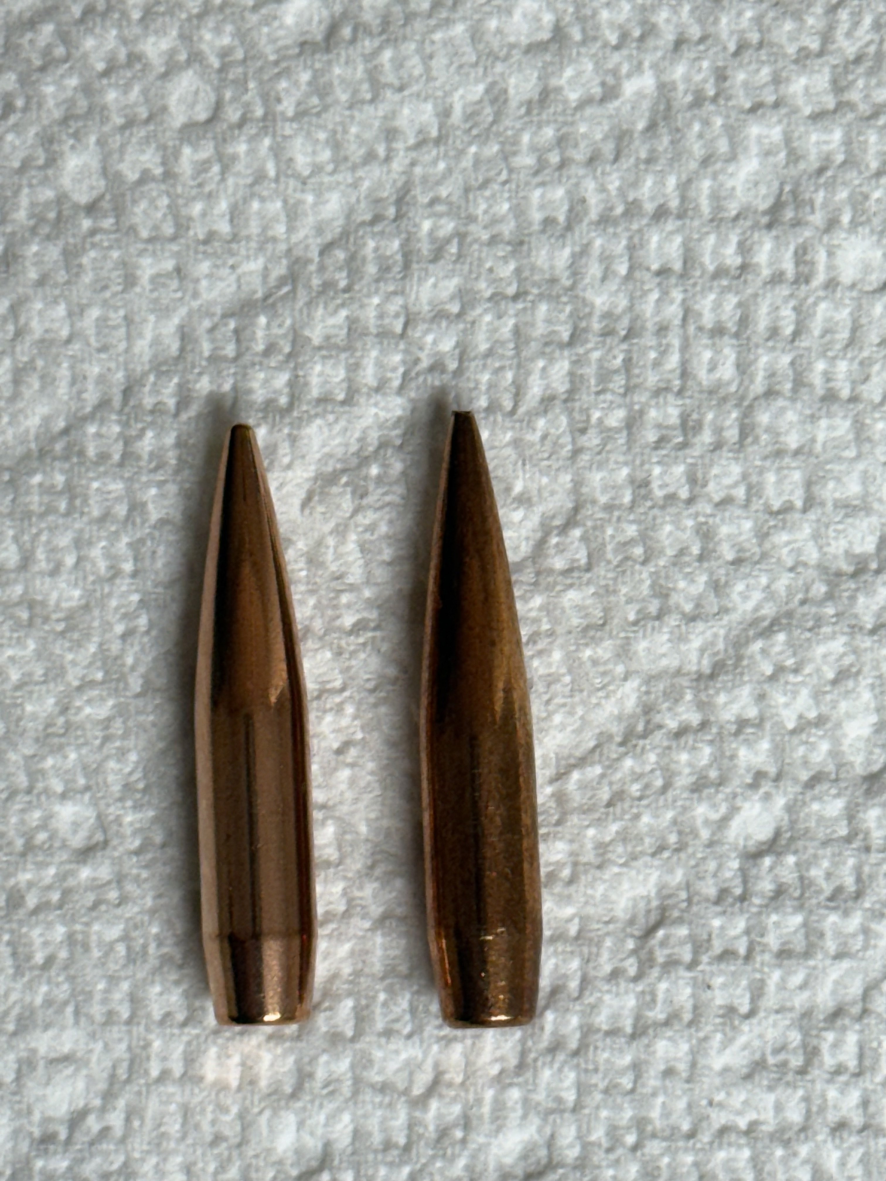

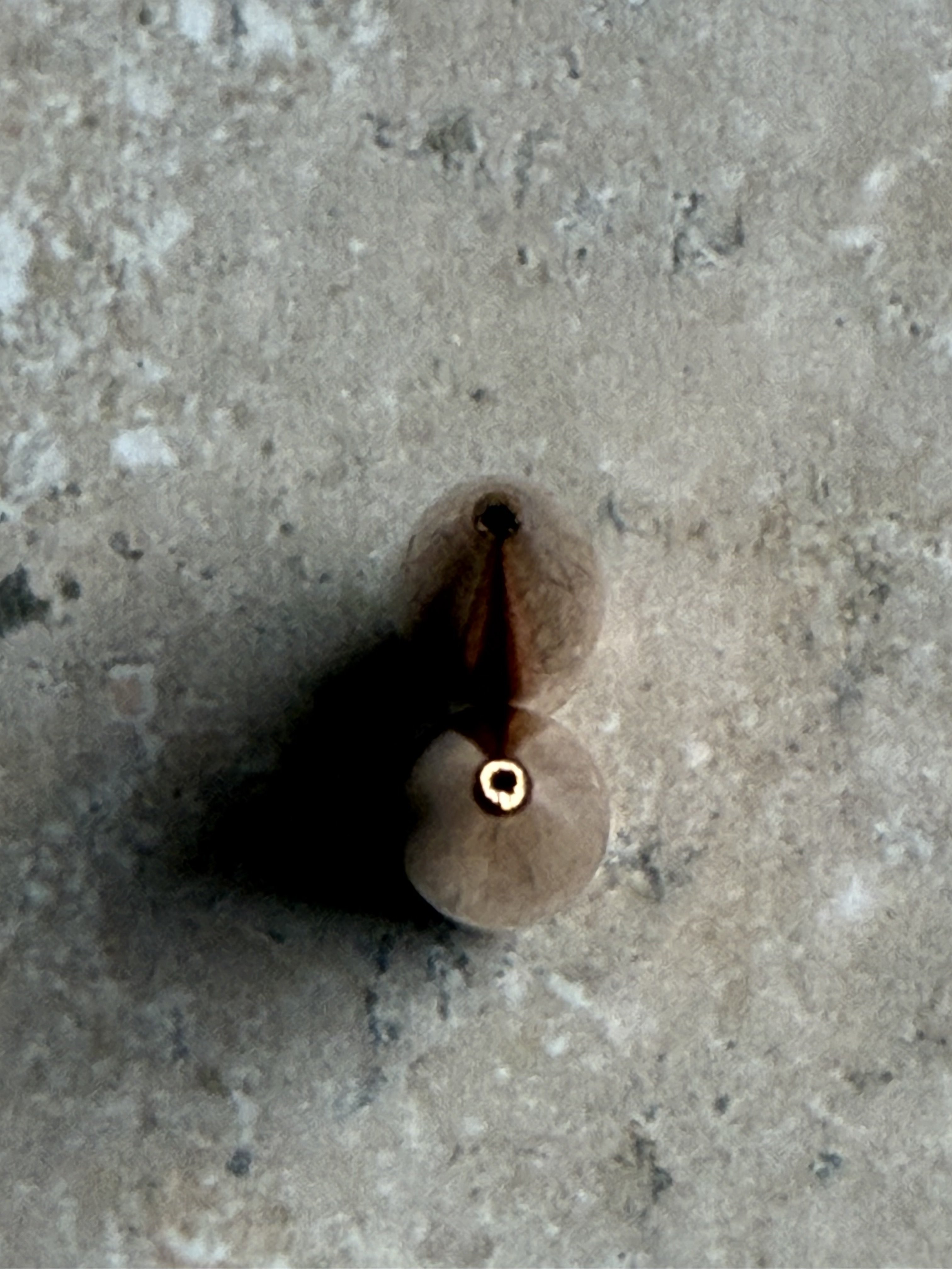

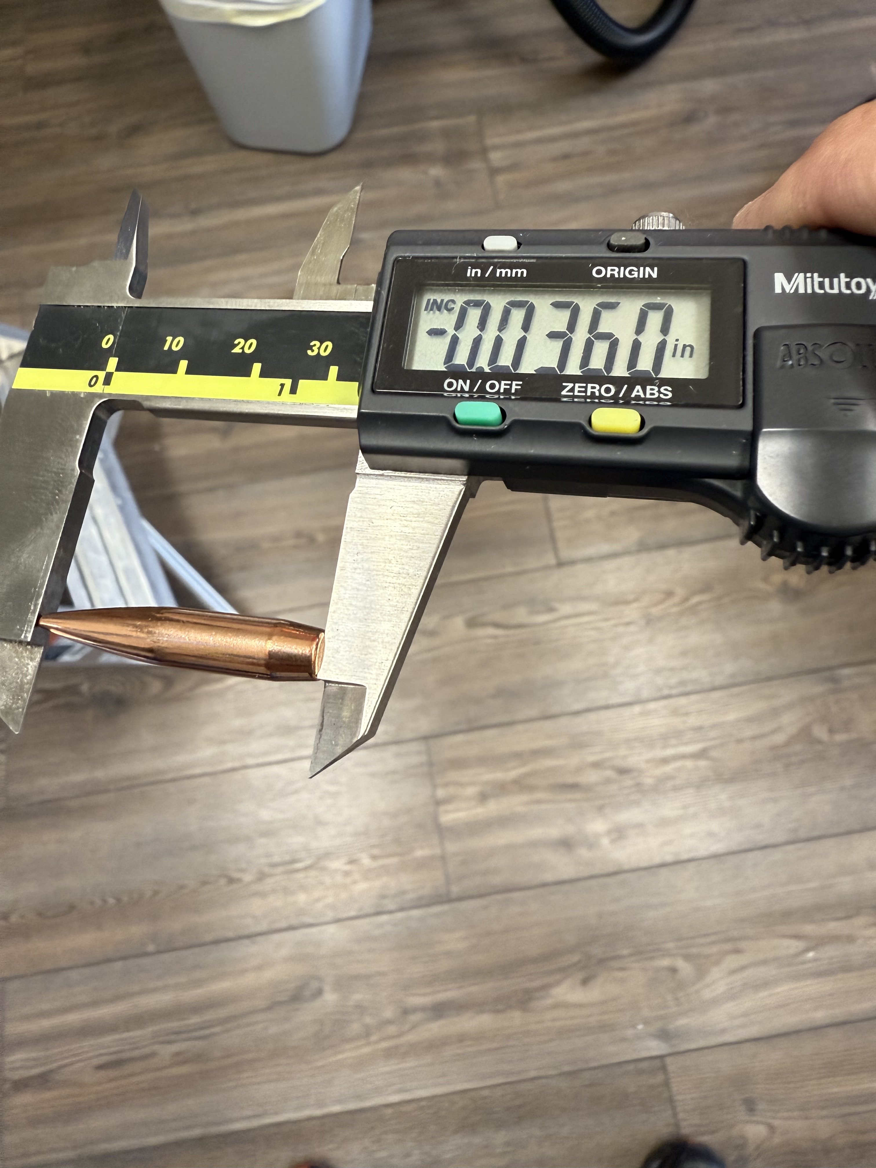

The Lapua is .036" shorter than the Berger 144 (which I measured at 1.412” and set zero on the calipers, note that Berger publishes 1.413” OAL so this one was very close). The boattails appear to be about the same and the profiles about the same. The tip of the Lapua is opened less than the Berger but this was hard to photograph.
Excuse my iPhone photo skills. Lapua is on the left, Berger on the right. Or, Lapua on bottom, Berger on top if the pic is oriented that way.

Thank you for posting Cynical. What cartridge are you going to be shooting them from? Keep us posted on your results. I'm glad to see that the lapuas are actually a little shorter in overall length than the berger. I'm curoius what Bryan Litz gets for a BC when he tests these. Seems most bullets he tests actually have a lower bc than what the manufacturer advertises, except for the Hornady Atips, which he reports having a higer bc than advertised.

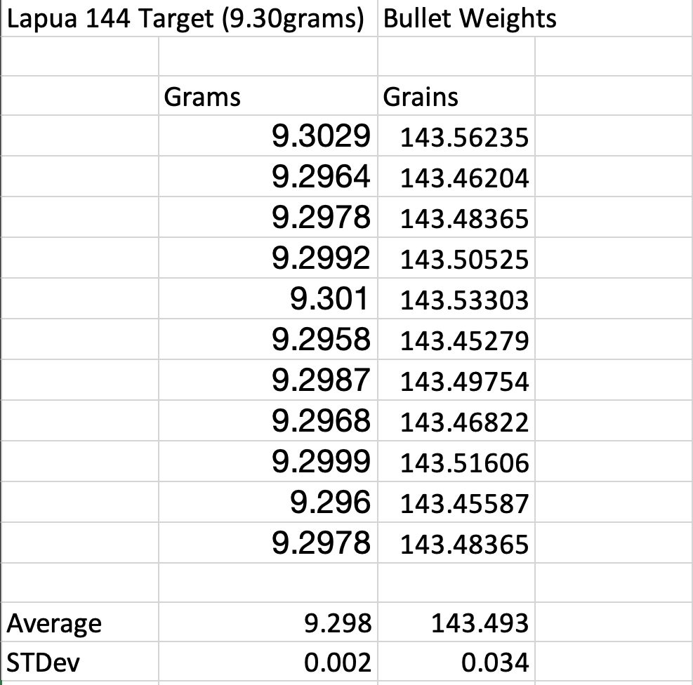

I just got 200 and ran a few over our labs analytical scale which is good to 1/10,000 of a gram.. These bullets are 9.3 grams / 143.5 grain so slightly under the 144, but I believe Lapua uses grams first and then coverts to grains.
Pretty tight weight ranges.. So far pretty happy.

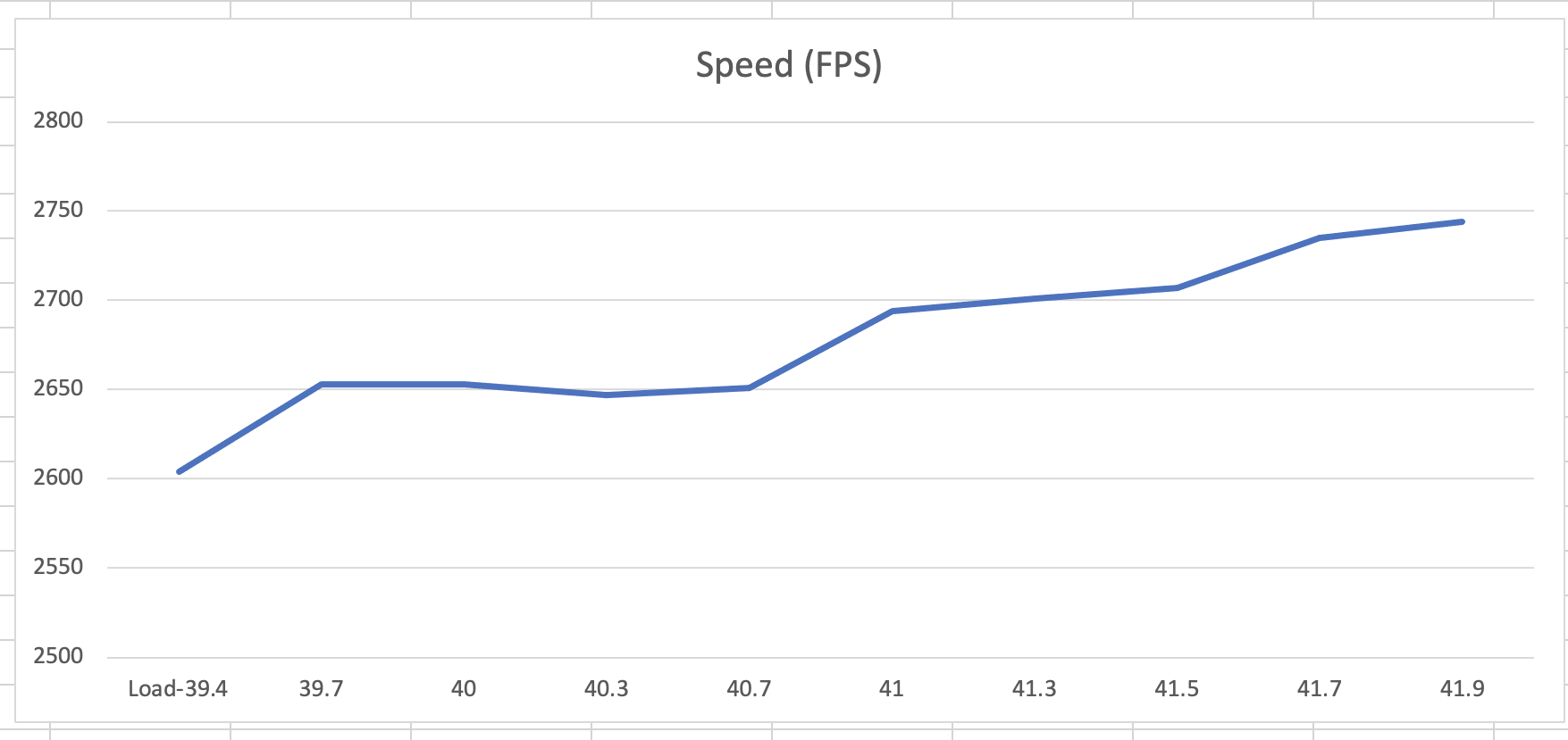

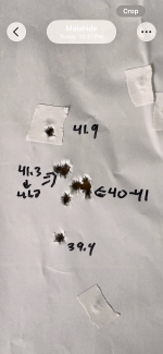

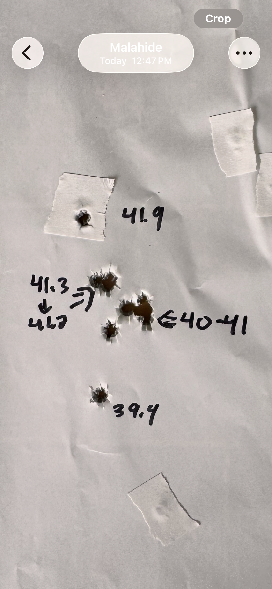

Okay so I managed to get some data.. Didn't get exactly what I wanted as the 300 range was closed today but got some velocity and 109yard ladder data.. Not great but I did identify a couple nodes.. One at around 2650 at 40-40.7 Poder Charge and one are 2705 at 41.3-41.5 Poder Charge.
I'll have to go back and do the ladder at 300 next week but I may load up some extra 41.4, 41.5 and 41.6 to try. Doesn't look like any signs of Pressure up to 41.9 which was mymax load.. There may be another node in the low 42 range as there was a big jump at 41.9 in velocity.

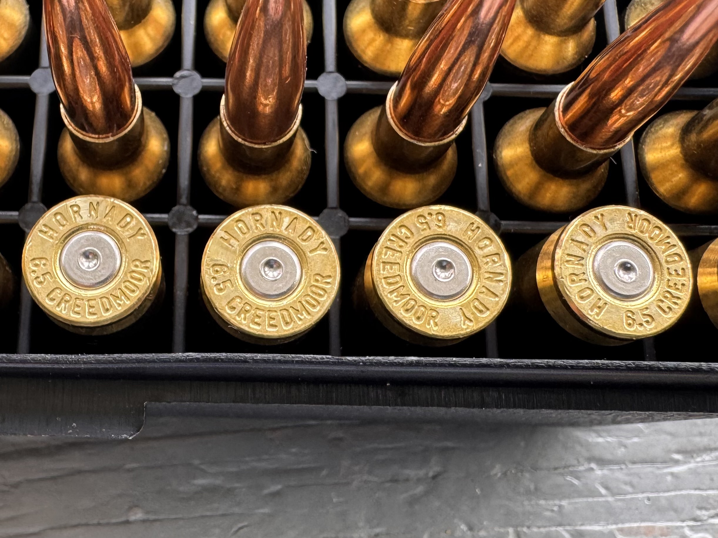

Also attaching cases of the last 4 powder charges in case someone can see something not good.

Trying not to open Pandora's Box on tuning based on "velocity flat spots", but in case I am doing you a favor I will say ignore that chronograph plot for now, and base your load selection after you see what the target tells you at the max distance you plan to shoot.
Running an Audette style ladder at close range can make interpretation tricky, so if at all possible run that test out as far as you can.
That vertical spreading at distance helps accentuate any potential evidence of a possible advantage versus noise due to typical shot dispersion.
There are never any guarantees with these low sample load development methods, but each style test has a few things you can do to improve your odds of finding a better or worse charge/depth level to go back and investigate.
Good Luck and in for the range reports.

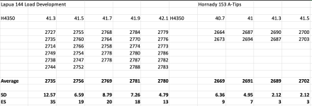

Tried the Lapua 144gr MRT in Bergara B14 Crest.
Showed better overall results from 50K psi load to 60k PSI load compared to a Lapua 136gr Scenar-L.
Tried 10thou to 30 thou seating depth steps with almost no change what so ever in group size.
Used VV N555, Lapua SRP, GM205 primers. Loaded at 2.840-2.860" COAL with 43.5gr N555 showed ca 58-60K PSI load with GRT @ 2620FPS over 24 shots with ES 18fps and SD 5 fps. 20" barrel length.

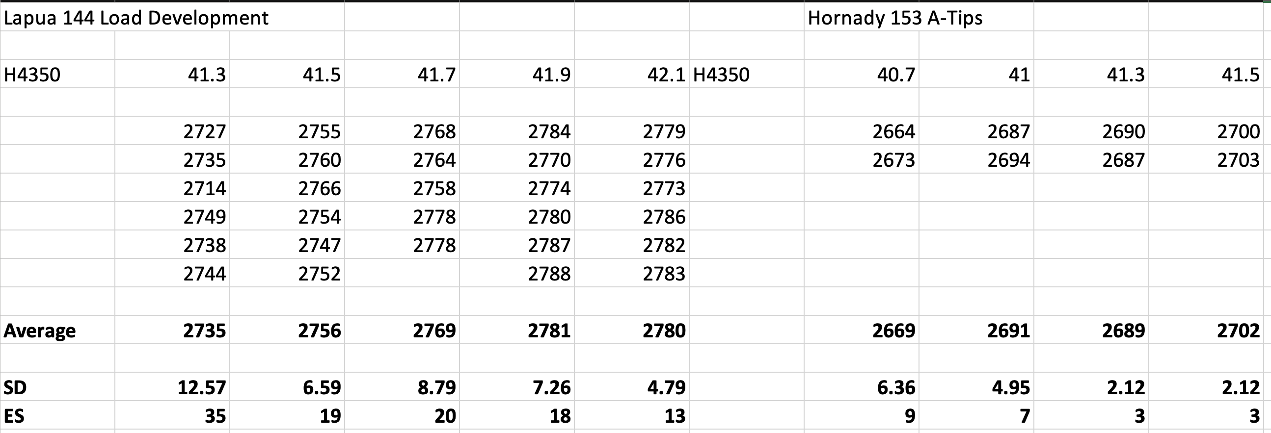

So I went back to the range with 6 loads of different weights with the Lapua 144 Long Range Targets.
Lapua Virgin Brass (Small)
CCI 450 Primers
H4350 Powder
330 Yards
0.015-0.017 Off the LANDS
I think I am going with 41.7 and 42.0 to do a 10 shot group and that should be good.. Not 100% happy with these as thats due to the fact I loaded a few rounds of the Hornady 153 A-TIPs and those shot crazy tight at end of session with hot barrell. I wasn't eve doing accuracy just trying to get velocities.
Any advice on the above plan> 41.7 and 42.0
Mike

I’ve seen new Lapua brass have more neck interference than I’d like, which has increased fps SDs for me & presumably could alter accuracy.
More than one way to skin a cat… but I’d load 5x 41.8gr, 5x 42.2gr & see where/how stabile those velocities are. I also wouldn’t hesitate to just run with 42.0gr next range trip & stretch that out to 600-800 to test for vertical dispersion
Those may shoot very well for you, but I would shoot more groups in the 41.0-41.4gr range
