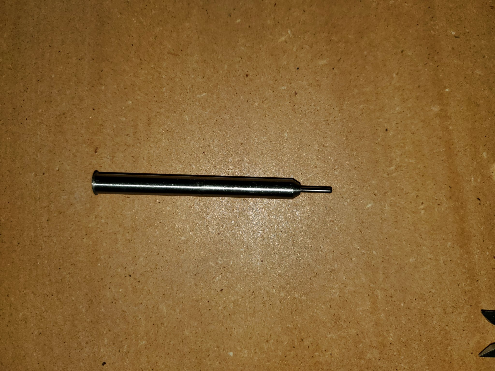

Anyone have a lee 223 collet neck sizer?
I have one that i use in the first position of my 550 to smooth out the neck burs from trimming.
Years ago i removed the decapping pin and recently ordered a new mandrel....well.

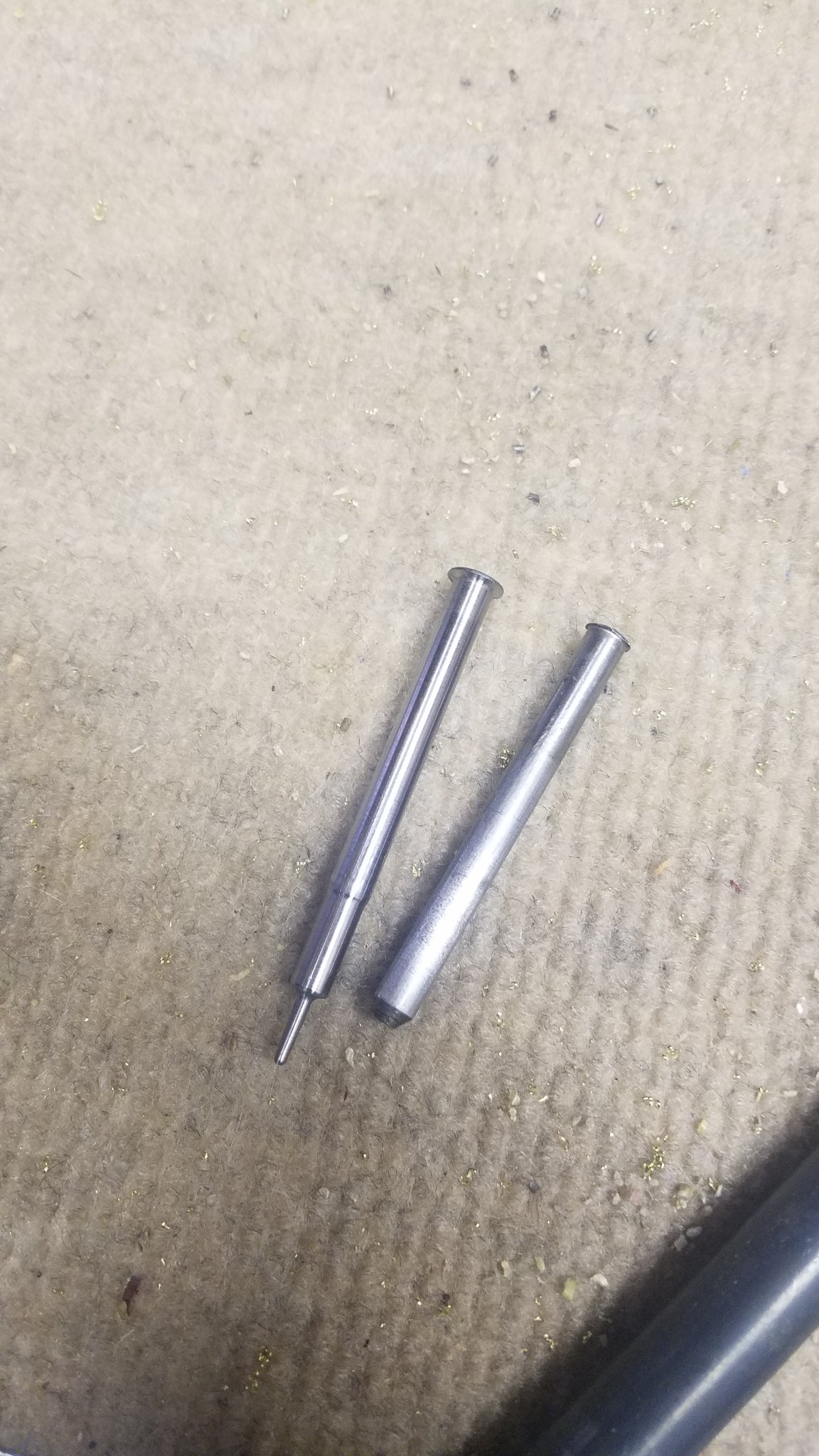

The new mandrel is .002 smaller than the old one and doesnt do the trick. My old mandrel is also non tapered and the new mandrel has a step machined into it.
Can anyone measure/examine theirs and tell me what they find?
Please and thank you
Shred

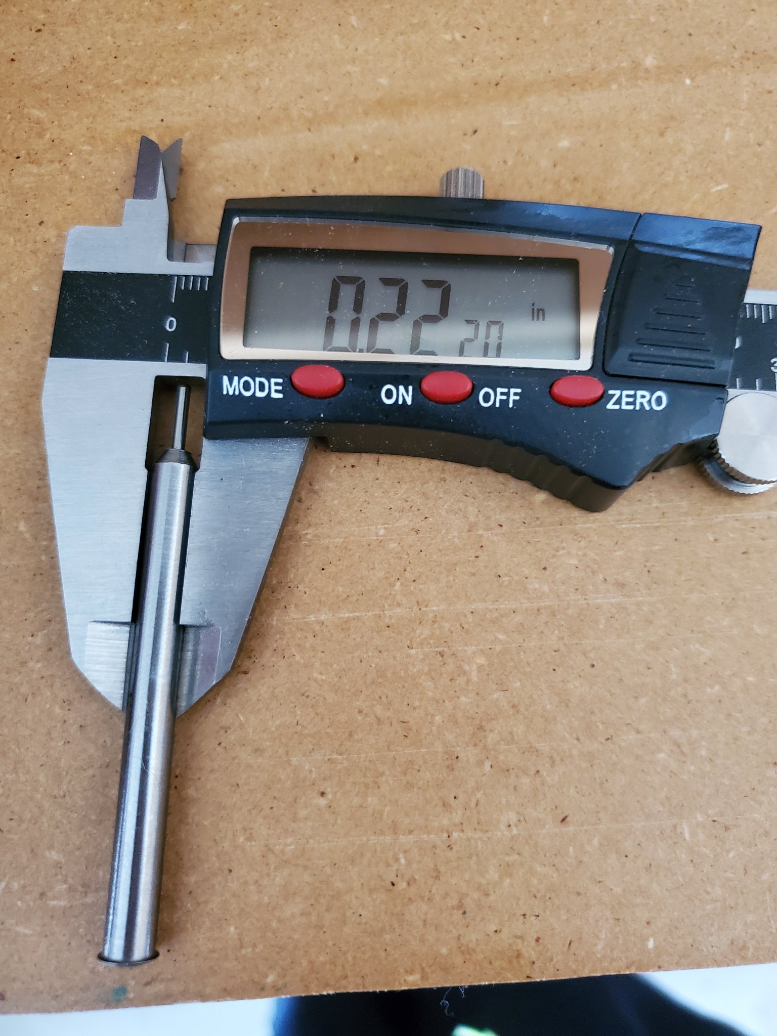

This one I've had for a while... .222 and no step
I dont really use it, if you have a problem getting one from lee, let me know, pay for the shipping and it's yours.

Cool. They might have sent a smaller mandrel by accident. I have several mandels formby 308 stuff. And they offer an undersized for 224 as well. Might load up an OCW or saterlee test to see what results you get with the smaller mandrel. You might be surprised
