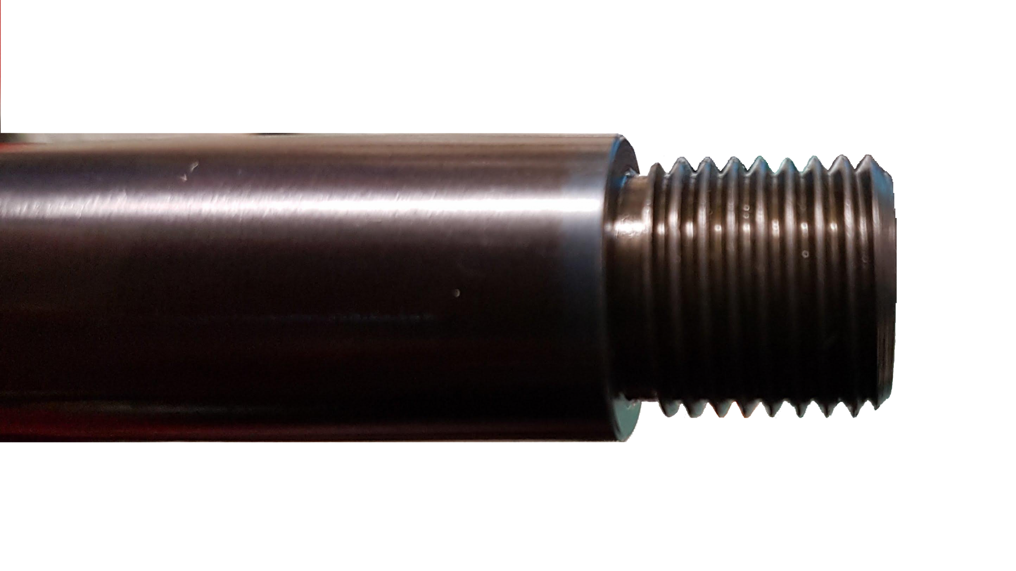

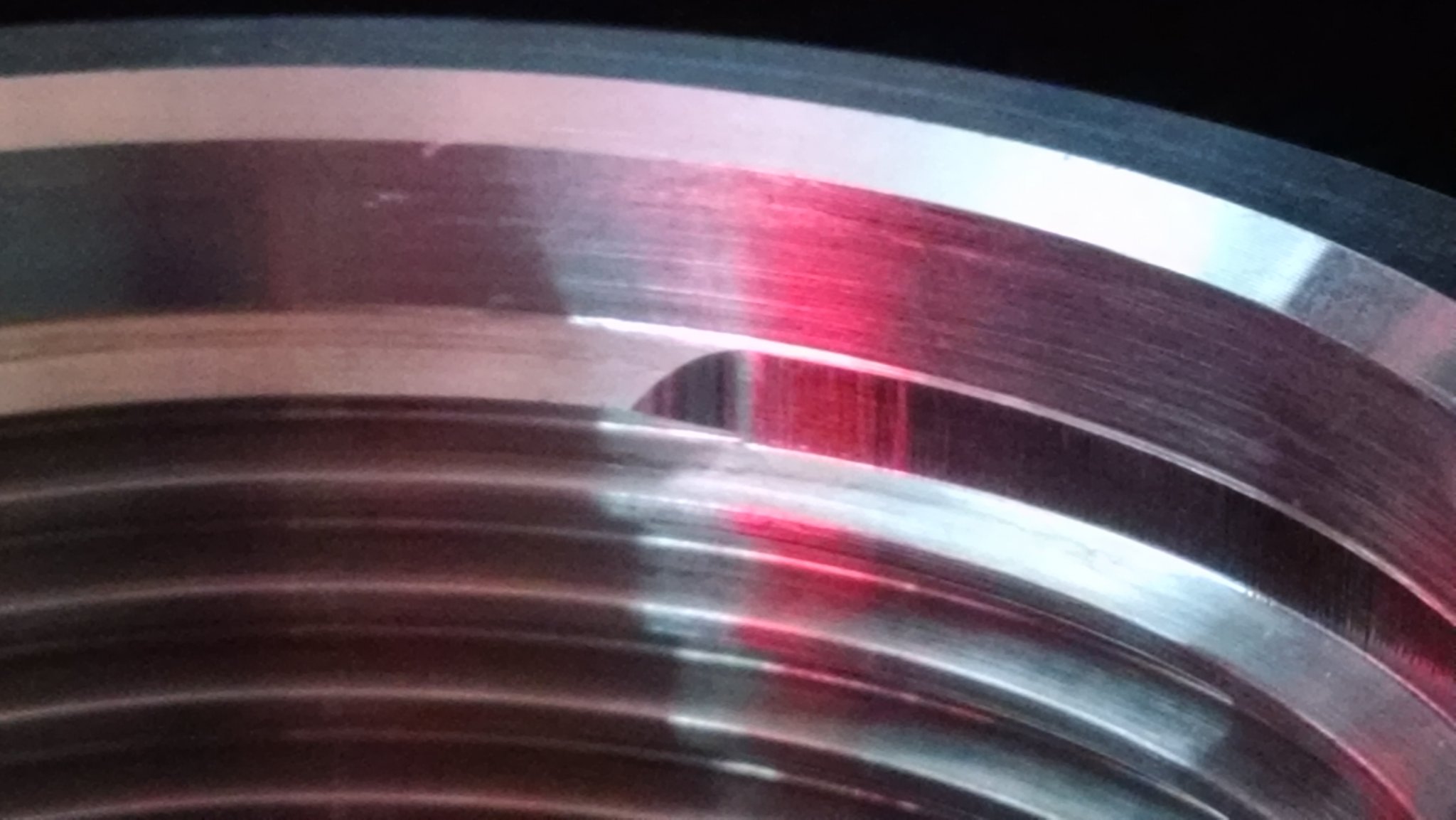

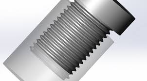

    There are different ways of making threads "better". Having the relief at the back vs not makes it easier to machine (especially manual lathes) and have square shoulders. Don't go too small.
    No relief
    Relief

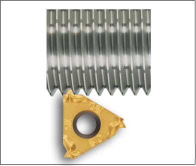

    For consistency of cutting threads, using a "topping"or full profile insert is great. It already has the proper radiuses built in if you order the right one. If they are using cnc most likely in use already. Downside is you have to have one for each thread pitch (eg -28, -24,-18, or x1)

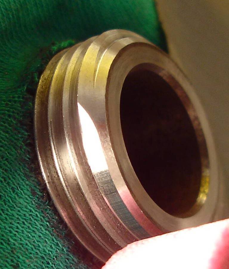

    For easier starting / stronger threads go lower pitch. Having a area in front that is a cylinder also helps start straight but has to be designed in to work. Also chamfer the front thread.
    One thing that is used in oil and gas is known as a higbee thread or blunt start thread. Not needed in guns and a pain in the butt to cut. (CNC thread cut with a square groover the first thread on both ID and OD threads. Has to have consistent timing.)
