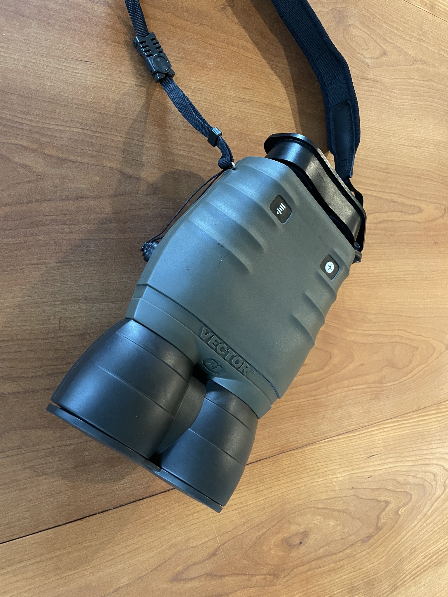

    I have IV’s, 10x lenses, lens caps with and without ARD, tripods, soft cases, data cables, manuals, quick reference field cards, basically everything Vector related.
    I’ve gto a couple different models of the IV here now, as well as 21’s. Since you know the 21’s, I expect you’d want the Swiss reticle, so a Vector IV SR1 is probably what you want. I have an SF1 and an S as well. Let me know what you need and I’ll put together a package price.

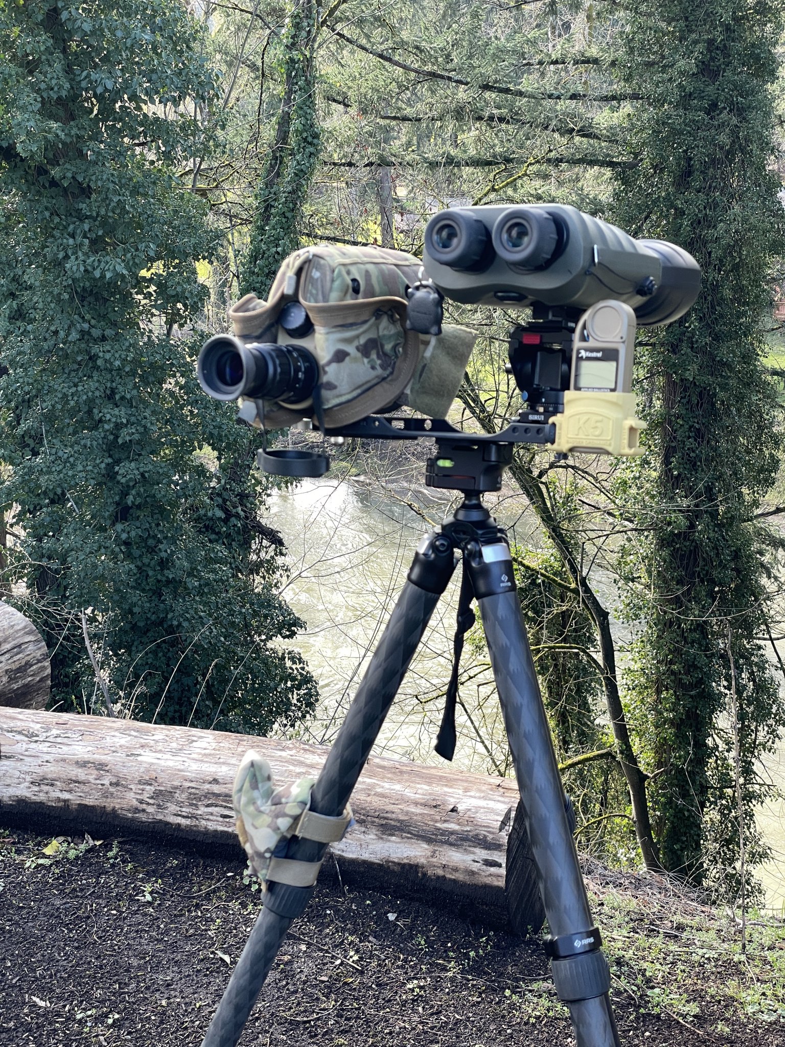

    Just got my set of 21’s from Cory.
    They are damn near new. And was hitting poles thinner than crosshair at 3300+ yds 10/10 times with just the 7x.
    Strapped the 10x on and was hitting tower about as wide as crosshair at 7500+ yds.
    He walked me through 100’s of questions without missing a beat.
    Highly recommend.
