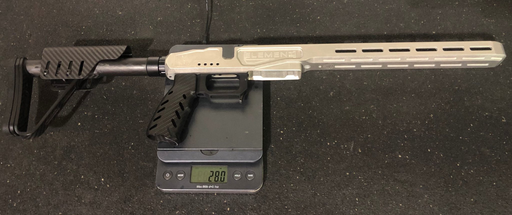

Here is a photo showing the lightest version of the new Element 3.0 chassis. As mentioned above this chassis will be able to be configured in a ton of different ways. from 28 ounces all the way up to 8+ pounds. All depends on buttstock grip, and forend option. Pricing is still getting worked on but we are REALLY close on having these available for purchase.

Here is a photo showing the lightest version of the new Element 3.0 chassis. As mentioned above this chassis will be able to be configured in a ton of different ways. from 28 ounces all the way up to 8+ pounds. All depends on buttstock grip, and forend option. Pricing is still getting worked on but we are REALLY close on having these available for purchase. View attachment 7117750
