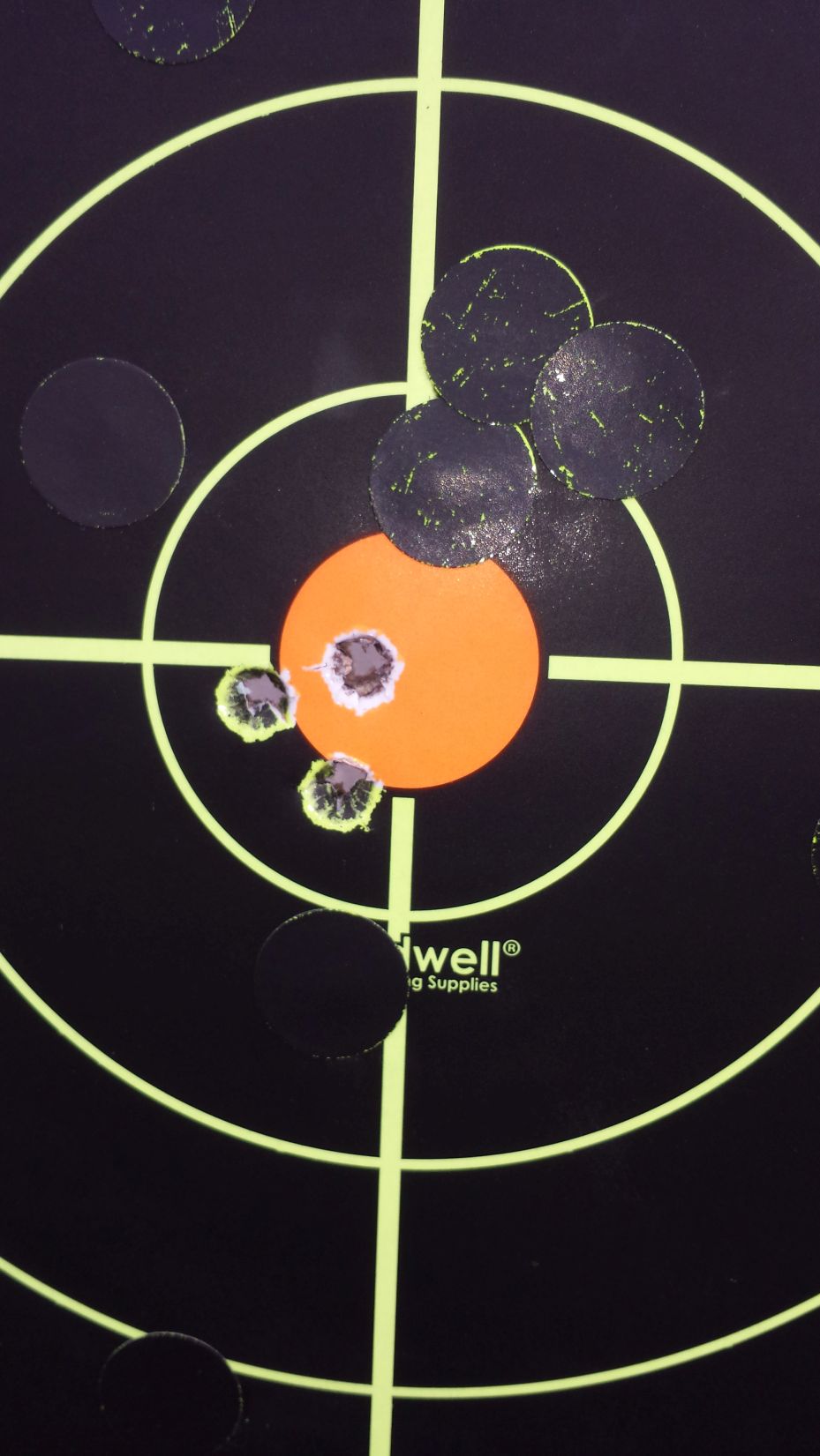

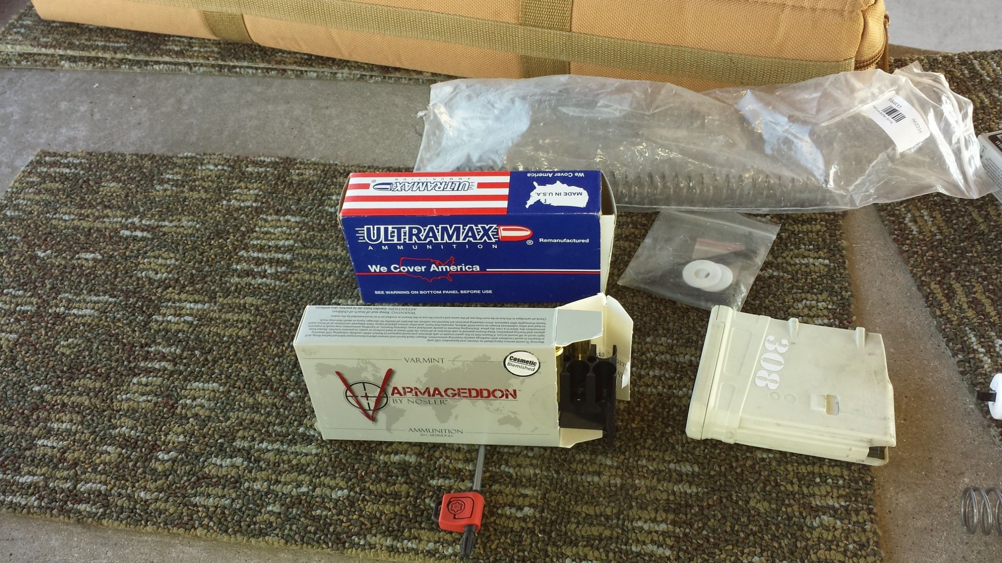

This 308 pencil barrel does great with 110 grain, loves the 110 Varmageddon. Actually looking at getting a lighter CF buttstock that is longer than the present one. I even cut the titanium grip screw 1/4 inch to 1.5 inches length.

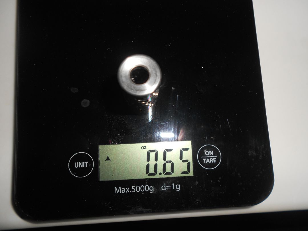

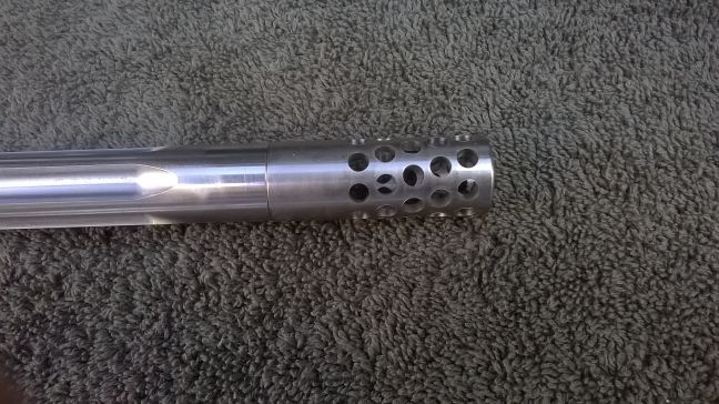

You might try the Anarchy Outdoors 35 hole spiral titanium muzzle brake. Only 0.7 ounces and it really works great. Looks like the Weatherby brakes but will make your 20 inch as light as my 18". I have an older V7 Furion 2 chamber brake on the barrel now. Trying to keep the build costs down and I know the Furion works great. I could use my super ultra light weight CF 11 inch hand guard and cut 2.5 ounces but since this uses a rifle gas tube it will look better with the medium wall 14.5 inch CF hand guard.
I'll have to look at that Anarchy Outdoors muzzle brake. I'm using a 2A X4 Titanium brake but at 1.7 oz you are correct, if I used the Anarchy brake, my barrel weight would drop by 1 oz. Every ounce counts. I got my Match barrel on sale at Brownells, otherwise, I might have gone with a Gunner. For me, the next big weight reduction will come in the handguard. Still need to find something really light or figure out how to make my own like you did. Thanks!
Actually lighter than 0.70 ounces. I have several in raw titanium and a couple in black. The AR15 version weighs more at 1.15 ounces.

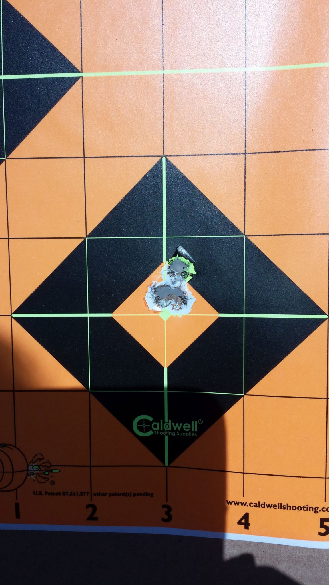

Finally shot today before the winds got over 25 MPH and the rain came. Slightly different configuration with a PDW buffer tube and a Rogers Super Stock. Using a 0.9 ounce buffer without weights. I was shooting in 20-25 MPH winds from the right, using factory Hornady 147 ELDM ammo. Took me 18 rounds to get the scope adjusted and get the first bullseye. From there about 1 MOA two 3 shot groups. Ejection ended up at 3 PM not using an adjustable gas block yet. Using the Toolcraft 11.18 ounce BCG.

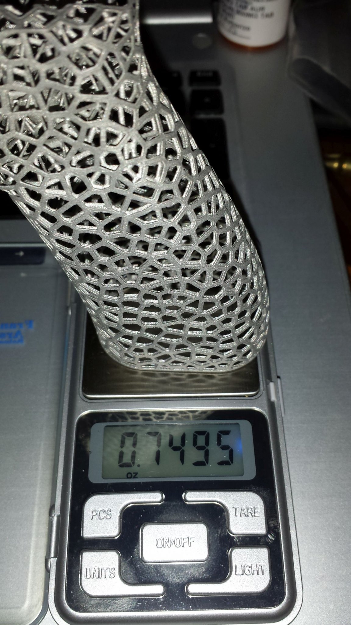

Also Form3D had the titanium pistol grips with black ceracote blemish for only $64, weighs a huge 1.1 ounces. I got mine and couldn't see the blemish? In 2017 the lightest pistol grip was the MagPul K grip at 2.25 ounces. Half the weight and grip feels amazing.

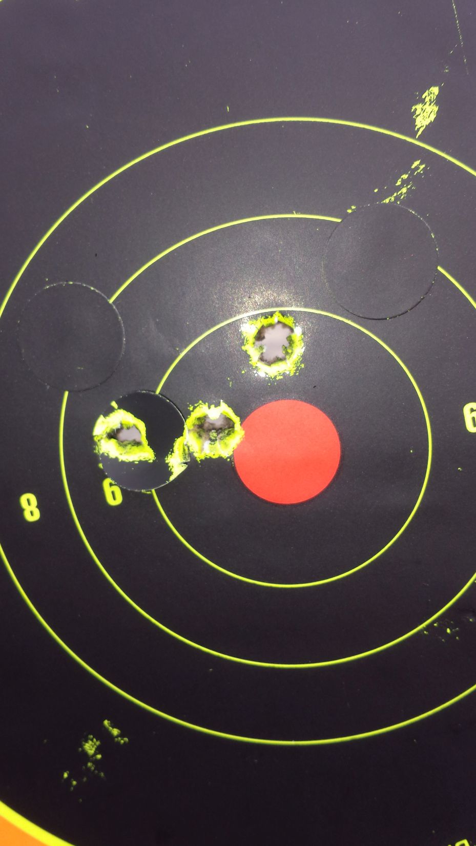

Shot yesterday, 90 degrees and winds less than 5 MPH. Used a box of Federal 95 grain Hornady Varmint ammo. Best group was .75 inches, but 5 inches from the bullseye LOL. The left right adjustment knob on my expensive Viper scope just spun, in fact actually came off in my hand. Rifle woked great with 3 O'clock ejection. Also had an issue with bolt catch, wouldn't hold with the stronger 308 spring but fed perfectly. Switched to a lighter spring and wouldn't bottom out the bolt against the barrel extension.
