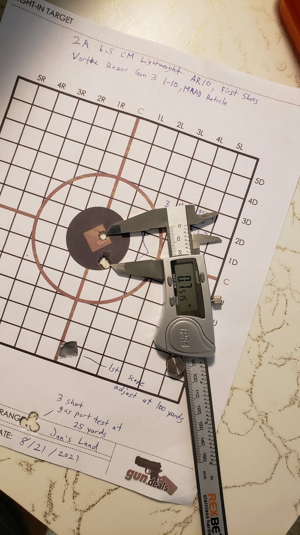

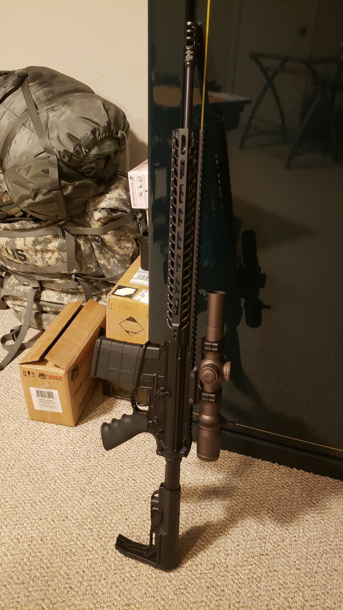

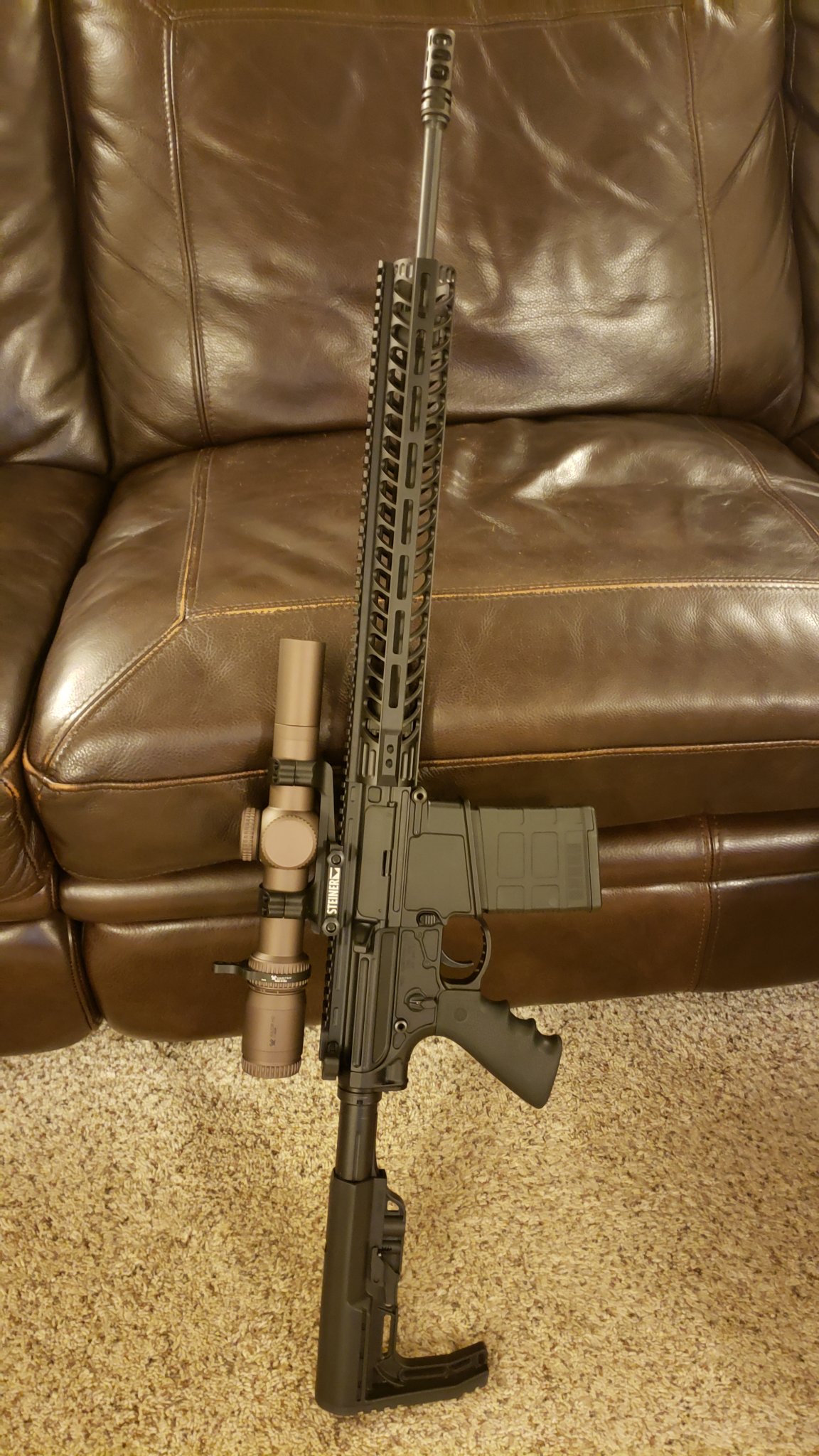

Well gents, been over a year since anybody posted on this thread. I finally finished my 2A build, and figured I'd upload a photo or two. With the virus of unnamed origin, its taken quite some time for me to get ammo and decide on an optic, and even more time to gather those and shoot it! My end result won't win any lightweight competitions, but before I added a mag or optic I stood at 6 pounds and about 9 or 10 ounces. I could lose quite a bit more weight with a lighter muzzle device, titanium bolt carrier and grip, but I liked these and its still less than many of my AR15s.
I went with a Vortex Razor Gen 3, and then threw on a Steiner 34mm mount I had lying around for optics. I ordered the scope from Liberty Optics back in March. On day 165, I received it. I put an SLR adjustable gas block on the 2A 20 inch barrel, and went with the 2A 15" handguard. Muzzle device is a VG6 Gamma 65. Stock is an MFT minimalist, and buffer tube, bcg, castle nut and take down pins are all 2A. Trigger is a 2 stage MBT, safety is a Radian Talon.
I've only shot a few groups, using S&B 131 grain soft point. My groups were under an inch from a rickety table and bag, on a scorching hot summer day in Kentucky. Both my Creedmore rifles seem to love this stuff. I had some fun getting the gas block set, but seems pretty reliable now, although case ejection is a bit weak. I am using a POF P308 buffer with all the inner weights removed. I'll continue to tune as time and money allows.
I will say, I love this scope. I'd have several more if they weren't 2K (or much less from Liberty) a pop. Cheers!
I found I'd saved one of my targets, this is a 3 shot group, taken at 100 yards on 6.5 magnification. About a .75 inch group. The bottom cloverleaf was trying to adjust the gas block at 25 yards. I'll take it, this is only the 2nd AR308/AR10 frame rifle I've built.

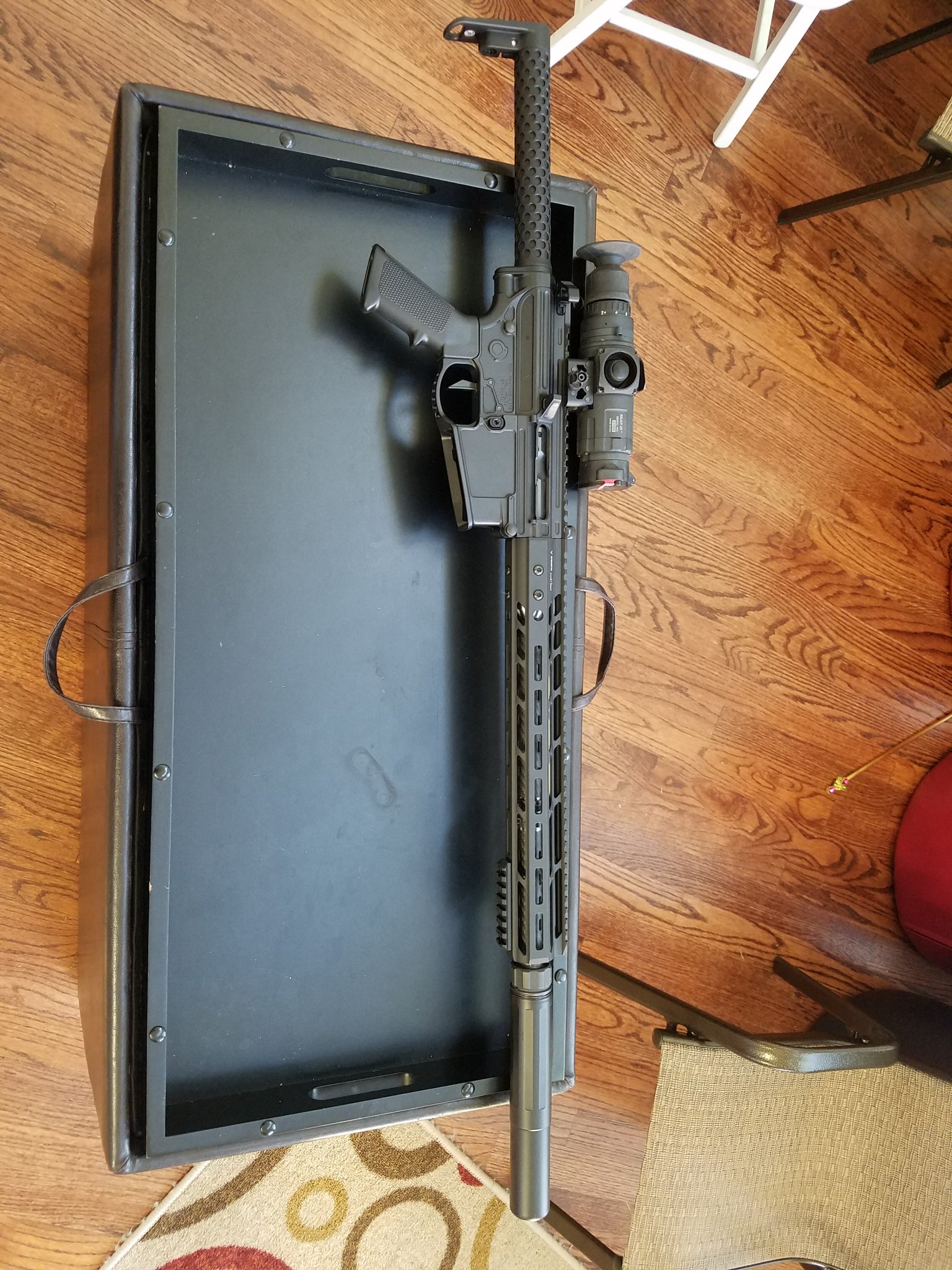

Finished mine up and works great, recoil definitely more then my other 308s, probably due to the the sabertube stock but it cuts weight. 5lbs 14 oz without brake or scope.
2A Xanthos
BSF 16" barrel
SLR Sentry 8
V Seven Titanium BCG
V Seven Ultraligte handguard
Raptor SD Charging handle
Geissele trigger of some sort
6.5oz Heavy Buffer
Pricey but will be worth it for hunting with my Reap-IR at night.
Might try a lighter buffer later to try and reduce recoil if it doesn't affect reliability. Have it tuned with my Sandman L right now with no issues.
