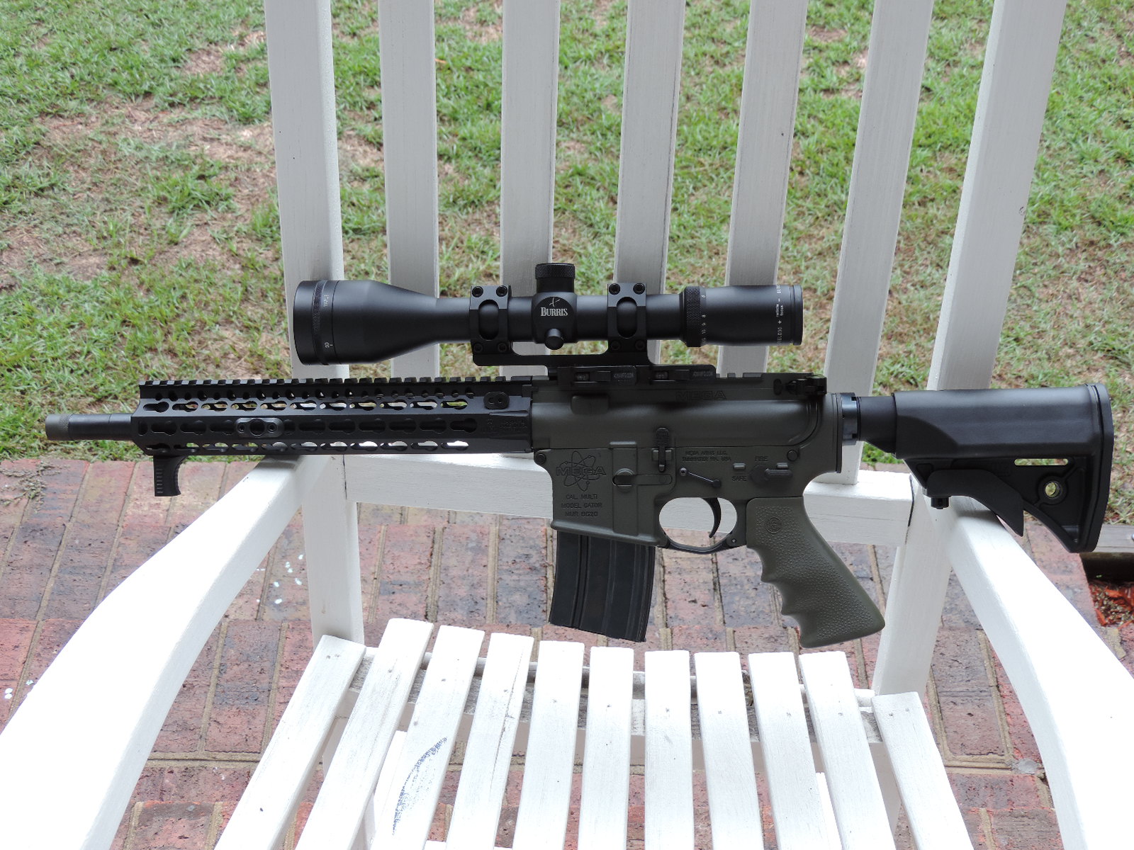

I just cut a 18" midlegnth barrel down to 12.5". Runs just fine with no tinkering at all.
Curious to know how it works out. I kind of want to SBR mine. It started as an 18" "DMR" and has slowly shrunk and become a carbine.
