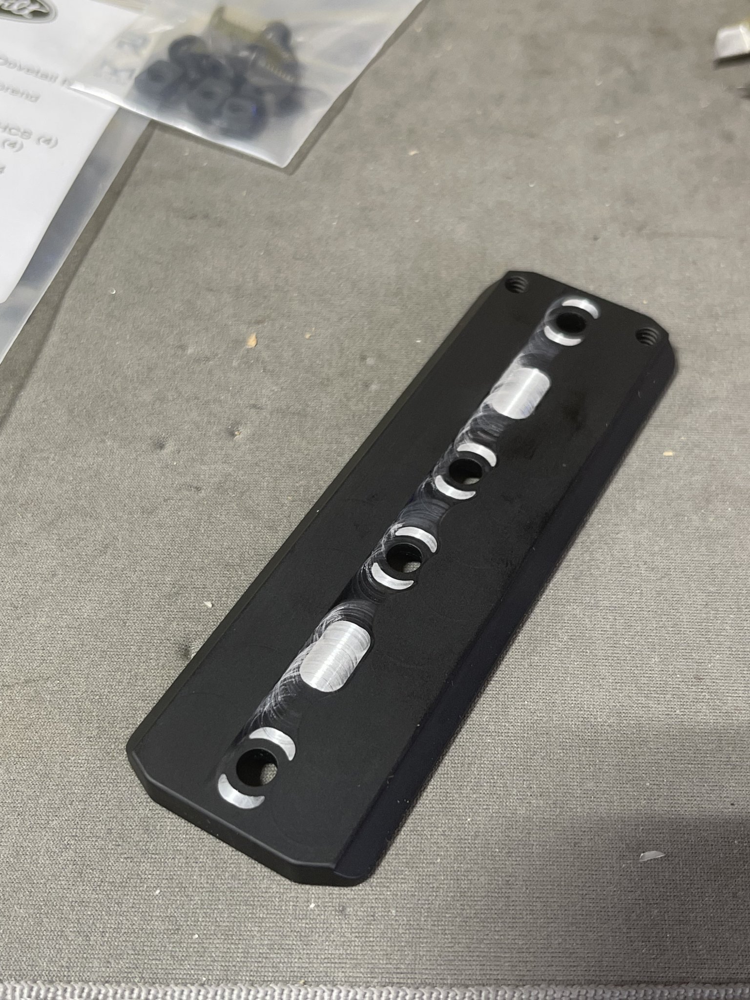

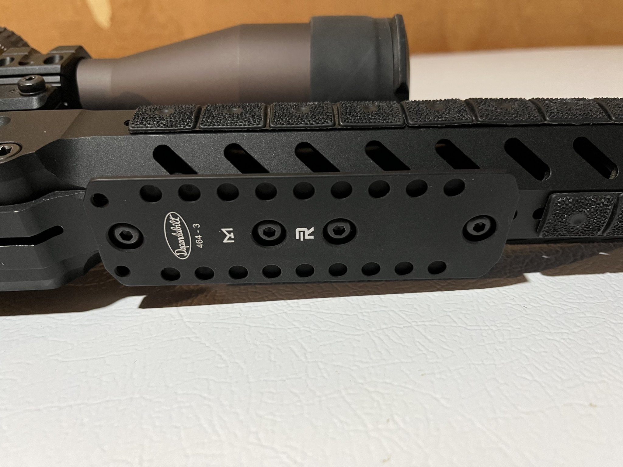

If anyone is looking for an ARCA rail for their LM8/SLK upper, Matt at Sawtooth Rifles modified one of their M-LOK ARCA rails for me. Modified and shipped same day. Excellent customer service and it fits perfectly.
Got any pics? I’m hoping dwilson makes his prototype for the LM8 also but seeing as they’re kinda phased out I’m unsure. Just sent my barrel off to him to be chopped to 17.5” and adding a Seekins adjustable. Just need to pick up the lower, scope mount, and charging handle.
Here you go. The screw hole spacing on mlok matches the lm8 spacing. Once the mlok indexing protrusions are milled off it fits. Screws are 10-32.

That Arca rail is looking good, do you have pictures from other angles? What are your thoughts on chamfering edges by the mag well or rounding the forward corners off?…do you think any of that would be a noticeable benefit?
Not many pictures at the moment. Still shooting some promo pictures.
We have considered what you describe, just working out some details on how to machine that economically.
Is it possible to include shorter M-LOK bolts that are machined to a length that does not interfere with the removal of the barrel? It will save us some time with a file or Dremel...
