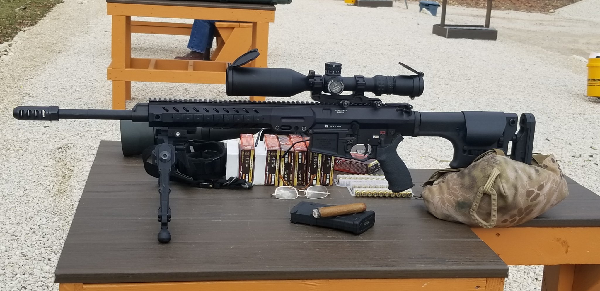

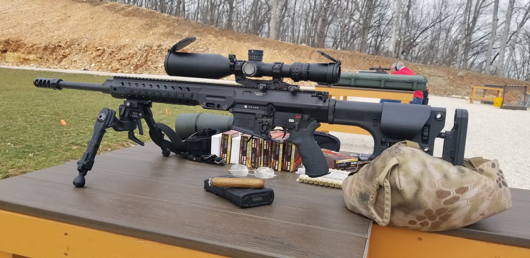

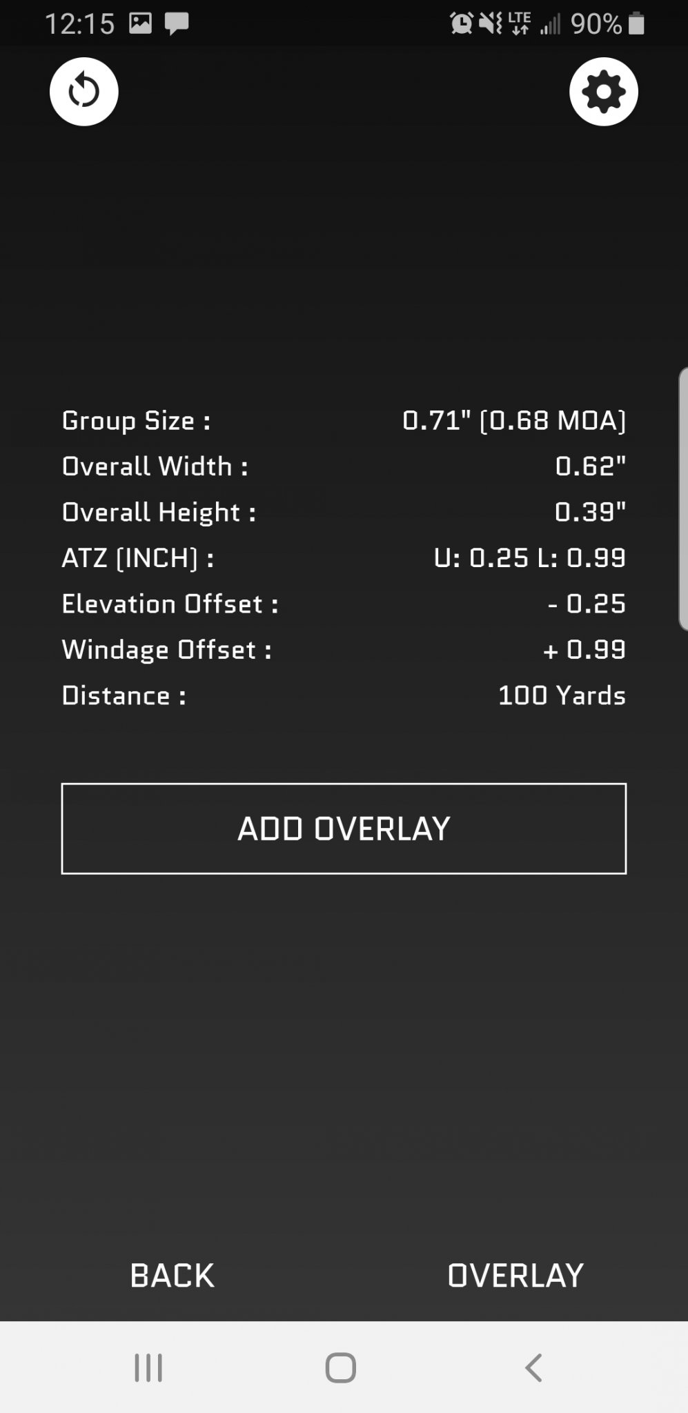

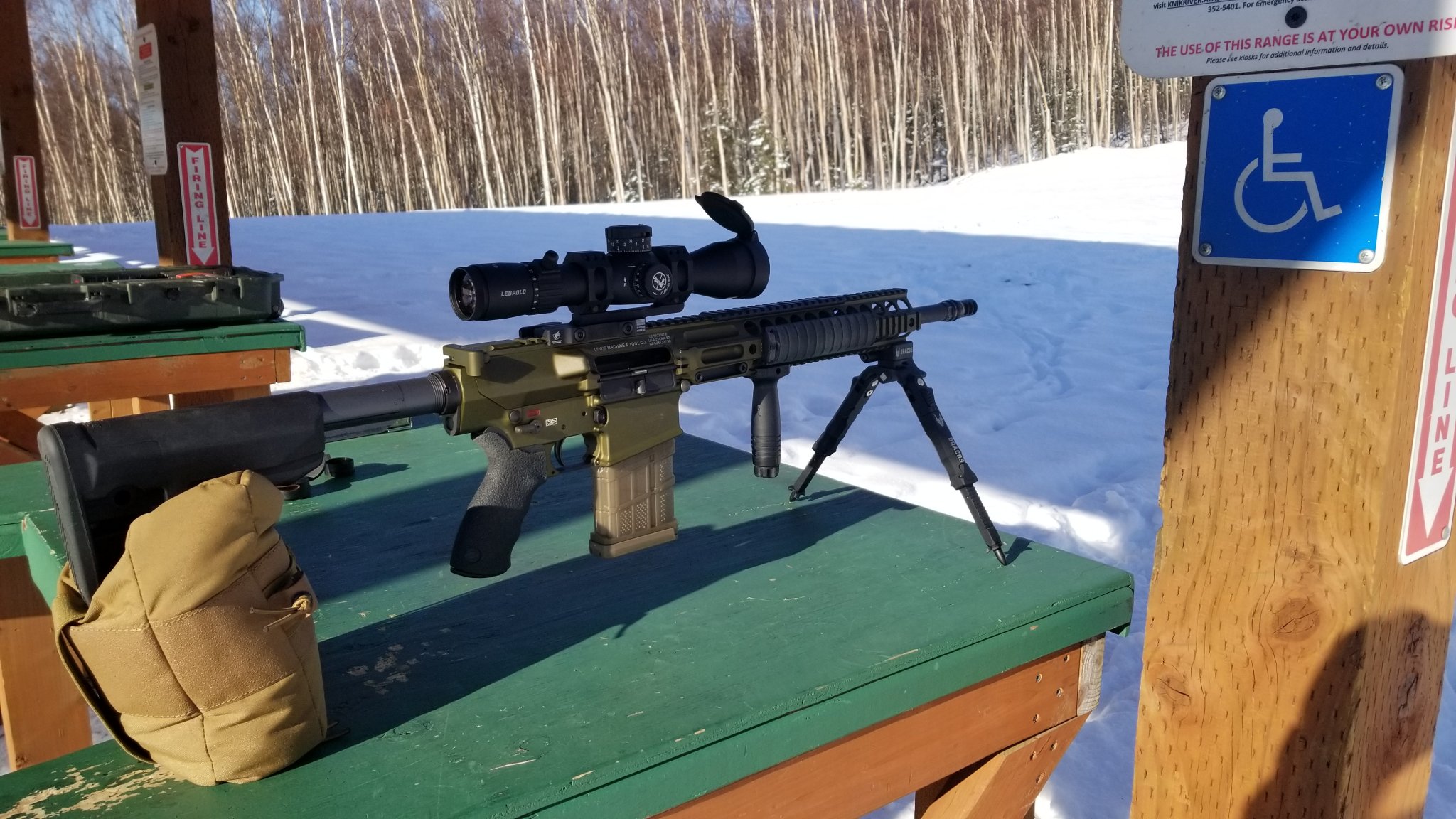

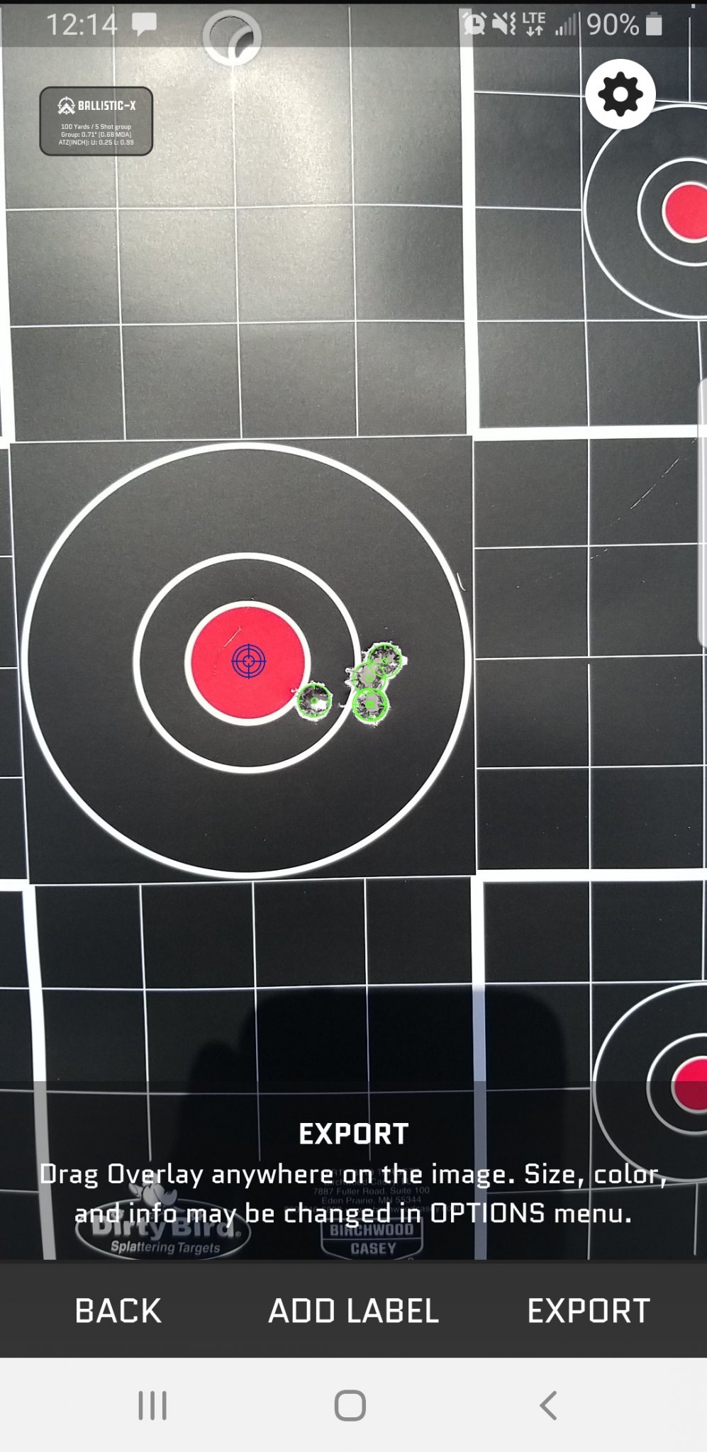

My LMT MWS .308 Update:
I purchased my LMT MWS from LMT directly when they had them on sale for $1900. I've had it now for a number of months and have run a fairly wide variety of ammo through it, shooting from the bench, from a bipod. I got a 20" SS barrel for it, the DMR stock, a Geissele SSA-E trigger and put a full sized Fat Bastard Brake on it. I got rid of my Harris and went with an Accu-TAC FC-G2 bipod (huge improvement!). I am using a Nightforce NX82.5-20.
I've been focusing on my fundamentals very carefully, really learning to work the trigger, avoiding feathering the trigger, etc. etc.
Long and short of it is: With even the crappiest 30 year old MIL SPEC stuff from Maylasia, I'm banging 6" steel plates at 400 yards, consistently and having a blast with the steel targets I have access to from 300 to 400 yards, various sizes.
I've tested it with Federal GMM 175 and 165 gr SMKs, several Hornady and Lapua loads and several less expensive mil spec stuff, but ... the very best groups I've been able to get so far are with .... PRIME AMMO 175 SMK. My best five shot group, repeated half a dozen times on a nice day (little/no wind, 70 degrees at 100 yards.. was .37 and .38 MOA.
For me, I find this very satisfying given all considerations and I'm enjoying the challenge of increasing my speed and accuracy against the steel targets at 400 spread out over a 50 yard line of targets various shapes and sizes. The muzzle brake very effectively gets me back on target very quickly and I'm able to get the steel swinging shooting as rapidly as I can.
Here's a pic of my set up.

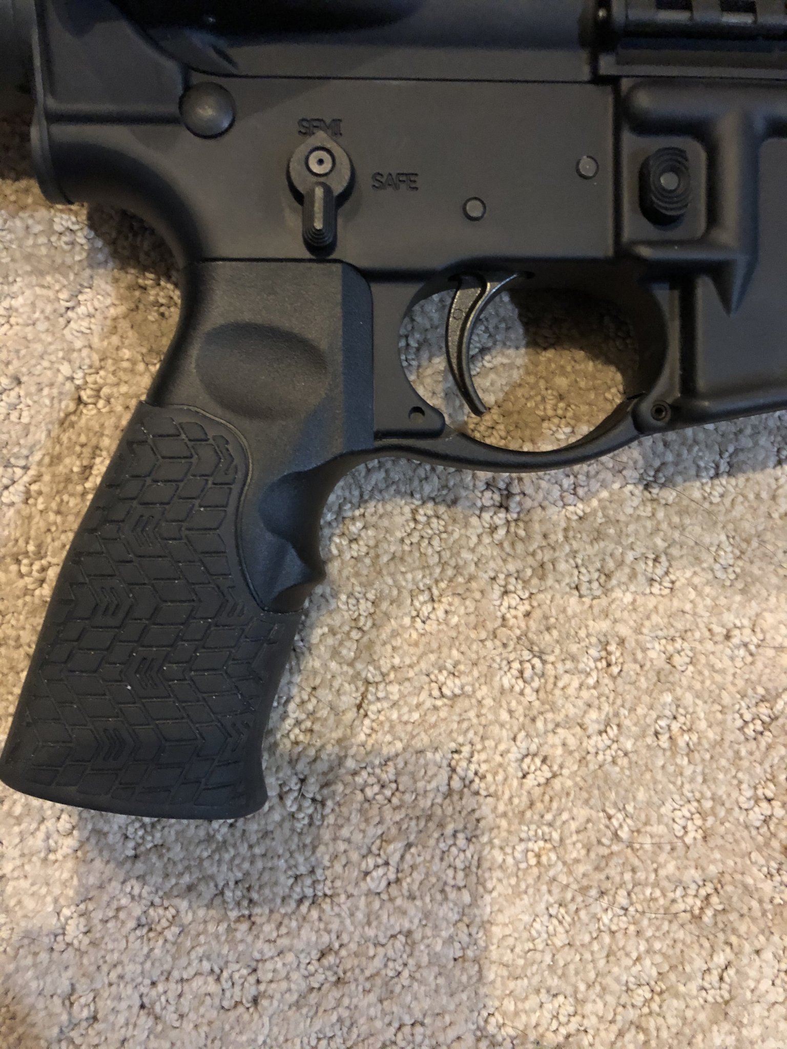

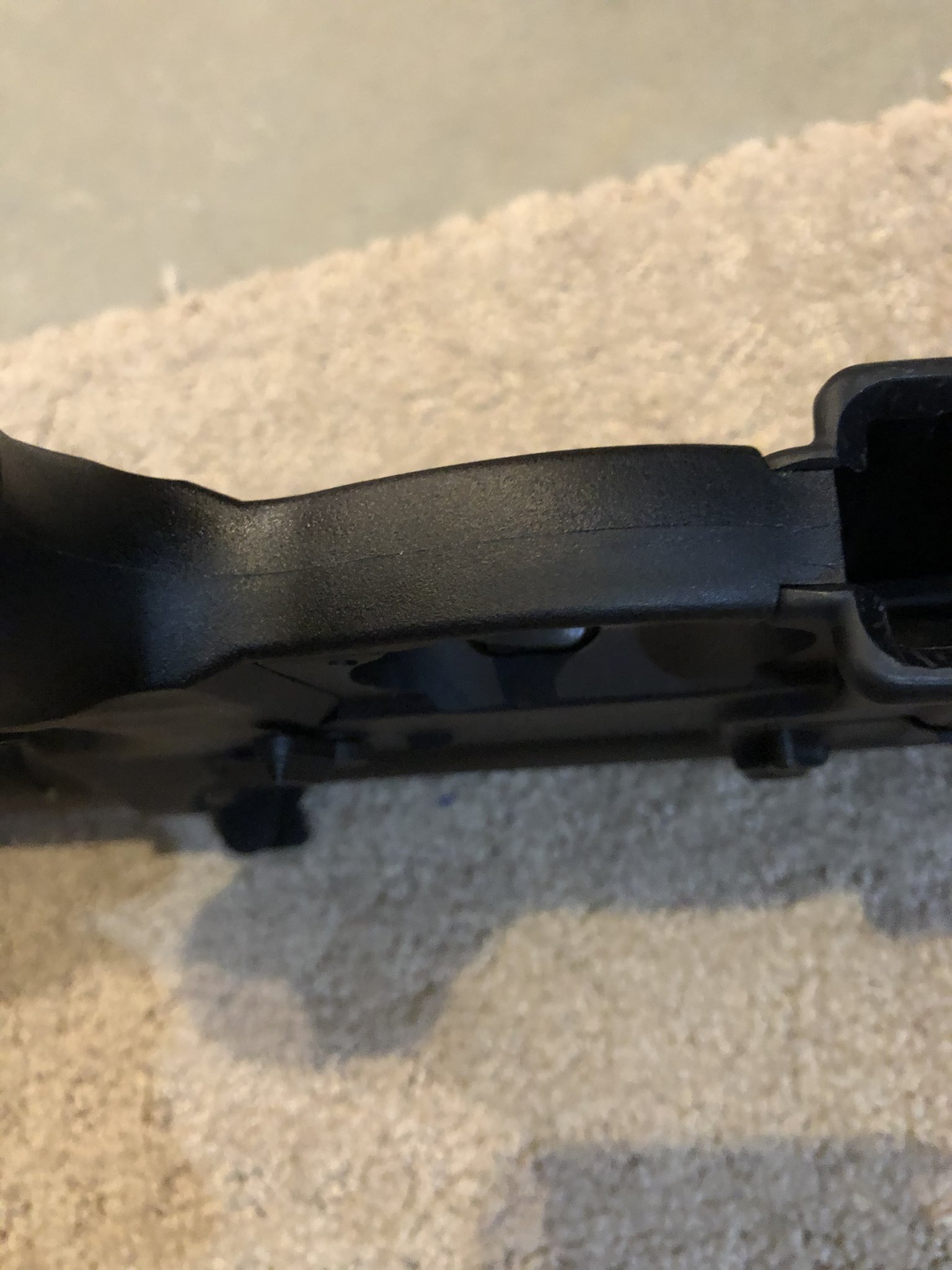

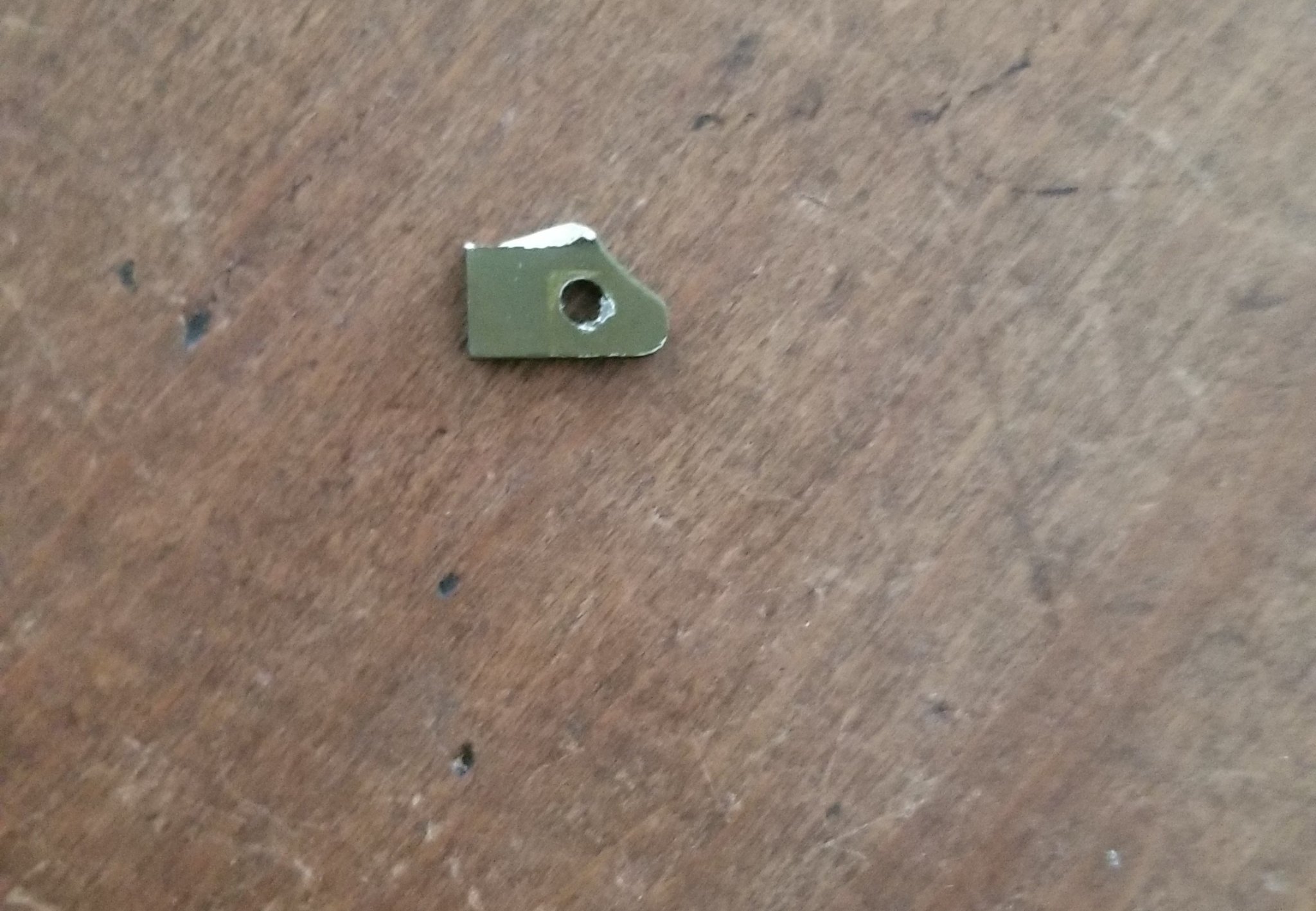

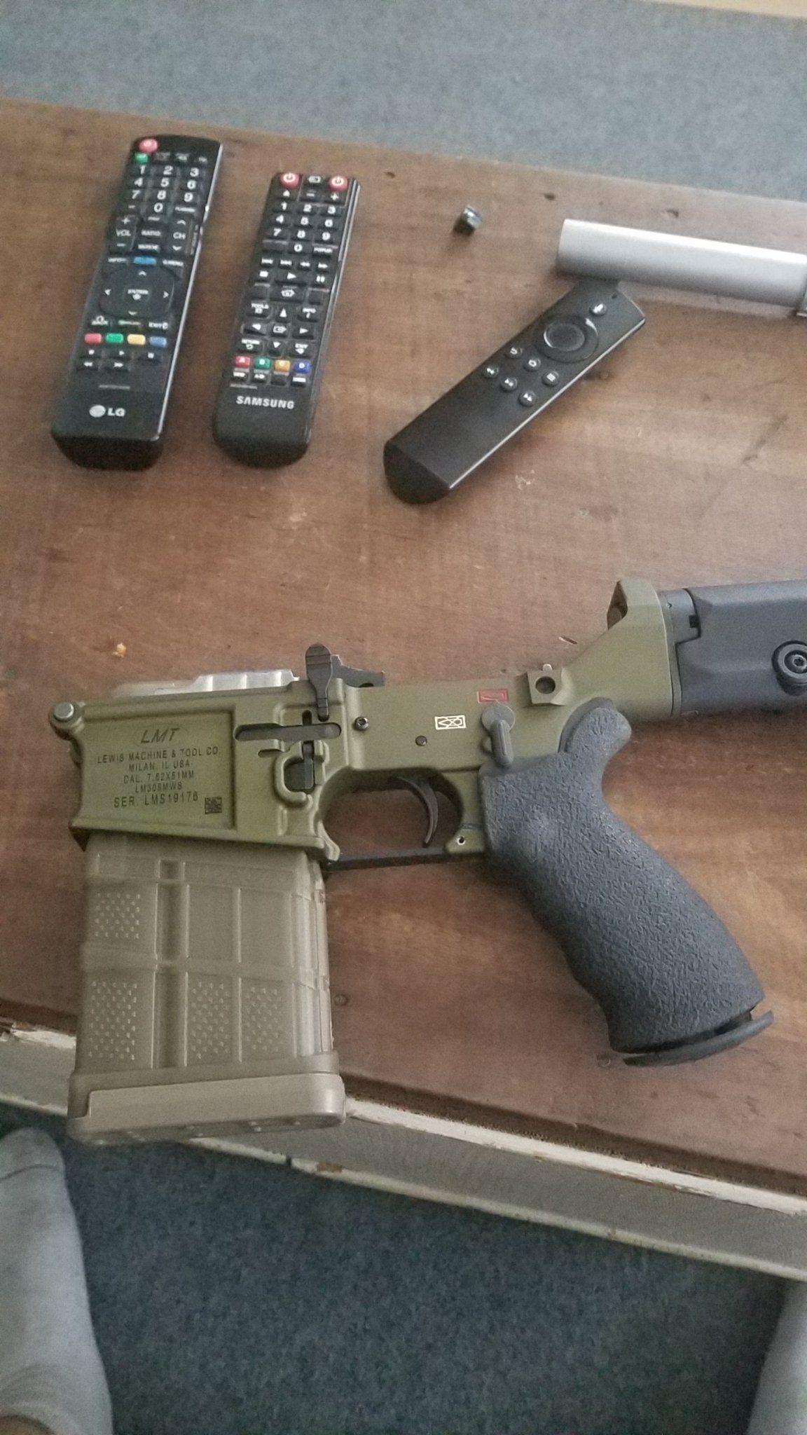

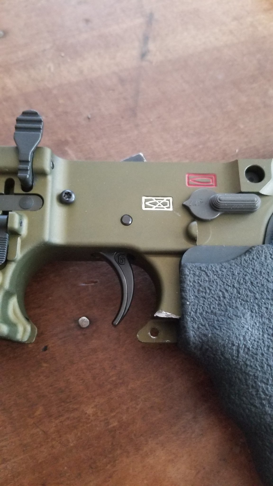

Hello all,
It's with great sorrow and pain that I ask this question. I recently decided to have my canteen green lmt trigger guard switched out, as it's a rare bird I decided to take it to the gun shop I've frequented for around ten years. Super great people and have never been done wrong (will not mention shop name.) well I got a call yesterday that my canteen green lower was broken, Pics below. Needless to say I'm sick to my stomach, but they have a free brand new mws lower on the way and I keep my canteen green lower as well.
My question is, if I'm able to tig weld this tab back on does anyone here know of a reputable company that would be able to anozide the welded spot after its welded?
Any and all information is greatly appreciated ?

Holy shit. Amateur hour fuckup. There is absolutely no excuse for that.
And no, it’s not repairable.
ROCKET MAN
Yeah its something I would do myself and chose not to, I'm regretting it pretty hard. Was told it was a new gunsmith and after this, I'm not sure how long hell last after this.
Man that sucks. I think they must be using the term gunsmith loosely, as that's a pretty serious mistake to make on a lower that's essentially irreplaceable.
This is one method of fixing it, and is something you can probably do yourself:
There are similar solutions posted on arfcom and carolinashooters, but the pics are hard to see.
Another option would be to use a grip with an integrated trigger guard like the one from Daniel Defense, or a first gen MIAD kit with the trigger guard front strap (if you can find one on the used market).
Though none of that will really restore the lower to like-new, they are some options that would make it usable.
ETA: this is probably the best solution, if you happen to know a competent machinist:
Daniel defense grip may also work. That is terrible it happened especially to the canteen green lower.

Sorry man....wow....that would have been an enormous test of my patience and self-control if that happened to me. At least they are trying to make it as right as possible with you, but .... geezo-Pete....wow. Hang in there.
Tx_Aggie
That magpul enhanced trigger guard looks like a solid option, I have that tap and I never even thought about this method. Plus I really enjoy the lmt ergo sure grip that comes with the lower.
I all honesty I would much rather have a machinist do the 80% ears trick, but I'd imagine it would cost an arm and a leg.
Thanks again

No problem, I hope it works out to your liking. That's the option I would try first.
There's no reason you couldn't have the machine work done at some point in the future if you'd either unhappy with the magpul fix or just want something more permanent. .
The DFC I did get in contact with lmt and they basically said there's nothing they can do. Understandable, but the lmt rep I talked to was say I could rock the lower without the trigger guard tab. He also recommended tig welding it, but I've been reading and I've read nothing but negative about welding.

Much appreciated for the grip suggestion, they actually had one of those stark grips. Man to tell you the truth, just couldn't dig them. If they didn't have that weird shark fin deal at the top of the grill and it was a thinner profile, I definitely would've bought one.

Lmt would replace that for free is my bet. They replaced an upper i got on a trade, that was bent from trying to remove the muzzle with the barrel attached to the upper. They didn't even charge me for shipping. Top notch bunch.
I will definitely give the 80% in the future, might as well make it a more permanent fix. The truly unfortunate thing is this hurts the resale value if I ever wanted to sell it and get a new lmt. However this rifle is such a tac driver, I'd have a hard time selling it.

Yes unfortunately it was the south American lmt mws, that I purchased from a fellow member on this forum. Great guy to deal with, a great gun that I had for a whole week before the great tragedy.
But man, if they didn't offer a brand new lower for free and no one didn't offer any advice of fixing the problem on this forum I'd be pretty raw. It's life man, it's all what you make of it. ?
