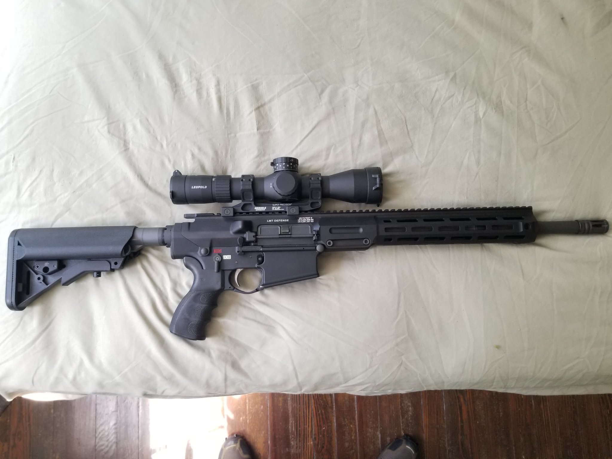

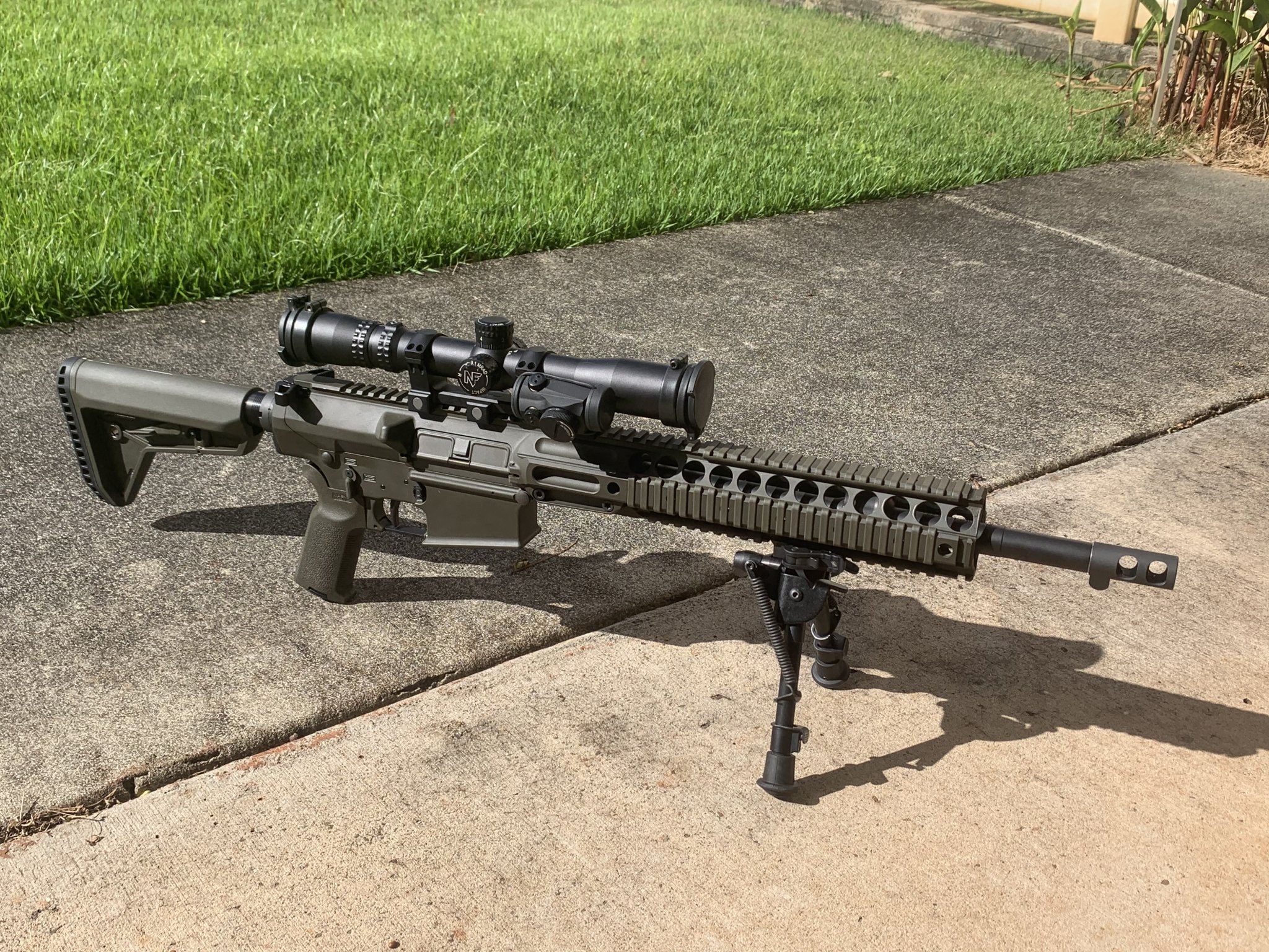

LMT .308 MWS
Just had my older MWS Cerakoted in the Magpul OD Green color. I really like how it turned out. The 16” lightweight SS 308 barrel has been a tack driver too.

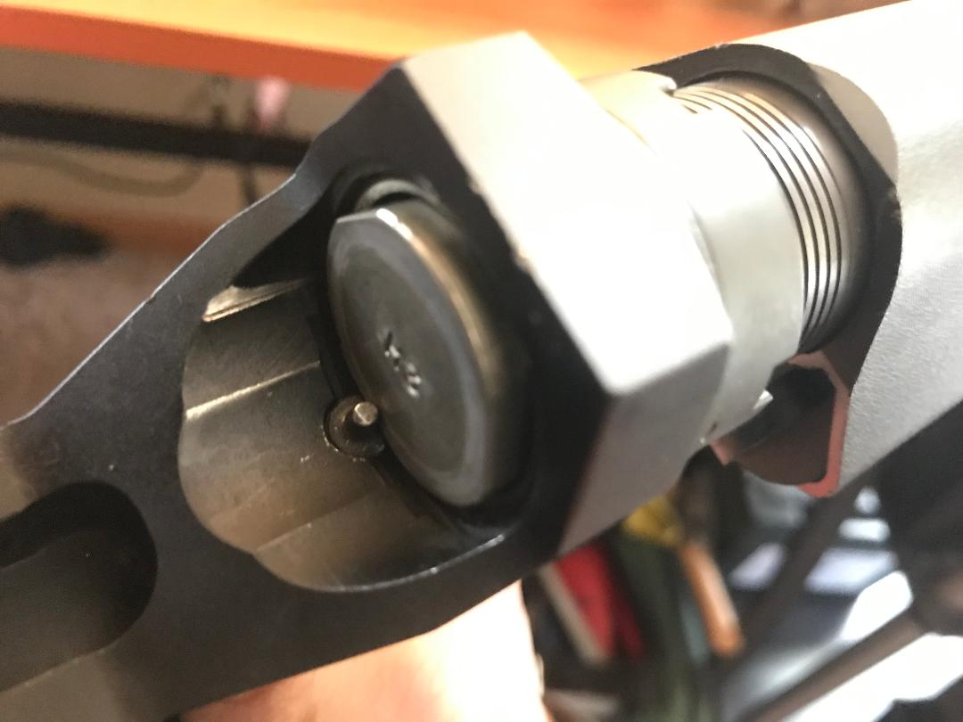

Here is a photo of the issues i am having, I dont know why its doing this. I sent LMT an email and have not heard anything back yet, might call tomorrow and see. If anyone has an idea of why this is occurring that would be great!
Looks like the bearing surface of the BCG hitting it. Is it a completely stock gun? Any left/right wiggle between the receivers?
Are there any marks in the upper opposite of the gouge in the lower? If you remove the buffer spring and push the BCG and buffer fully rearward does it bind at the end of travel and how far does it go.
no marks in the upper, looks clean, BCG and buffer run smoothly inside the tube, not feeling any binds, visually inspected as well and appears to be fine
So Lmt replied and stated "those marks look normal". Kind of skeptical as this gun is pretty new in terms of round count (under 500). And i have other 308's with thousands of rounds on them and they do not look anything like that!
Look at the alignment between the upper and lower (right to left looking down). Yours is probably biased upper to the right, I'd likely send it back especially if it were causing a reliability issue. Regarding sluggish, that contact can cause a loss of energy, however I noticed my BCG was sort of dry and LP on the BCG bearing surfaces and the gas rings helped.
I will have to look into that. When i called LMT they basically said i was SOL. I am going to take it out this weekend and run a couple test the recommended and go from there. I appreciate the help though!!
I had a factory rifle with a little bias, .030 measured on the outside flat that runs down the middle of the receiver and extends on to the lower. Measure the difference between upper and lower flats on each side. Obviously there is a tolerance for off center bias. I discussed it with LMT support, he asked if it was causing cycling issues and offered to look at it if it were.
