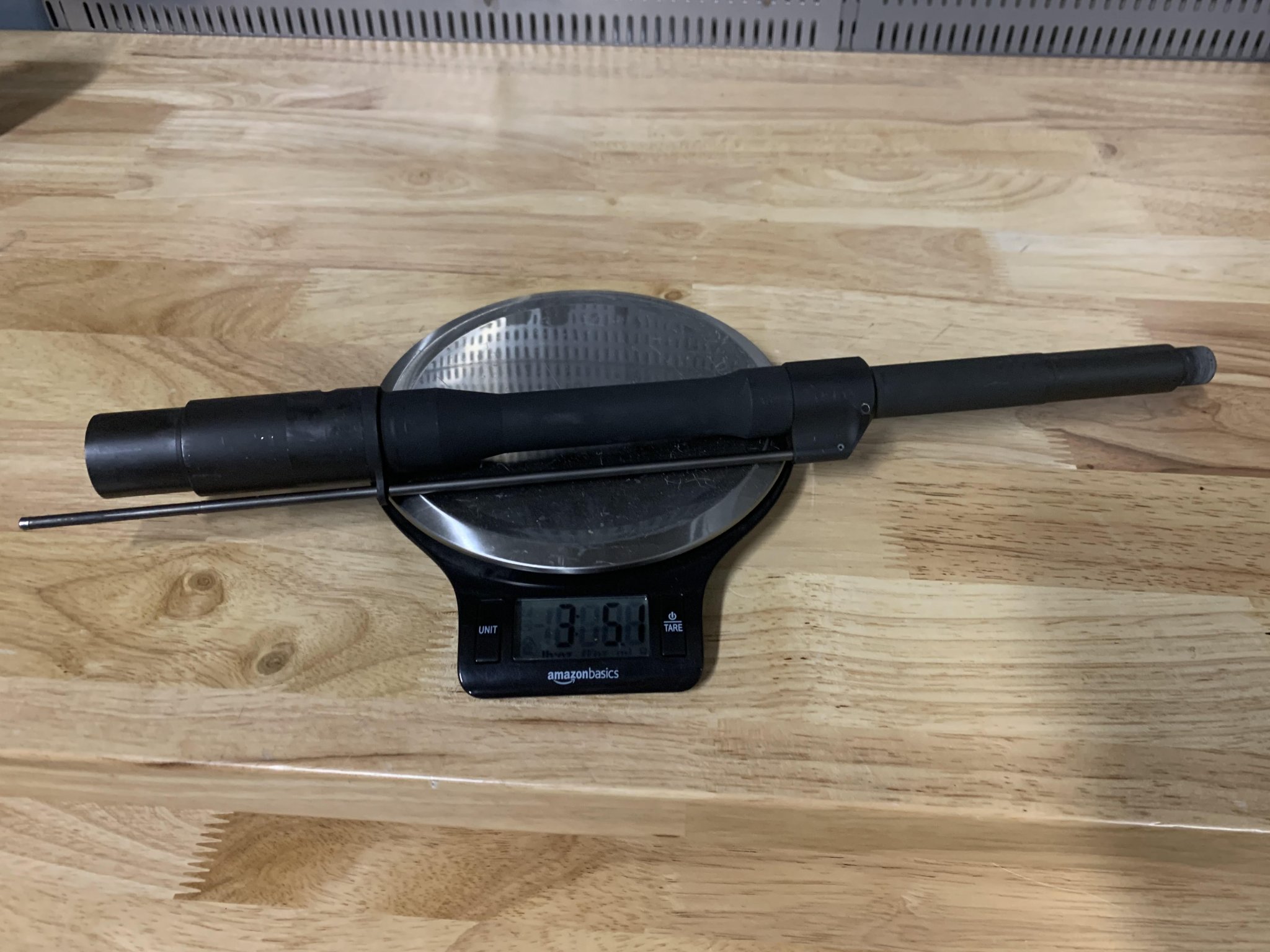

Thank you. The spec sheet helps, but looking for a direct comparison of the LW 16" barrel and the Proof carbon 16". Understanding I'll have to factor in some weight for the conversion.
Does anyone have the weight of the LW 16" barrel on its own?

I just weighed my LW SS 16” barrel in its box and it was 2 lbs 11 oz. Keep in mind that includes the integrated gas block, gas tube, and how much ever the actual little plastic box weighs lol.

A regular 16" barrel for comparison

The Proof 16" Ar10 Barrel is 2lbs 3oz, that is without an MWS conversion which likely add a few ounces.
The LMT LW 16" is around 2lbs 11oz according to Mitu above

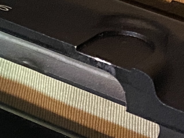

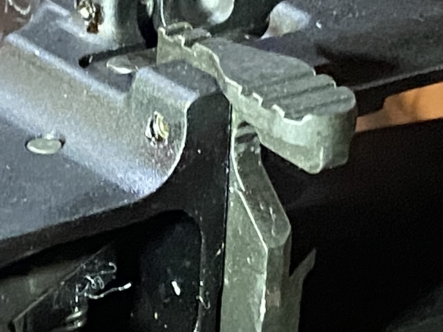

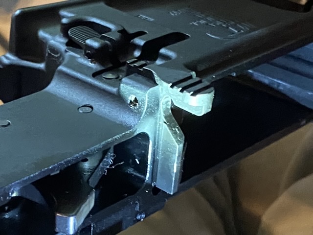

So, this is pretty disappointing. I went to go test out my new rifle (assembled from a MARS-H lower, MLOK upper, LMT BCG, and 16” SS barrel). It shot great, but the bolt hold open wasn’t working. Felt like it wasn’t getting the full movement, so I pulled it apart and I see this:
Looks like it’s not setting right. Guess my best bet is to get a hold of LMT?
View attachment 7401272View attachment 7401273View attachment 7401276
Is it a factory complete lower or a stripped lower?All LMT parts? Mine has a tiny amount of wear in some of the same areas (not as much as yours) but nothing had an effect on function on a Complete factory gun.
All LMT parts minus the trigger and the stock/grip. MARS-H lower, LMT lower parts kit, MLK MWS Upper, LMT 308 BCG. Assembled by my gunsmith. When the upper is off the rifle, the bolt hold back has full range of motion. When the upper is attached, no dice.

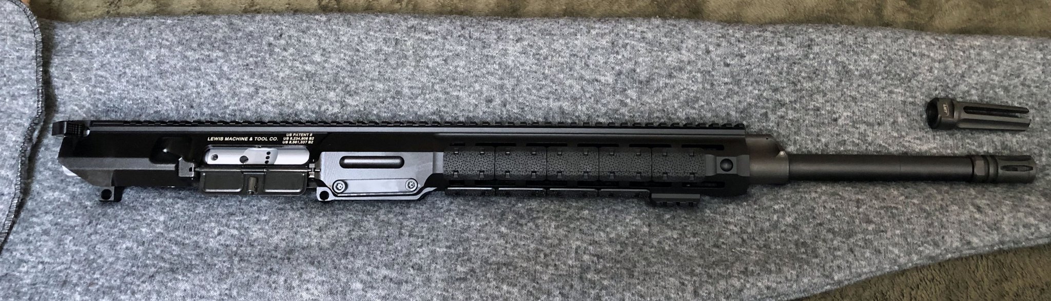

Putting together the last pieces for a full LMT 20" 6.5CM MWS.
Trying to decide on a stock. LOVE the Sopmod. Is it really worth running the PRS or the LMT precision stock? Is the PRS a better stock than the LMT?
Going to be shooting mostly from a Tripod and some from a Bipod. Woried the DMR stock would be to unweildy and I have heard its loose and not as tight at the Magpul?
FYI, in case anyone is interested, spoke to LMT this week. Sounds like they’ve had this issue a couple of times before, has to do with the bolt catch riding too high. They’re going to send me a replacement bolt catch.

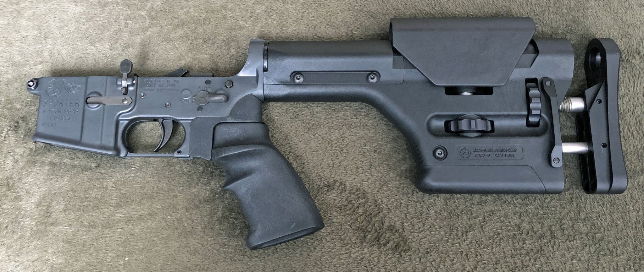

I have all three. The Magpul PRS is rock solid, but I do prefer the LMT DMR check rest. The LMT DMR lock up is no worse than the LMT Sopmod, but there is no extension limit so you can end up removing the stock accidently in the field when you extend it.
I currently have the Magpul PRS installed on my MWS. Like you, I have also built up a 6.5CM upper for my MWS.

Here is the Magpul Gen 3 PRS stock on my LMT MWS. It’s solid and I don’t find it unwieldy for my purposes. I do prefer the monopod rail on the earlier generation with the rail cover to this configuration.

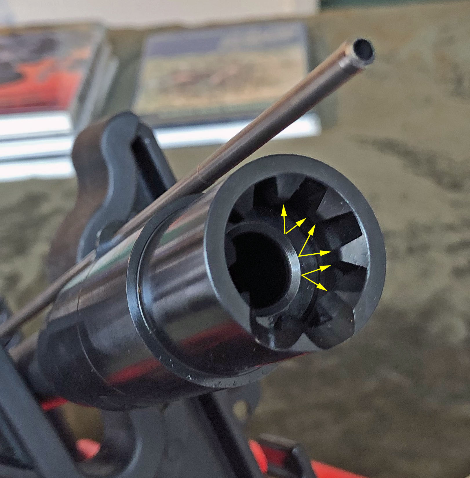

After my recent trip to the range I have decided to address over gas issues and cartridge case damage with the following modifications. My rifle is not suppressed and I do not run a brake.
Install an adjustable gas key. I see there are at least two manufacturers, Rubber City Armory and ADIGS. Are there advantages over one compared to the other?
Break the pointed edges at the rear of the barrel extension lugs. Mine are cutting two deep parallel gouges on the case neck during ejection. I have found several discussions regarding this issue, but none clearly explain how to modify the rear of the barrel extension lugs. I would imagine easing the edge would correct the problem, but what are the proper contours and the best tools to achieve it? I found an inexpensive source for AR-10 barrel extensions and I think I will order one or two to practice on.
Remove a coil from the ejector springs to correct case dents from cases hitting the case deflector. I see some are just adding a piece of Velcro to the case deflector. Any recommendations here?

Regarding the LMT barrel extension trashing fired brass. I spoke with LMT and they consider the damage to the brass as normal.

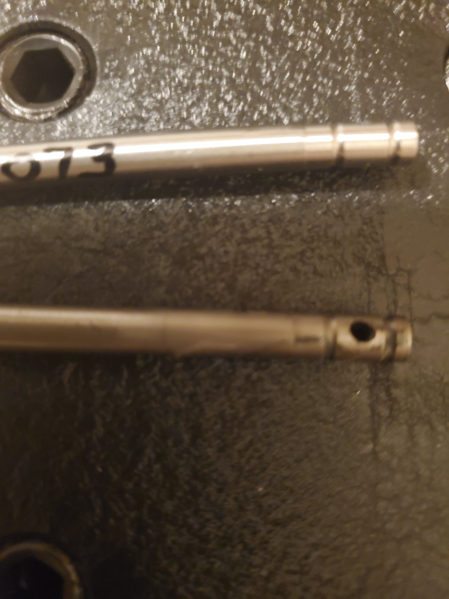

I just installed a BRT gas tube into a 13.5 p/w. With an oss helix qd suppressor And....
It was perfect. Less recoil than an unsuppressed 16" stock SR-25. Much less actually. Both used with a tubbs flatwire and lmt H3
Brass looks perfect except 2 very small scratches on the brass from feed ramps. May eventually polish those out. Or maybe let the gun break in.

When you get it, measure the port size, remove your factory gas tube, then drill the measured port size in the stock tube. Now you have 2.
But the whole point is that the new one would be smaller. These are over gas not under gassed
I think you’re missing my point. Lmt tubes are straight. Drill the reduced port size in the “top” of the factory tube and run it upside down. Matter of fact, drill the new one straight through so it’ll last twice as long. The port in the tube is going to erode and increase in size resulting in the over gas condition returning.
