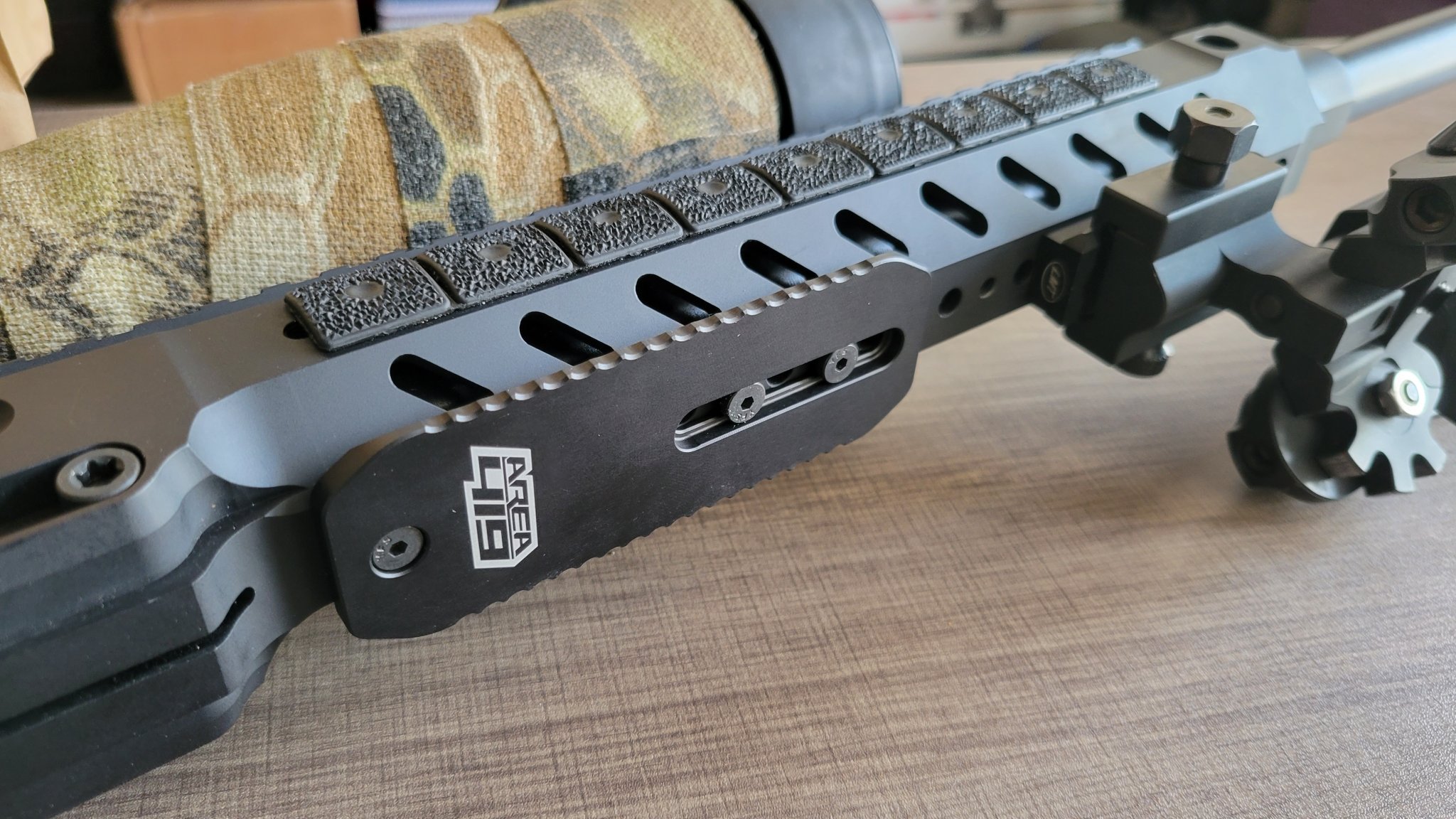

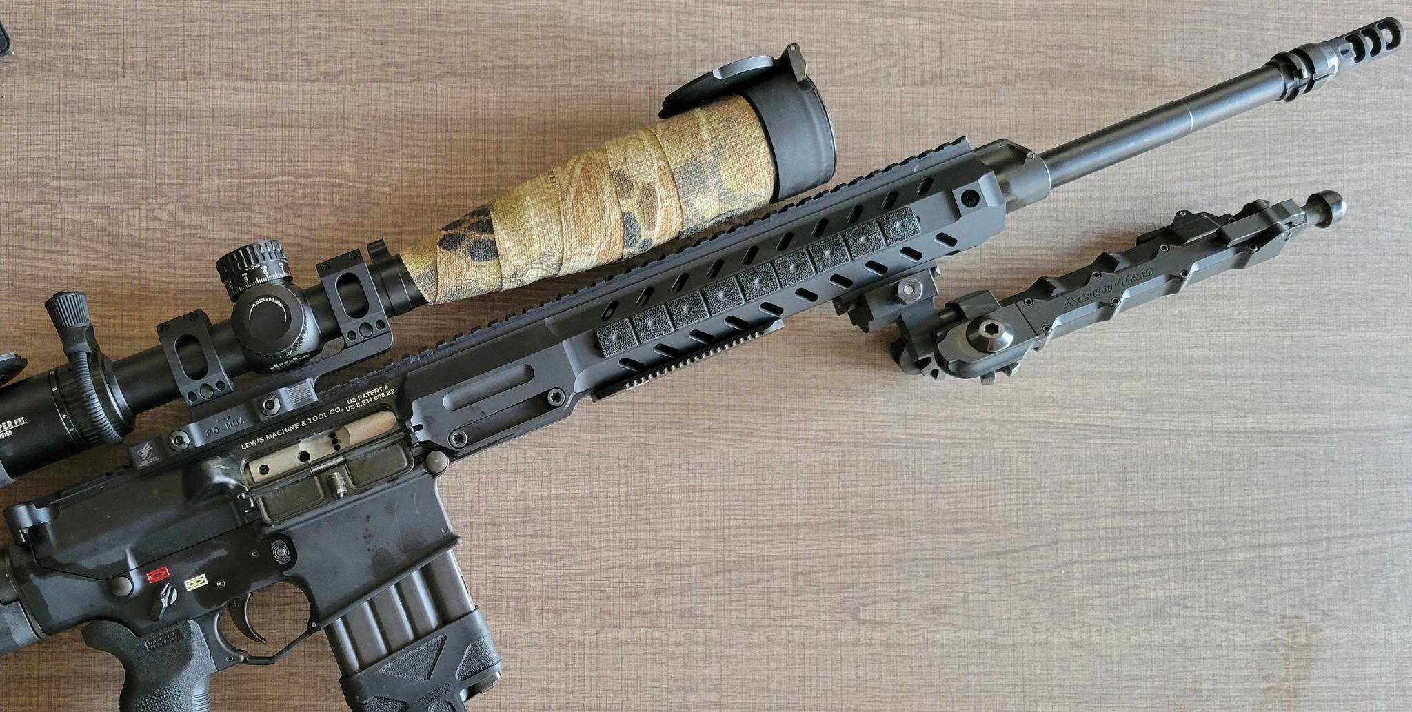

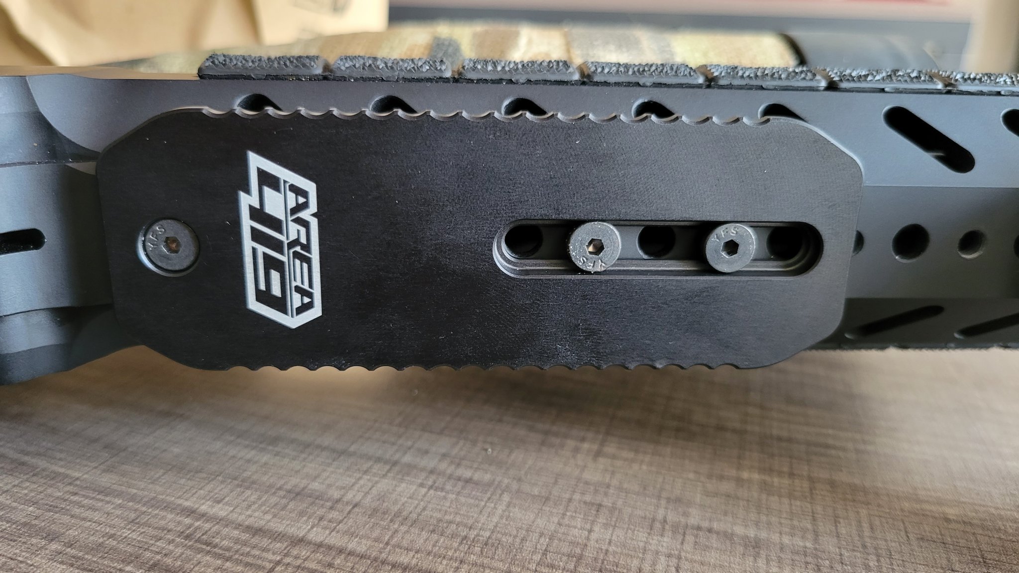

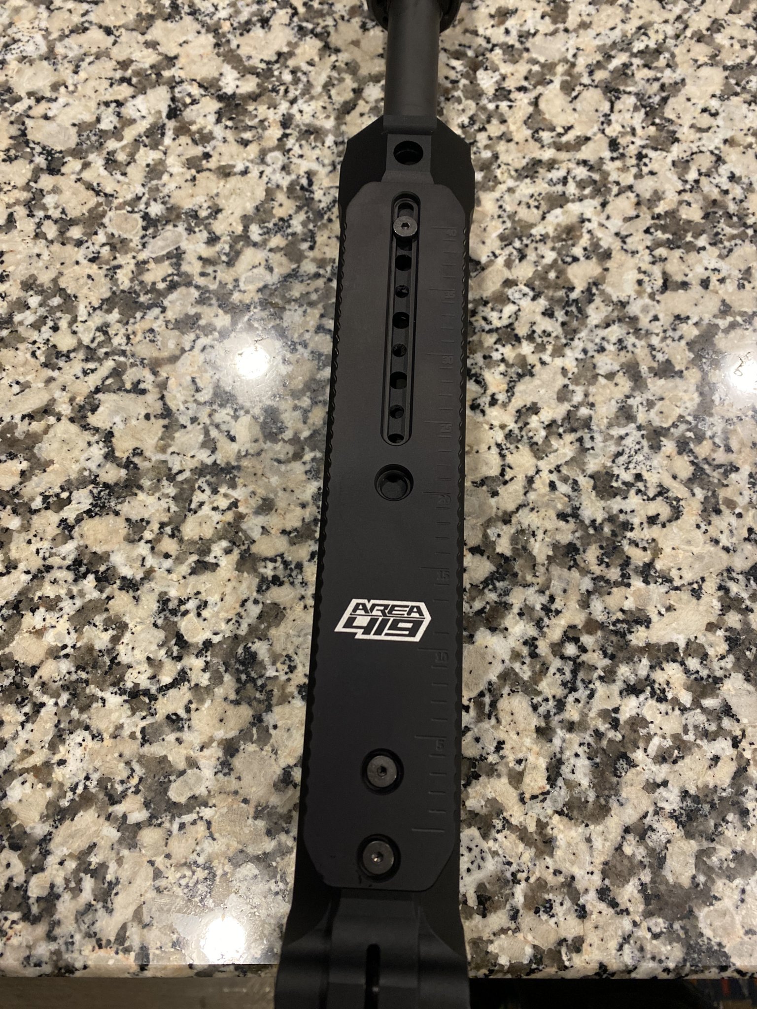

Finally got around to trying this today, but a 4" Area 419 arca rail fits perfect on a slick side upper using 3 LMT rail section screws (they sit about 1.5mm below flush with the rail plate). I didn't have a torque value on hand, so I went with firmly hand tight for now (with lmts threadlocker) and will probably call the LMT guys this week. I didn't measure the length or thread pitch of the screws before hand, but I'll add it to this post sometime. I'm happy to find this works because the 1913 section was both hard on the hand and has been chewing on my Anvil 30 head.
View attachment 7831662View attachment 7831664View attachment 7831663
Thanks for posting this! I was wondering if there was a way to make this work. Think you could get the 8" universal rail to fit?
Reactions: Vivacious Stallion
I figured it would be helpful to someone. I can tell that using 2 x 4" plates won't work space wise. The 8" might work? Idk how many of the 419 milled holes will line up with the SL8 holes. I don't have one on hand to try atm. The SL8 1913 rail sections are solid but not very refined, so if the 8" worked that would be another nice option.

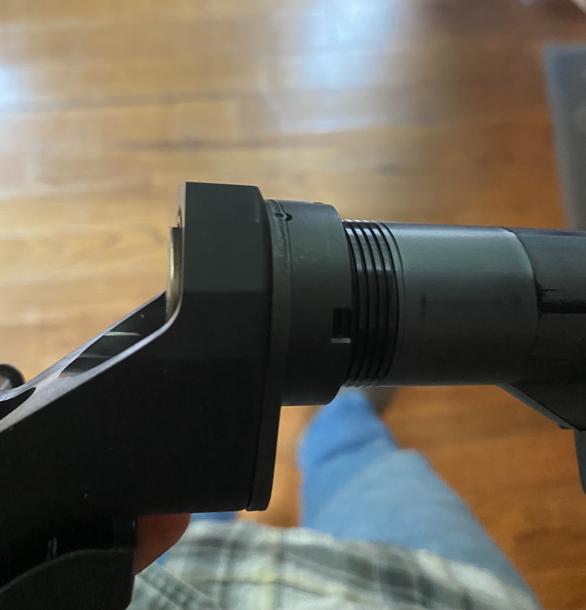

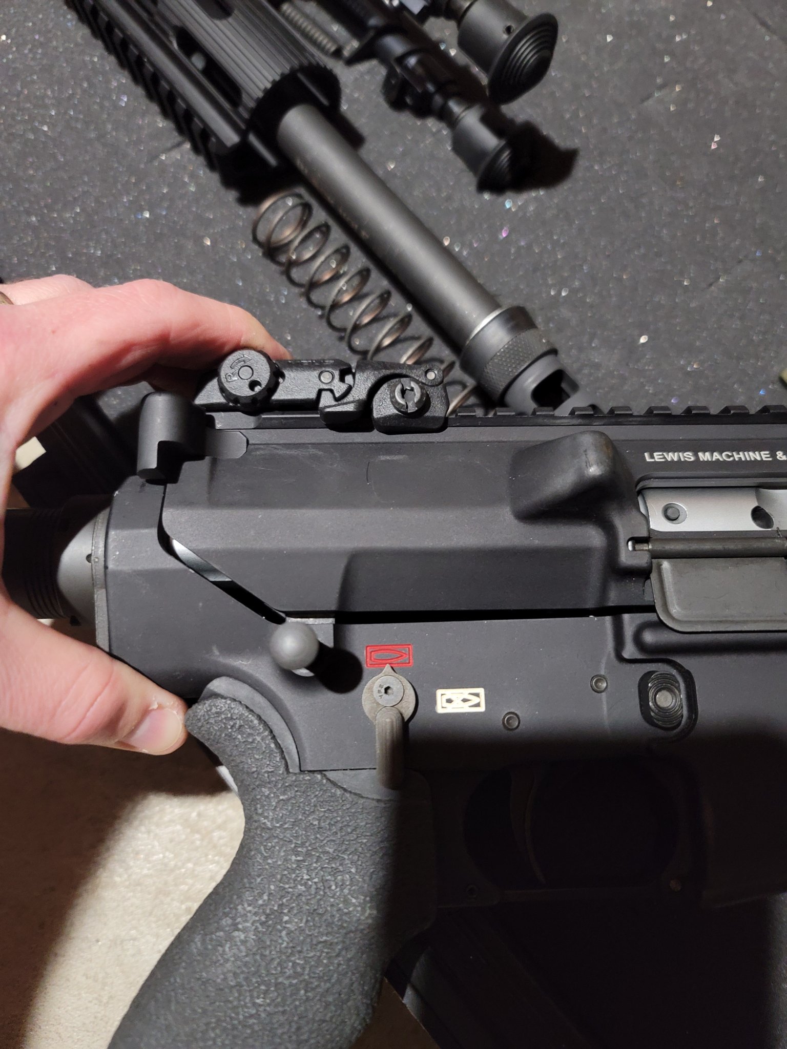

My apologies folks. Factory rifle bought from another member. 16" SS 11.25 twist. I have fewer than 300 rds through it, unknown how many prior to my ownership. I've tried FGMM, Hornady Match 168 and 178, Norma 150 or 155, M80s. None performed worth a poo.
So, you're saying you shoot this gun with 175 FGMM and you're going to get a 9" group?

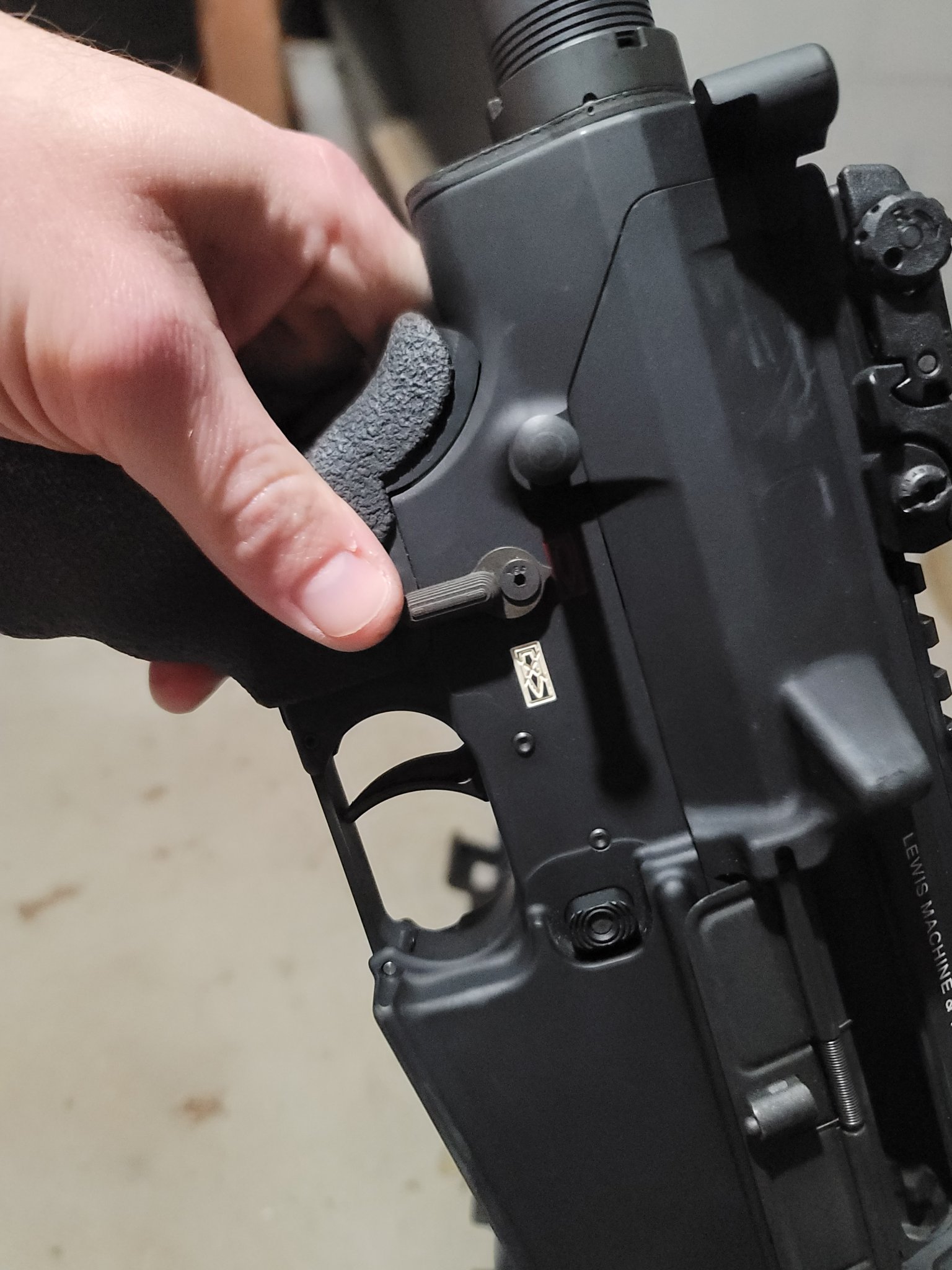

Can you post pics of the recievers not matching up? It's possible you have a lemon that someone else dumped. Probably best to call LMT and have a chat.
Reactions: McCrazy and FALex

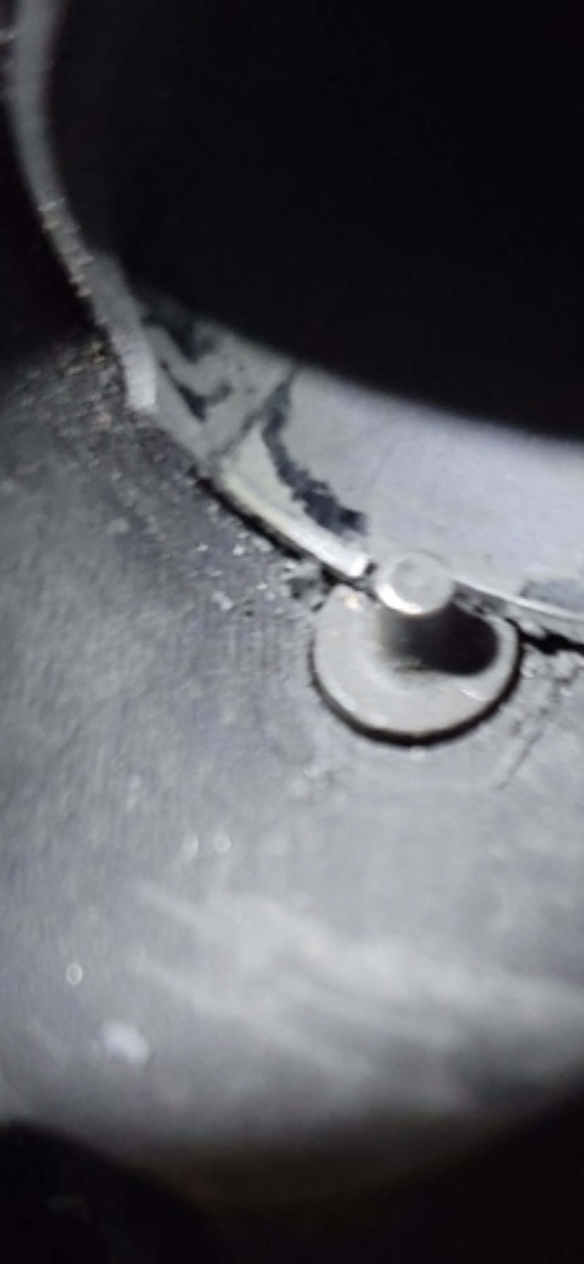

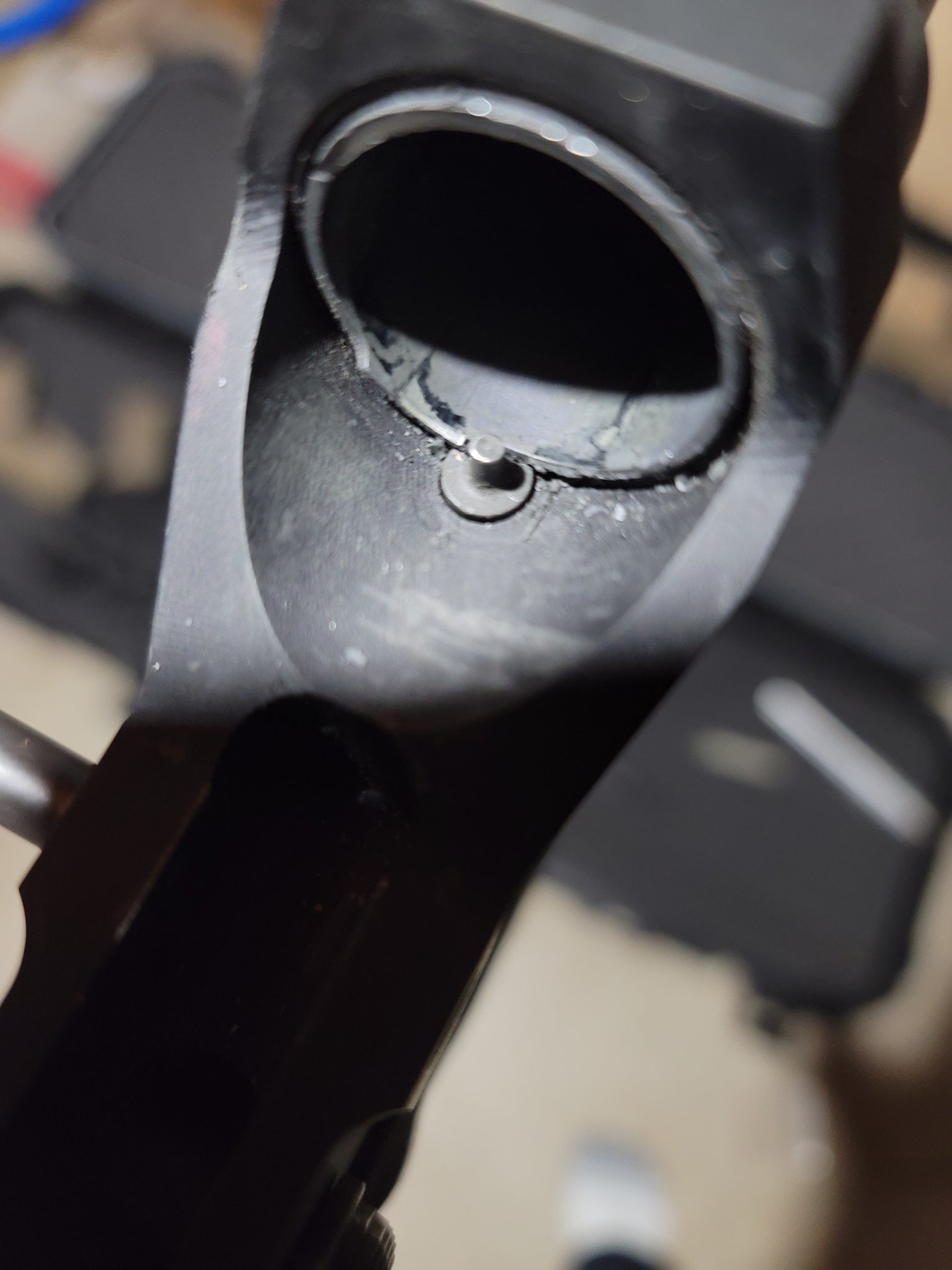

I've had my rifle for a few years but haven't shot it much. (Wife had cancer twice, her mom and brother passed away at separate times, I had neck surgery and a stent. FUUUUUUCK) Anyway, it's never produced anything but shit "groups". I mean, 8-10 inches at 100. Finally broke it down the other day and it looks like the carrier is contacting the buffer tube. There's no marring on the under side of the carrier but the portion of the tune that contacts the buffer retaining pin is somewhat disfigured. Now I can't get the upper to seat right/completely on the lower. Can't even get the rear pin in. Tried removing and retorquing the barrel. Optic is a Gen1 PST 2.5-10X32 in a ADM mount. The optic tracks/works and is torqued fine because I've used it on my 450 Bushmaster for deer hunting. Barrel, gas tube and inside of upper seem fine and align well. No obvious deformation or machining marks in the chamber. I'm not a "sub-moa-all-day" shooter but I can regularly hold 1.5-2" groups with my 16" MRP wearing a RT6. I'll post pics later.

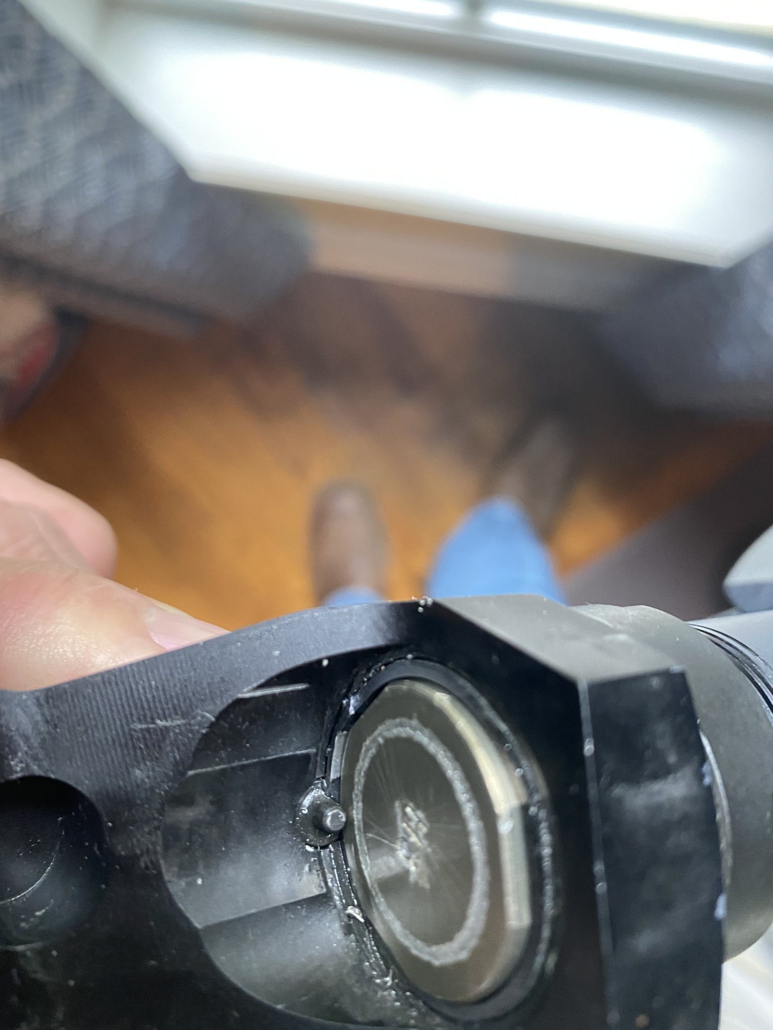

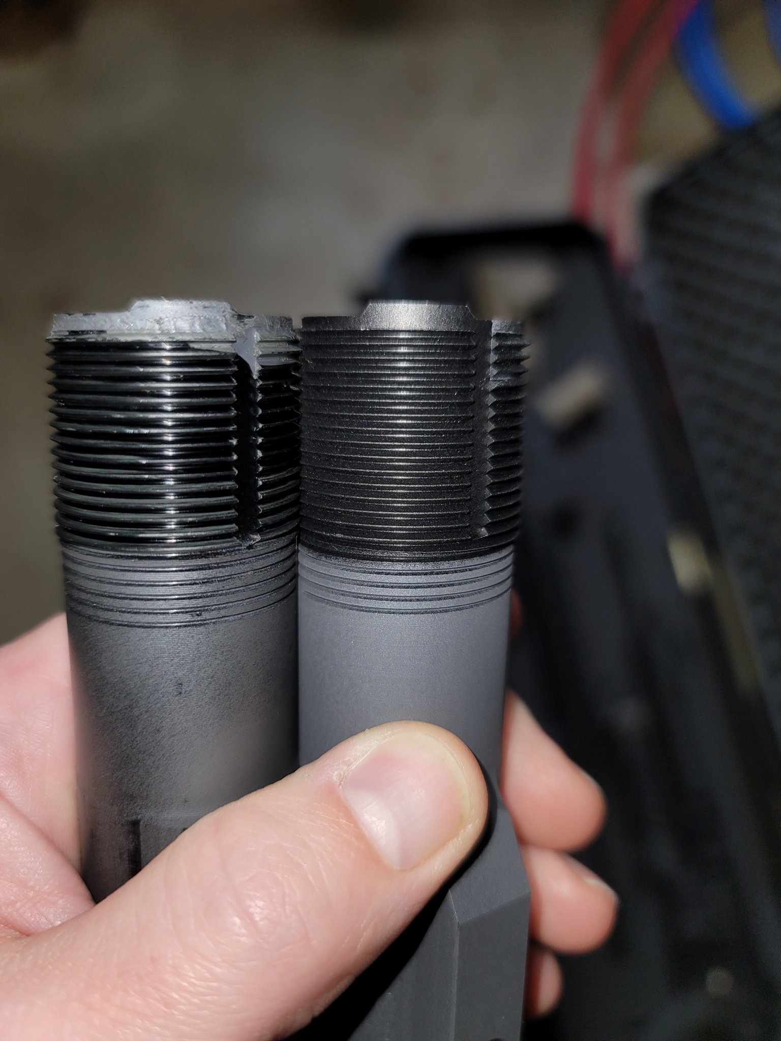

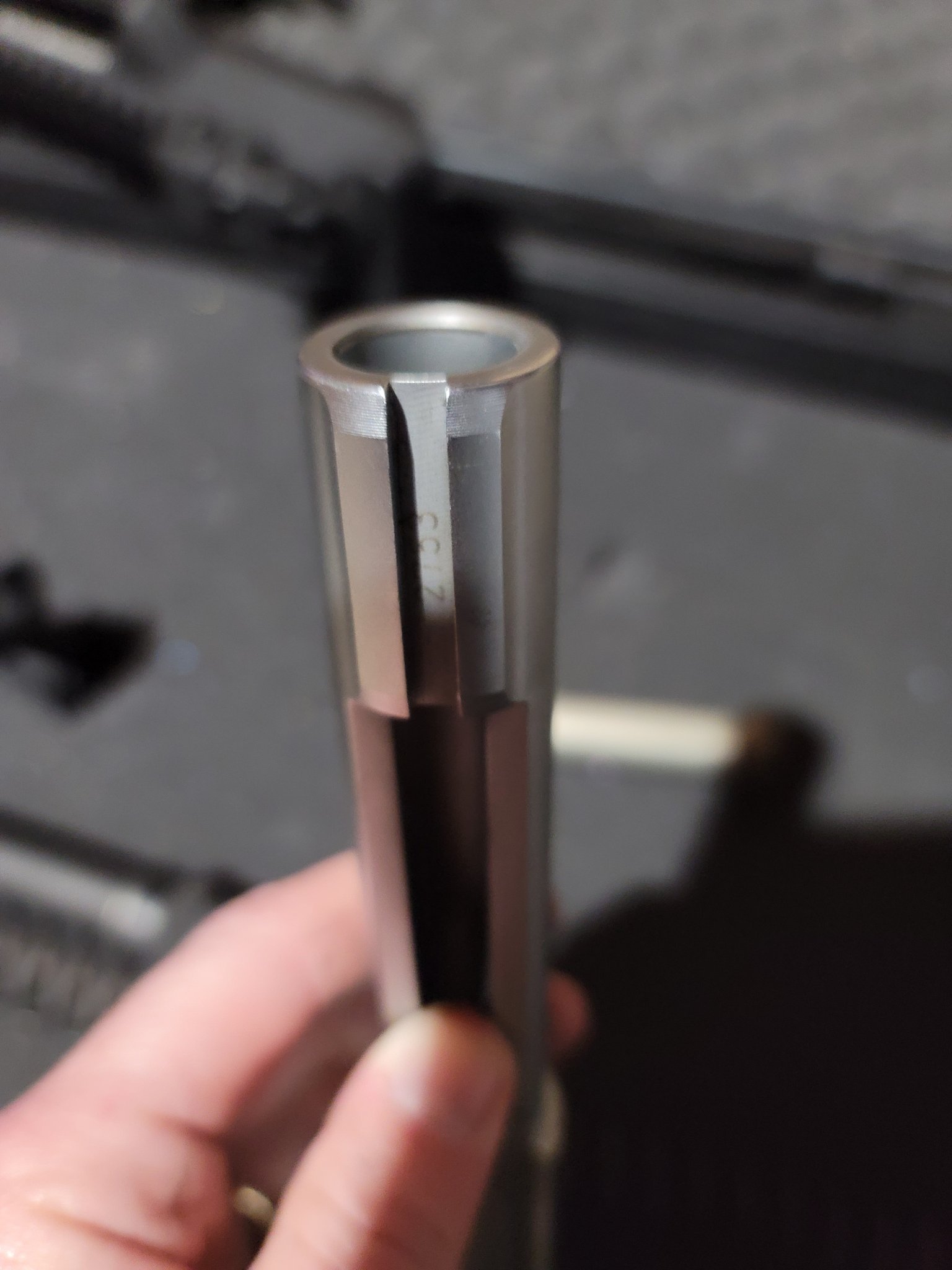

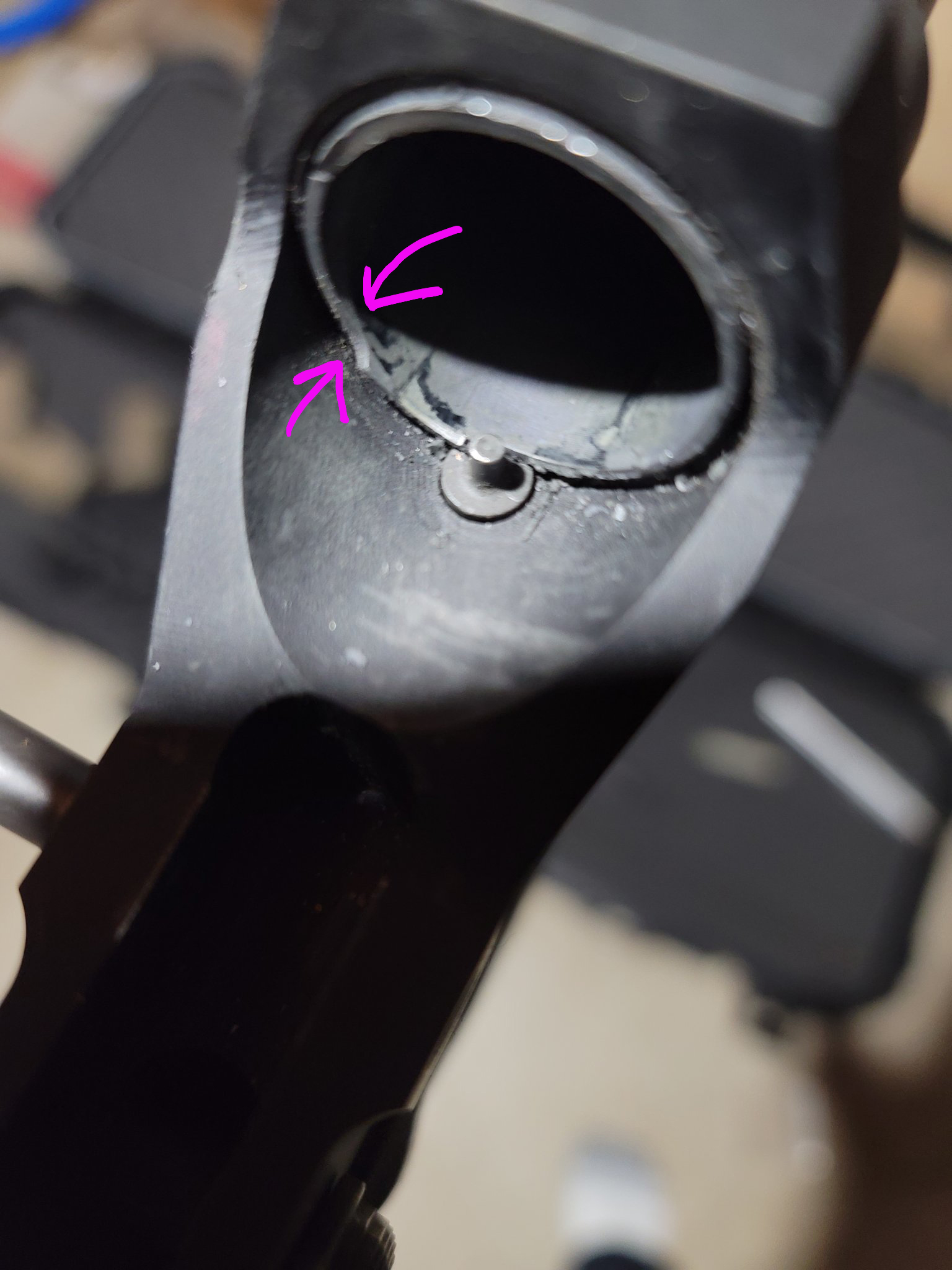

Any chance you could post some pics of what you're describing regarding the damage to the buffer tube, rear of the BCG, as well as the top and bottom portions of the BCG? Pics of the buffer retaining pin would probably be awesome too.
I guess the buffer tube just looks more polished in that area than deformed. It's to the left of the retaining pin. She mates up fine without the bcg. About a 1/4 inch gap with the bcg.

FWIW LRS I'd replace that buffer tube, put it straight into the trash can. Get a nice quality buffer tube and be done with that problem. Recommend you have a gunsmith check it out. Could be several things causing the accuracy problems. With LMT the upper and lower generally mate up perfectly. The BCG should fit and cycle as designed. Sometimes another set of eyes can make all the difference. Best of luck!
I’m trying to figure out what interference is preventing the upper and lower coming together.
The BCG doesn’t add any physical obstruction to the upper - it’s in battery or else you wouldn’t get that far closing it ….
The only point of restance is when the rear of the carrier comes into contact with the face of the buffer, but the buffer should just be nudged back enough , under spring tension, so that the upper and lower come together properly….
From your 4th picture, it looks as though the buffer isn’t moving back when the carrier is pushing against it.
This is the point on mine where the back of the carrier starts to push back on the face of the buffer, is your buffer binding on the rim of the tube as it moves back ?
In your first pic, to the left of the retaining pin, it looks like a swath of metal is missing from the edge of the tube
To anyone wanting to know if the 8” Area419 arca rail will mount up. It’s money. Thanks VS for the original idea.

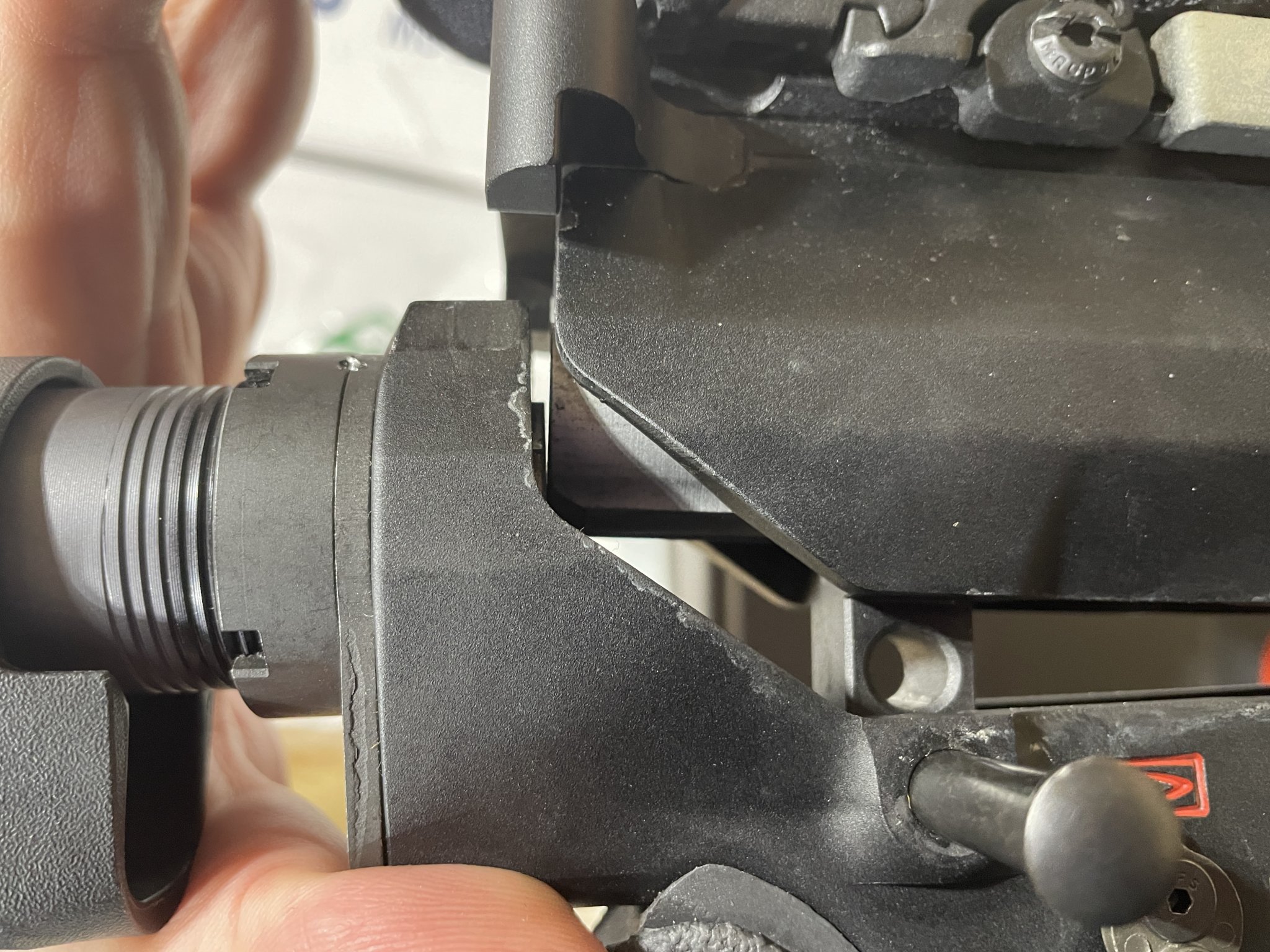

From your 4th picture, it looks as though the buffer isn’t moving back when the carrier is pushing against it.View attachment 7838244

Is that a factory gun or a build? It looks like the receiver extension is threaded in 1 thread too deep.
In the pic it looks like the extension was filed to fit around the buffer retainer or broken off if zoomed in. The extension should be behind the pin, not around it. You’ll probably need a new extension to get it right.
Your pic above. Mine below.
Another of your pics seem to show the extension threaded into the receiver. It shouldn’t be that way. The carrier is probably hitting the extension.
None of this helps your accuracy problems though. It may just be a bad barrel causing them. Hope you get it sorted out.
You can get it back together as is. Remove barrel. Put the receivers back together. Re install the barrel.
Another of your pics seem to show the extension threaded into the receiver. It shouldn’t be that way. The carrier is probably hitting the extension.View attachment 7849522
Plan on getting out this weekend to see how she runs with a new buffer tube. The old one on the left had the first thread stripped so it HAD to be threaded in one additional rotation. I also bought one of the $500 LM8 uppers. If none of this helps, it almost has to be the barrel.
Reactions: Jsp556
Talked to a tech at LMT. My rifle was built in 2010. I bought it second hand a few years ago but haven't shot it much. Had issues on my first range trip and never got around to diagnosing things. Wife has had cancer twice, her mom passed away, I had neck surgery, then a stent, her brother passed away... It's been quite the shit show. Anyway, in the time since it was built, who knows how it was stored. Did the original owner store it in a damp basement which pitted the barrel? Did I jack it up letting it set for so long? I kept it stored with the rest of my guns that all shoot well but I don't rule myself out as the culprit. There's just too much possibility that the issues arose post production.
Is it a Chrome Lined barrel? I feel like it'd take some deliberate negligence to mess up the barrel. They do sell cheapo bore cams on Amazon you can use to check your bore and throat.
