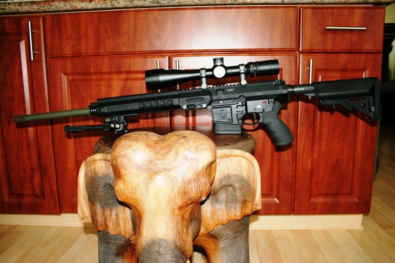

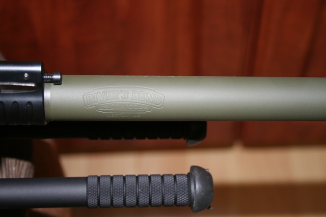

An LMT MWS with one of his barrels .this one being a 6.5CMView attachment 7097292View attachment 7097293
That pretty cool. Jeff’s a good dude. I had him do some work on one of my rifles. I got to stop in to his shop when I dropped my rifle off and ended up spending about an hour in there BSing. That multi cam cerecoat AIAX of Lowlights was in there getting ceracoted by Custom Gun Coatings (aka shortbus) at the time. Jeff does great work, I had forgotten about his MWS barrels.
