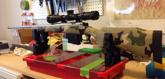

1. K&K Customs Rem 700, Fluted #4 Bartlein, 1:8.5" twist @ 24". Gen II Little Bastard brake (replaced Vais Micro)
Micky A3, Surgeon DBM w/Accurate & Alpha mags (have a B&C Ti stock to swap into for back-country hunts)
"new" 6.5 GAP 4s reamer, .2962" nk
Premier Lite Tac, lit Gen2MD, Seekins' 20moa base & low rings
2. H-1000, 61.0gr
3. WLRM primers
4. Norma 300SAUM brass (prepped by me) .291" Ti bushing to resize
5. 140gr JLK (moly coated by me)
6. 2.910 (.005" off lands)
7. ~3010 avg, single digit ES (via Magnetospeed V2)
8. don't measure groups to nth degree, but its <0.5moa
9. Taken one whitetail with this load @ 340yds, bang/flop passthru both shoulders
Photos:
Rifle in current A3
Last chrono confirm, over the weekend
Doe laid out @ 340yds, thru Bushy Elite scope
Exit wound, 140 JLK

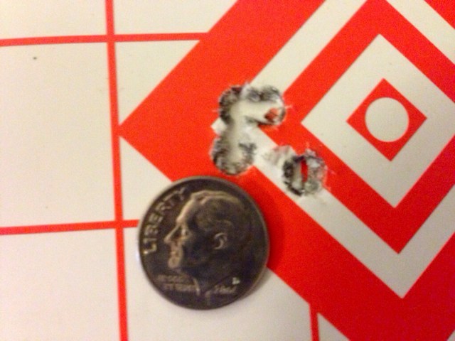

1. *6.5 SAUM new reamer, *Stiller Predator, Stiller DBM, Accurate mags, Bartlein 5R, 1:8.5-24" finished with Vais brake, Mcmillan HTG Mcmillan camo, Jewel trigger.*
2.* H1000, 61 grains.*
3.* Win mag primer.*
4.* Rem 300 SAUM brass necked down with Pat's model.*
5.* Berger 140 hunting VLDs.*
6. 2.090 BTO.*
7.* 3035 fps, magnetospeed v3. *
8.* Best groups are the size of a dime at 100 yards. *I'm still forming the rest of the brass.*
ImageUploadedByTapatalk1406826158.840331.jpgImageUploadedByTapatalk1406826168.722728.jpg

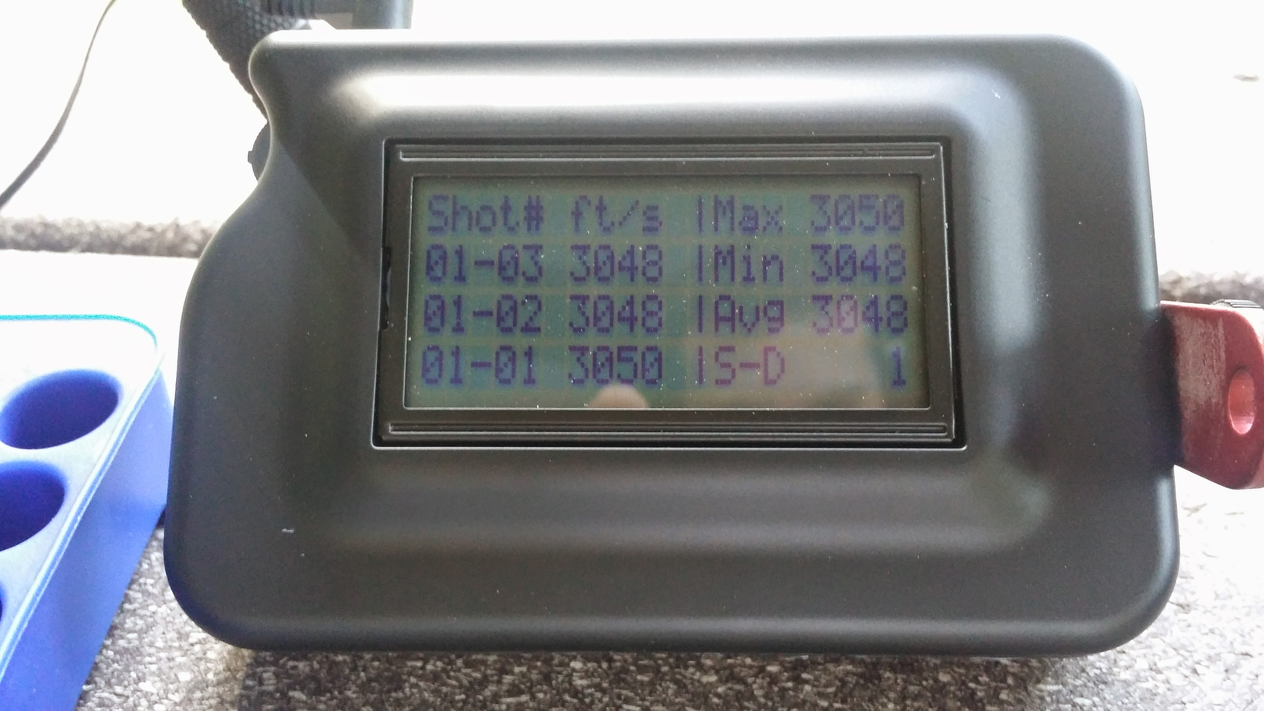

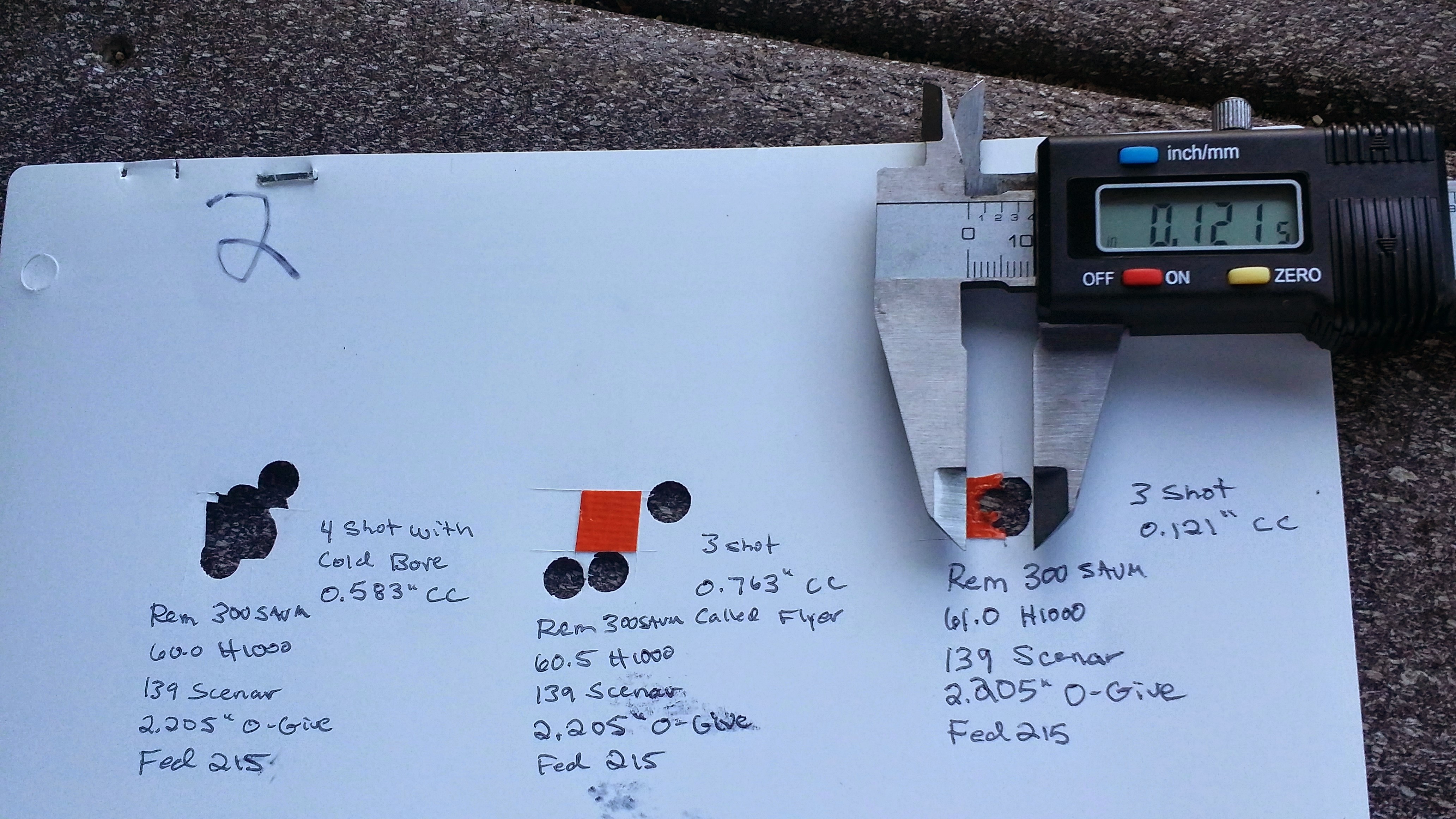

139 Scenars are looking good so far in my new rifle
Rem 300 SAUM Brass
61 Grains H1000
139 Lapua Scenars
Fed 215 Primers
2.205'' OGIVE (0.015'' jump)
3 Shots @ 61.0 Grains H1000
Ave: 3048FPS
St Dev: 1
