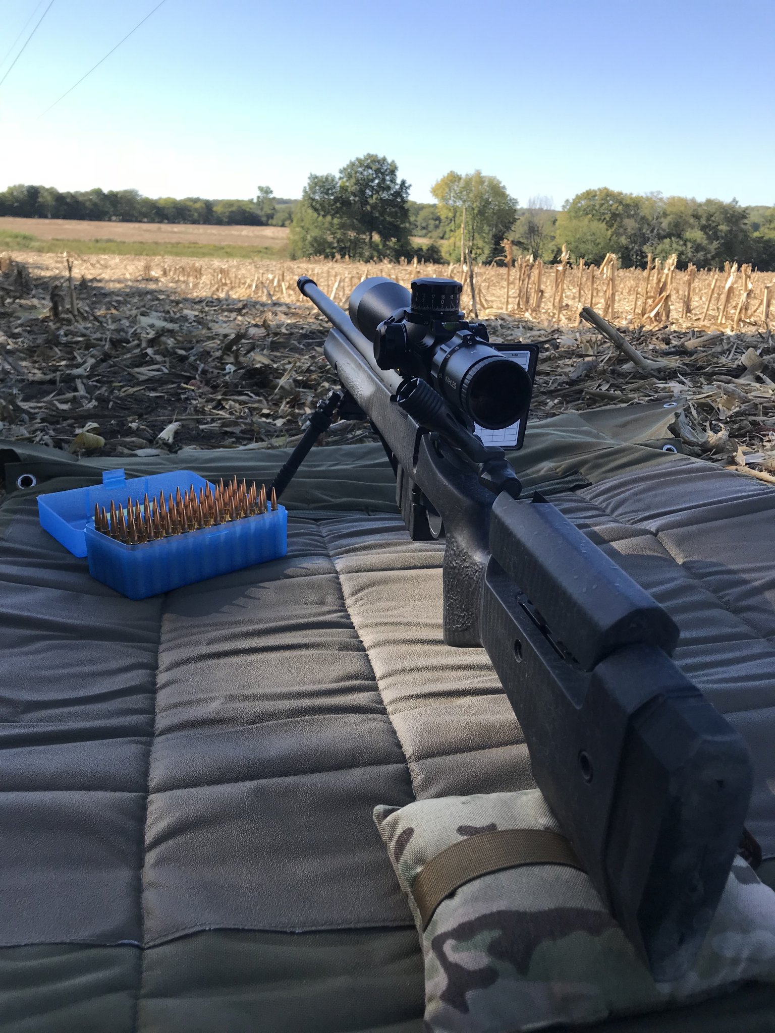

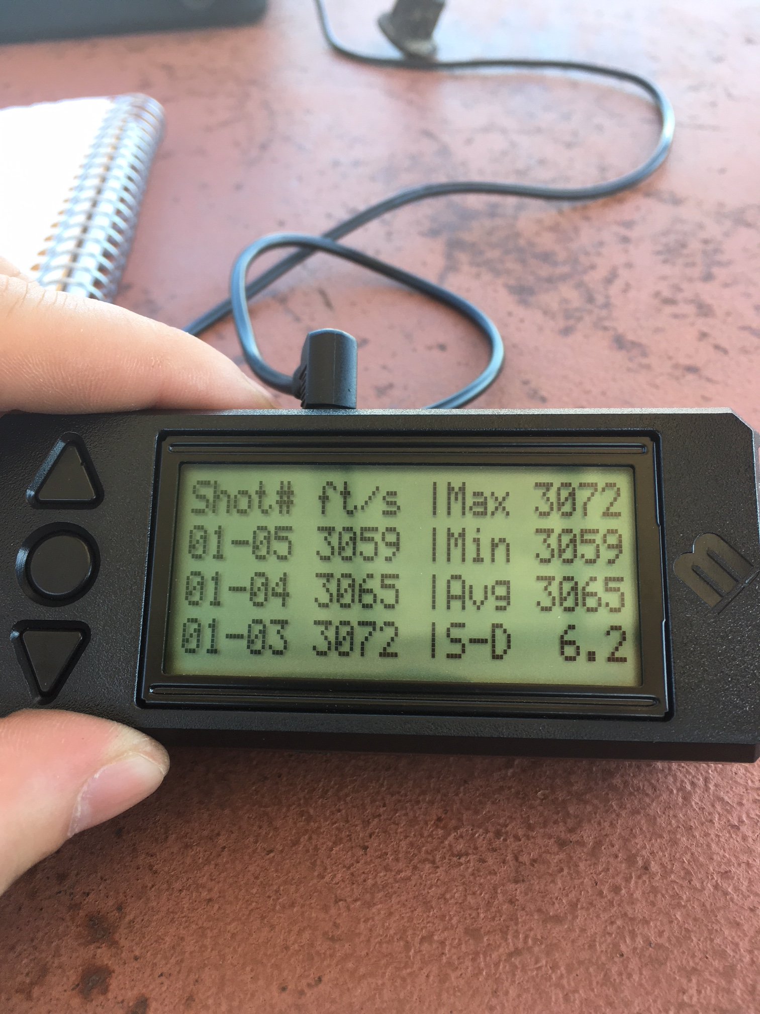

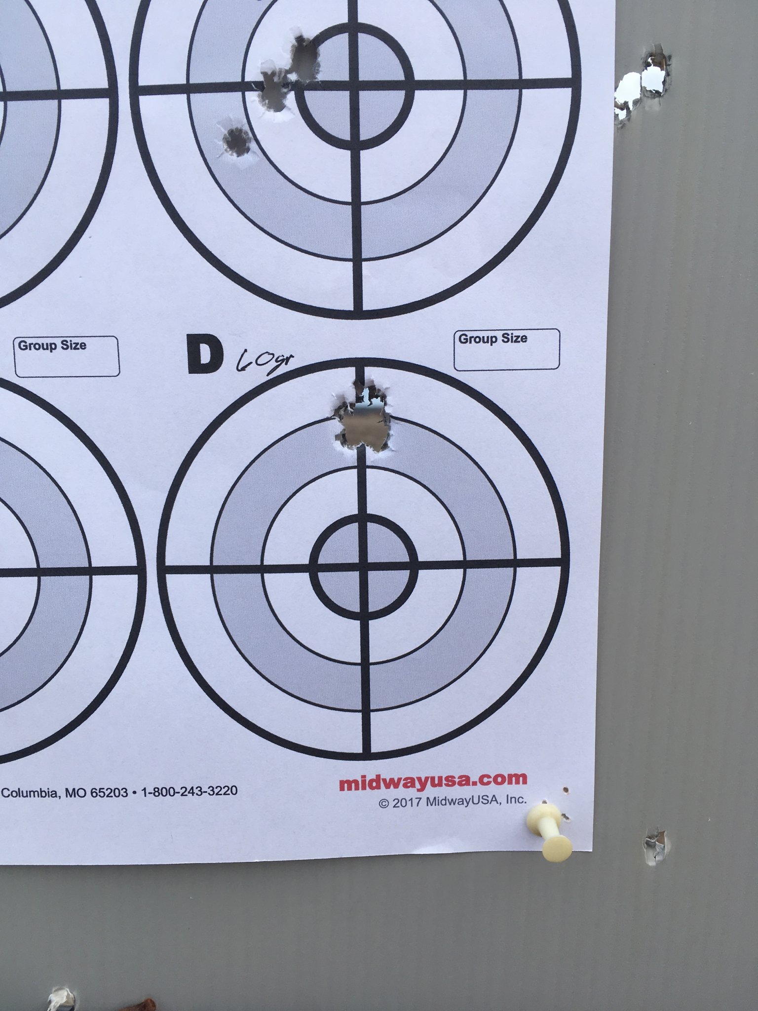

Finally got around to doing some actual load development for dad's gun. We switched from the Elite Hunters to 143gr ELD-X. I ran them 10 thou off the lands from 58.5-60gr of RL26. 58.5gr and 59gr groups were okay, probably could've been a lot better but it's hard for me to jump right back into shooting and calm down and do well. Velocities out of the 23" tube were as follows.
58.5gr - 3007fps average SD - 17.9
59.0gr - 3011fps average SD - 15.5
59.5gr - 3029fps average SD - 4.2
60.0gr - 3059fps average SD - 4.2
60gr produced some ejector marks though so did 61gr of h1000 and did 58.5. Primers seem fine, bolt lift was fine. I've got some of the latest brass as backup as these 60pcs i have are 50pcs of the second gen and 10 of the first IIRC. They're holding up thus far though without issue. I've got everything written down to see how the velocity changes next winter. Hopefully not too much as i was shooting for 3050. Gun has 120rds on it though so i'm expecting it to speed up at some point.
Group was looking more promising but i'm not the best shot to begin with especially after a months absence and it being a magnum, so i'll happily take it.

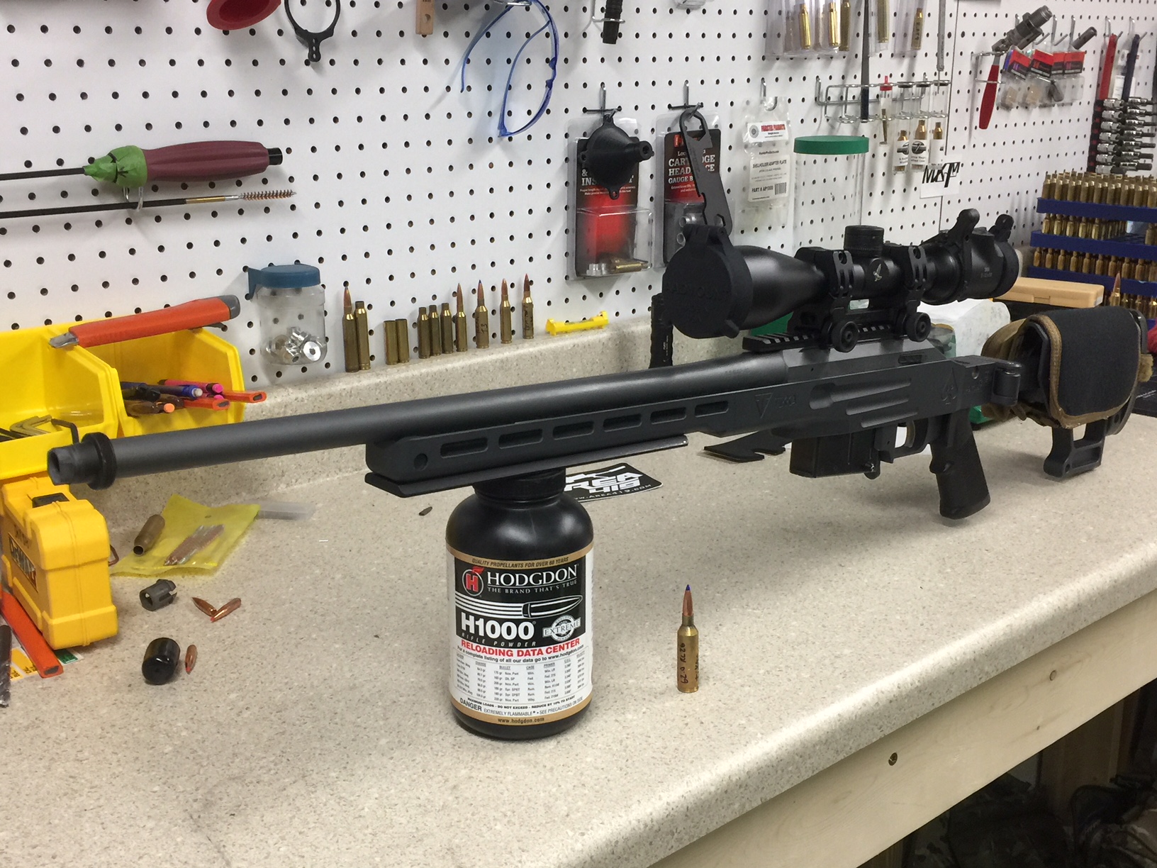

Have a new 6.5 4S. 0.296 neck, 0.081 freebore, 22" 1-8.8 brux. Starting with Rem .300 cases. Plan on starting at 54g R26, and 58g h1000, with 140 amax seated 0.015 off to sart.
Only had time to run the H1000 ladder. 61.5 gr only got me 2800. To be fair, my H1000 is 10yrs old, but I was surprised at how slow the load was! Will try some R26 next.

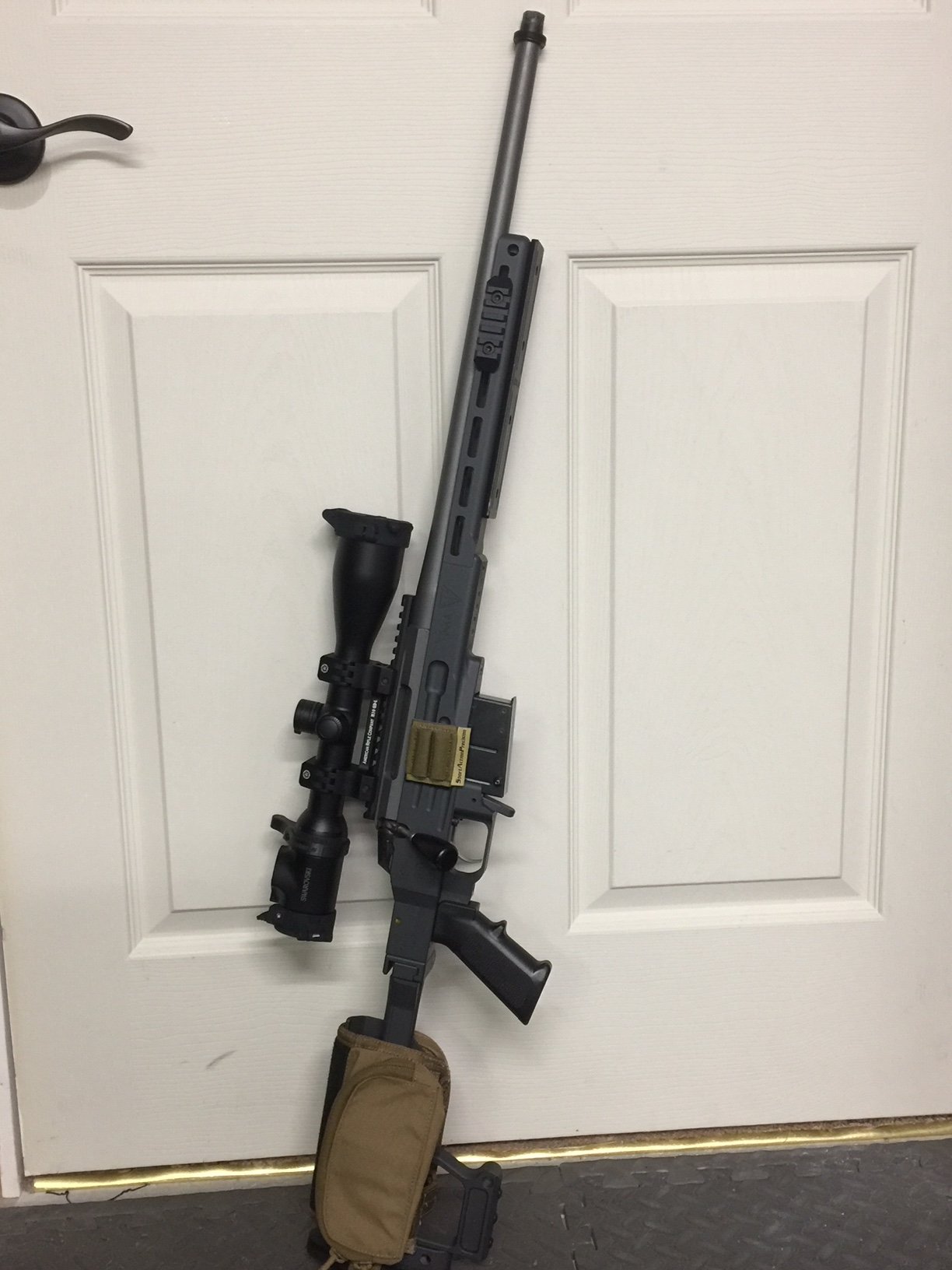

I also have a GAP barreled Tikka with a Bartlein 3B 20” barrel that rocks this caliber. It’s a real handy hunter.
7mm SAUM brass necked and turned
Berger 130 VLDH 62.0 gr RE-26 at 3150 FPS with the 20” barrel.
Barnes 127 LRX 62.0 gr RE-26 at 3090 FPS with the 20” barrel.

Sure - I am using the Barnes LRX and Berger 130 Hunting. Hard to beat the 130 gr at 3150 from a 20" barrel. Lightweight, minimal recoil.

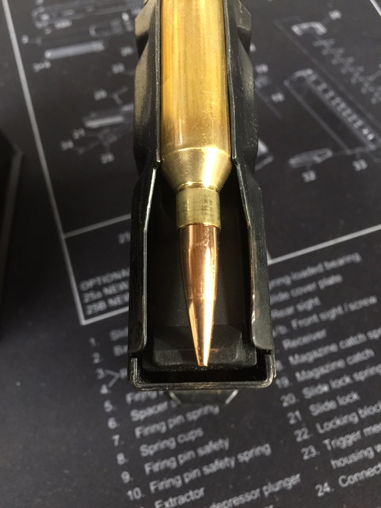

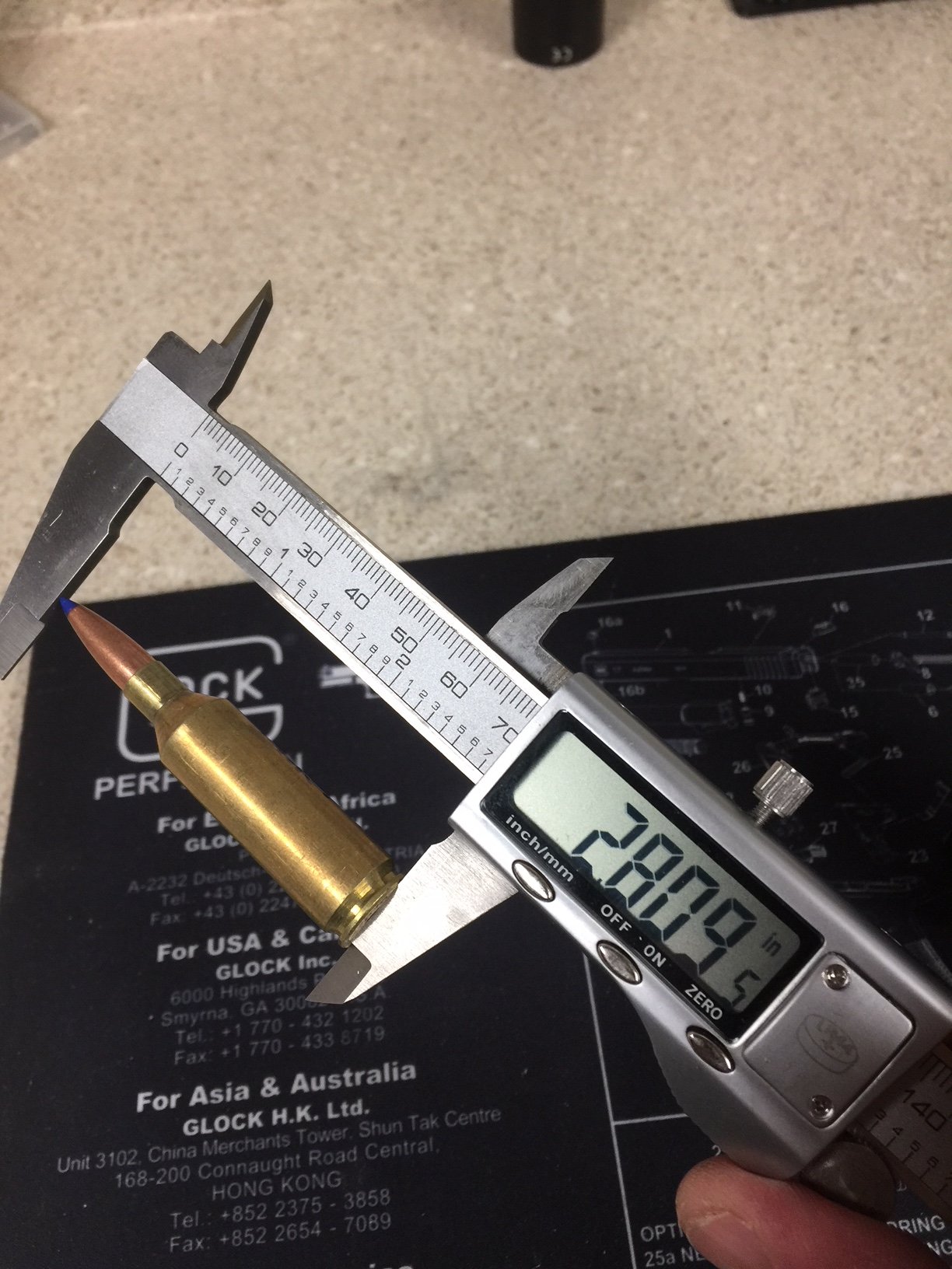

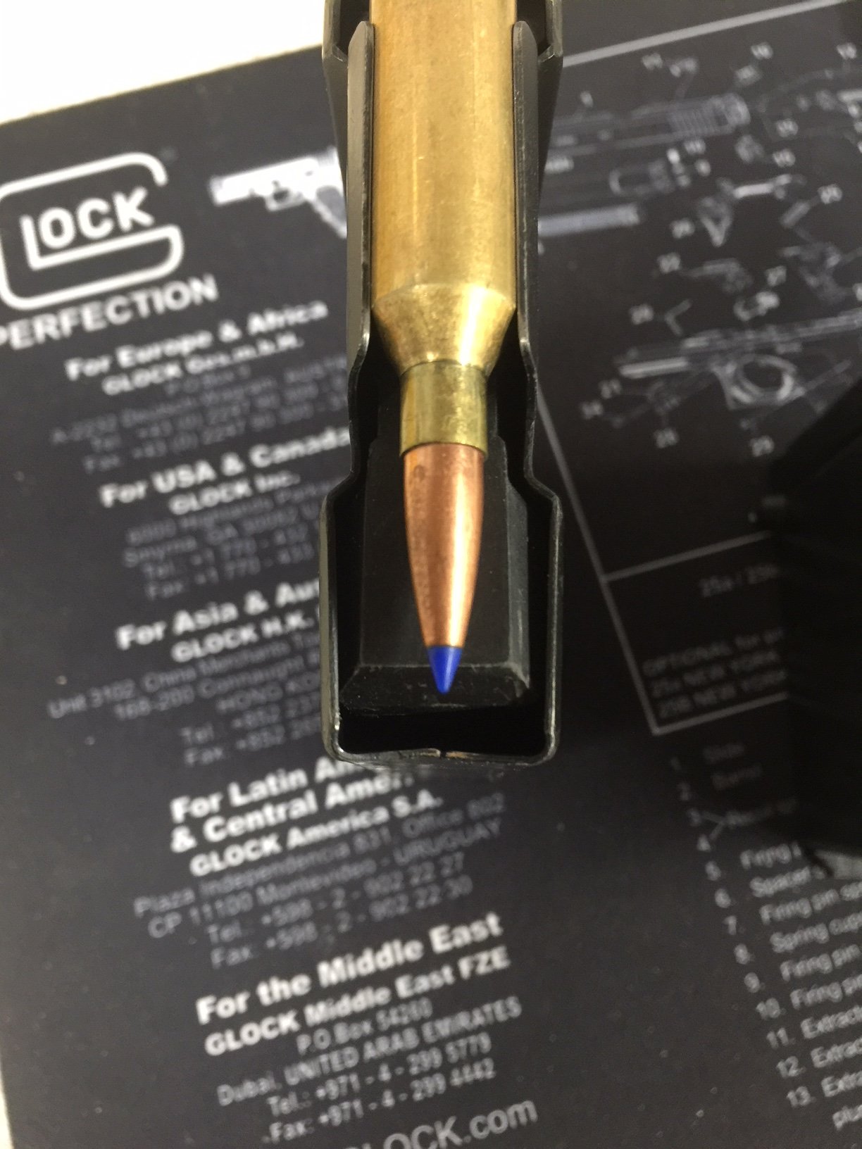

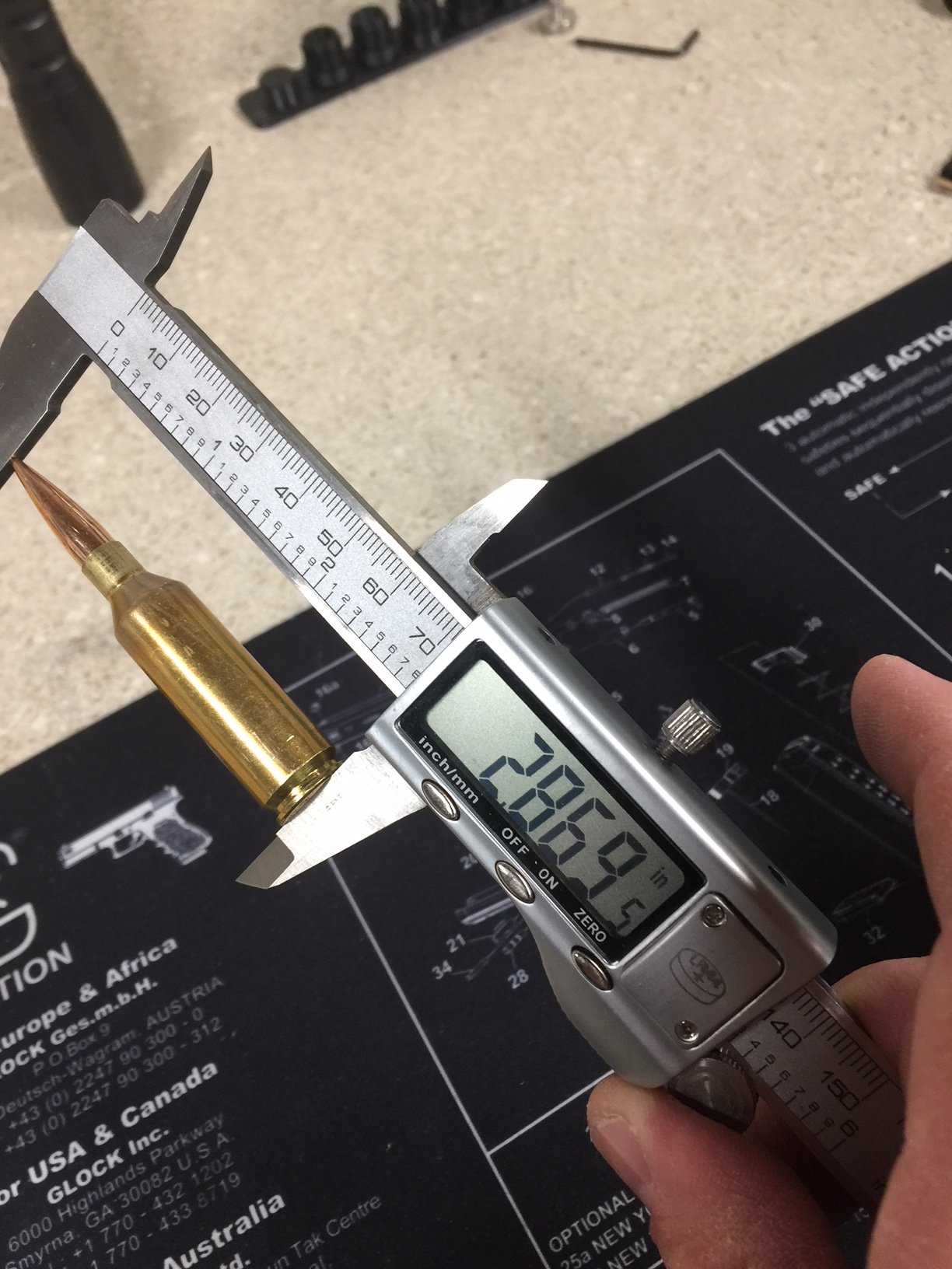

With the Berger 130 VLDH, the OAL is 2.869 and I am getting close to the edge of the factory CTR magazine.
With the Barnes 127 LRX, the OAL is 2.809, and I have plenty of room, though this is in an Accurate Mag 300 WSM magazine.
At some point I think I would like to put it into a Manners stock to get back to a traditional hunting setup.

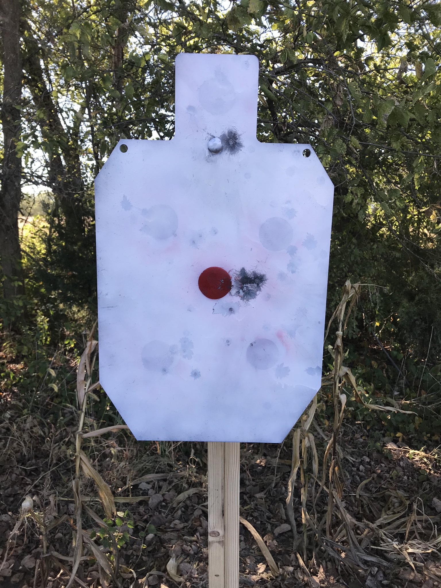

First little bit of testing done today, I failed a little too conservative but I can live with that. It'll be Monday before I can get back out and push a little farther. The barrel only has 111 rounds through it including these 11 in the pressure test, I wouldn't be surprised if it still speeds up a little more on it's own.
