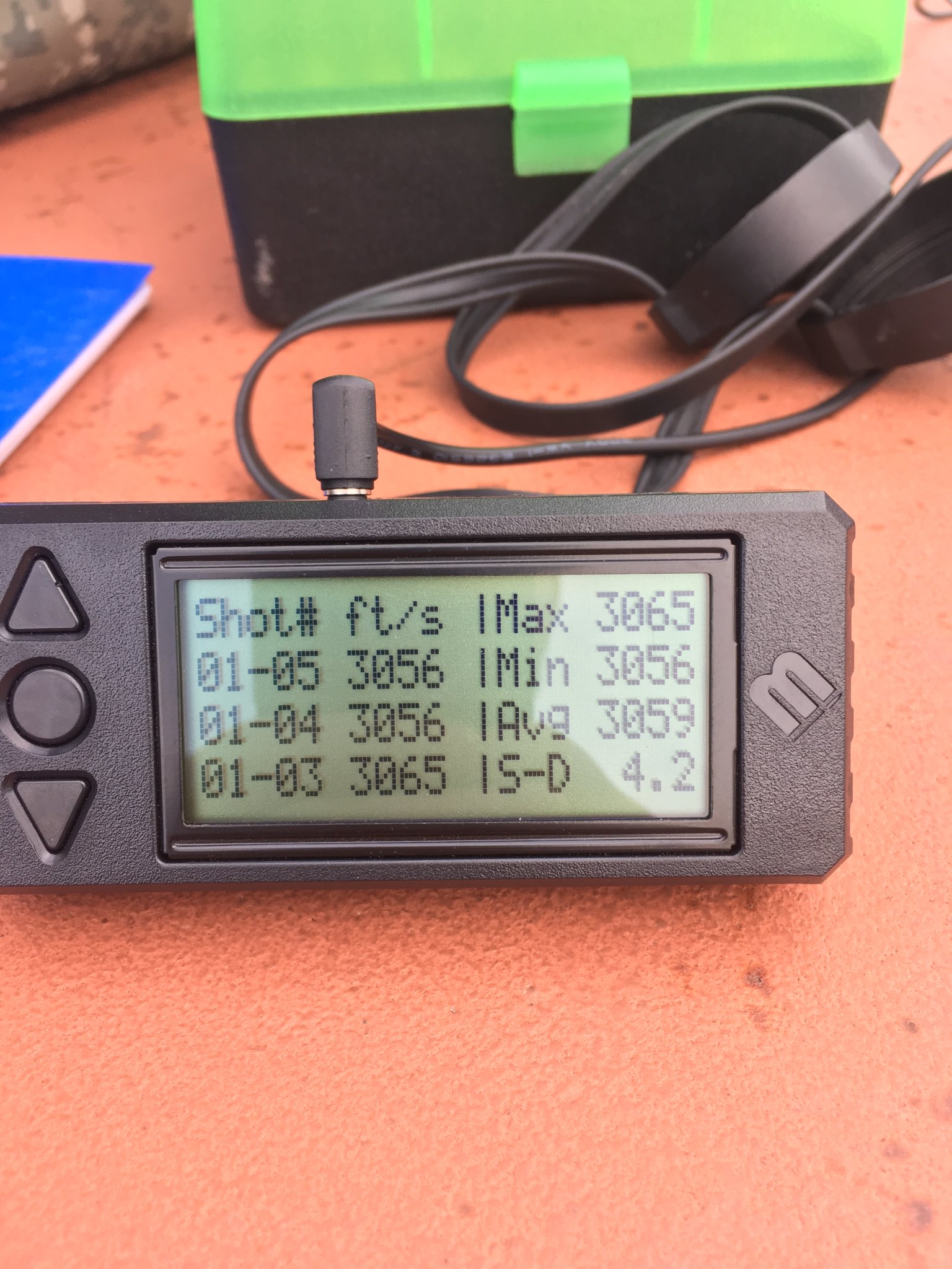

60.0gr - 3059fps average SD - 4.2
60gr produced some ejector marks though so did 61gr of h1000 and did 58.5. Primers seem fine, bolt lift was fine. I've got some of the latest brass as backup as these 60pcs i have are 50pcs of the second gen and 10 of the first IIRC. They're holding up thus far though without issue. I've got everything written down to see how the velocity changes next winter. Hopefully not too much as i was shooting for 3050. Gun has 120rds on it though so i'm expecting it to speed up at some point.
