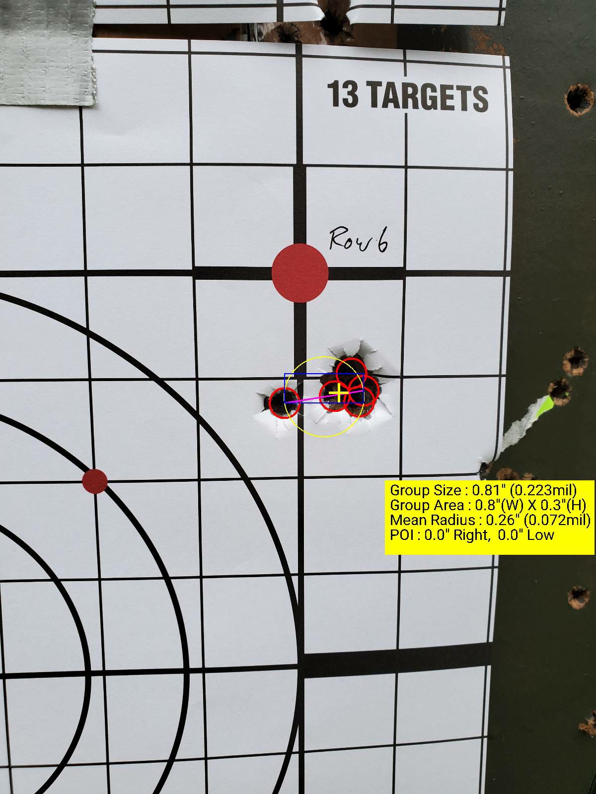

42.0 of 4064 is my go to for the 175 in hornady brass out of my factory Savage, .3 MOA if you exclude the flyer and .8 if you count it. You're right on the money.

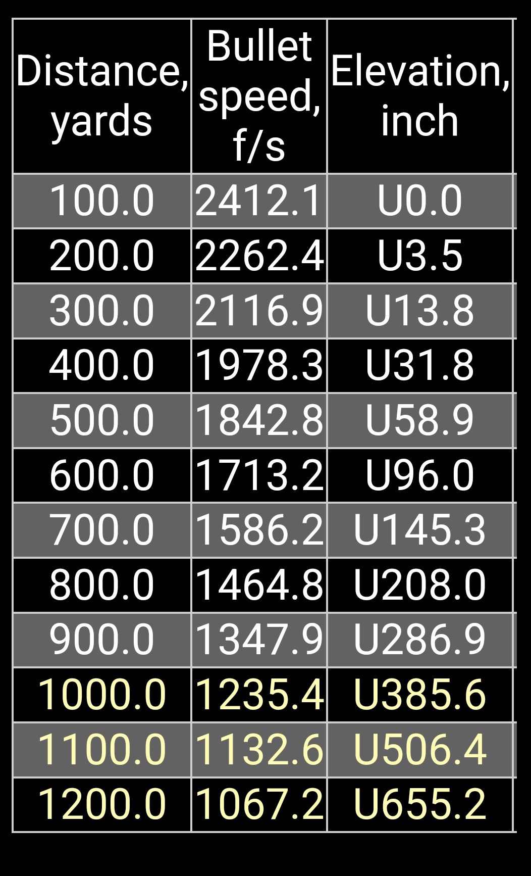

I’ve see this program a lot on here where do I find it?
Has anyone tried the Lapua 167 grain bullets in the 308? I cannot find any B/C published for them as well.
That one is an app called Range Buddy on Android, not sure if it's on iPhone but I imagine it is. It's a little unintuitive at first but with some fidgeting and hitting random buttons that look like what you want it works well.
Another one I see a lot over on reddit is Ballistic X but I havent personally used it.
