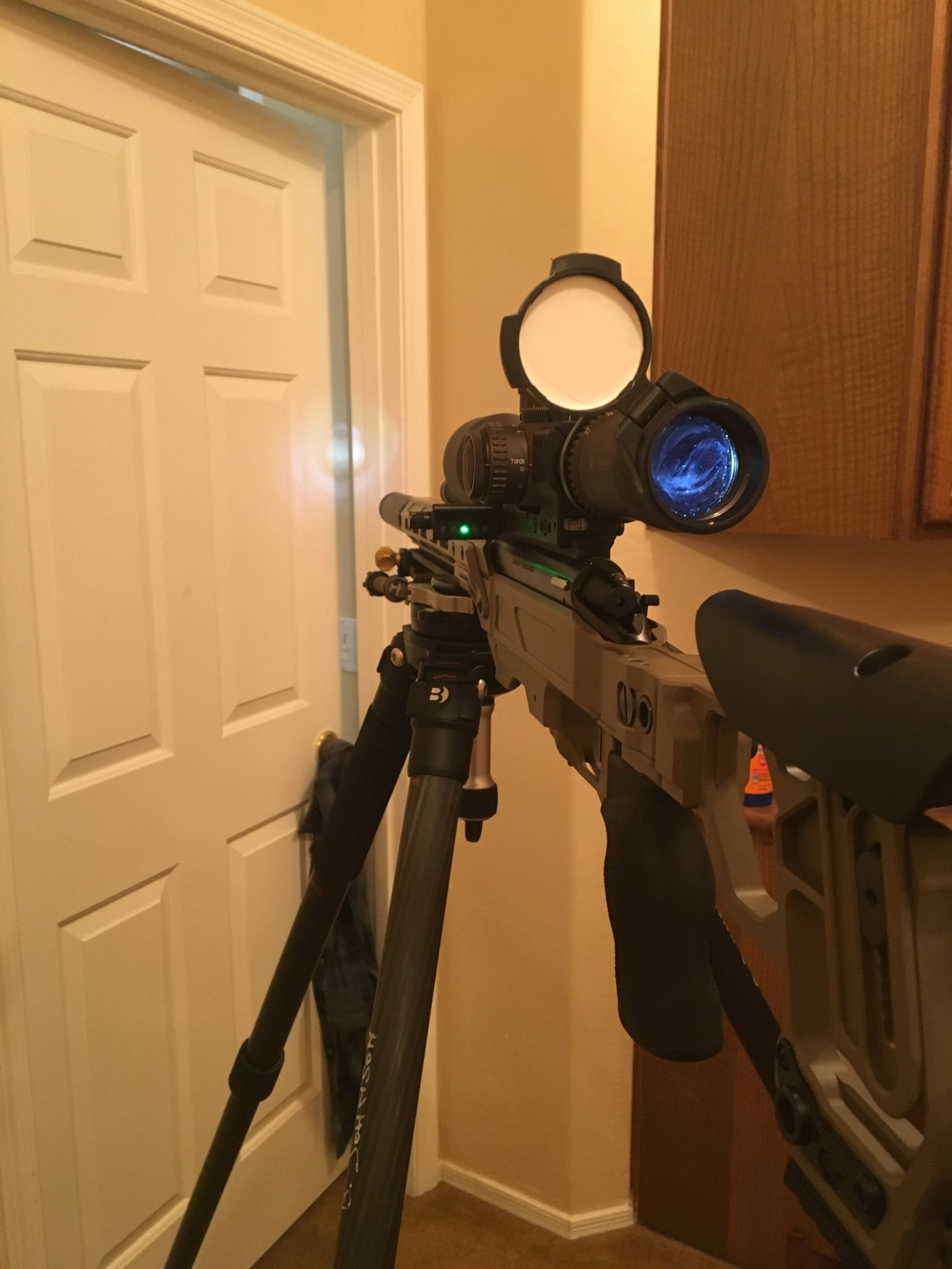

I shoot subsonics with a high trajectory, I have 25moa scope mounts and my scope heights is 3.25" .... all three of these situations exacerbate canting errors and POI shifts so I am trying it out, especially for a nighttime vehicle like mine, where a bubble is worthless because you cant see it. Ill post more when it gets here and after I try it out. I am planning on a verticle mount as previous member suggested

Its perfect for nighttime and this model can be mounted left,right,top or upside down. device remembers all 4 settings. sensitivity adjustable, dimmable, auto off. Im all-in, true badd @ss level.

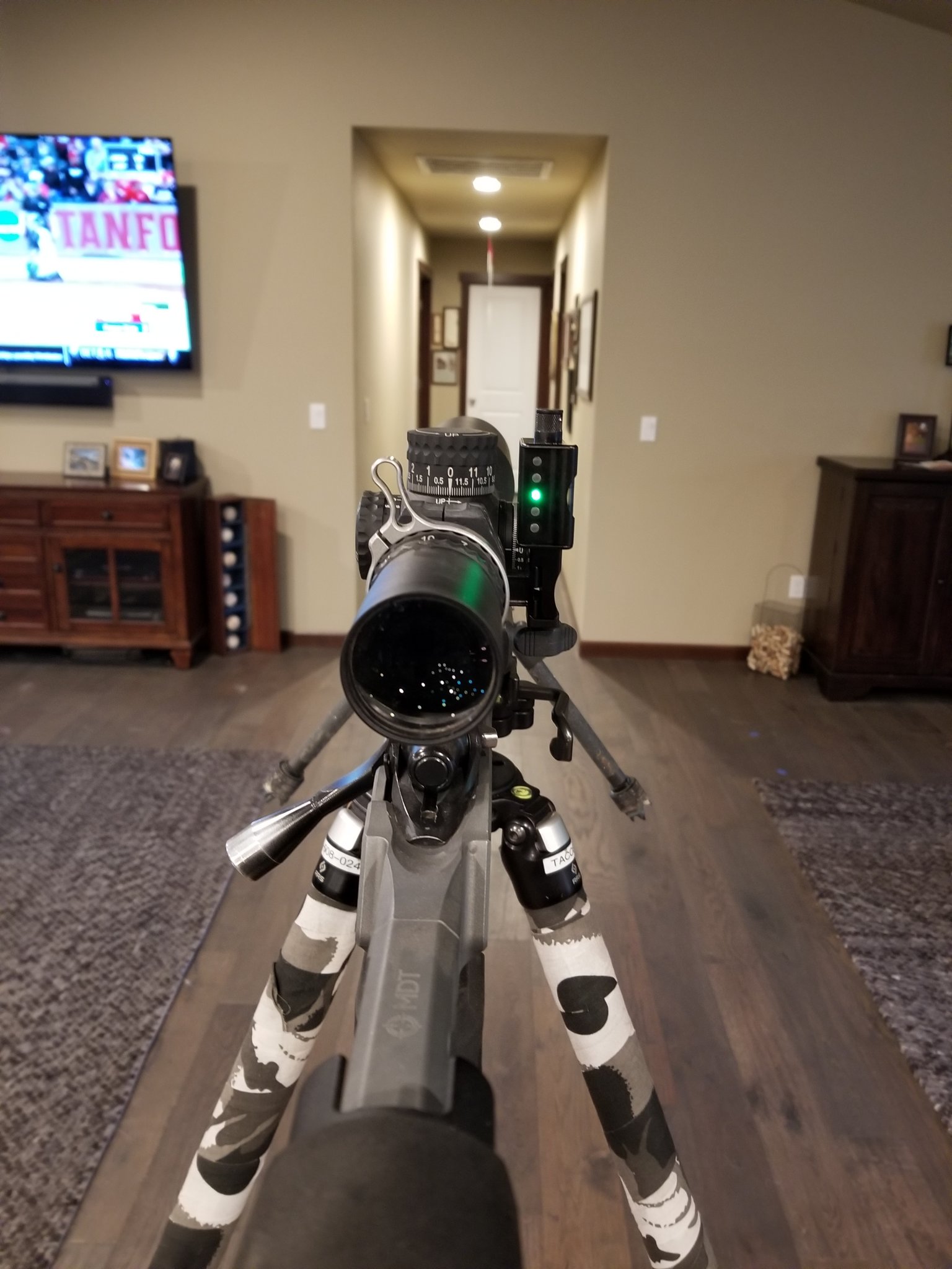

I've got one of these mounted on the left side off my Spuhr mount using a Pic rail segment. I use the bubble in the Spuhr mount to get in the neighborhood of level, turn the Send-It on, and use that to get perfectly level. I have it mounted vertically on the side, and I ordered the smaller version without the bubble in it for that very reason.
For the LH guys, it'll operate correctly in the vertical orientation with the knob up or down, so you can mount it on whichever side you like as long as you're okay with where the knob is. I ordered mine from MHSA almost 2 years ago so hopefully they've since come out with a left-handed version for anyone wanting to mount it horizontally.

I mounted a 3 slot rail on the right side my Manners T4 and mounted it vertically. It is nice being tucked into the rifle close. I figured I would come up with a better solution later.

I've used one for about 6 months now, works great. Hung it vertical on Spuhr mount. Mounted it 1st with just the Spuhr A-0003 Pic rail, it was touching my Deviant Action causing it to list a little and put it in a bind, didn't feel that was right. So, got a Spuhr A-0001 spacer 0.16", Now have clearance. I shoot my 6.5CM from 100-1200yrds all the time with it. Easy to open my left eye and see the green or adjust a touch and its right on. Has not ever distracted me and I have set on the brightest setting. Oh sorry, have been distracted a few time when someone comes up and ask me "whats those lights for?"

I run one left side, vertical. I’ve found it to be very easy to use and intuitive especially for helping my spouse, son and others learn fundamentals. I like that it’s so easy to know when you’re “there” and it acts as a reminder to check rifle cant it if it’s not green (LED color for “Send it”).
