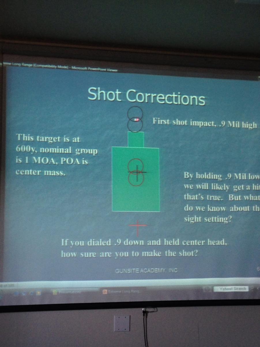

Gunsite as an excellent presentation on some variations and how they can move the poi high, low, etc.

The presentation that Frank posted a slide from (above), given by Cory as part of the ELR class at Gunsite, is an eye-opener on the issues of hit percentage at ELR and the method/ability to effectively determine and make corrections. Anyone interested in the problems unique to 1000-2000 yards should consider taking that class. It's money well spent.
