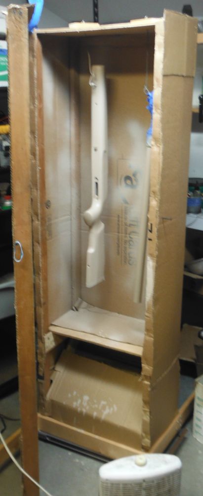

Very happy with the results, but cannot wait for 90 degree weather in Seattle, so I made a paint box from cardboard, sticks, a hot plate from Salvation Army, a blanket, a staple gun, and a meat thermometer.
Brownells is very helpful in email, on the phone, or in their reference information.
