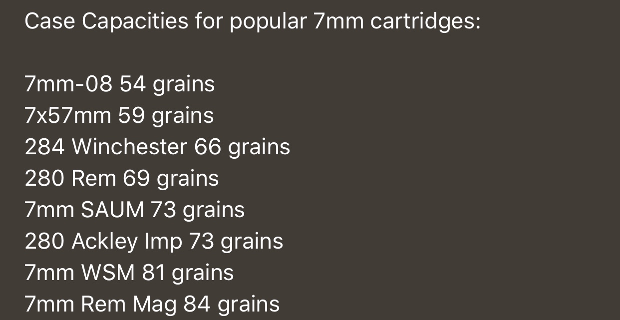

    280AI can do everything my 7 saum can do and my 7 saum has gotten me hits at two miles so far.
    It’s a great ballistic compromise of Bc and speed with minimal cost and recoil.
    I really don’t think anything else with a .473 boltface can complete with a 280AI for ELR.

    28” barrel 7 saum with regular chamber pushing 190 Berger’s at 2880.
    I actually single feed them in a short action.

    Ah, gotcha. I read your post too fast, haha. Thought you had a 280 and were comparing it to a SAUM.
    I'm guessing case capacity is about the same between the two. Have you smoked a barrel yet?
