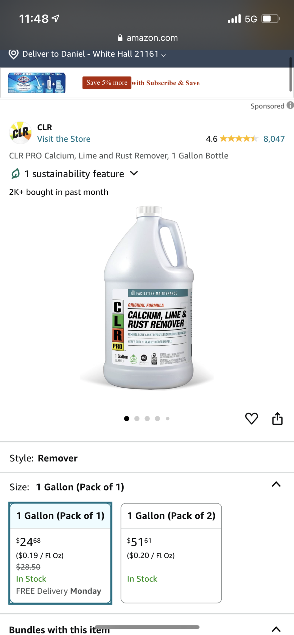

What’s the mix ratio one should use?
And is this the stuff?
Not sure if that’s a good price for it.

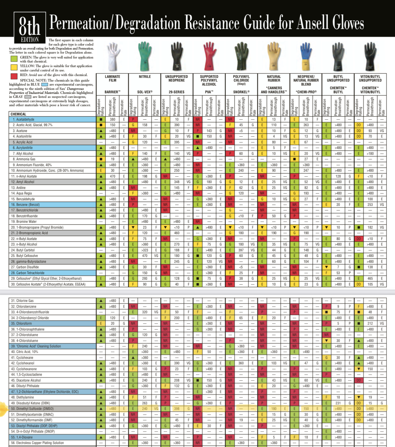

As I seem to be the Hide’s resident “safety glove man” vis-à-vis suppressors, in this case the best glove seems to be a pure butyl rubber one, which apparently don’t allow DMSO to permeate at all?
Viton/Butyl gloves are not great with DMSO, so do pay attention.
See p.6 of the attached Ansell pdf. Their nitrile glove seem to be ok for this stuff (Dimethyl Sulfoxide or DMSO). I’ve highlighted the relevant row. Perhaps it’s due to the glove’s thickness (they come in a variety of styles, all really thick) or special construction?
Ansell’s nitrile Solvex gloves are way thicker than mechanic’s nitrile gloves with most @ 17mils (.46mm). Some at .56mm.

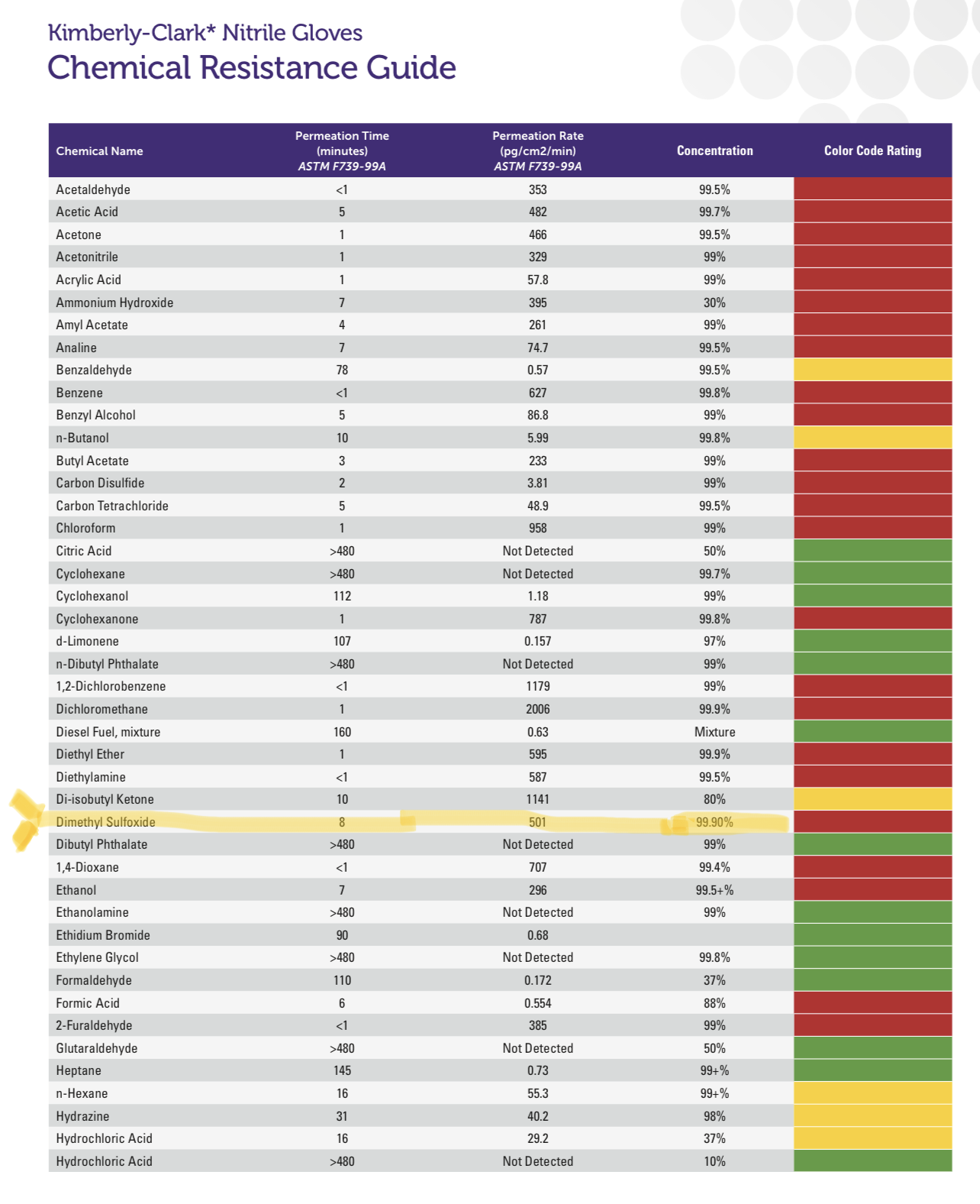

The Kimberly Clark pdf says the opposite for DMSO and nitrile.
Their pdf for incidental exposure for their thin nitrile exam gloves (excerpt below; but entire pdf also attached) I think says: at a 99.9% concentration, it takes 8min for DMSO to go through a nitrile glove at a 501 pg/cm2/min permeation rate (ASTM F739-99A).
Which doesn’t mean a lot to me, but they give the glove a red rating.
So no nitrile for me when handling this stuff, even at 10% concentration.

  • Ansell_8thEditionChemicalResistanceGuide.pdf

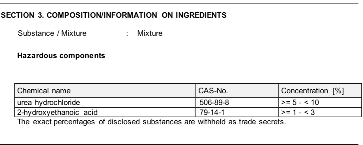

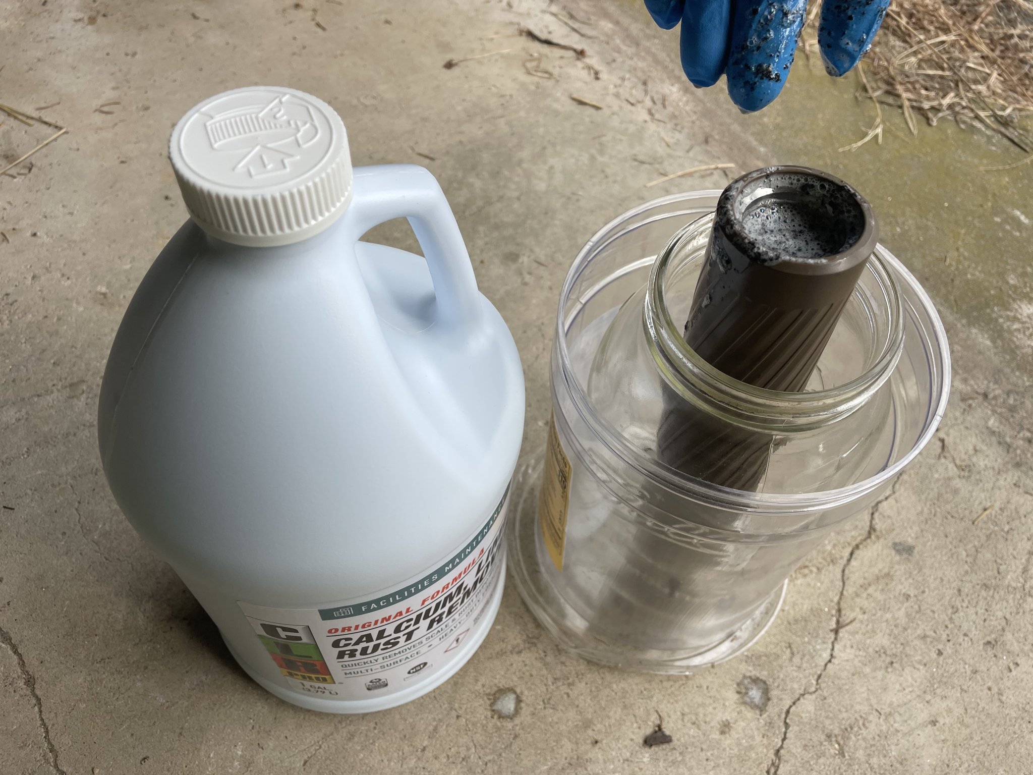

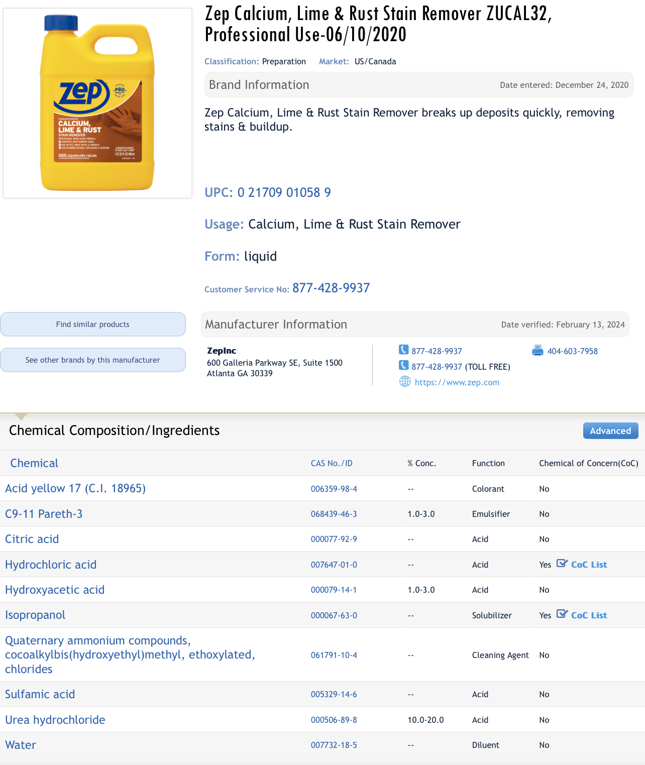

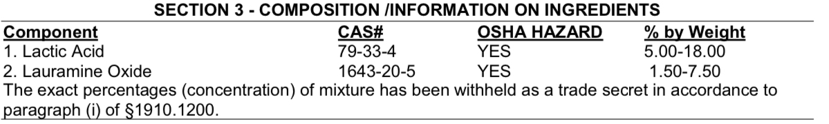

When looking up what gloves to use with CLR I noticed that the hazardous ingredients in ZEP clr vs CLR clr (lol) are, in fact, different.
Unless someone’s playing chemical word games, adjacent-chemical games or similar.
Chemical companies are a tricky-ass bunch.
CLR brand clr
ZEP clr
Meanwhile, the Consumer Product Information Database (CPID) lists all of the chemicals for each:
CLR brand (link)
Zep clr (link)
No idea how reputable the CPID’s data is.
Ah well.
No idea what this means about each’s efficacy at cleaning suppressors. Or proper gloves…been using nitrile but noticed they fall apart faster after exposure with ZEP (haven’t used CLR brand).
On Another Note​
I wonder if this different chem composition has something to do with people’s experiences with CLR when cleaning barrels…etching or not. Other brand’s CLR might have other stuff in it too. @Frank Green ?
CLR brand clr
ZEP clr
CLR brand (link)
Zep clr (link)
Ah well.
On Another Note​
I wonder if this different chem composition has something to do with people’s experiences with CLR when cleaning barrels…etching or not. Other brand CLR might have other stuff in it too. @Frank Green ?

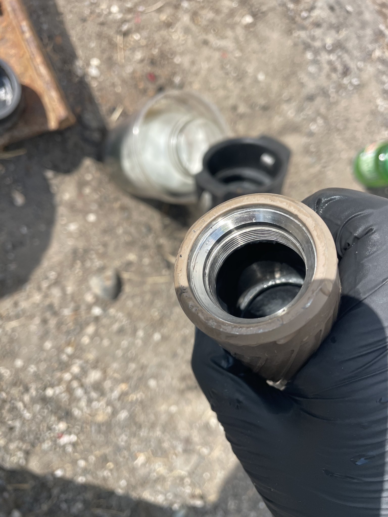

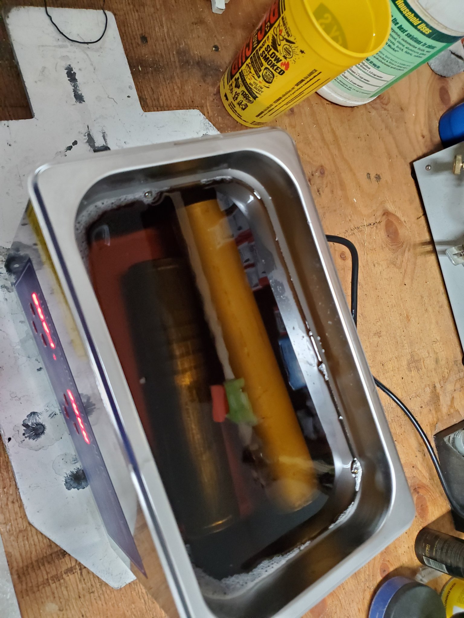

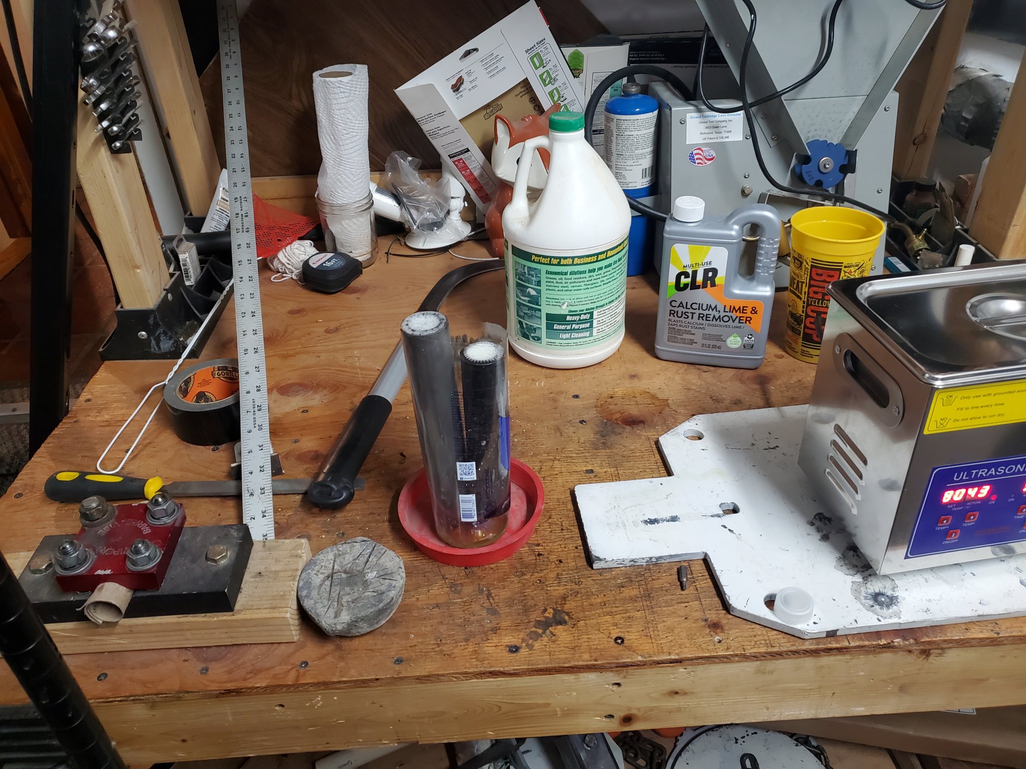

I recently cleaned mine with a few ultra sonic baths with simple green, flushed out with water, then plugged and filled with CLR for 2 hours, then another ultra sonic bath and then flushed out with hot water. View attachment 8495645
I did that with my R6 recently to get a mount off if it and it took off the cerakote. That didn't happen to you?
It didn’t, sorry to hear that.
Did you use heat? I've used it on other cans and not had trouble but I don't know if I've ever used it in the US and had heat with simple green. Maybe it's a different brand name or something, I will have to look. Just a word of caution to others. It may just be that cerakote wasn't the right kind or something???
Yeah I used hot water and my ultra sonic has a heater with it also. I’ve never had an issue with simple green and cerakoted parts personally.
The Kimberly Clark pdf for incidental exposure for their thin nitrile exam gloves, below, also attached, I think says at a 99.99% concentration, it takes 8min for DMSO to go through a nitrile glove at a 501 pg/cm2/min permeation rate (ASTM F739-99A). Which doesn’t mean a lot to me, but they give the glove a red rating.

Apparently the silencer cleaner works really well with a sonic cleaner. I haven't tried it yet but plan to.

An hour? The KC chart seems to say you’ve got 8min with their 6 mil nitrile glove in an incidental splash exposure use. Not comforting, not full immersion!
Also note that hot (like 100° in the piston vid) DMSO might permeate even faster.
Context: 6 mil is in the range of “mechanics” grade nitrile glove thickness. I’ve seen other brands that call their nitrile gloves “mechanics grade” on amazon go up to 8 mils.
Other sources like Showa’s most excellent Chemrest site agree with KC on this point. In fact, at 11mils, their non-disposable nitrile glove 717 only gives you between 30-60min of time in either total immersion (TTL) or intermittent exposure (INT).

I soaked carbon steel in the stuff and it cleaned the carbon off without damaging the steel.

The Ansell glove tested is the 20mil/0.51mm thick Canners 343 (now rebranded Alphatec).
You can let it soak for longer but normally do 8 hours, followed by a really hot water rinse and another. The chemical seems to do the most in the first couple hours.

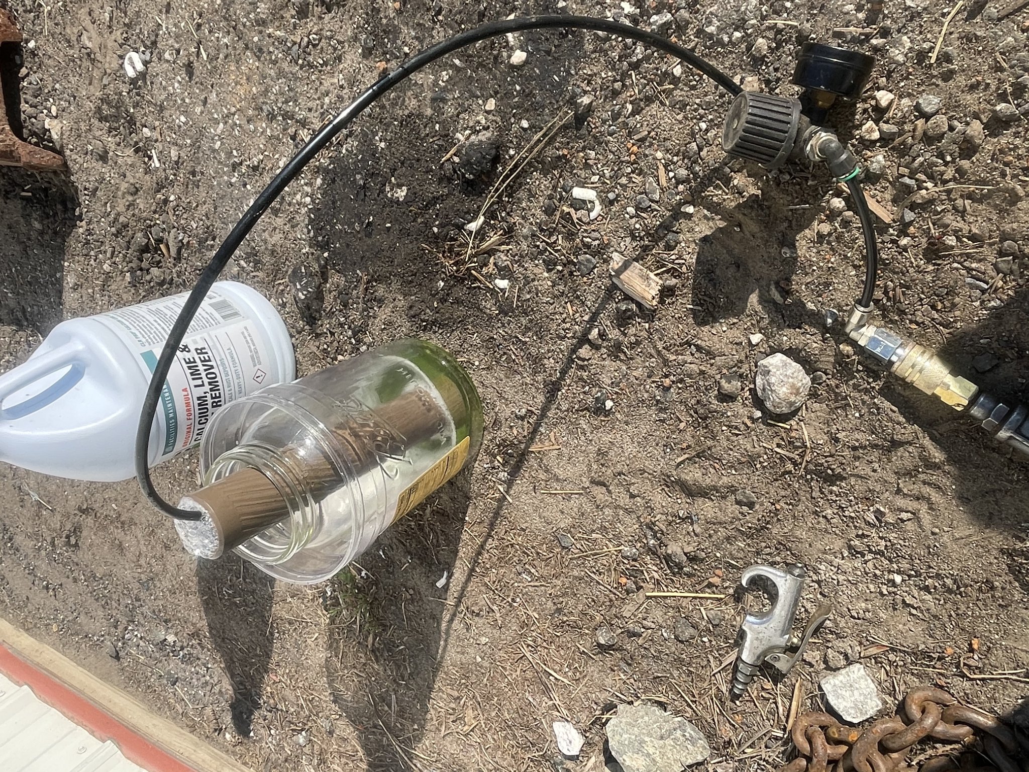

We will see if some cavitation will move this along
Interested to hear your results. I shoot 100% suppressed so cleaning is something I deal with often. I typically soak in CLR for 8-24 hours then flush with a pressure washer. Depending on how dirty the can is, it can take 2-4 cycles to clean it out. I'd like to find something that can do it on the first or second soak/rinse cycle. I've always thought some sort of flow or movement to the solution would make the cleaning much more efficient, I just haven't tested that theory yet.
Reactions: BurtG and NiteQwill
Reactions: lead ƒarmer

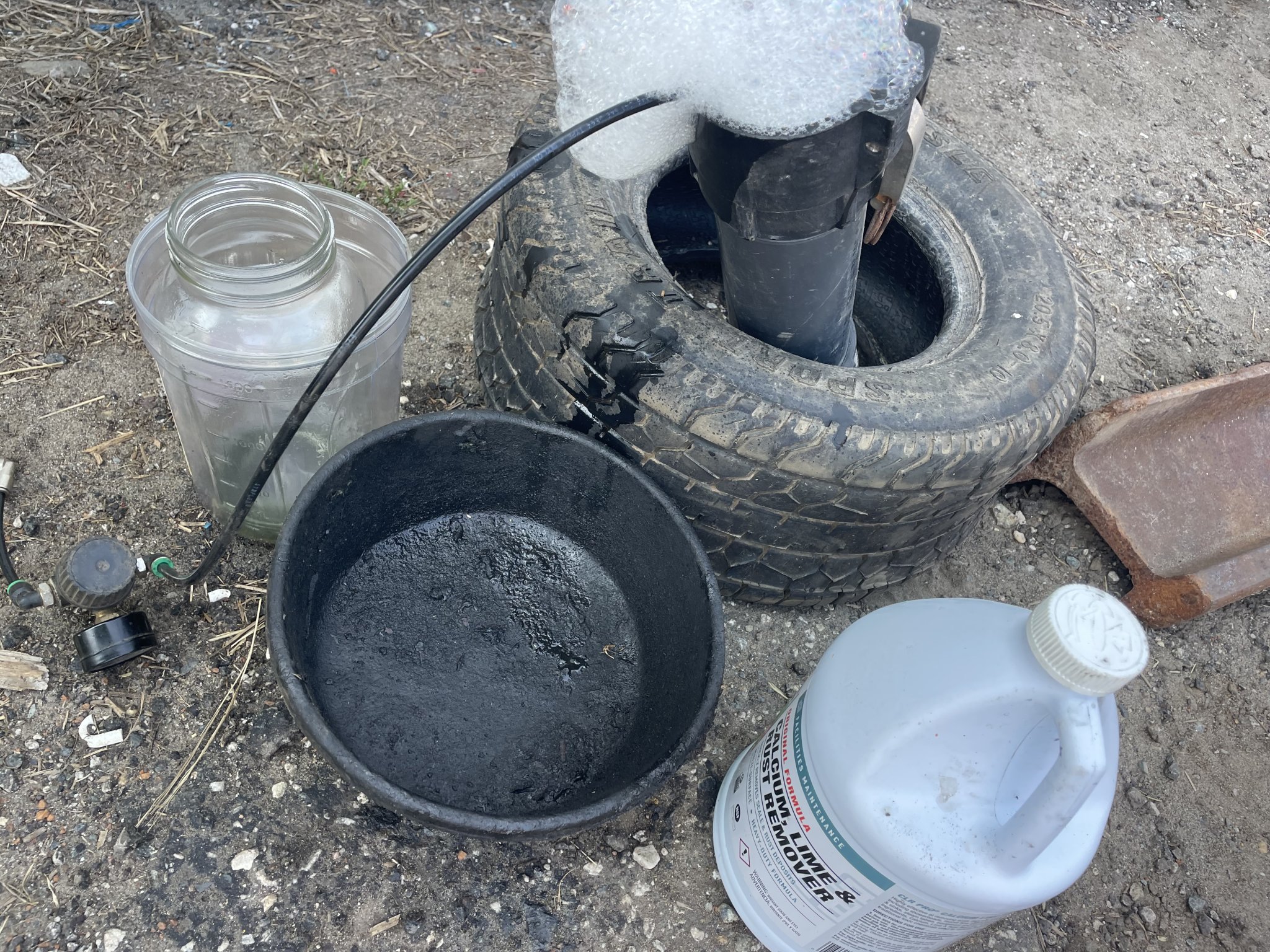

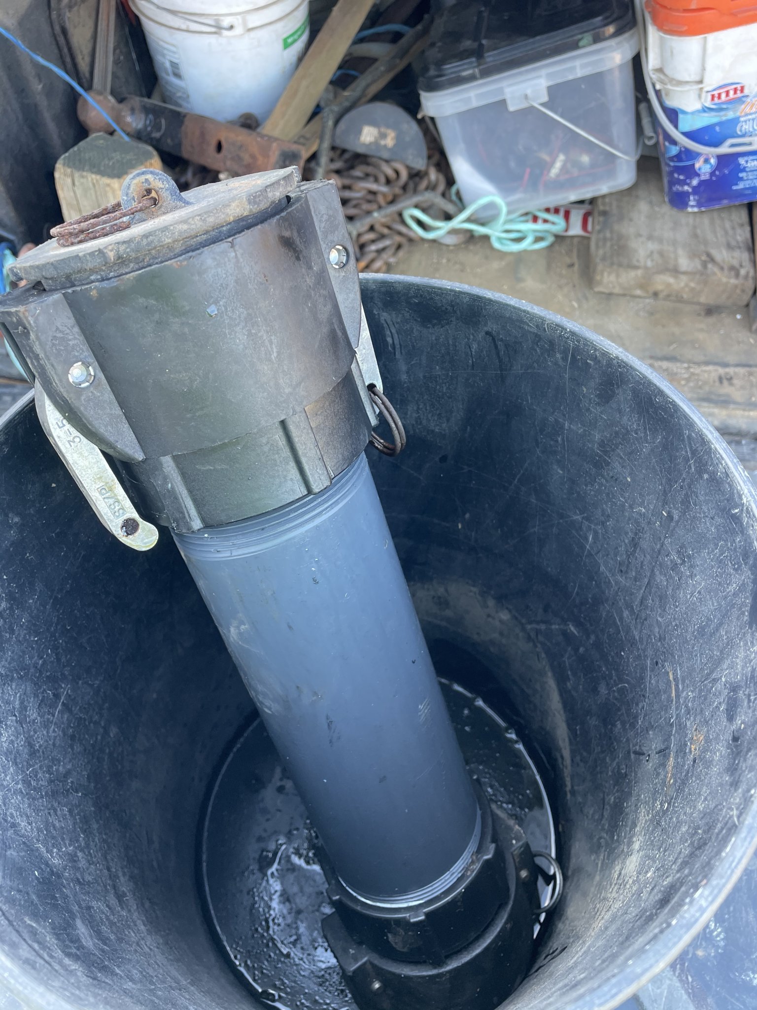

The airline bubbled all the fluid out even with a loose top on
I put a locking lid on that container after putting more CLR in. Now ima let it ride in vehicles for a few days. Sort of a vibratory shaker for it.
Reactions: FuhQ
Your redneck engineering is impressive... Being from the South and growing up a Poor, that's one thing I enjoy partaking in at times.
For example, I just had to do some myself last night. I needed to send one of my old vintage Dual Rectifier amp heads to Mesa in California for repairs, but instead of sending the whole amp head in a huge box like I normally do, I decided to pull the chassis out and send just that (much smaller and lighter). I had to modify the box to shrink it down to about half the height it was originally, and to makeup gap space inside the box, I then had to rig up some cardboard triangle internal corner stops inside the box to keep it from sliding around in there to avoid damage. Then used up every stitch of bubble wrap I'd collected over the last 2 years or so in the whole house, and still needed more, so I had to start cutting up Aero Solus chassis box foam (thick, & dense...Very good for heavy items) to fill in gaps. By the time I was done, I was pretty proud of my redneck packing job, and it turned out pretty damn solid, too...Barely any wiggle room in there. Almost wish I'd took pictures of it. 😂

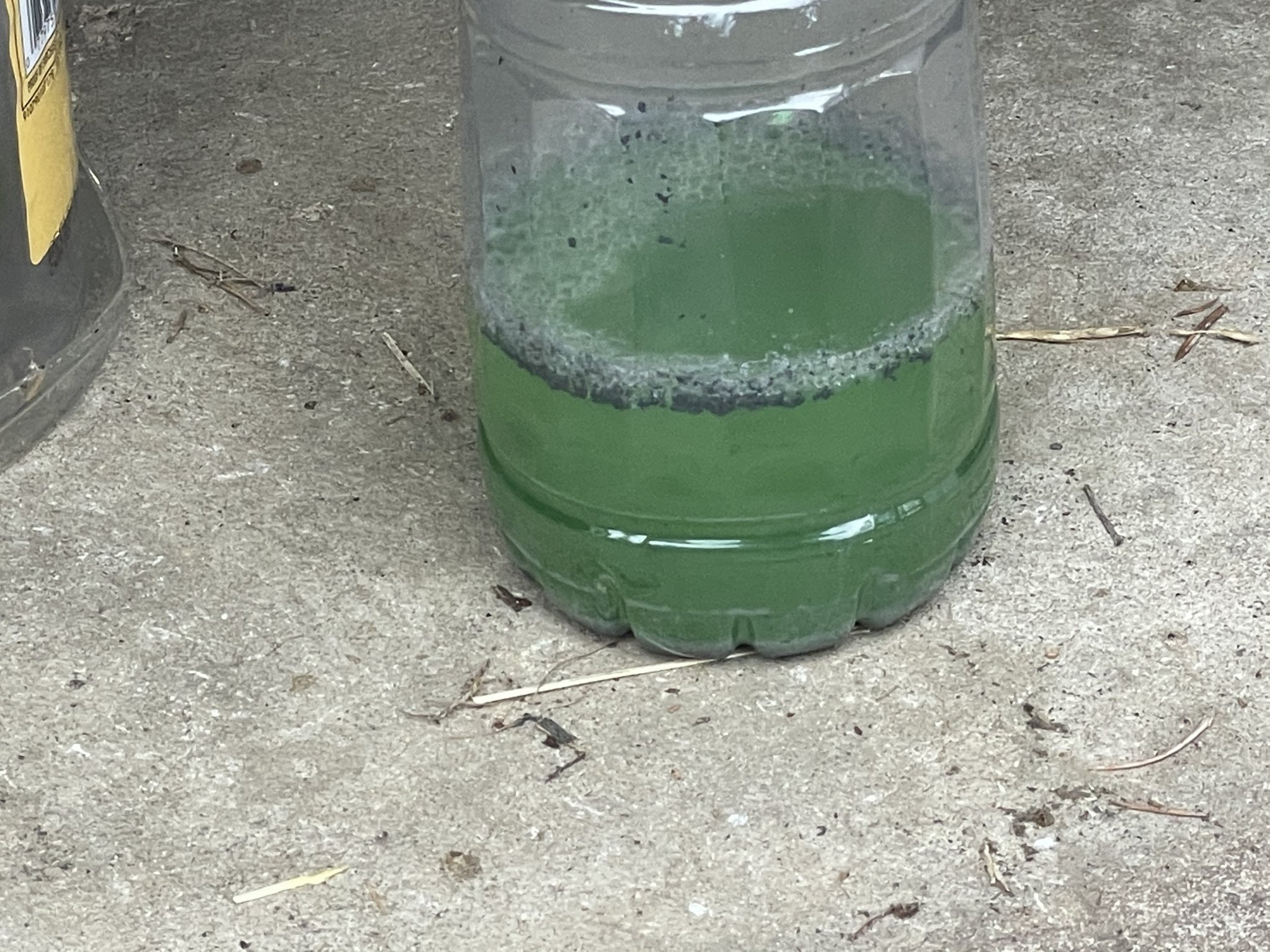

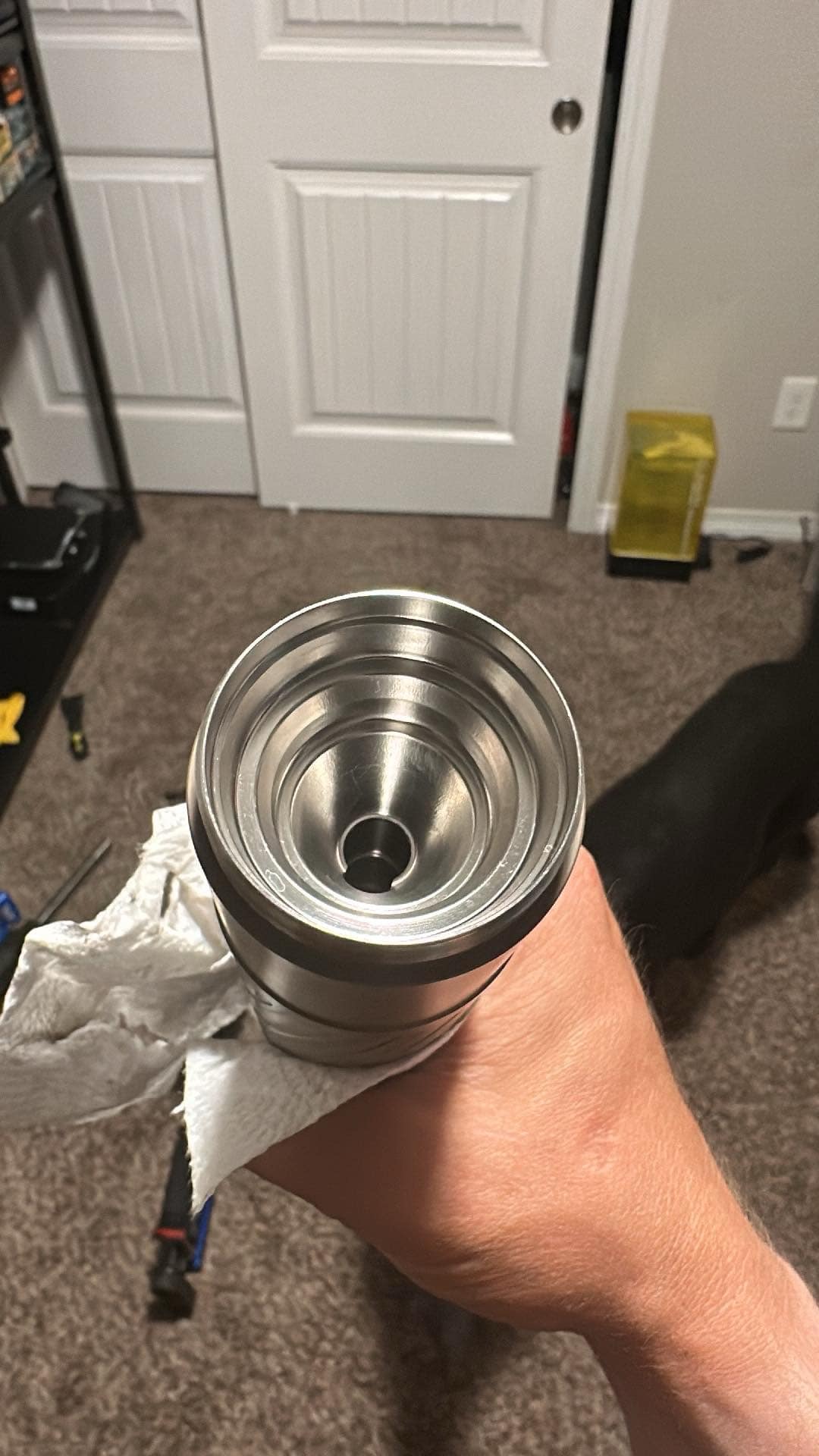

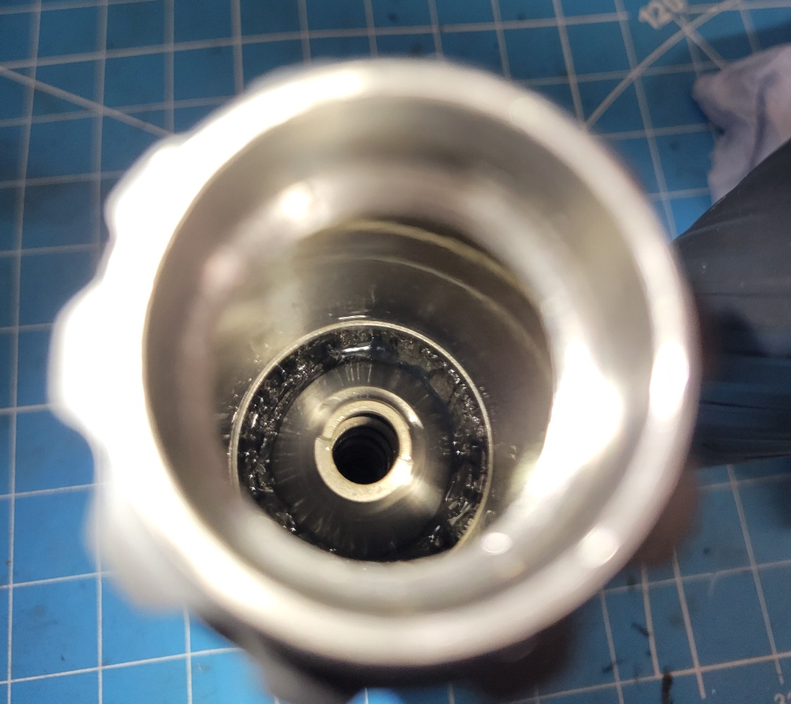

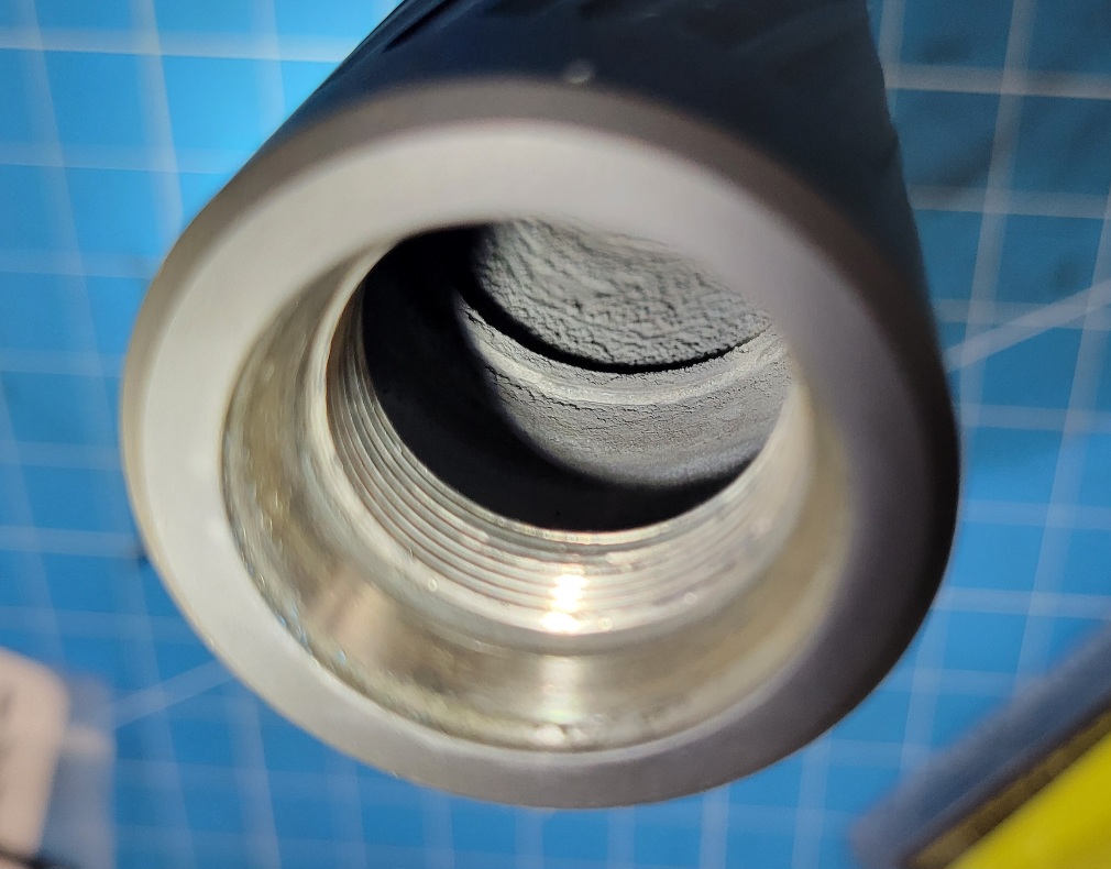

Preliminary results seem excellent. Carbon is very soft to the touch. I don’t have time right now but I think the bore tech power washer attachment would get all the carbon out as is now. I think submerging the entire thing helps. Breech side down so k baffles are draining contaminants all the time.
Hot water rinse, and a couple short barrel rounds will get more loosened up.
Reactions: BurtG

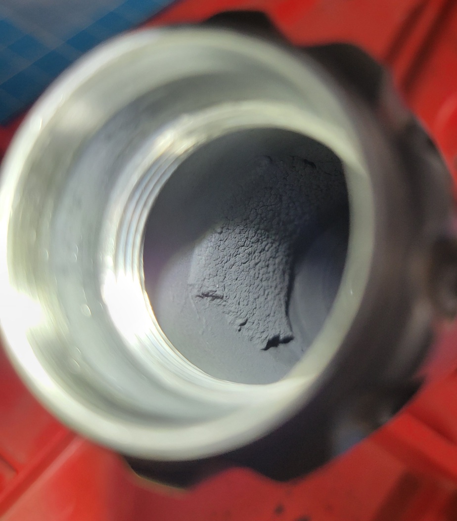

I didn't seem to get much more out mine with freeze cycles. What really started breaking things up fast was working them over with a soft hammer while r8nsed them with hot water. I took about 3oz out of each of mine with CLR, US with simple green, soft hammer hot water rinse in the sink. It took a handful of cycles. I weighed it after each cycle. I was in one of threads on cleaning or had one of my own. I don't remeber. 20230914_205412.jpg20230910_194859.jpg20230910_192800.jpg20230910_192749.jpg
