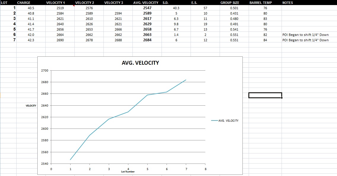

I agree w/ ZiaHunter. The Hornady brass requires some case prep. I was able to achieve lower SD's as a whole with Hornady brass for my 6.5 Creedmoor. (Data is posted below).
I did the following: uniform/debur flash holes, cleaned primer pockets, bevel and chamfered neck after trimming to 1.910". I use a Lee Collet Neck Sizing Die and adjust to .002 smaller than the caliber (So .262 is the Inside Diameter after resizing). I will also clean the inside of the neck after tumbling because sometimes there is a white residue left from the polishing compound in the media. You will feel it almost polish up with a Q-Tip. I'm not sure how much that helps, but it's a step I take. Hope this helps!
Ruger Precision Rifle 24" Barrel 1:8 Twist
H4350
Sierra 142 gr. Matchking
Hornady Brass / CCI BR-2 Primers
Seated .020" off the lands * (3.214" from the OGIVE)
DA: 1400
Temp: 78
Humidity: 59
*Used MagentoSpeed V3 Chrono (which is why POI is 2" left), Kestrel, & IR Thermometer for Barrel Temp.
*Note: Cold Clean Bore for 1st Shot was 40 fps slower. This is a trend.
