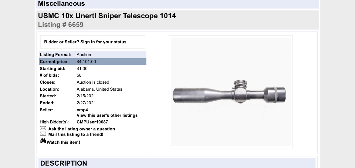

This was back around the same time I bought mine form Jrb572 here on the forums (which by the way the scope works very good with no issues).
Like I said... I was shocked that it sold for $4k with a broken reticle.

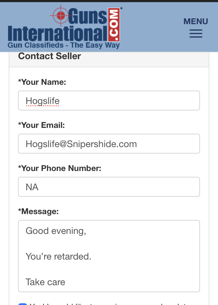

Actually looks like the seller @Joemore has an account here. @Joemore what the hell is up with $20,000 for a scope?
Fixin to send him a message

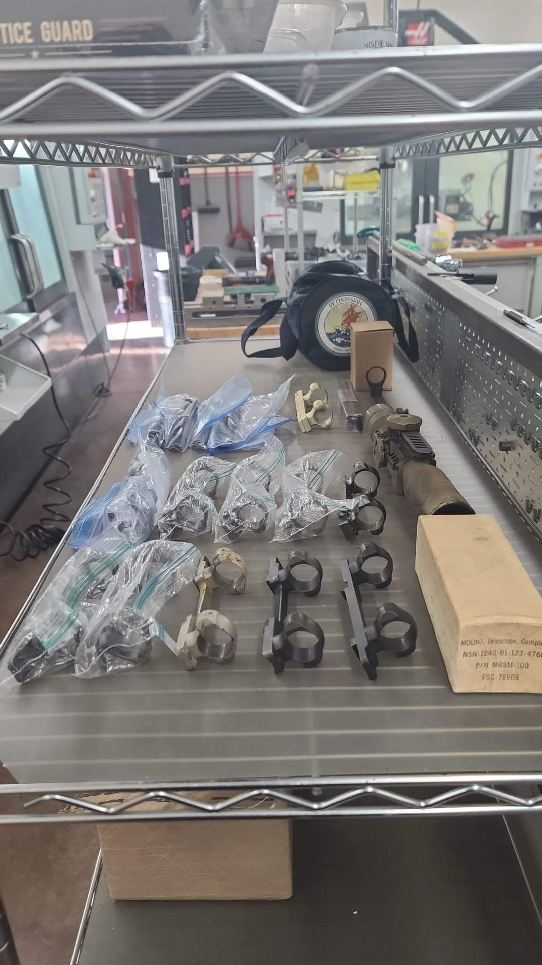

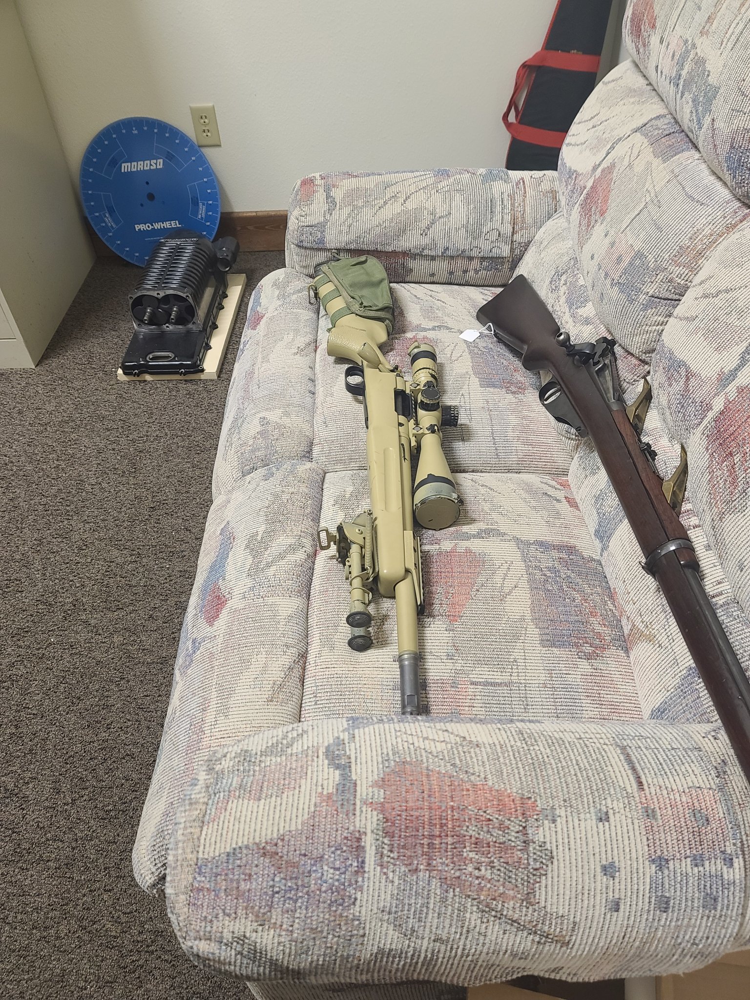

Yesterday I had a pit stop in Sioux Falls, SD, on my way home from Omaha, NE, to pick up more artifact pieces for this scope base project. A good hour-long meeting in my pickup at a truck stop reviewing parts once again humbled me greatly as the subtle details of how these parts evolved is cool to see. This stuff is getting its teeth in me, and I'm grateful for the opportunity to try and bring some of it back to life.
Ryan was gracious to entrust me with his XM3 rifle. Driving home with that thing caused me to change my habits a bit. Normally, my cruise is set to 90-93 across SD, and I don't think twice about it. Yesterday I drove at posted speeds the entire way. (SD freeways are 80mph when outside of city limits) Home safe n sound. I've got a ton of juicy stuff to molest. More base and ring sets, the rifle, and some Barrett junk as well.
Now that I have a legit XM3 scope base, I can start that dissection as well. I also have the correct recoil lug.
My P90 project is nearing fruition, so it puts some time back on the clock to work on this again.
Good times.

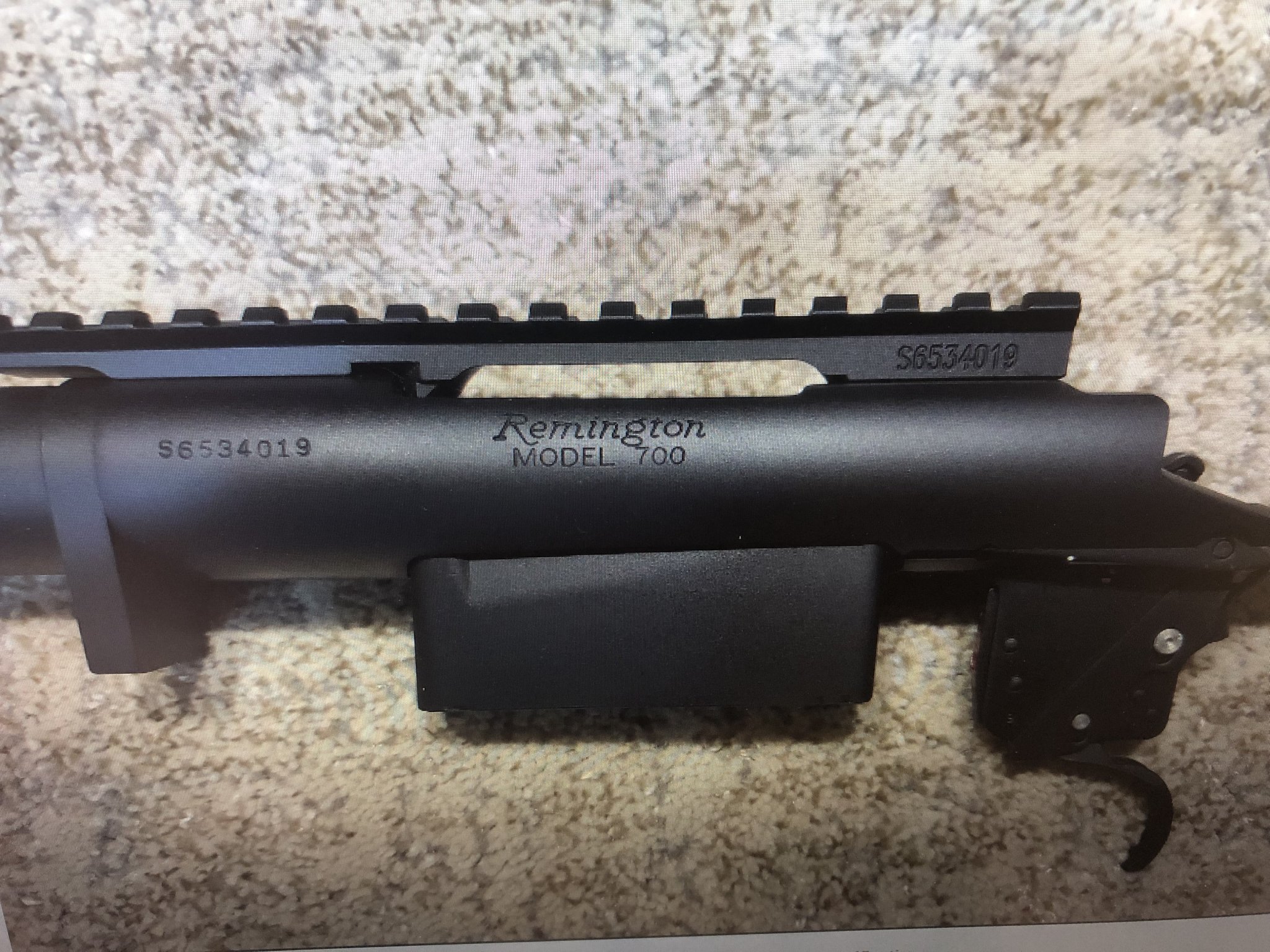

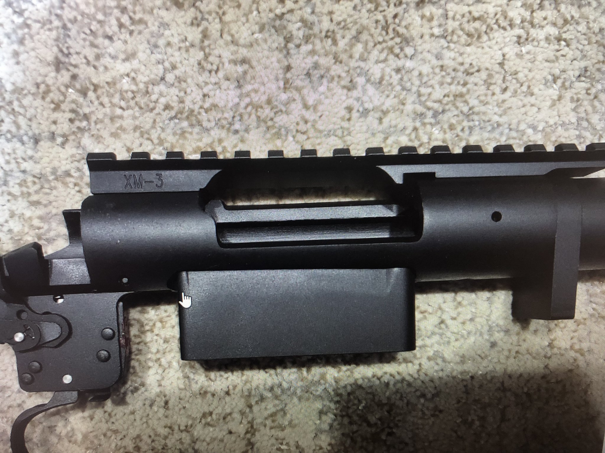

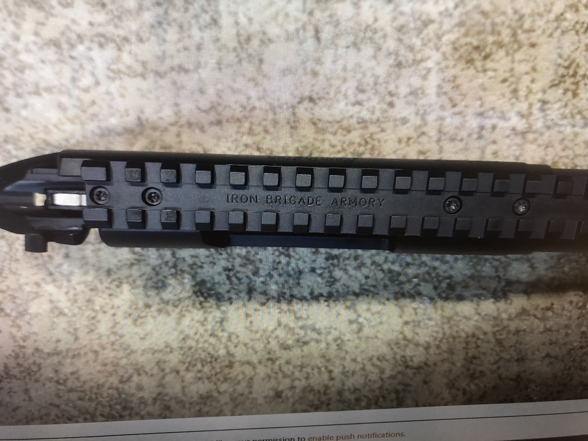

Here are a few photos I got from the CMP auction site for an XM3 that was being auctioned.

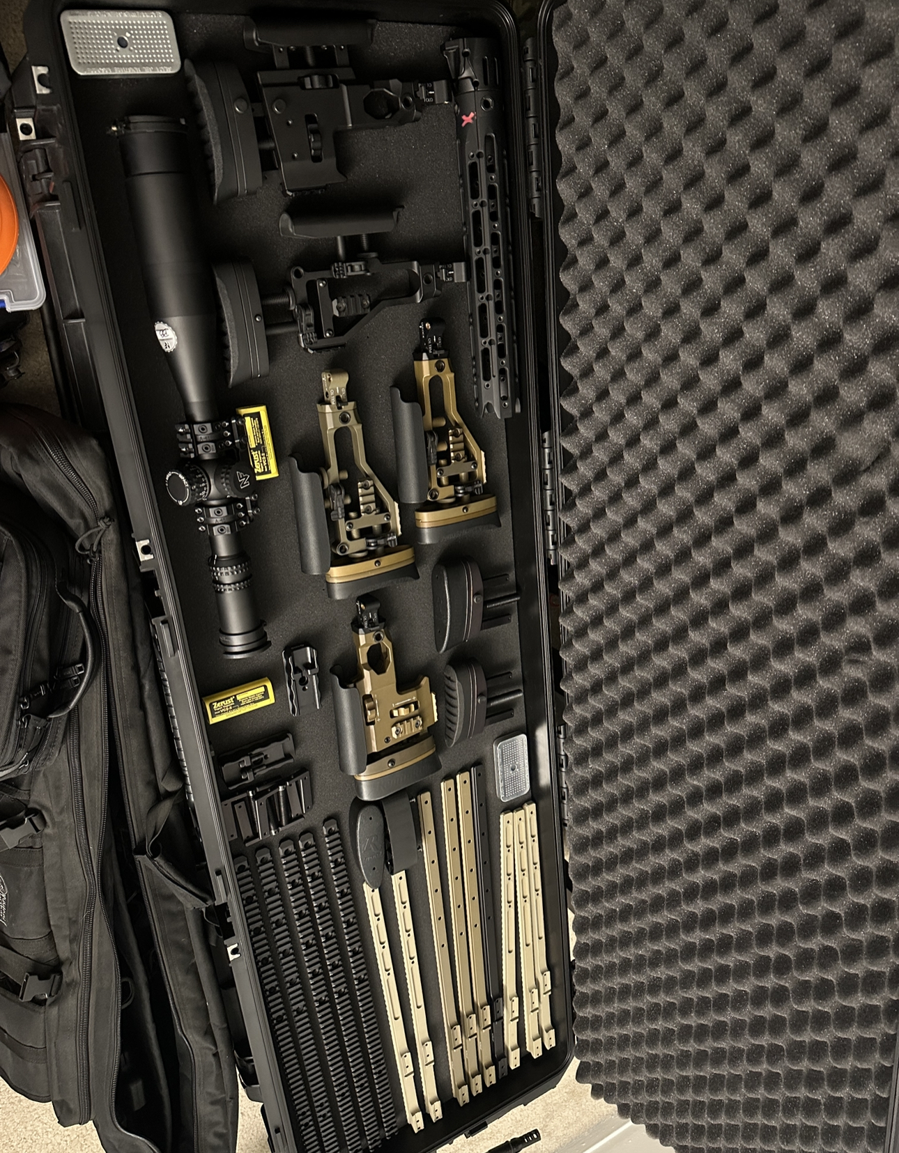

Getting into this thread now... I have 3D design experience and if needed let me know... I also have a few parts..
The XM2010 Chassis is another version of the RACS chassis in extremely high demand. The buttstock design was better in my opinion than the later skeletonized design with the lock levers. Any RACS would be awesome though especially in both short and long action version. Sorry LRI, the can of worms has been opened...
Reactions: USMCSGT0331
Both stocks are useful, and each has its own benefits, but XM2010 is usually more stable than the Lightweight one... But the lightweight one can be made very stable too, just needs extra care.

Well shit Ryan, I thought I had got those pics from the CMP. My bad man. You and I have traded so many pics over the years I completely forgot I guess.
Yes everyone, these pics were from Ryan as he was helping me with my personal XM3 build.

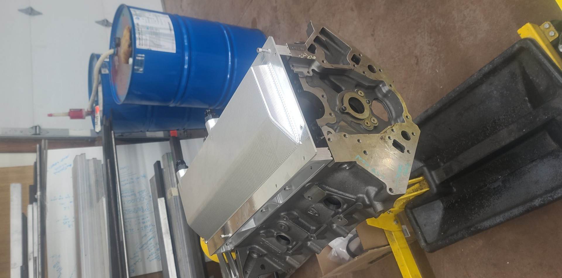

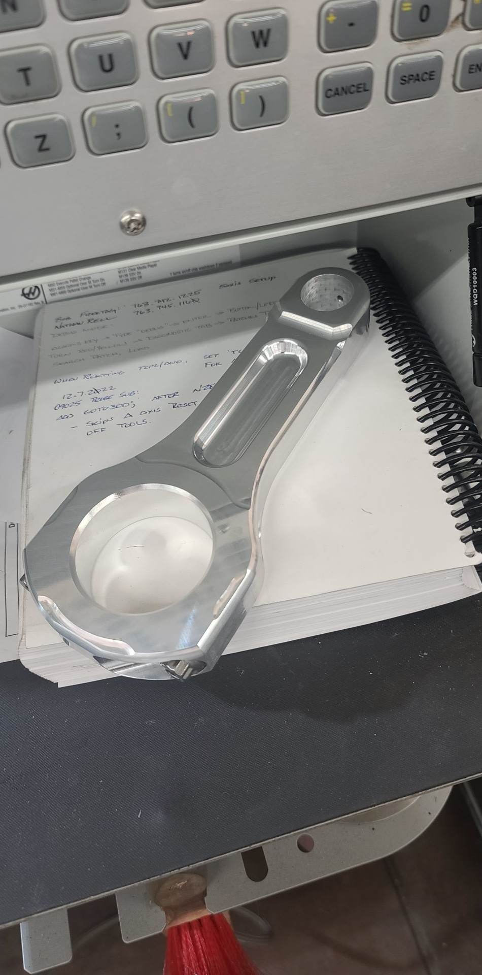

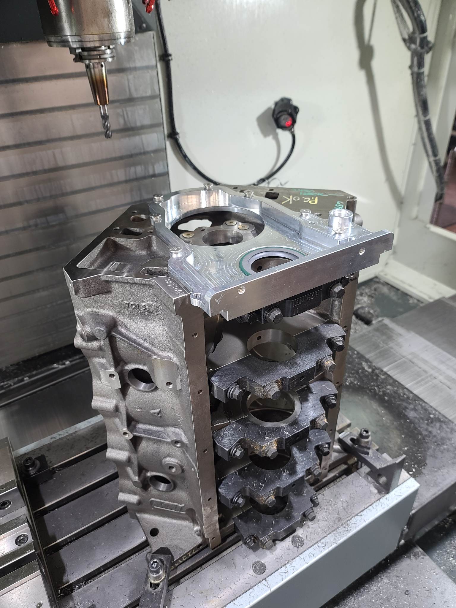

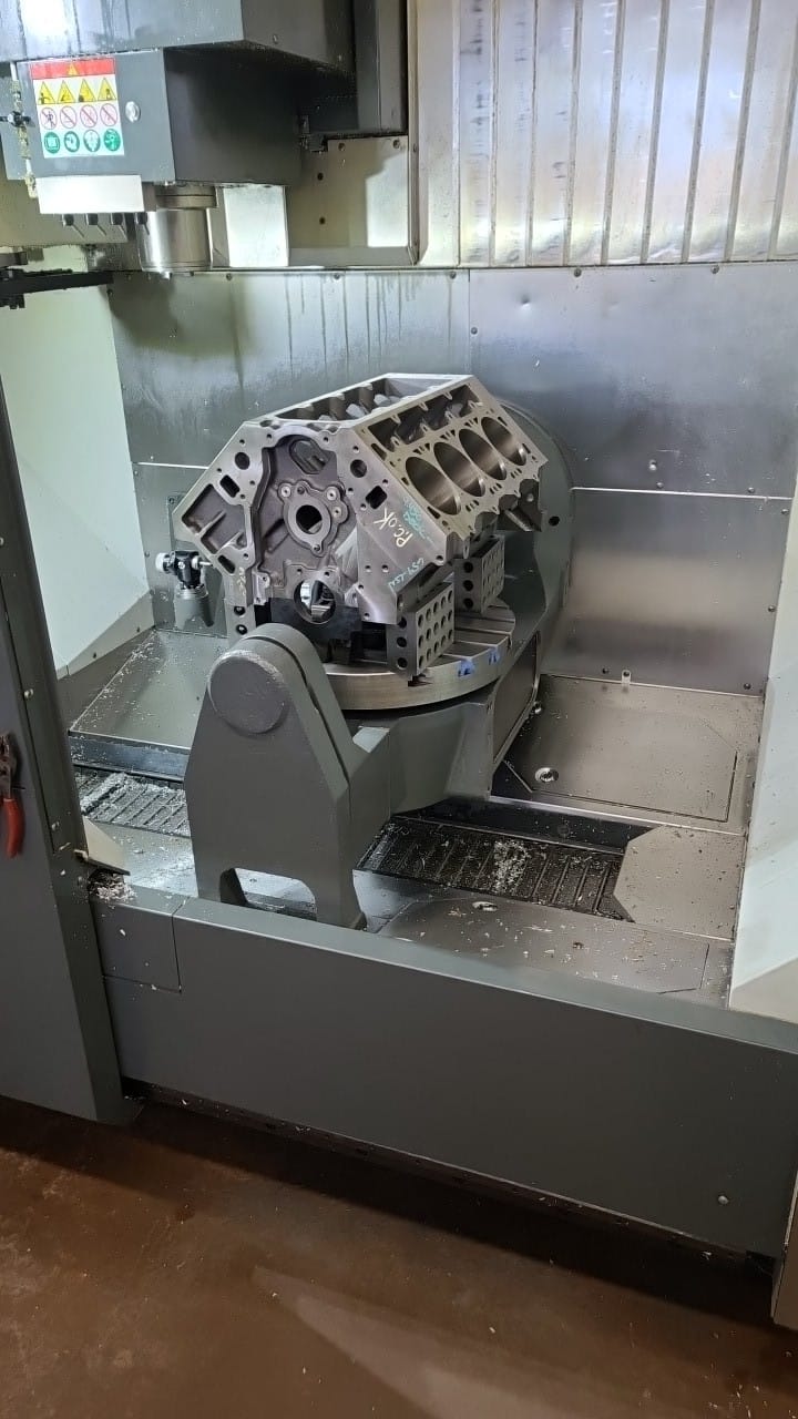

You had to bring it up....lol.

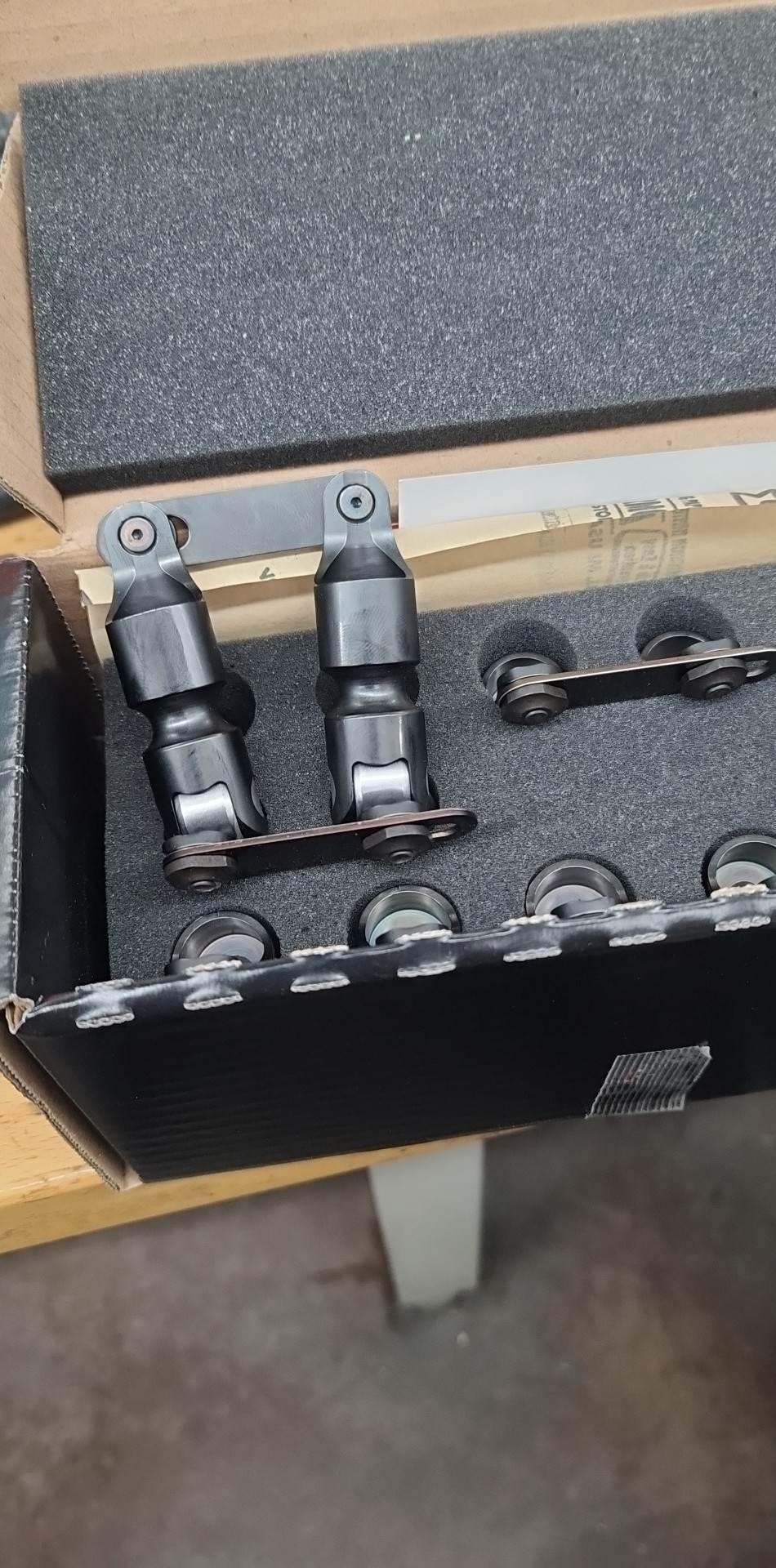

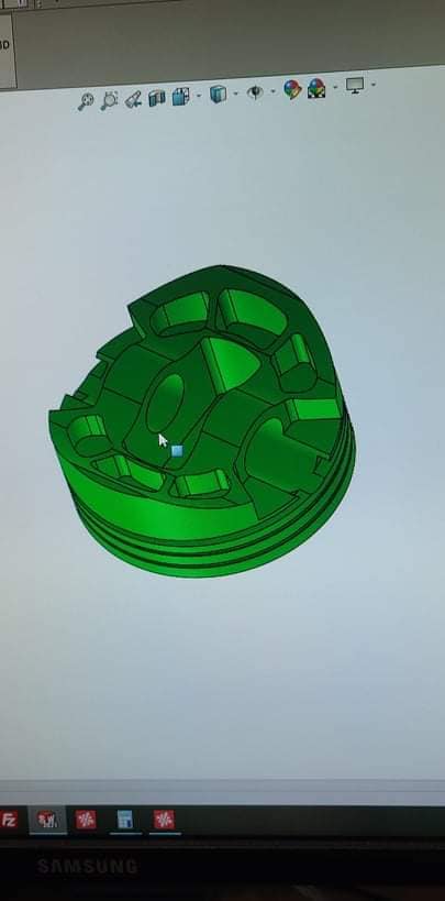

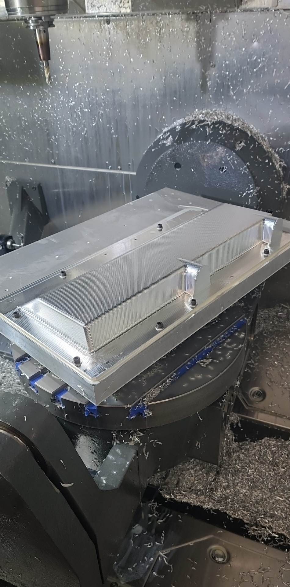

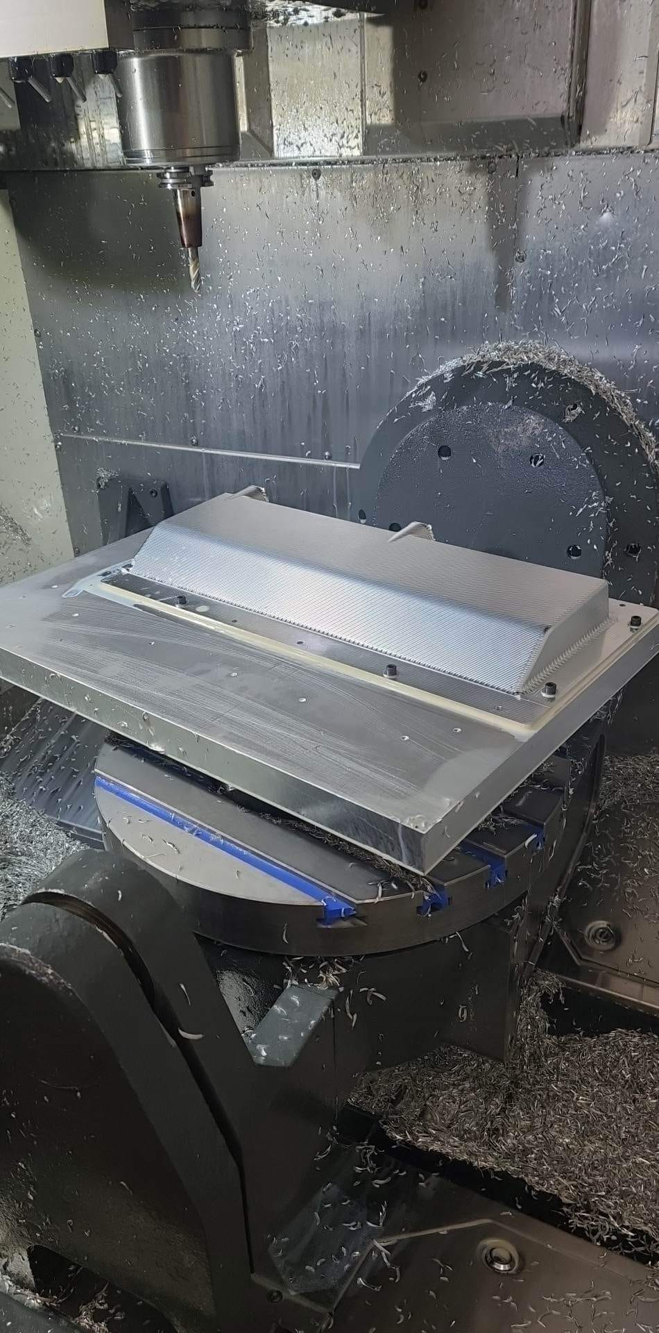

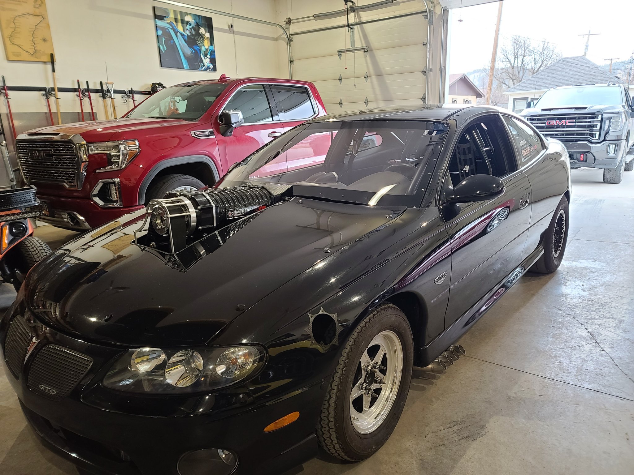

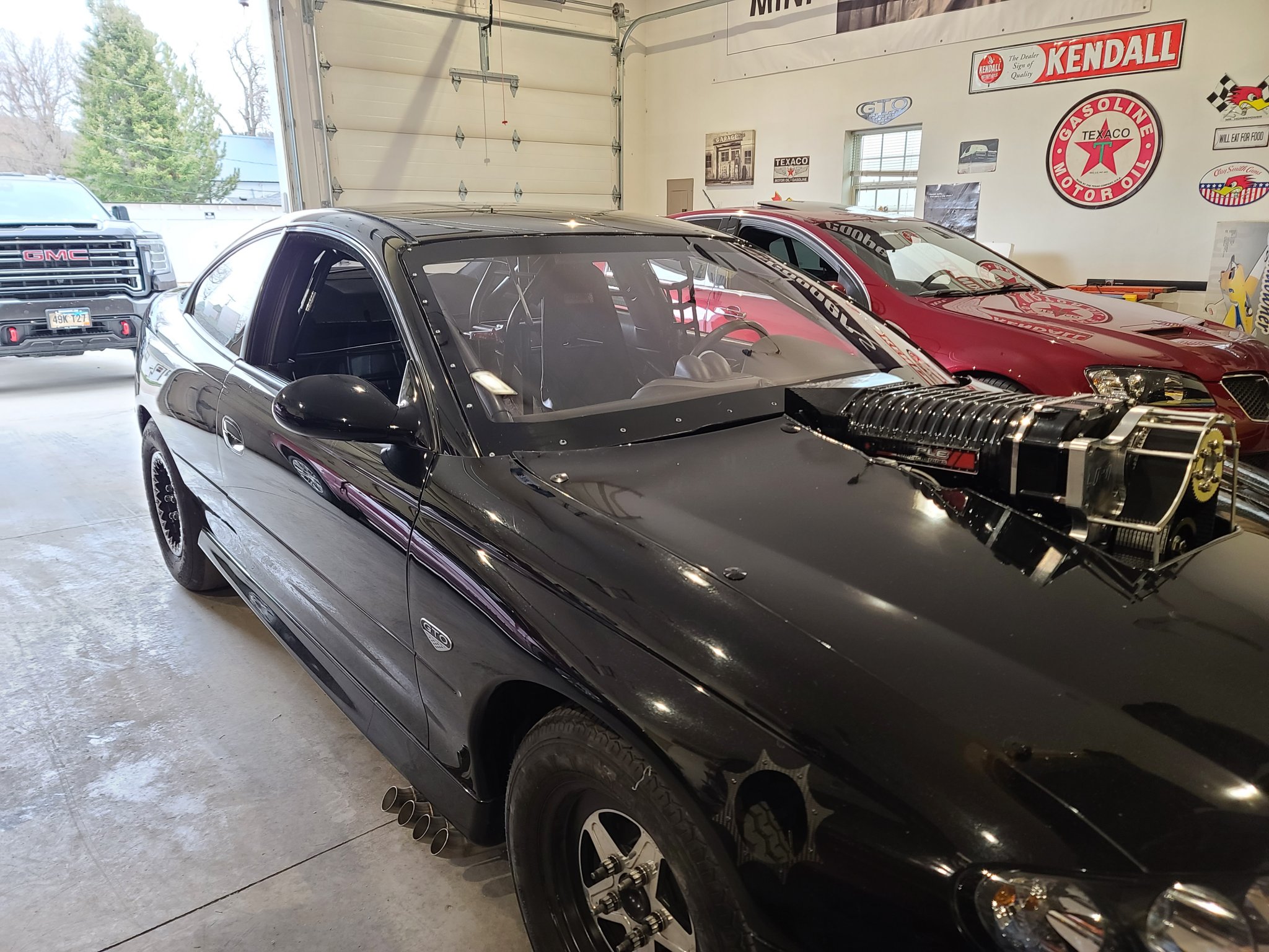

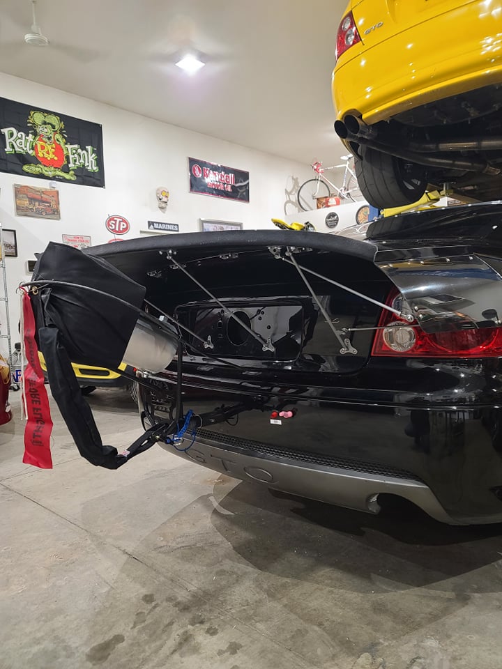

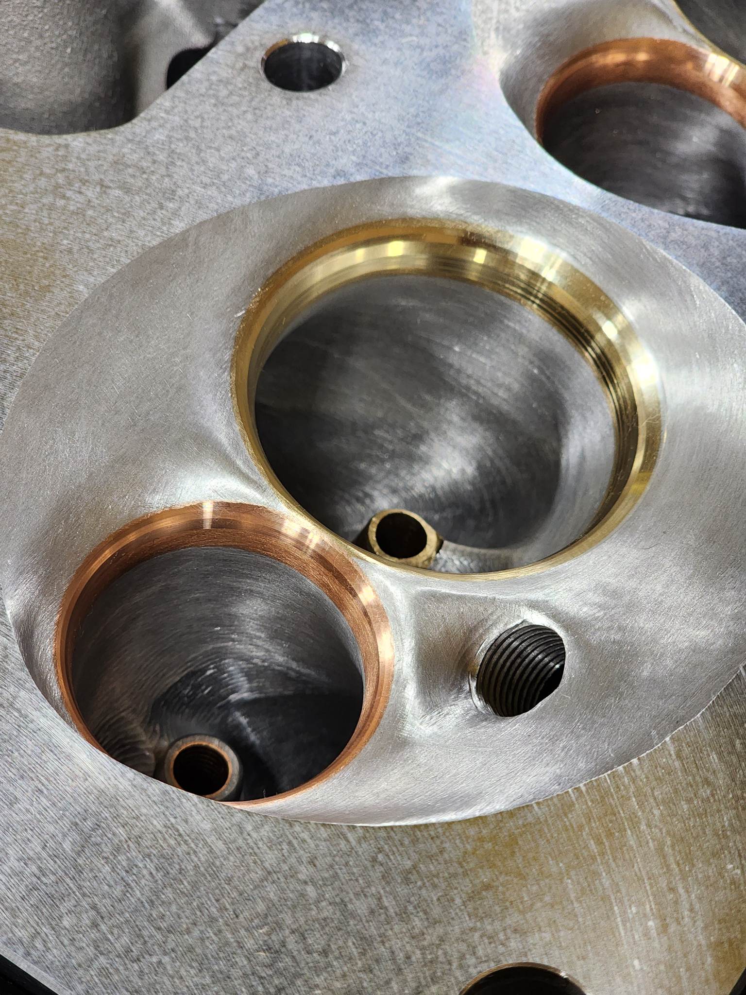

Whole new setup this year. (more like next year, as we prolly won't get to do much with it this summer since it's still at the machine shop being finished) I made a lot of parts for this thing, but I don't own a boring bar or a hone for the block work. I was able to bore out the lifter bores here, though. That was a cool/fun Sunday project.
427 LS based
Dart tall deck block
Callies billet crank
GRP alloy rods
Billet slugs
Wrist pins that look more like steel rods with a small hole through them. (ridiculous!)
CID LS7 heads, Ti/Inconel valves and over 430CFM at .800+lift. (absurd!)
Jesel stuff for valvetrain
.800+ lift on the cam (solid roller)
Billet dry sump oil pan
Big Whipple (8.3L) blower
All the methanol... Last year's engine consumed almost 3.5 gallons every pass. (burnout&pass)
Hunting for a little over 2K flywheel with this bugger and 4's in the 8th mile. Last year we made an estimated 1500-ish flywheel with a 6.0L block. -that survived 5 passes before splitting the #4 main web in half. -oopth

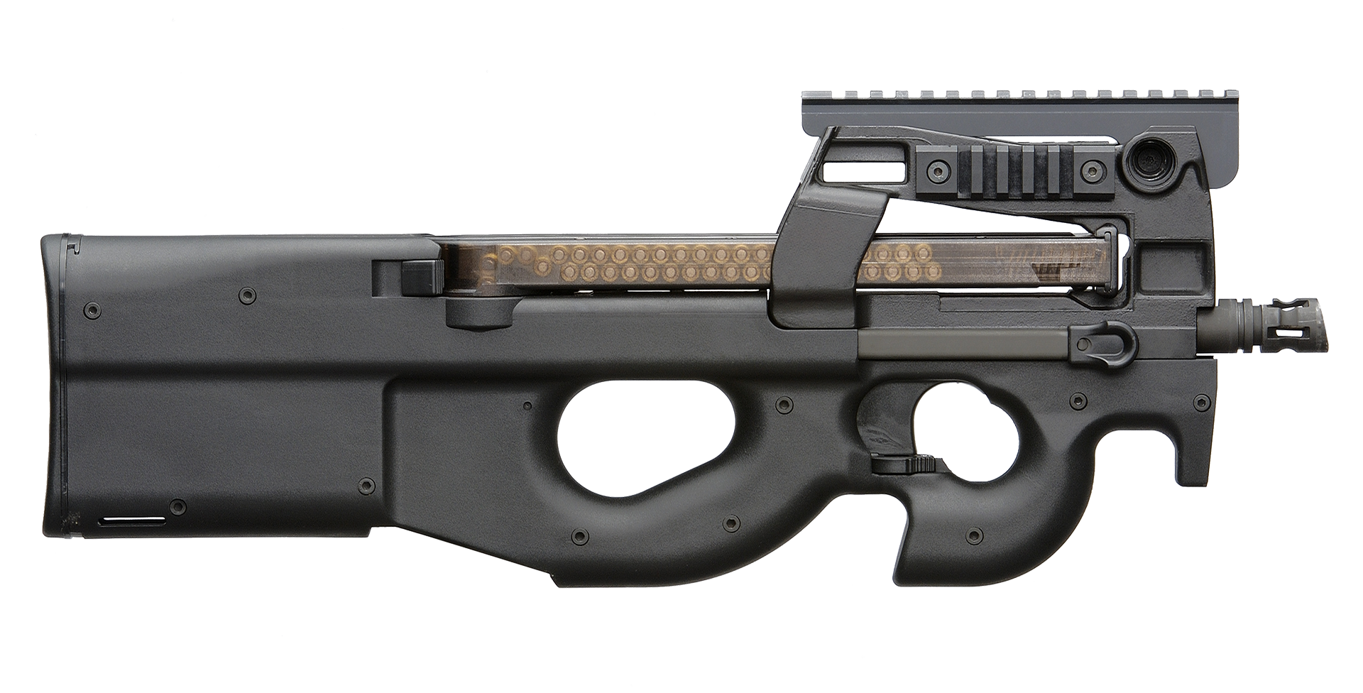

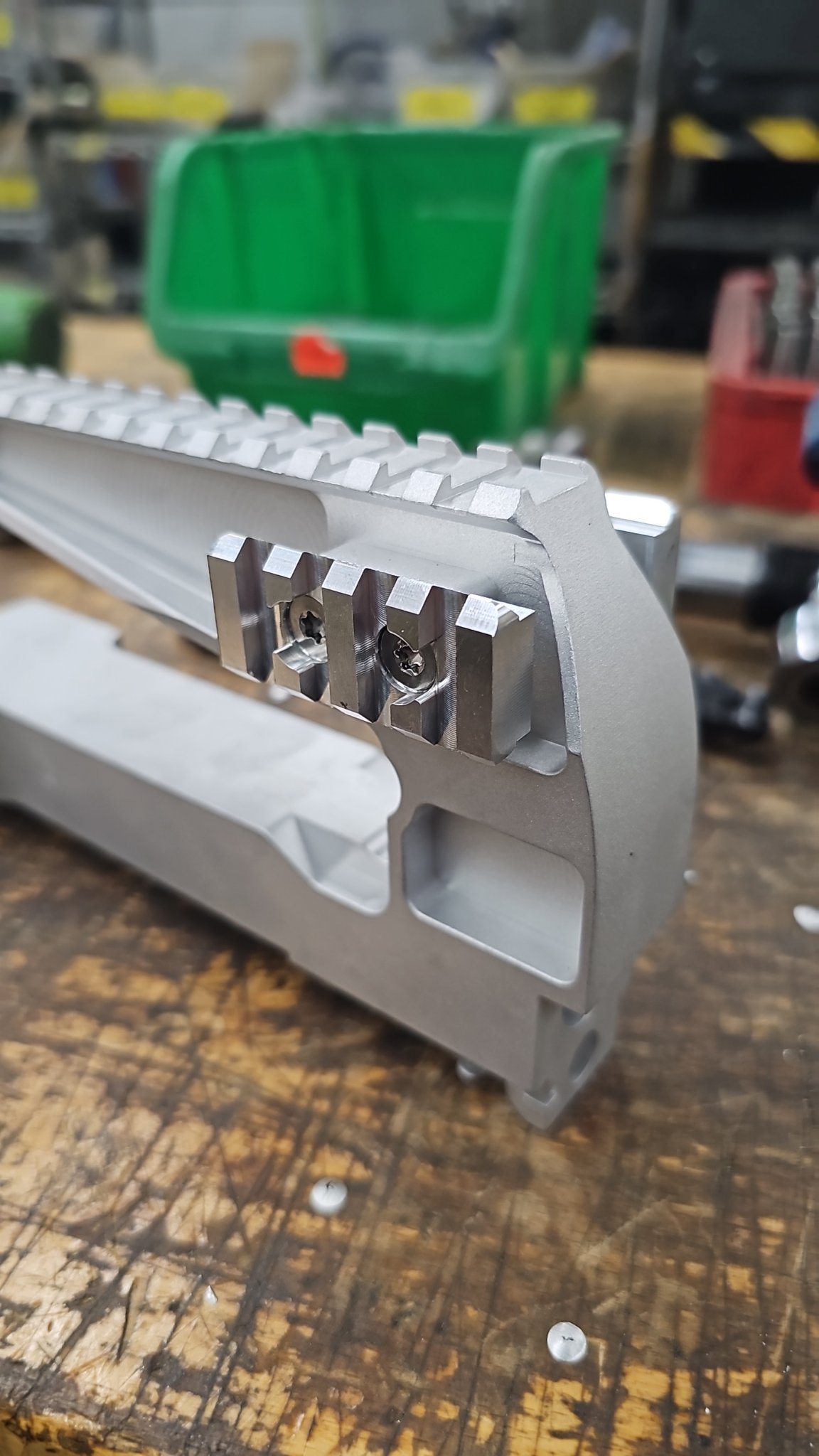

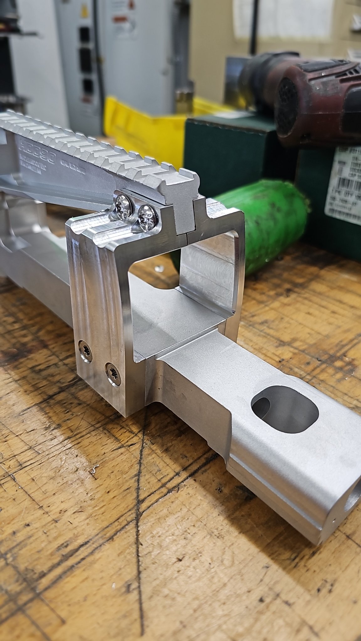

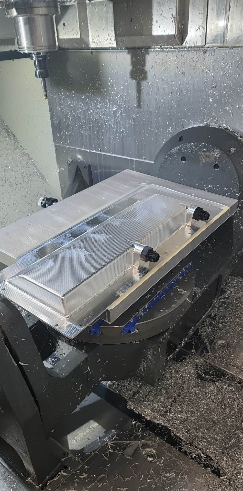

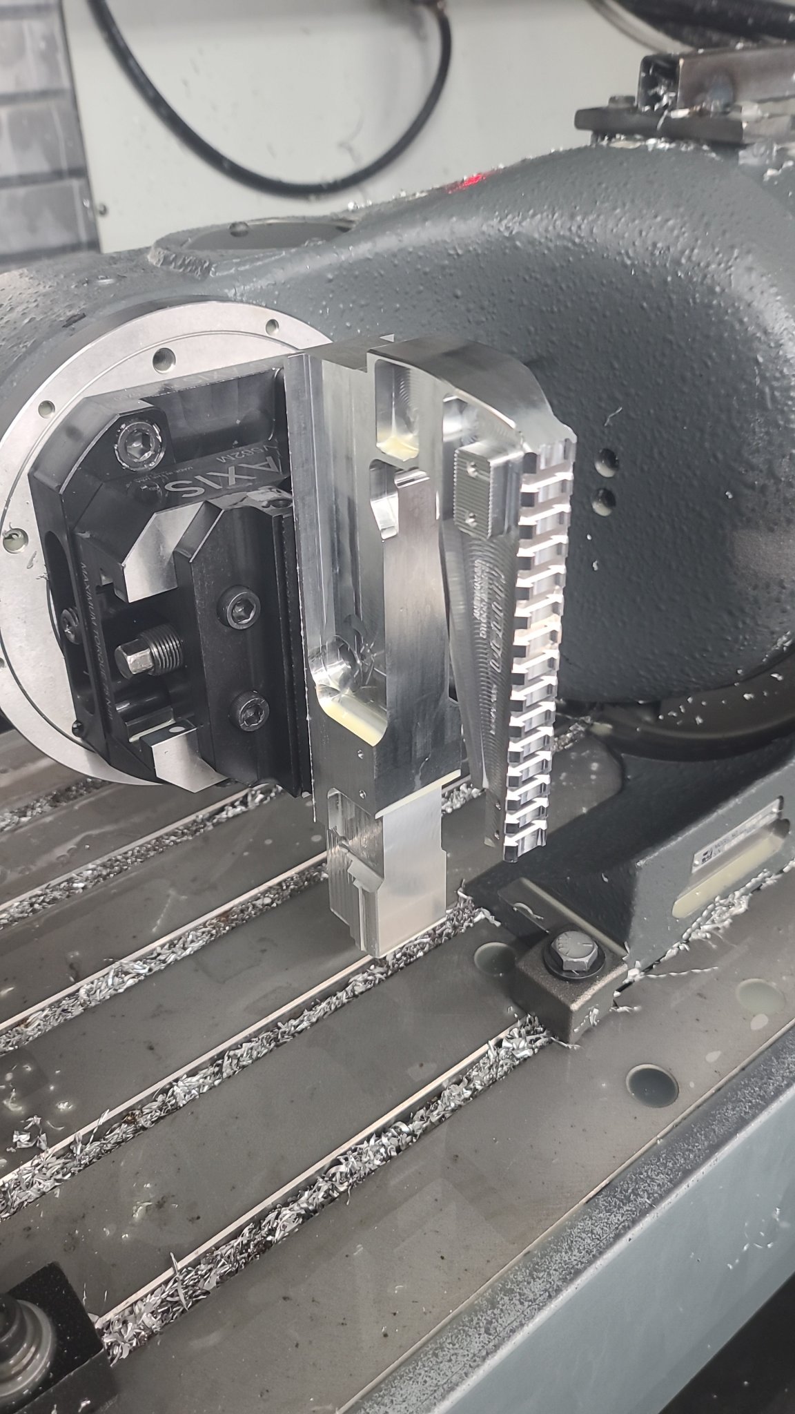

This week has been devoted to wrapping up these buggers, 1st article samples of a billet P90 variant upper receiver. They shipped yesterday so I have that box checked.
I am hoping to start on the bases over the weekend. -It's in the air as of yet. My daughter's car (Infinity SUV) is on the fritz and Denver is the nearest dealership. I've been "volentold" to get it down there for service.
I am hot to trot to get these bases moving. I hope that works for you all.

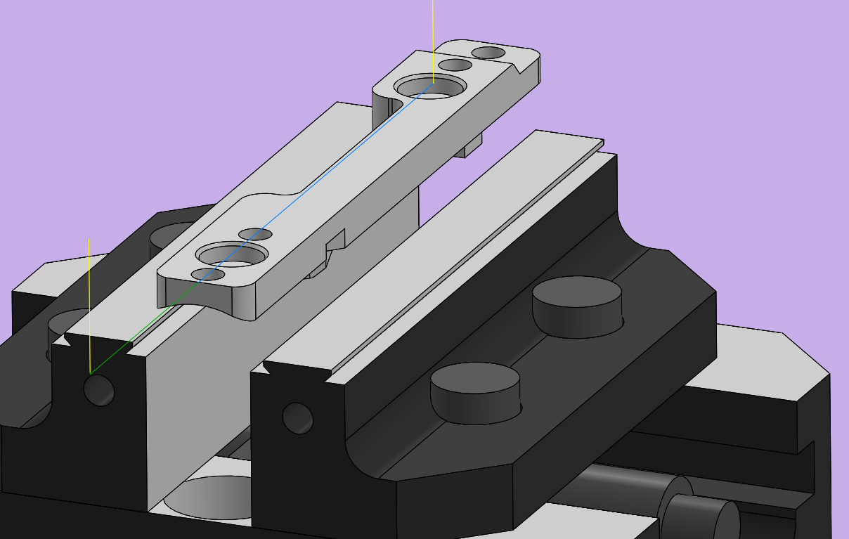

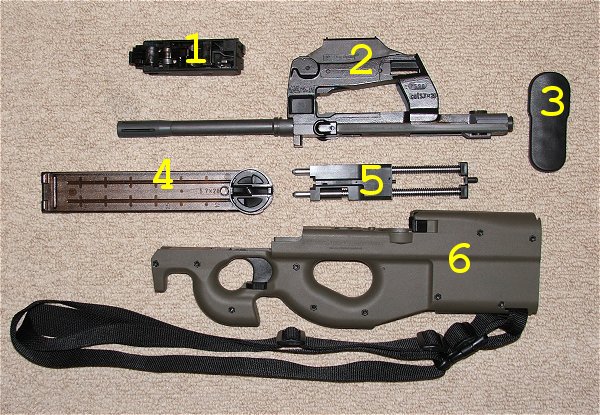

What's the deal with the top set of screws in the second picture? They don't match the screws below.
Its for a p90. Pic 1 is front of part 2. Pic 3 is different view of same. Pic 2 is rear of part 2. Part 4 (mag) goes between back of part 2.
I get that. I'm just saying that there are countersunk or recessed screws on the whole thing everywhere. And then there's those two screws that look like wood screw heads. Very out of place to me.
