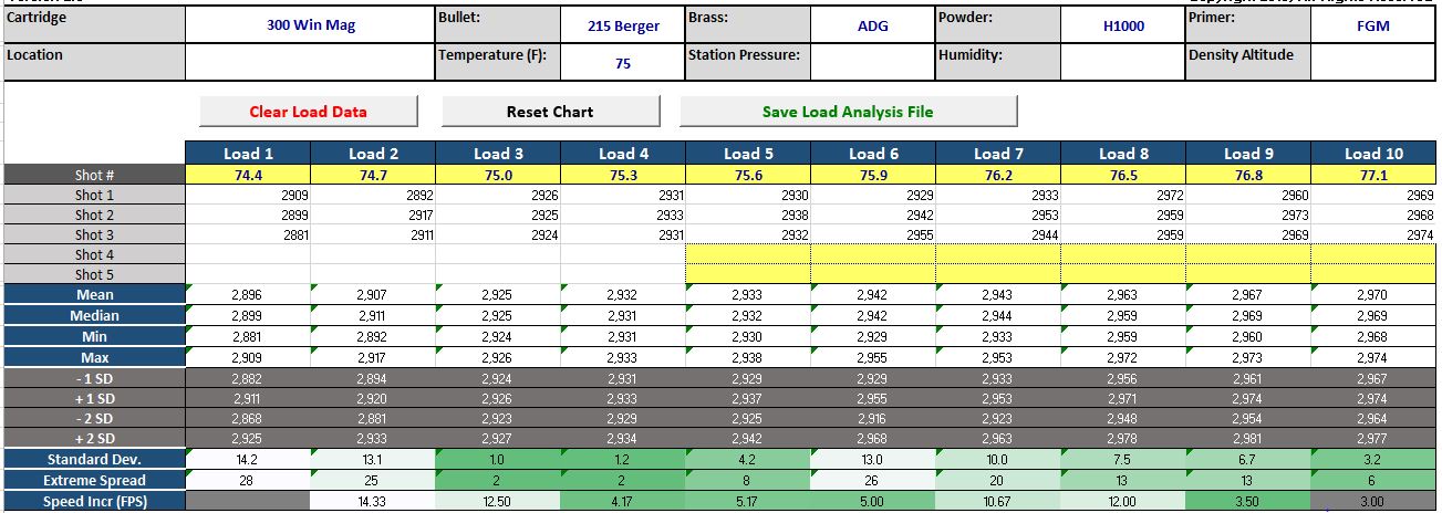

Try this spreadsheet. It works great on deciding a load.
Here's a video explaining how to use it
This is an example from my 300wm

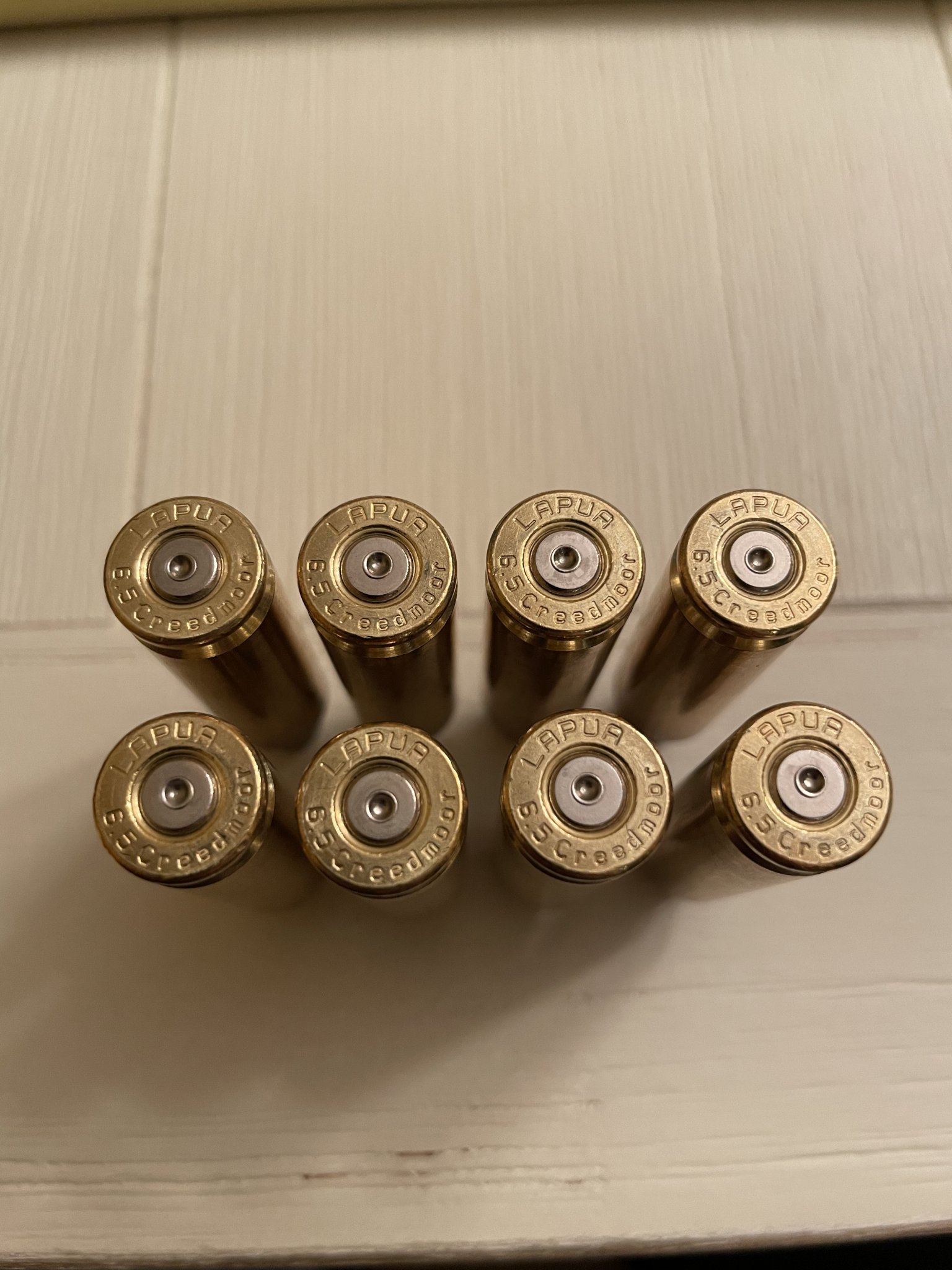

Here’s the eight round Lapua brass ladder I ran.
Top row 40.2 40.4 40.6 40.8
Bottom. 41.0 41.2 41.4 41.6
