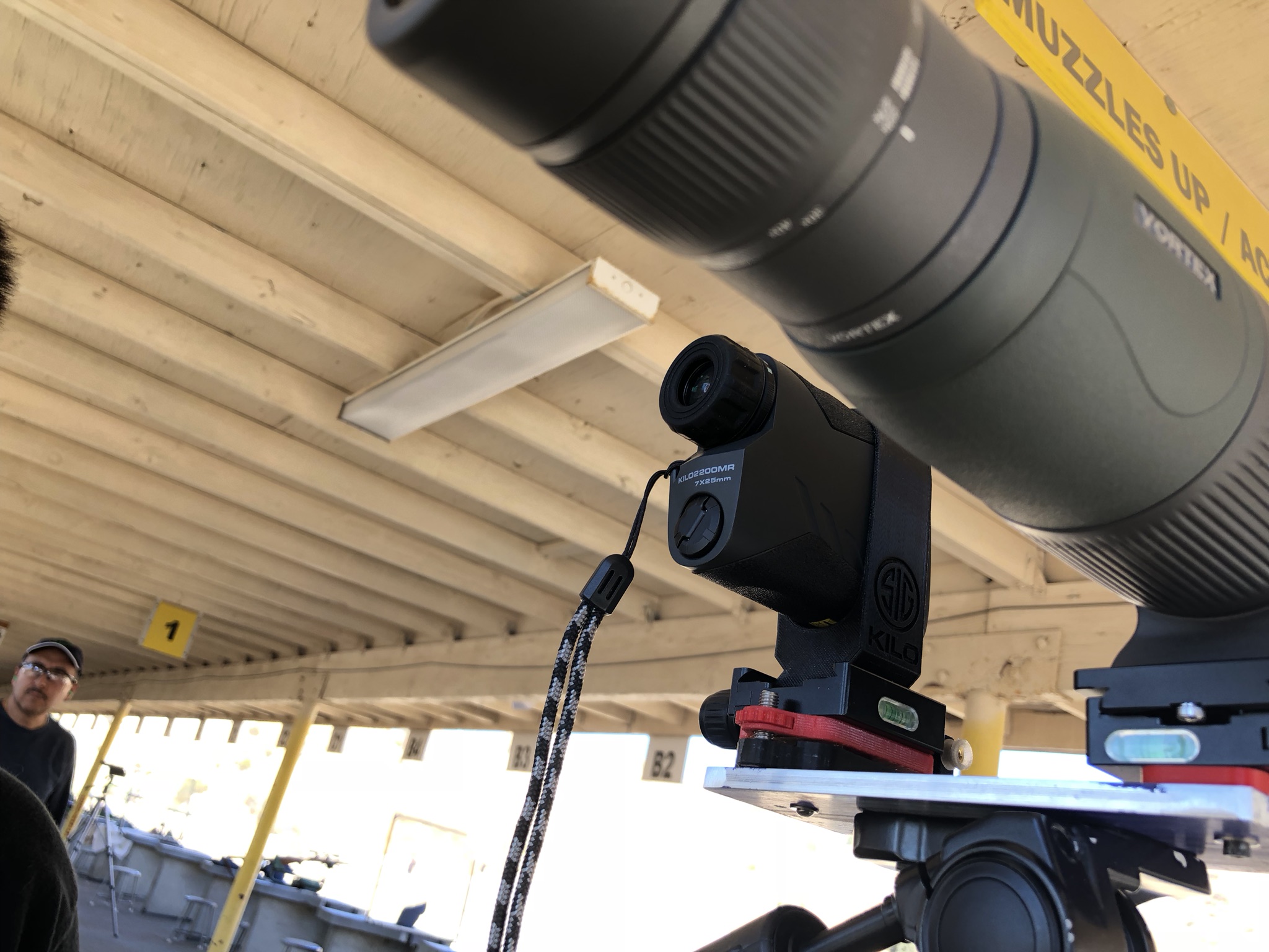

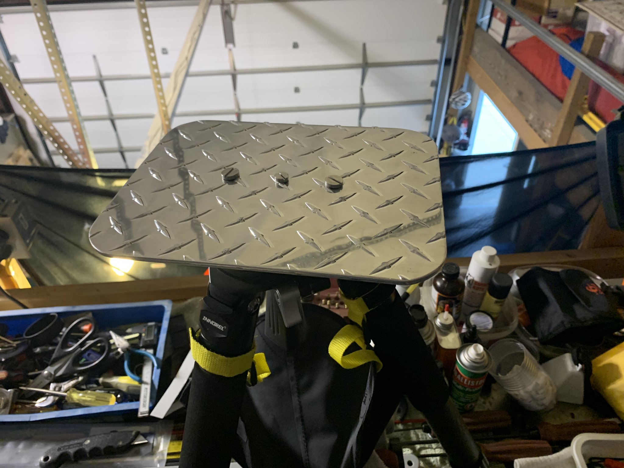

This was more of an excuse to design and build than anything. I've barely used it, but it's been a fun build and I actually want to improve it even though I don't have much use for it: 7077194
You can kind of see where I'm going with this, aim at an object with the spotter, shift over to the rangefinder, and use the base to adjust your point of aim to wherever you were looking through the spotter.

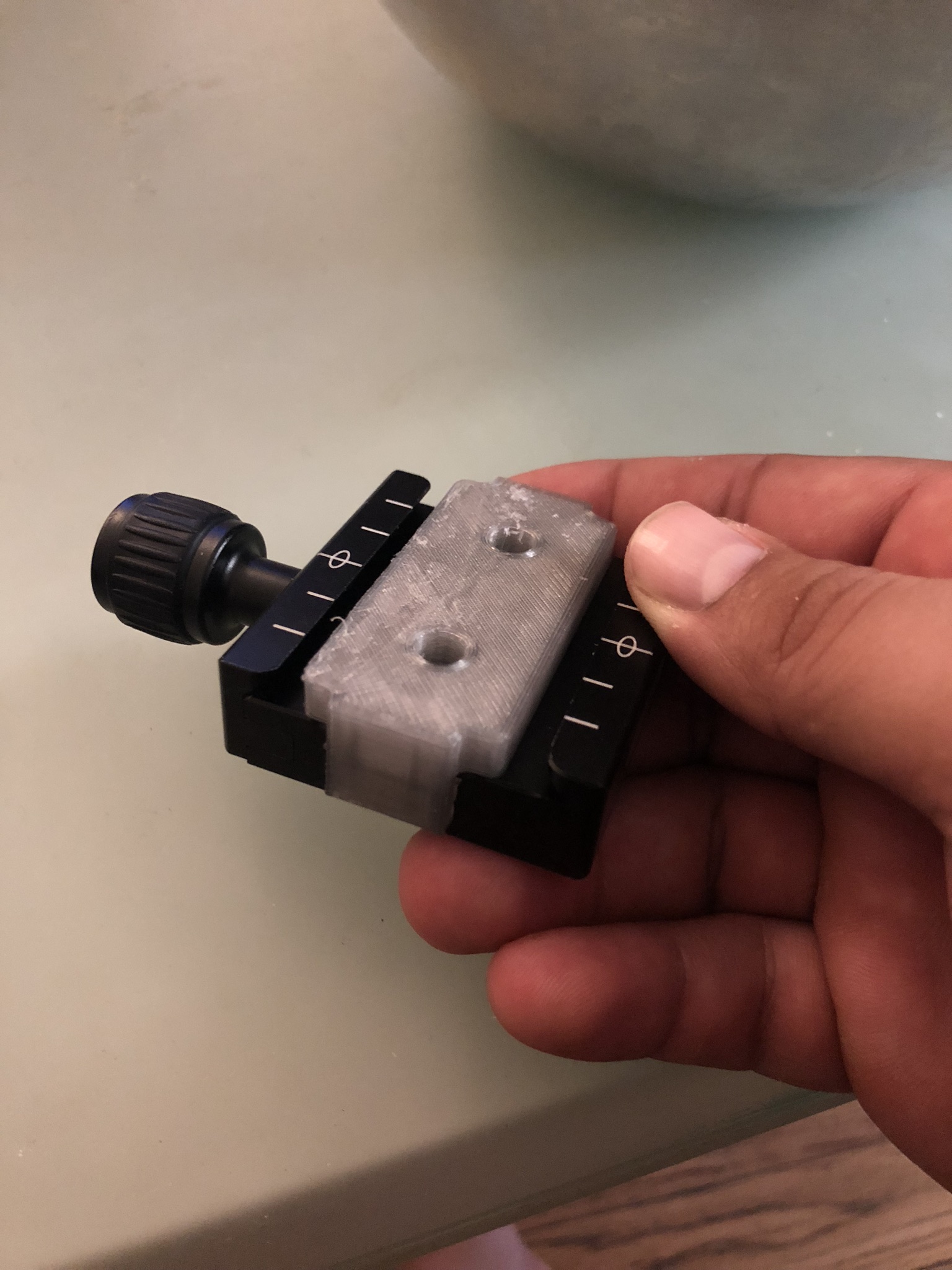

I started off with these cheap clamps:
https://www.amazon.com/gp/product/B00KYEO70Q/ref=ppx_yo_dt_b_search_asin_title?ie=UTF8&psc=1
And I made a jig to drill holes to mount them onto my bases:
7077195

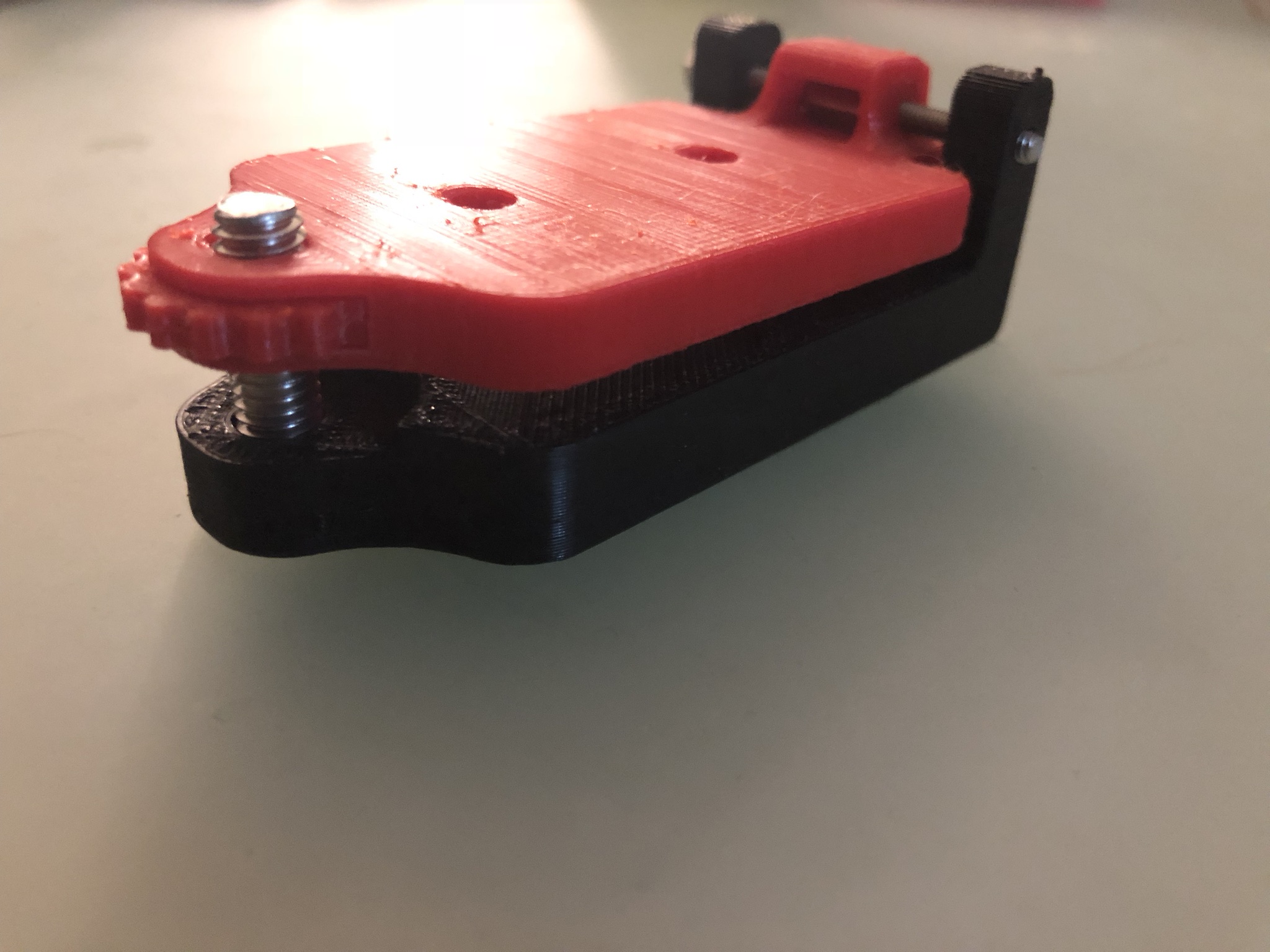

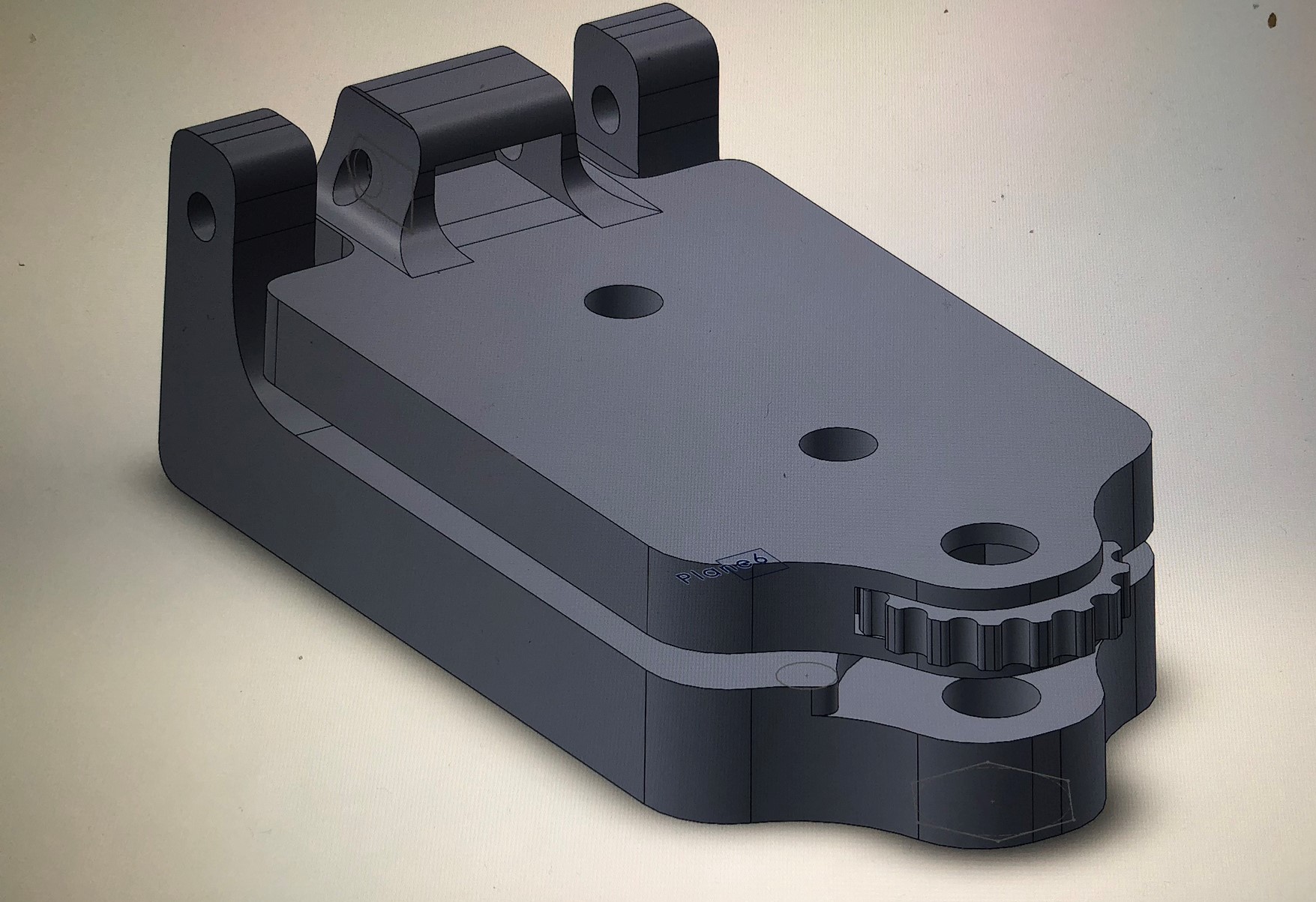

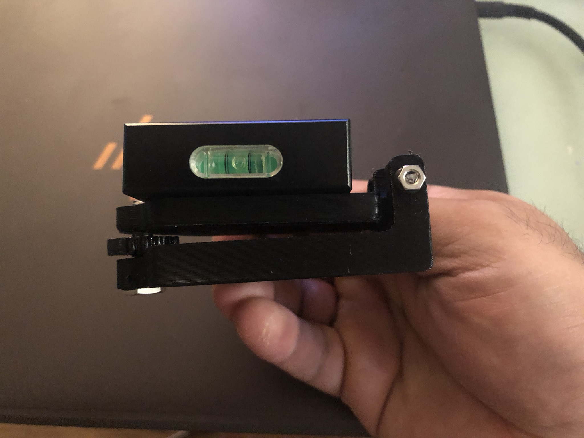

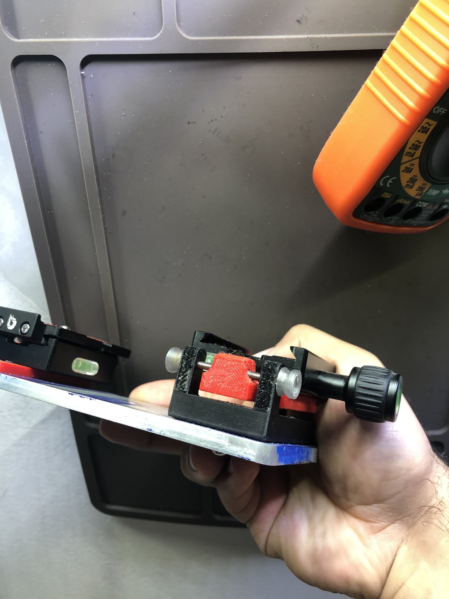

Next step was the "aiming" base, and I was inspired by the older Elcan optics.
7077196

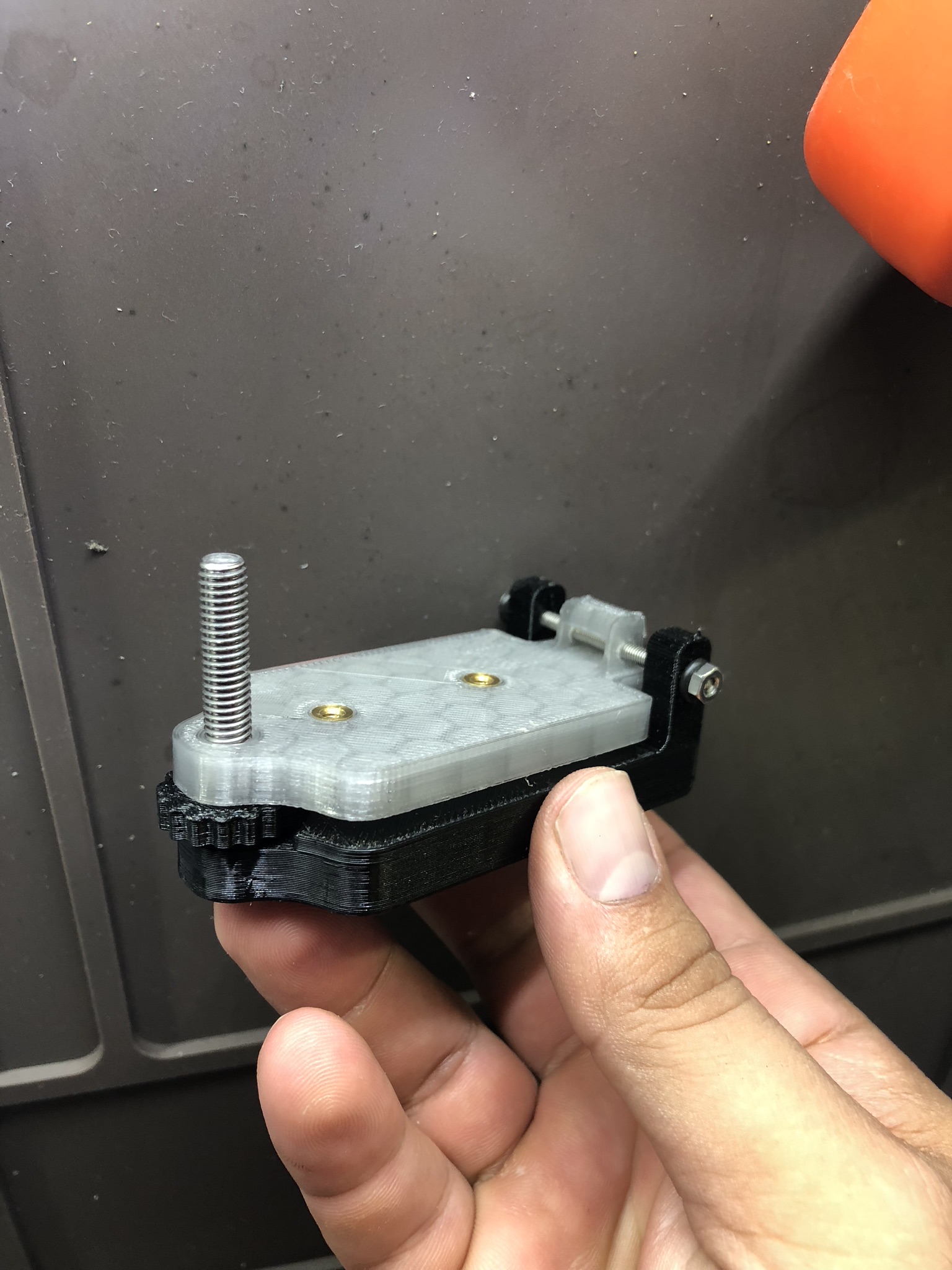

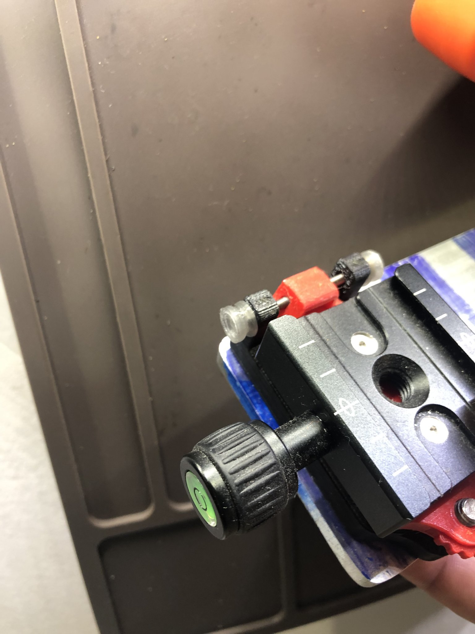

Left and right adjustments in the front, and up and down is in the back.
7077197
7077198
Went through a few design changes getting things to line up and settled back on this one:7077200
7077201
Video of it in action here:
http://instagr.am/p/BoGGk5-hll2/
I plan to release the files on this, but I'm not completely happy with it yet. I'm going to add a swivel to both adjustments so you can get the full range of motion without putting stress on the parts, and I'm going to make it bigger overall for greater stability. I want the plate to hug the clamps. I might do something to make the aluminum plate look less like scrap... but that might be stretching it for me. I definitely want to make a remote fire for the rangefinder so it doesn't move as much when ranging distant objects as well.

I did make a thumb wheel for the windage, and I used stacked orings to give the adjustment some tension, I just didn’t have a good picture of the front on my completed one.
When I make the entire thing bigger I’ll have more space for a more refined adjustment.
Once I post up all the files and parts, as long as your devices have a 1/4”-20 screw hole, you can just throw them onto an arca plate and you’ll be set.

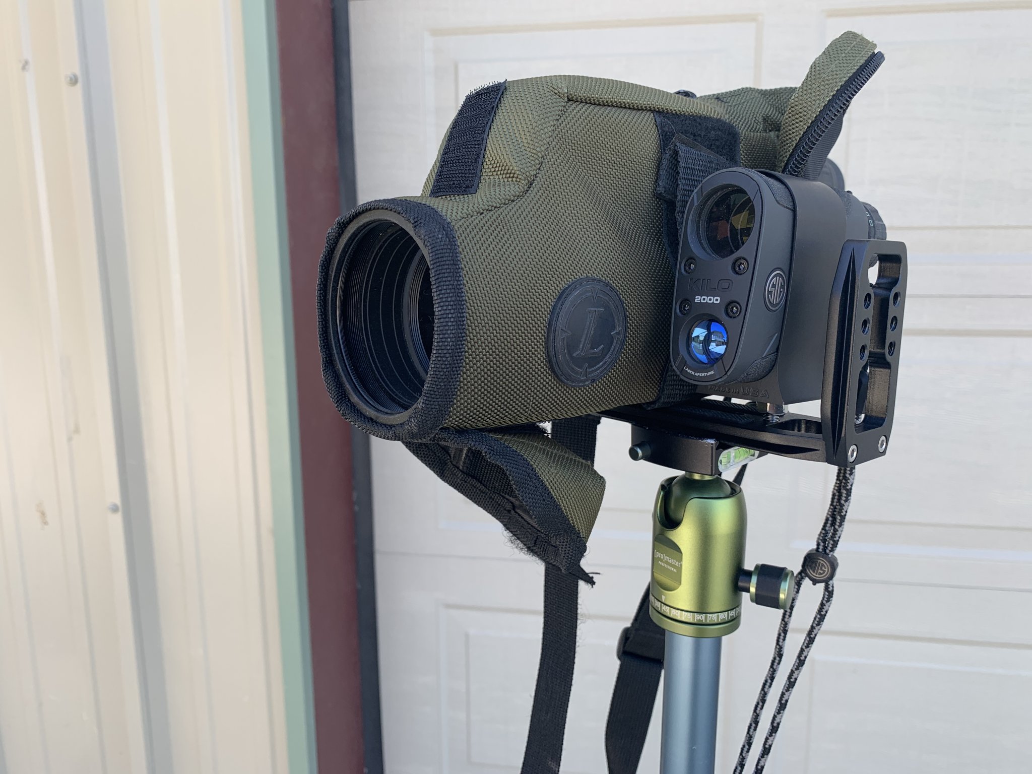

I did this, and stacking them works better IMO but I need a mount kind of like your Elcan style mount for my LRF. Ideally I'd like to superimpose the LRF reticle over the Observation reticle at infinity (or 6 miles, the limit of the LRF). That way the greatest difference will be the vertical distance between the two devices at 0m, just a few inches, and at 10,000m they'll be point on. Right now I don't have a solid mount for the LRF, it's just bolted on. Maybe I'll get a buddy to make me one of those if he can... A mount like your Elcan setup but with a base cut to fit the LRF's angled lug.
Here it is:
7079455
The idea was also to zero the PEQ2 to the others but I haven't been able to make that happen yet. Need the LRF locked down and adj. first. OR adjusted and locked down. The idea was to lase the target with the PEQ and follow that up with the LRF to get the reading without actually looking at the target through the LRF.

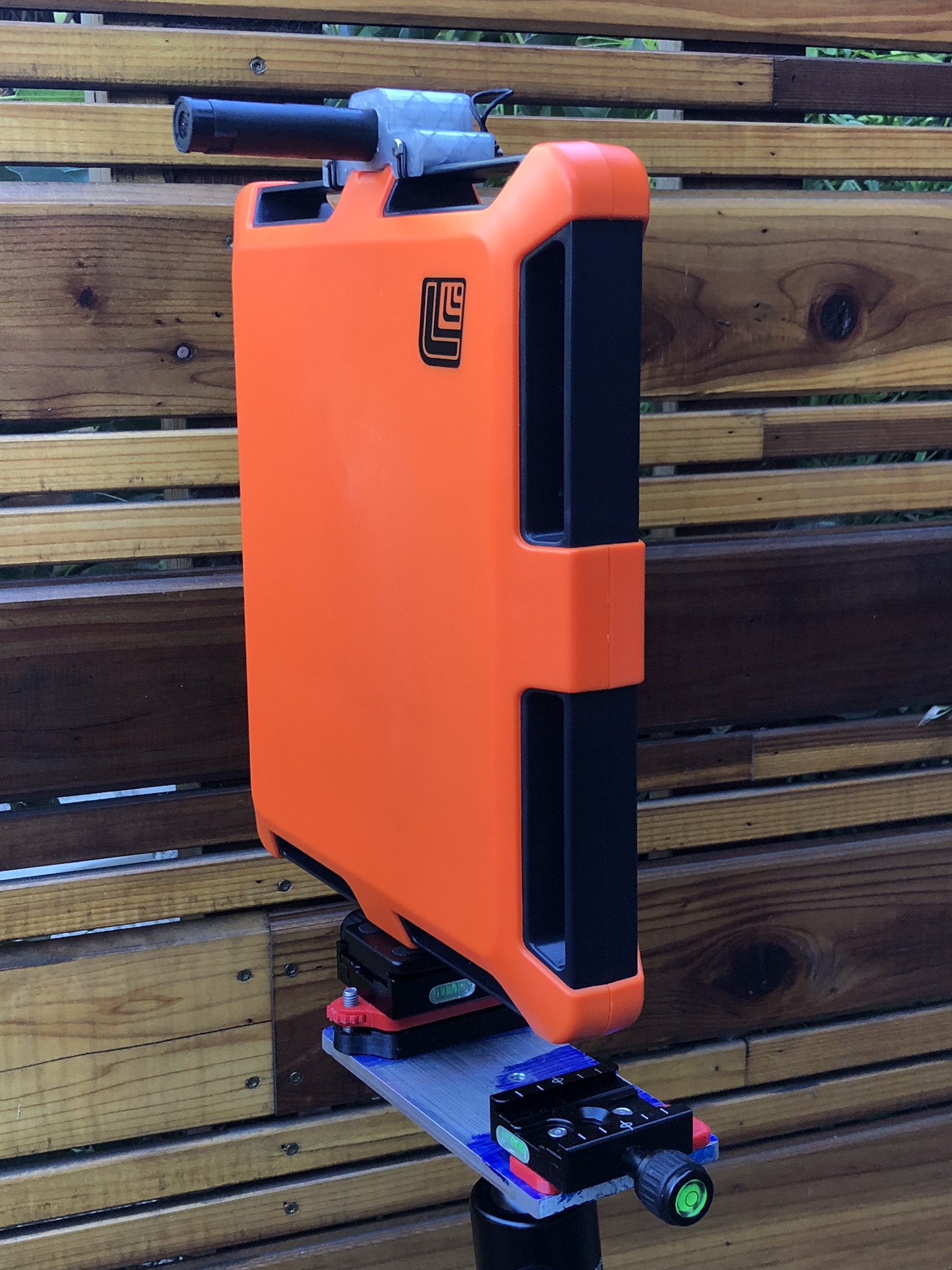

Here is what I put together via parts on Amazon and a couple of hardware bits.
thaflash_la
Belligerents
Apr 10, 2014
107
65
34
I wanted to do slots like the abel table, but just haven’t gotten around to milling something like that. And after seeing similar things on amazon, it’ll be easier for me to buy something.

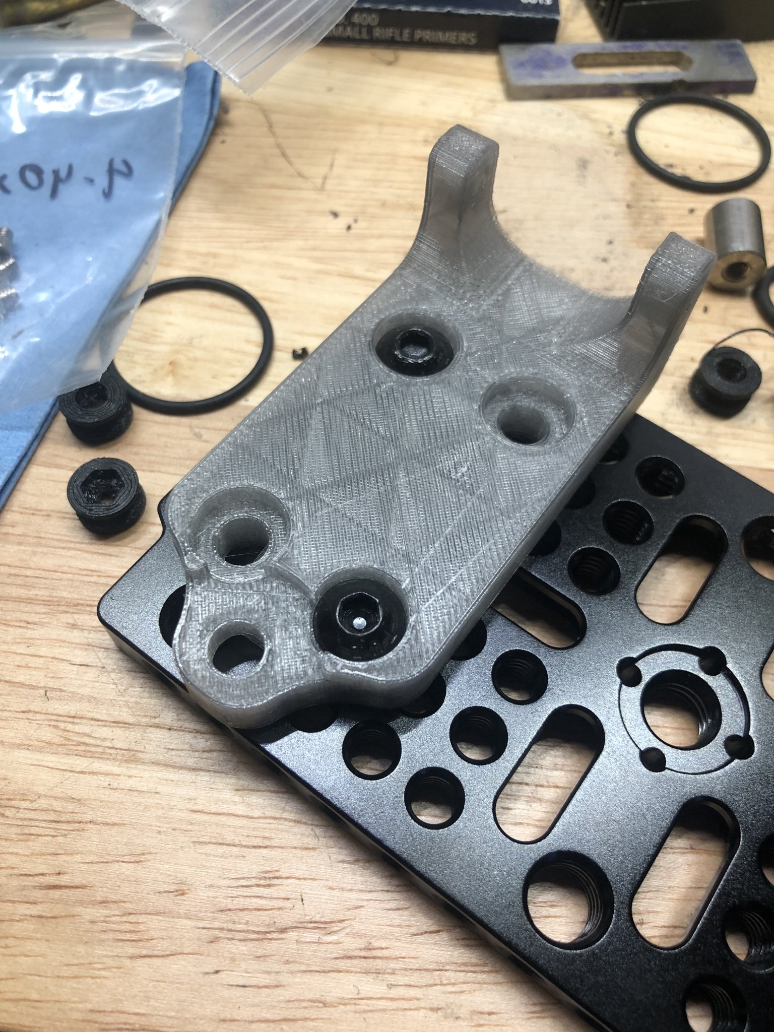

Taking inspiration from @Rover31 and @Strykervet i purchased a “cheese plate” from amazon to take the place of my aluminum plate.
SMALLRIG Multi-Purpose Switching Plate for Rail Block, Dovetail Camera Cheese Plate - 1681 https://www.amazon.com/dp/B019C2ZM8Q/ref=cm_sw_r_cp_api_i_oCi6Cb172RWX6
I’m going to adapt my aiming mount if necessary, to fit the hole pattern, and also see about printing up brackets so that I can make a cage with other cheeseplates. I don’t know what other kind of extraneous shit I can bolt on, but I’ll find stuff.
Also seems good for my labradar setup where I can fine tune the aiming, and slave a scope to get groups and velocity.

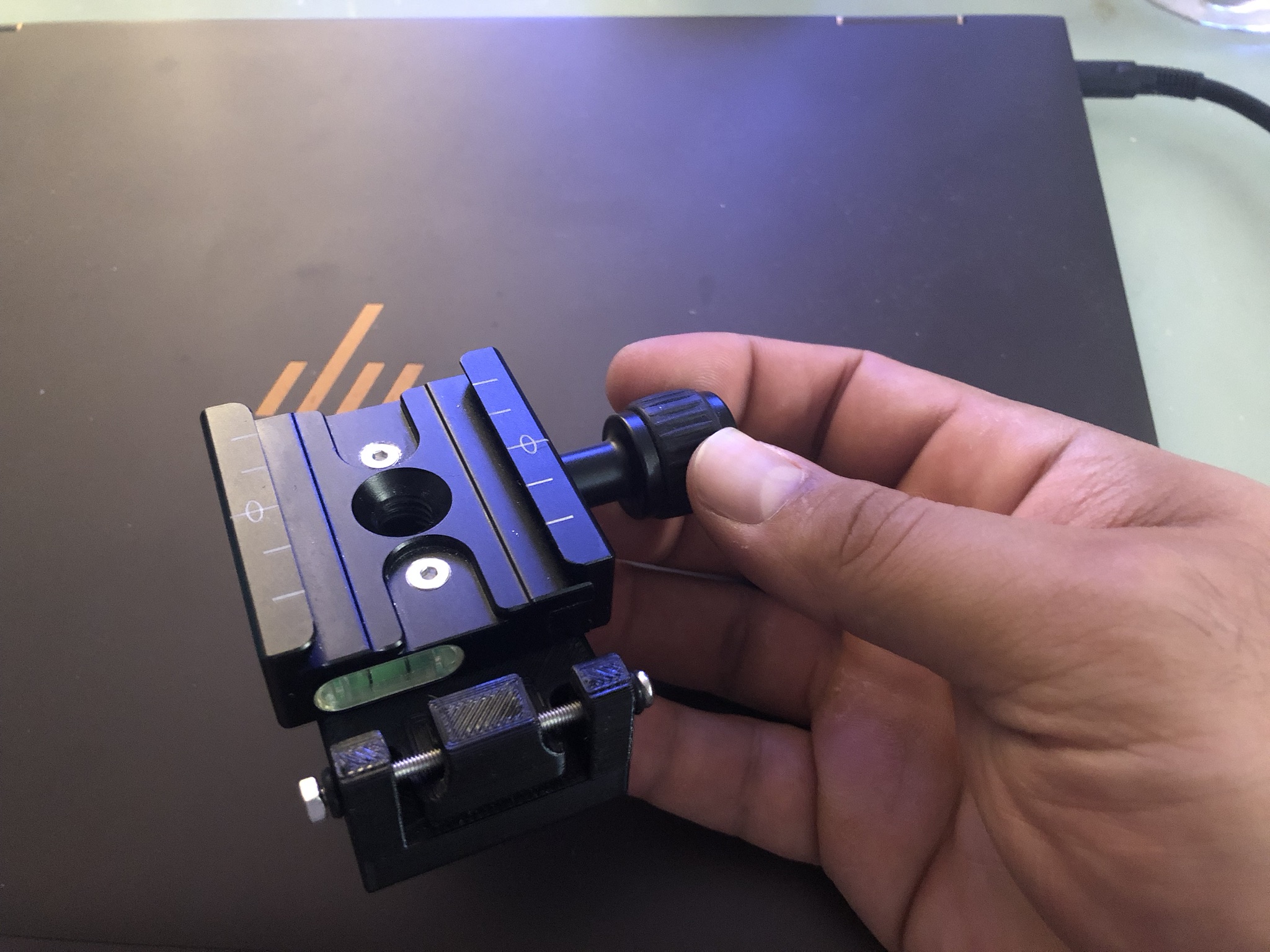

Need to test for a couple more parts, but I should be able to have this uploaded tomorrow as an update to my files. I modified the part to fit on the smallrig pattern cheese plate. This should also do away with needing to file down the M6 bolt. 7085329
Reactions: Rover31

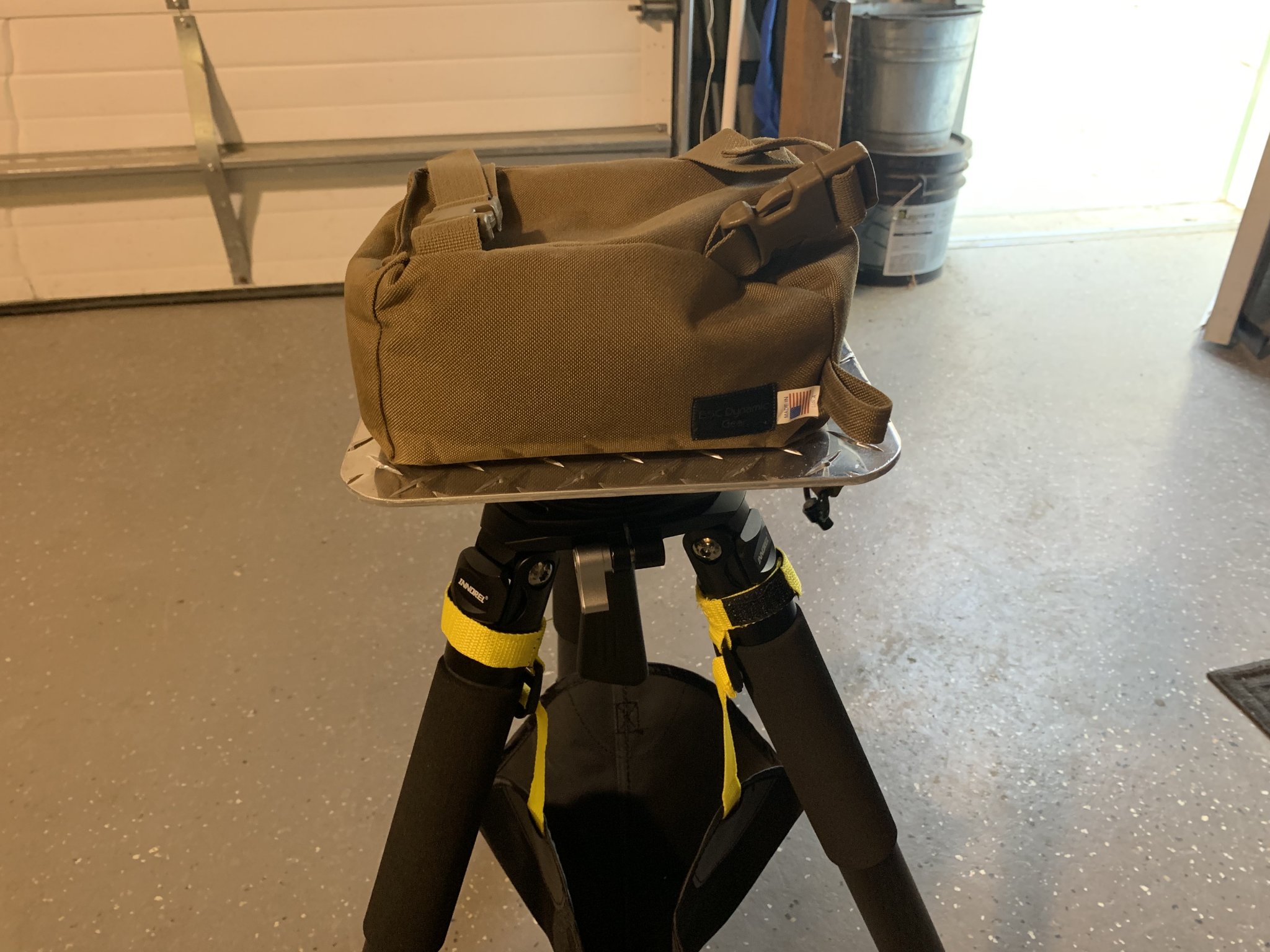

I need to get a tripod strong enough to shoot off of. Mine claims it can handle 60lbs, but that’s clearly chinese lbs.
