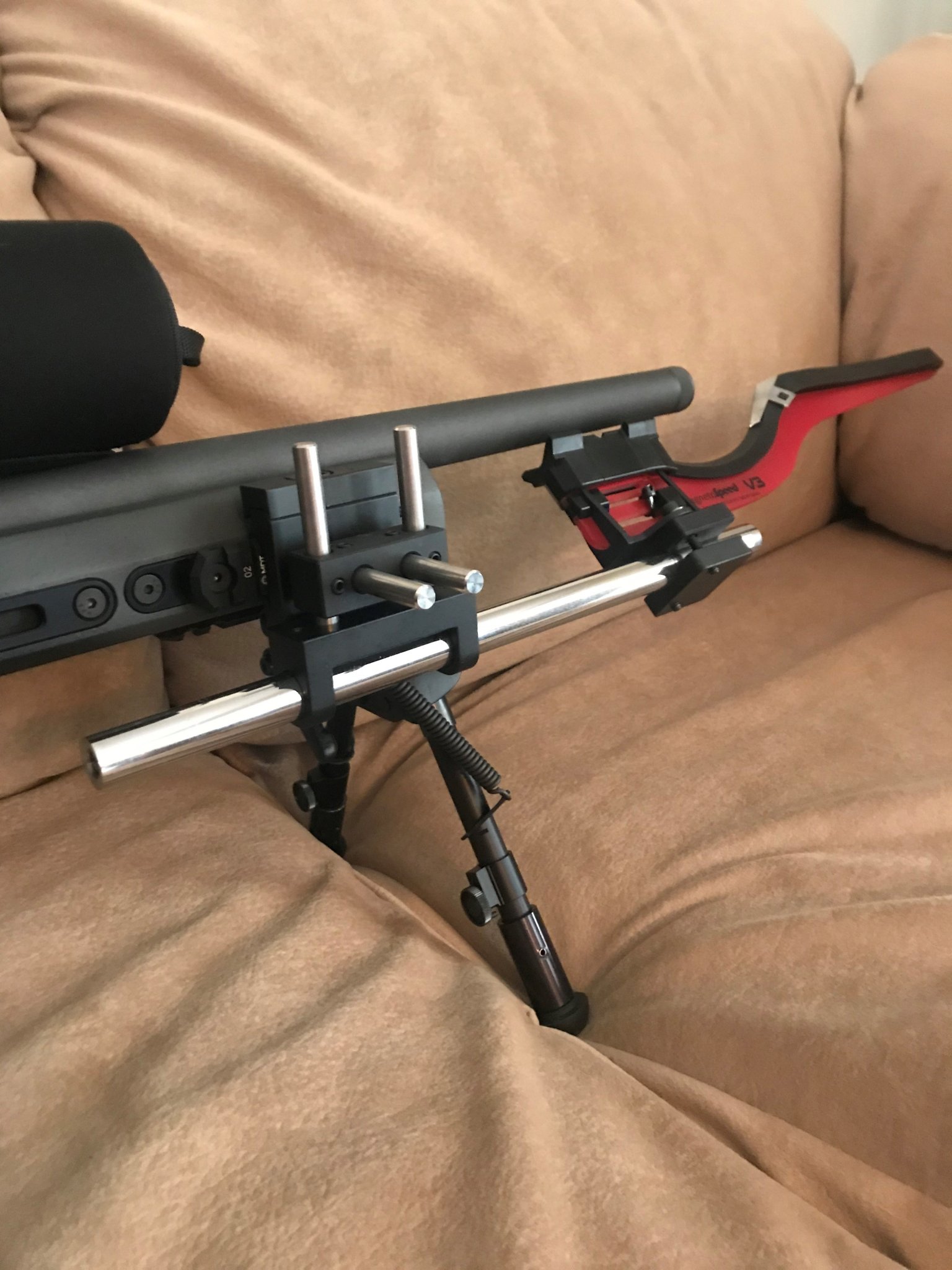

Has anybody here used a Magnetospeed chronograph to test 22LR velocities? I just got it all set up with the MK Machining mount and trying to get to the range tomorrow. Hoping someone could tell me what sensitivity setting works the best with 22LR.

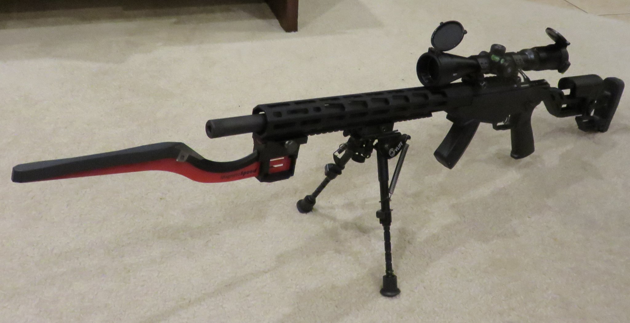

I set mine at 8 for 22LR and it never missed a reading (close to 5,000 LR rounds fired over it).

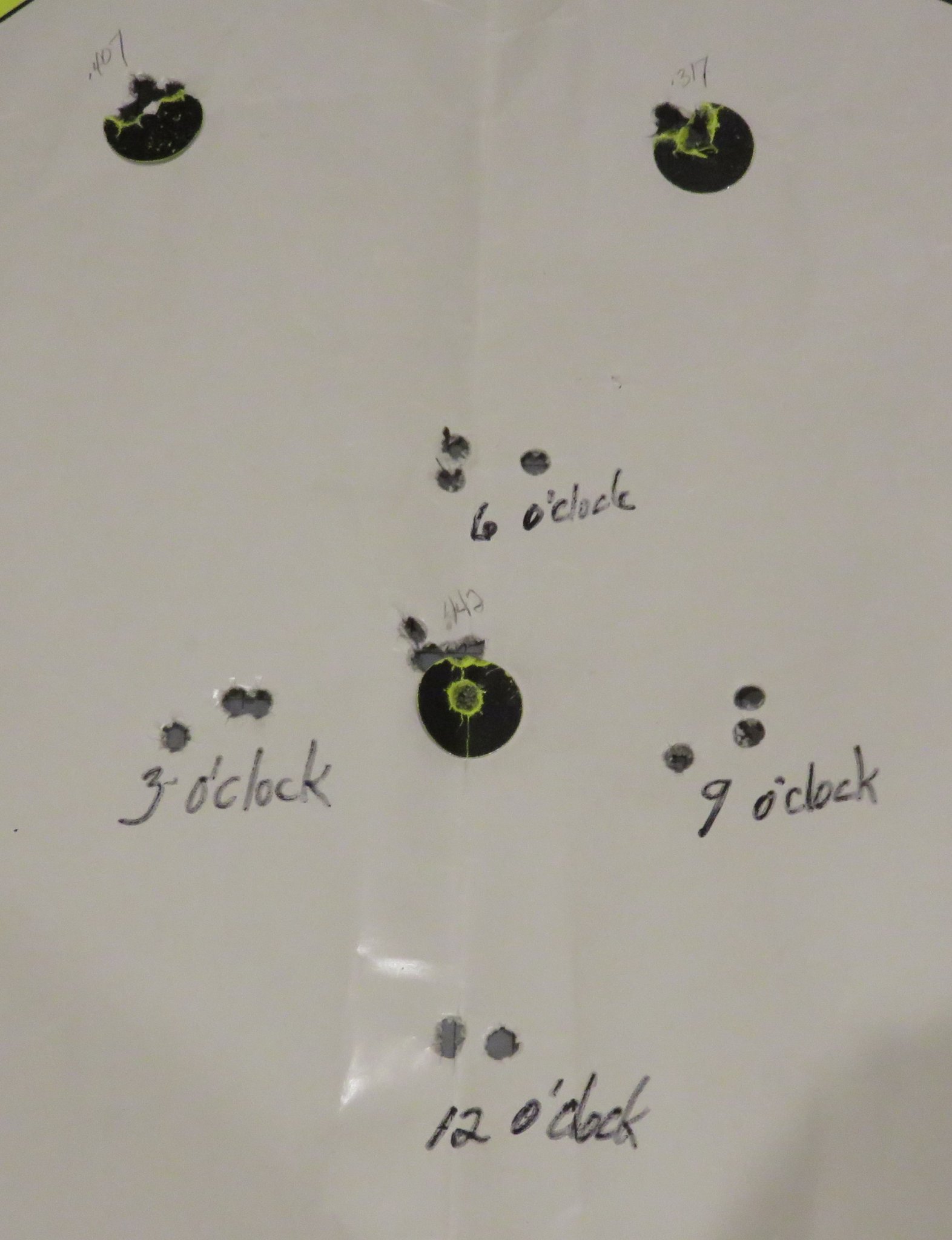

Here's a pic of the experiment I did with my MagnetoSpeed on my .308 as I rotated the MagnetoSpeed clockwise 360° at 90° increments starting at the normal mounting configuration at the 6 o'clock position:
I found that it does effect group size as it changes the harmonics of the barrel. In my case, the groups were still pretty good and good enough for evaluating load development for my .308 . . . just that the POI was a about 2.6" high and when attached to the barrel, the POI was a little higher. For my 22LR, which never had it attached to the barrel, I couldn't see any distinguishable difference.
