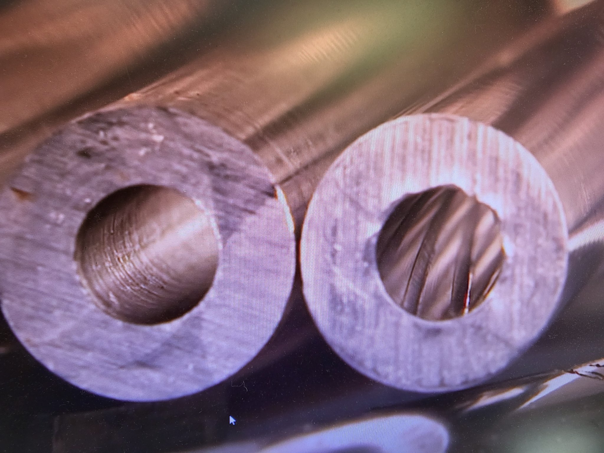

This is the view from the end on a button rifled barrel. Look at the face after it was rifled.
The bore ream finish isn't the greatest looking either. Some will say you don't need to prelap or finish lap a button barrel either because the button rifling will iron out the bore reamer marks! I don't think so bat man! You can see the roughness of the bore on tops of the lands even after button rifling. Look how the metal got displaced on the grooves from when the button entered the barrel blank. Also I've never seen any chips come out of the blank after the button came out. So no chips....steel is deformed...I say displaced...not removed.

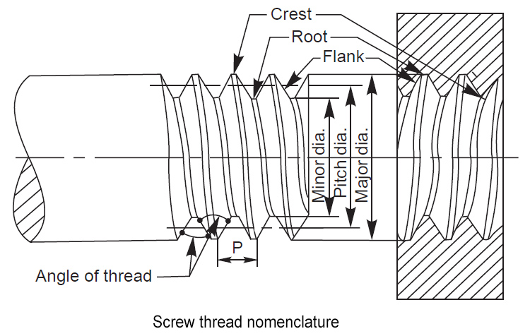

Have you ever messed with making threads?
There is cut threads and there is form/roll threads.
Cut threads the OD is cut to major diameter and ID threads drilled to minor diameter. The thread is then cut and metal is removed to form the thread.
On roll threads the OD is cut to pitch diameter and on form threads the hole is drilled to pitch diameter. The pitch gets pushed to form the crest and root.
Is the pushed metal displaced?
I'm sure on button rifled barrels the bore is drilled to the rifled equivalent of pitch diameter.
Figured that might clear up differences.

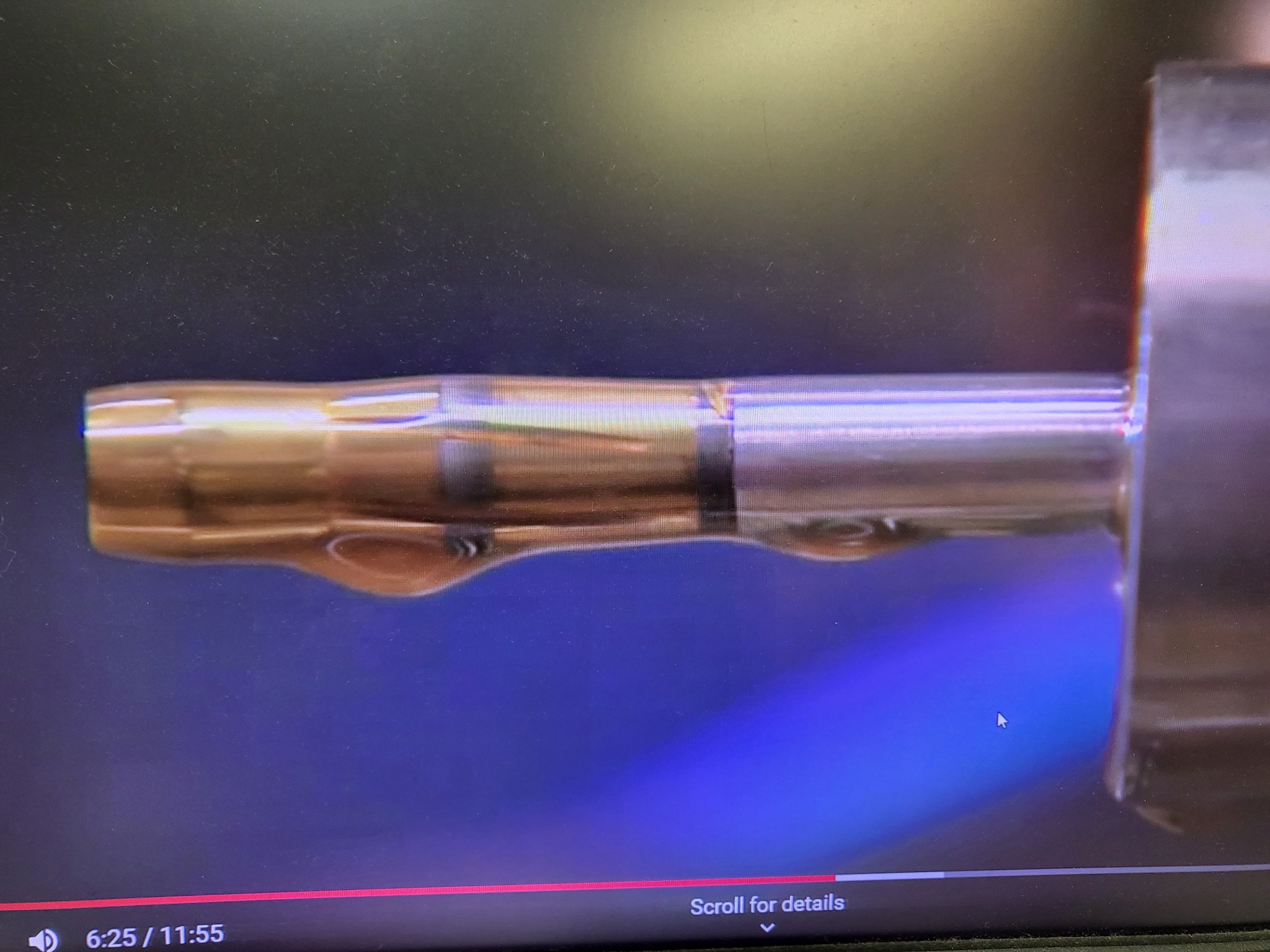

Here is a picture of a button. This is called a combination button. You can see the grooves in the button that will form the lands of the rifling. it also looks pregnant. It has to expand/displace the material in order to form the rifling etc...
Again for example on a 30cal barrel you might be using a .3115" or a .312" diameter button because of the spring back to get it to come in around .308" diameter.
