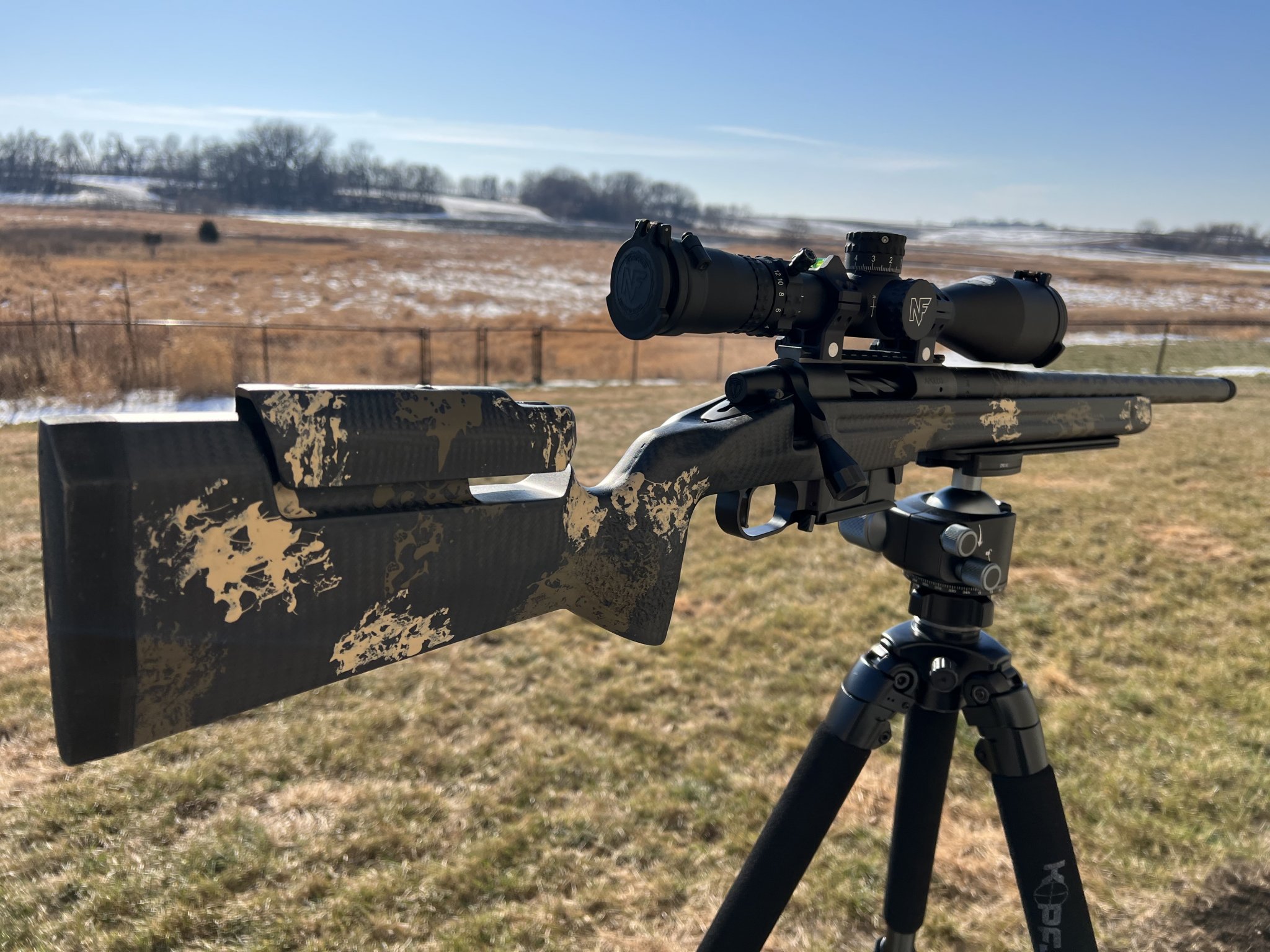

Been running this lrh for a year now, been really enjoying it. Has a lower height from center of bore to bottom of arca, then my prs1 which makes it feel more planted. I also like how the bottom is parallel to the barrel.
Unfortunately this lrh doesn’t have a mini chassis, but my next one will. The stock being so lightweight (36oz), it allows you to add weight where you want it.
