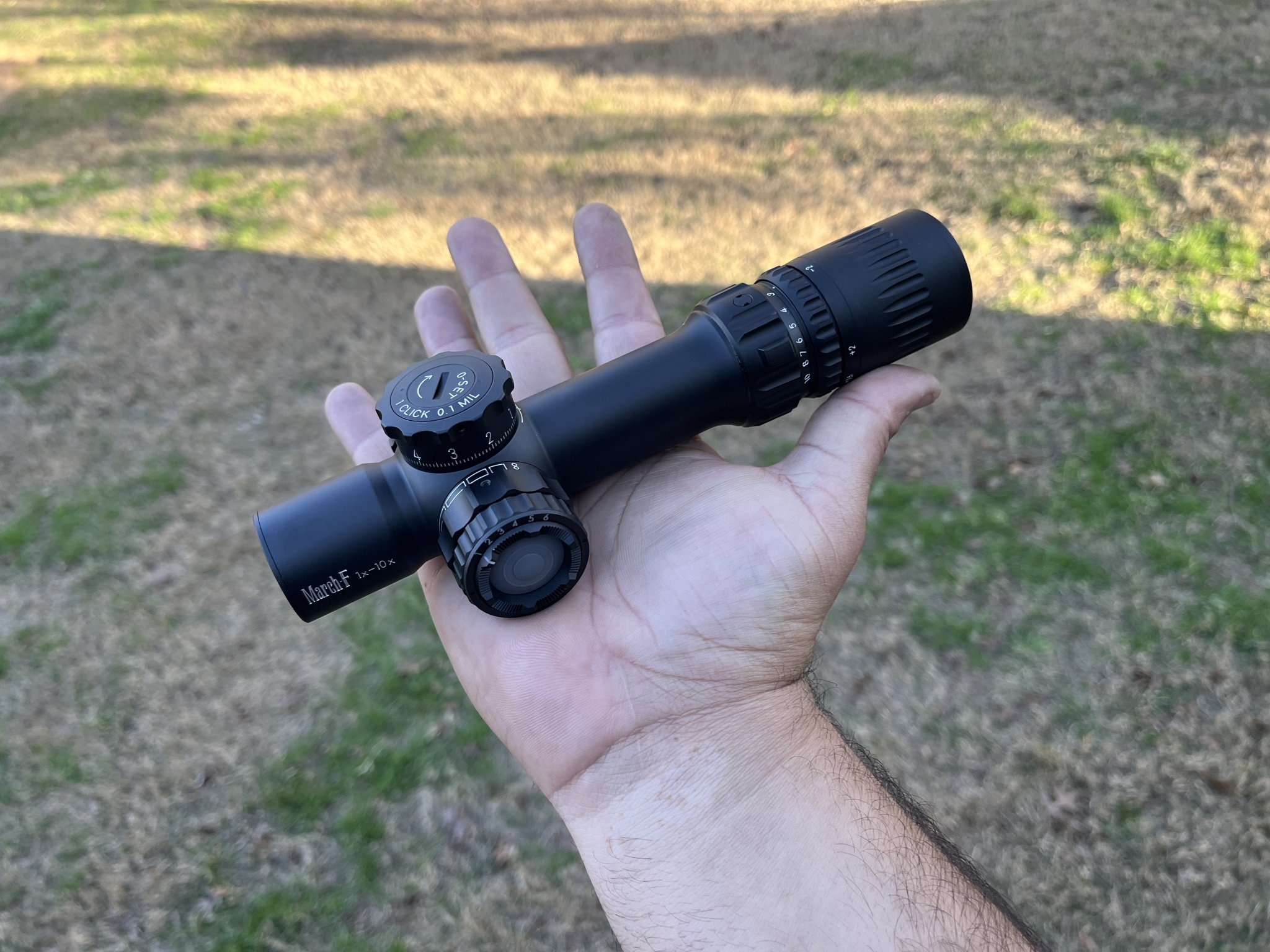

I was today years old when I heard about the new offering from March. Anyone gotten some hands-on time yet?
Their 1-10 Shorty appears to have all the ingredients of a winning LPVO to sit on top of an all purpose battle rifle (SR-25 ACC). Intended usage is Heavy Metal division in various carbine competitions including Run N Gun matches. Typical targets range from 5-750 yards, typically at least 3 MOA or bigger out at the longer ranges.

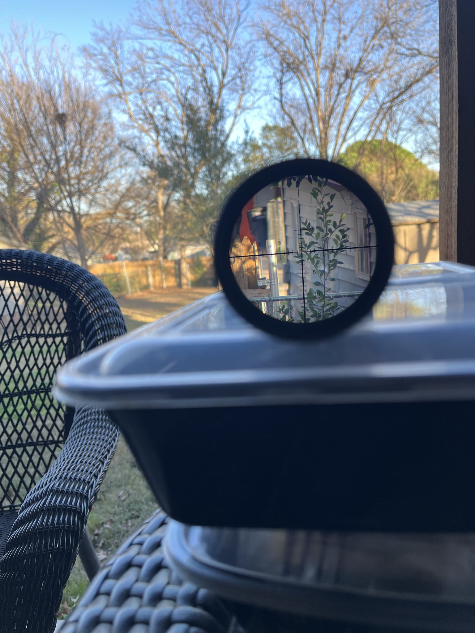

Personally, I'm most curious about the daylight brightness and performance on 1x. I currently have a Vortex 1-10 but the March is nearly 5 oz lighter and that is a sizable difference when you are running with it on your back for up to 8 miles.
It’s definitely day light bright! The 1x isn’t a true 1x more like the Razor GenIII 1-10 where the 1x is less actually…more like .7 but the eye box is much better than the Razor. It’s easier to get behind. The photos I took are with my iPhone 13. No special adapter. The illumination is on 1 only in the photos.

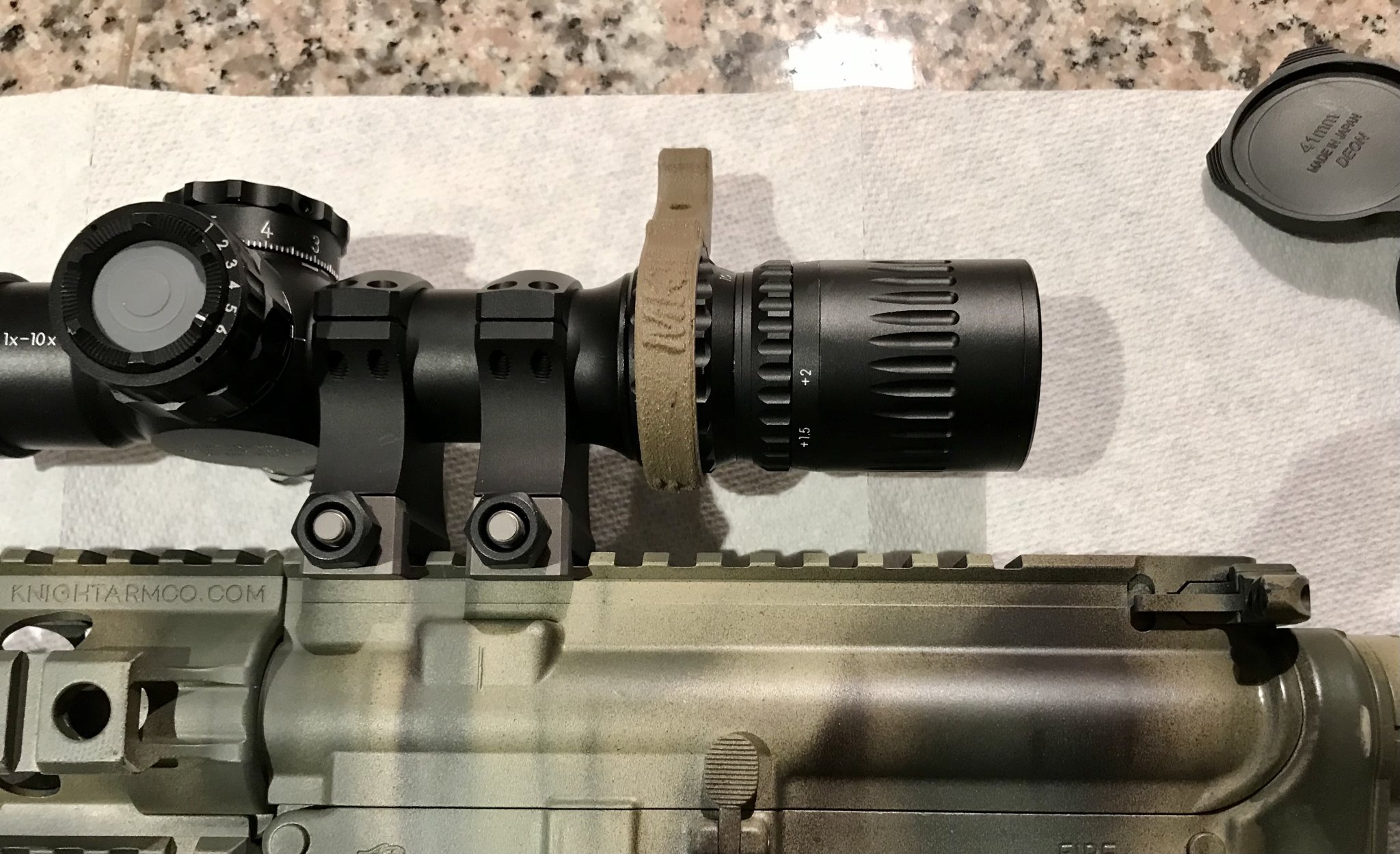

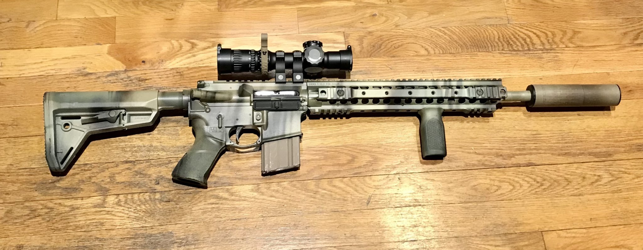

Do you think it has a place on a hiking hunting rifle
If you’re looking for the simple yes or no answer…yes. If I’m tracking what you’re saying, I have this setup on a Sig Cross .308 16” and the whole setup with my titanium can and Scalarworks Leap 02 mount is just under 8.7 lbs…loaded. And it holds zero. The leap mount is wide enough (or deep enough) in the ring and the base that is solid as far as I tested running 168gr bullets for the last 200 rds if you follow Scalarworks recommended torque spec of 25 inch lbs.
I decided to take the TierOne mount off and go with individual NF Ultralight 1.57 rings. Saves 5 ounces and seems very stout. We will see. This a 16 inch 6.5 Grendel I use for hunting deer and Hogs during the day.

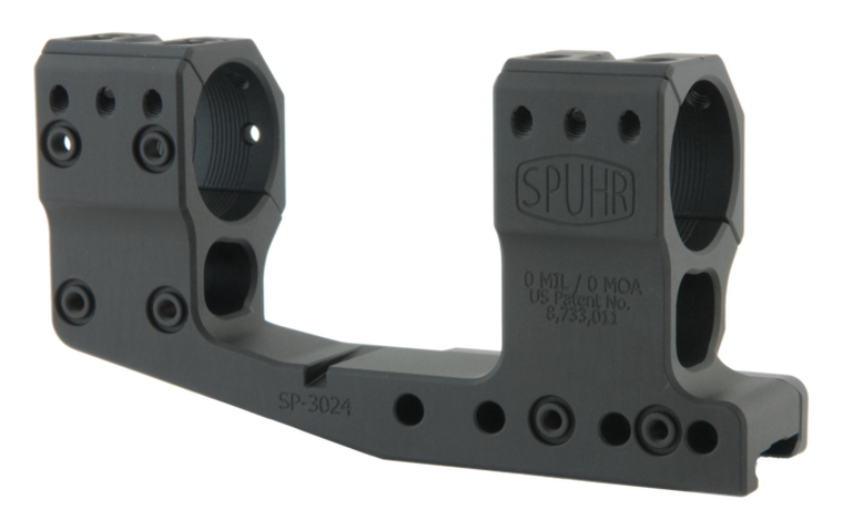

Honestly, I was looking for something NV height and considered purchasing a Spuhr SP-3024: 30mm Cantilever Mount 0 MOA - 1.89" and chopping the front ring off. Keep the base and all the lugs and then chop it right where the front end angled up. With a Dremel and some black sharpie for touch up.... But I have refrained. Wonder how much it would weigh?
About 60% of original.
You could get one of their non-cantilever mounts, cut it in half, and split the cost with someone else who has a March.
I suspect that is a very viable setup, as long as you can keep the front ring on the upper and not have to position it on the handguard.
For me, I don't think this is quite far enough forward. Do you have another set of rails to move it forward? And how much farther can you slide it forward before the radius on the tube interferes with the ring?
If you put the rings closer together you could move it forward another slot. If I did that I would be NTCH so I’m good with it as is.
Remember that the scope caps stick out in the rear and make it longer in the back than it is. It’s further forward than you think.

I don't know if that will work because the the bar that the QD levers are on is all one piece. If you cut it, I don't know if it clamps correctly or how many lugs are underneath. The reason I looked at the extended mount was because you could chop the front ring but still retain the entire base with all it's lugs and and clamping points.
I’ll have to do some more in depth research. I have access to a bunch of Sphur mounts at my buddies shop so I’ll have to take a look. Better probably to open it up to 33mm on just the front ring but i don’t know how it would be affixed to either a lathe or a mill. Probably a mill would work better but thats gotta be precise and i personally dont have that skill set. For the price of a Sphur you’re better off buying March’s scope mount ahead made for it.

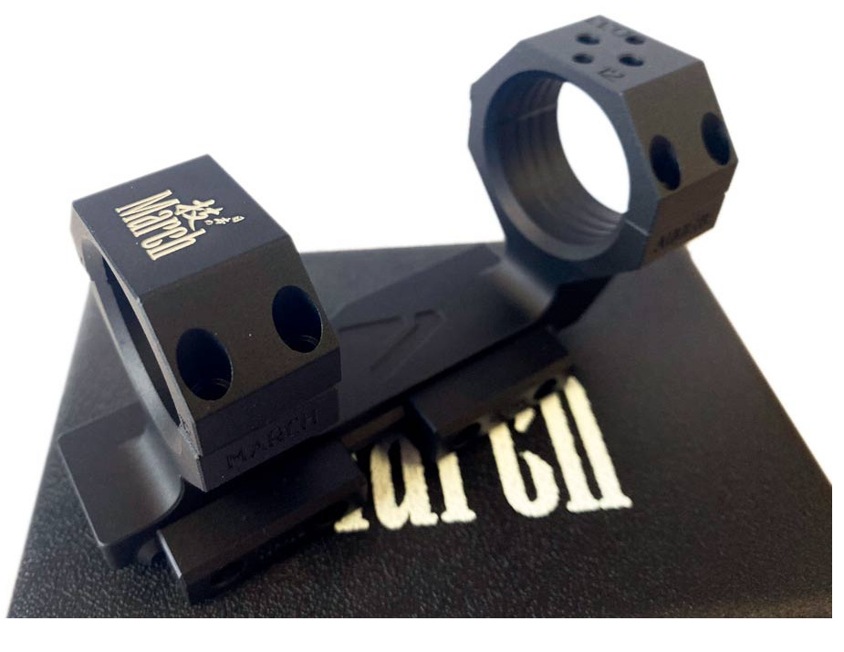

Trying to bore out an existing 30mm scope mount to 33mm is a significant undertaking, and that is assuming there is enough material in the mount to bore it out that large. To keep everything in alignment, the task is not trivial, and this is coming from an experienced machinist.
The truth is, despite the shortcomings with the 2 available options, there is not much reason to use anything other than the correct March or Tier One mount. Unless you have a specific reason to not use either of these options. Examples of such reasons:
1) Availability has been an issue at times.
2) The March is heavy, and has very little cantilever. The weight is troublesome, and the cantilever may be a no-go for some applications.
3) The Tier One has plenty of cantilever, but is REALLY heavy. The weight is even more troublesome. And they have been out of stock every time I ever looked.
So unless one of the above reasons drives you towards another option, you are probably better off going with 1 of the 2 current options.

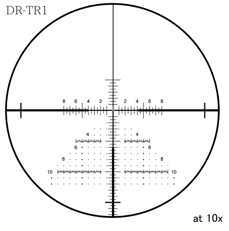

It is DFP, that is what the DF stands for, I just haven't kept up for a bit. Reticle is interesting, would like to see it first hand...
The March name for the reticle is DR-TR1. It is Dual Focal just like the original, but with a tree on the FFP reticle.
Did you purchase this specific mount? If so, are you happy with it? I ask because they have 2 of them in stock. Audēre and MK Machining are back ordered.
No complaints. I keep my eyepieces about even with the end of the upper receiver and that is enough eye relief for me.

Oh nice, what do you think of the reticle? How well aligned is the FFP hash marks with the SFP main cross? How prominent are those wind dots, are they easy to find when you need them?
I haven’t had a good look through it since I set it up, hoping to get out to the range with multiple projects soon.
