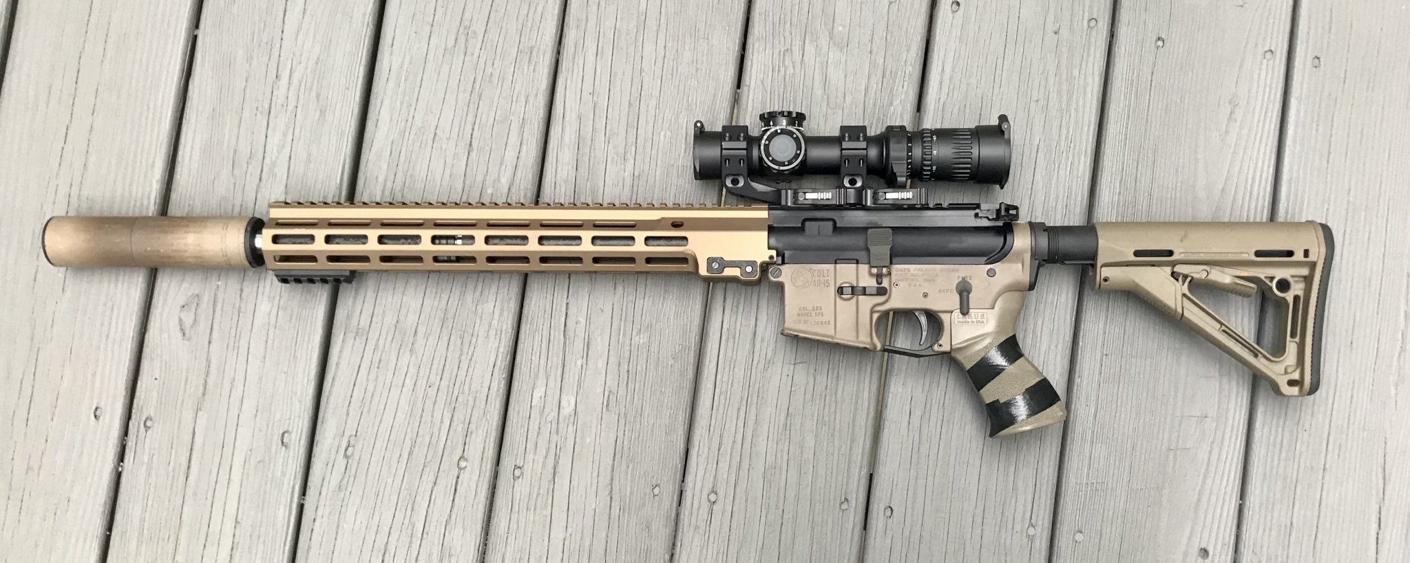

I received my March 1-10 with the original reticle. Mounted it using the Tier One QD mount on a 16 inch Proof CF barreled AR15 and Omega suppressor. The dot is definately daylight bright, not nuclear but a slight step below. At 1x it functions as a red dot and the edges of the scope almost disappear. Shooting off the tree is easy from 3x up to 10x. Glass is fantastic but there is a small bit of CA. The eye box is comfortable and was not an issue even at 10x. Parallax allows you to dial right in on longer shots. I shot it out to 500M on steel. I am extremely happy with this optic.
One issue I had was with the supplied snap on mag ring lever and the qd mount. When rotated all the way to the left toward 1x the plastic lever contacts the QD lever just before true 1x. Like at 1.1. The plastic lever is a bit fat and may have room to be clearanced or there may be aftermarket aluminum ones that are thinner and don't have this issue.

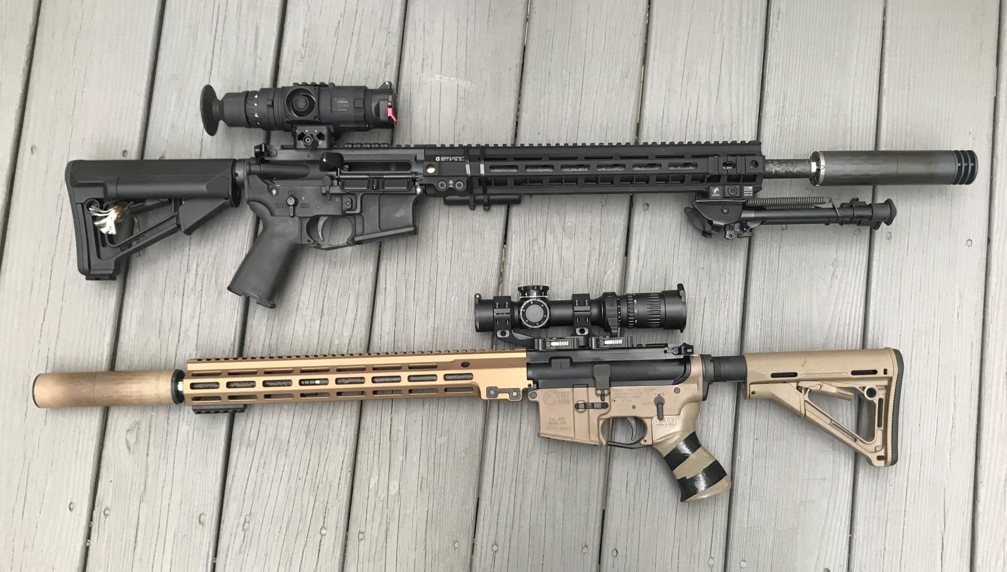

Also included picture of it with my 18inch Proof 6.5 Grendel set up for Hogs and Coyotes. And I apologize for lousy iphone pictures.

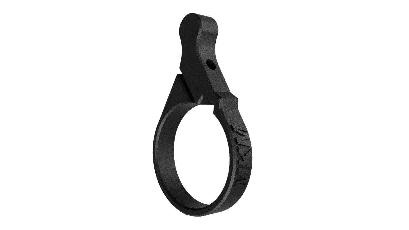

I found MK Machining prints polymer ones for MARCH F scopes and it has an offset "nub" placement so I ordered one. Looks like if it fits the offset will allow it the clearance needed plus they do FDE and who doesn't need another shade of FDE? Not sure it fits but cheap enough to try.
lMarch throw lever
lMarch throw lever
I had the same issue with that tier1 mount and throw lever. I can also confirm that the MKM lever will fix this issue. but if you can go with the pro series. It looks better and is more rigid.
I already ordered the other. I didn't notice the Pro series. Is there a difference? You had to go and tell me......damn it.
The non-pro version has the obvious 3D printing artifacts due to FDM process. The Pro series has more of a finished look due to a different printing technology. Their sales page for the march lever has the picture of the pro series. It should look similar to this: https://www.mkmachining.com/product/athlon-polymer-throw-levers/#throw-lever-model
