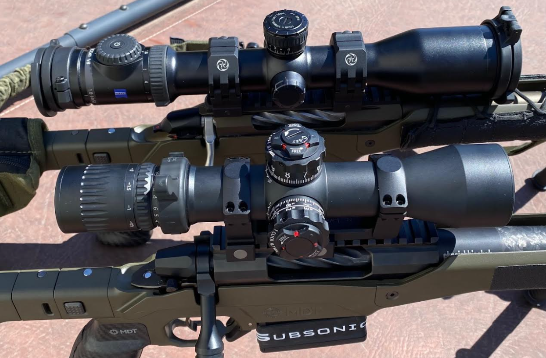

Mine arrived early! This thing is sweeeeeeeet! DFP is exactly what I hoped it would be since this is going on my hunting rifle. I was surprised by how nice the illumination is. Daylight bright for me. Eyebox is a bit tight on higher magnification but not horrible in my opinion. Parallax was another surprise for me after having the 3-24x March FX Tactical a while back. I did not like the 3-24x at all because of the parallax but this 1.5-15x is so much better. The parallax dial does go well past the infinity mark so to keep it set on infinity will have to be a regular double check. The turrets are nice and tactile and the locking mechanism is pretty cool, although I do think it can be bumped from locked/unlocked if not careful. It only takes about a 1/10th of a turn counterclockwise to unlock it and it moves smoothly. I would have liked that to be a little tighter so it takes more purposeful pressure to engage/disengage. The throw lever that comes with the scope is interesting. No bolts on it, just a self tightening latch that is all plastic. Curious how it will do in the woods and hold up over time. They positioned it well so it doesn't interfere with the bolt which was something I worried about with a 10x mag range.
I have a Zeiss V8 1.8-14x that I put this next too and the glass is great in both, hard to tell a difference. Felt like the leaves on a pear tree 100 yards away looked more vibrant in the March but not by much. Compared to the V8 this thing is tiny. Curious to see how they compare in low light, although I expect they will be on par which will be fantastic.
Overall at first glance: I'm impressed. Not that my opinion matters much but I am very happy with this scope even though I had to get it in Mil. :sick:

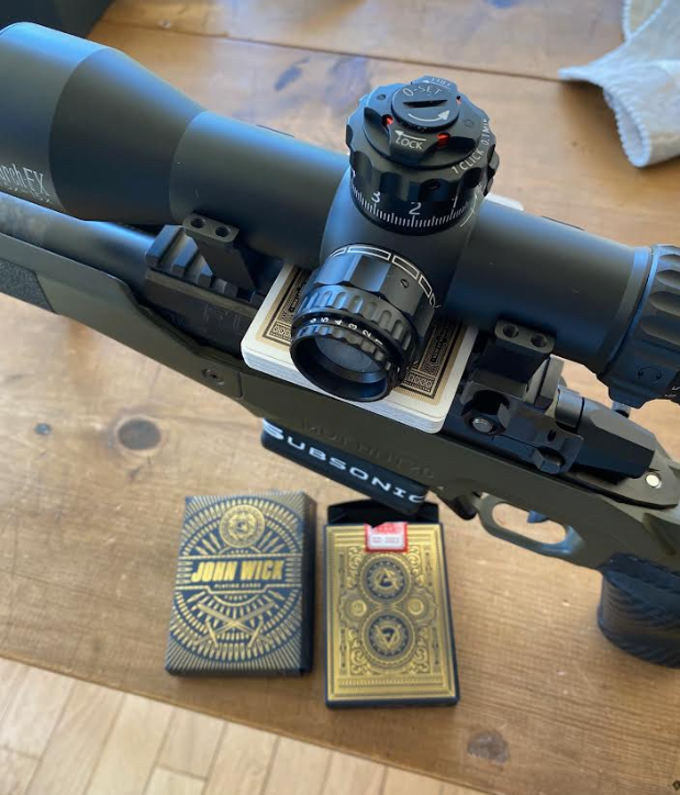

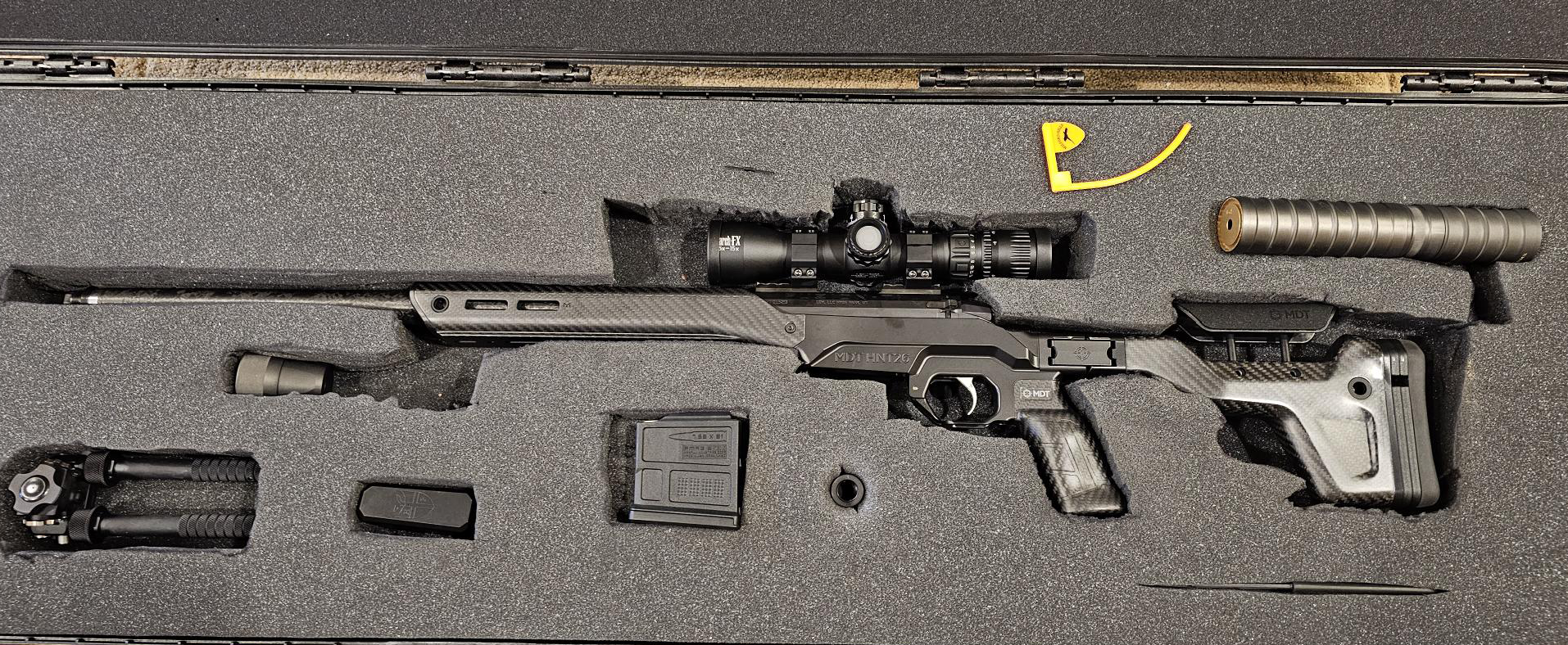

Here are some pictures I was able to get. Hard to do comparison pics with the V8 mounted outside since it's as sunny as it gets outside right now. I tried. :)

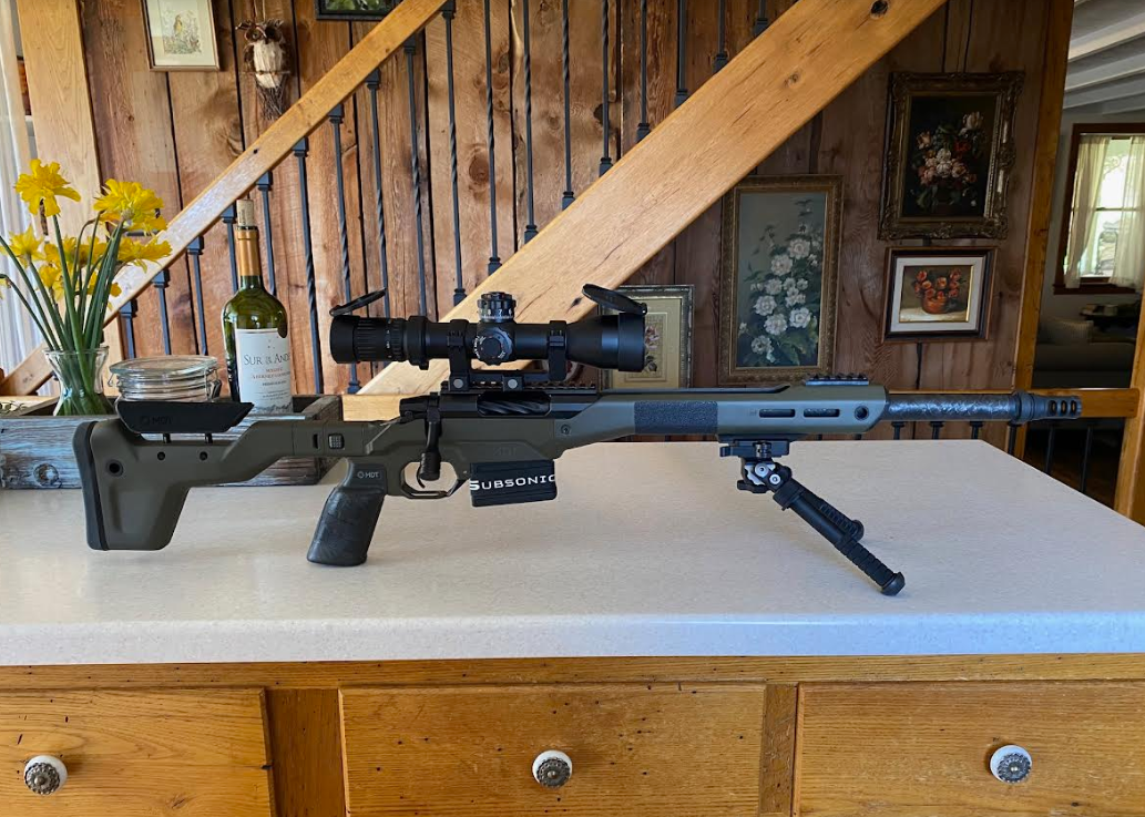

Mounting it up in a Nightforce Ultralight using my John Wick cards. :)
Rig Setup:
Lone Peak Fuzion Ti action
Straight Jacket spun 16.5" Proof .308 1/8 twist with YHM qd comp
MDT HNT 26 folder
Atlas V8 w/ Gray Ops Arca throw lever
Nightforce Ultralight 20 MOA mount
March FX 1.5-15x DFP

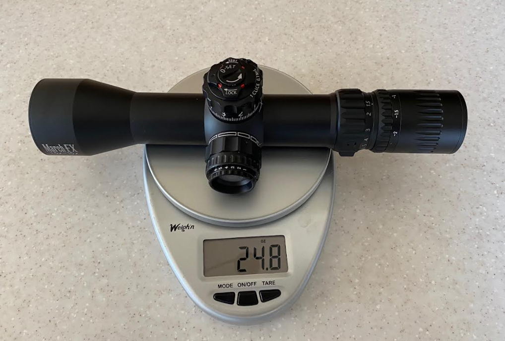

Total weight as seen (mag not loaded) = 8lb 14oz.
Rig Setup:
MDT HNT 26 folder
Looks like they came in nearly an ounce over budget. :)
Is that mount a 1.5 high?
Yeah, I went 1.5" in hopes I could use my PVS30 but I think it's going to be too far forward with the stock and compact scope. Would love if MDT came out with a fully closed forend with mlok on the top for the HNT 26. That piece is removable so they could do it and it wouldn't add much weight at all.

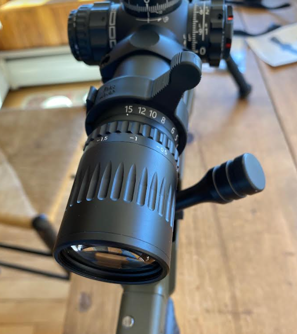

Just a quick note on the fast lever, or throw lever, as you call it. I have been using one on my competition rifle for years. This is the bestest design lever I have seen. Let me explain why.
- It is made of polymer (plastic) whereas others are made of aluminum (aluminium) or other metal. For this purpose, I prefer plastic. This thing sticks out and regardless of how careful I try to be in handling rifles, stuff happens, and I have hit it a few times over the years. It doesn't hurt and it won't scratch anything. It won't gouge out a piece of flesh by mistake.
- It comes apart if you hit it on something, unlike more durable ones that screw into the magnifying knob. Again, for this purpose, I prefer it comes off when hit. The last thing I want is something solid that is firmly attached to my multi-kilobuck riflescope and can screw up the zoom assembly.
As I said before, I have hit it or I have had it hit something. In such cases, the lever comes apart in two pieces and falls off. Just pick up the pieces and put it back on while thanking your stars if did come apart and did not cause any damage to you or the riflescope.
If you lose it, get another one, they are not expensive.
Another neat feature of the fast lever is to be able to look at it and you know the approximate magnification your riflescope is set at. You can do that from position, or, if you're scurrying around in the dark, you can do that by feel if you need to.

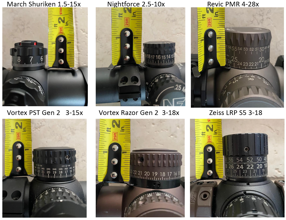

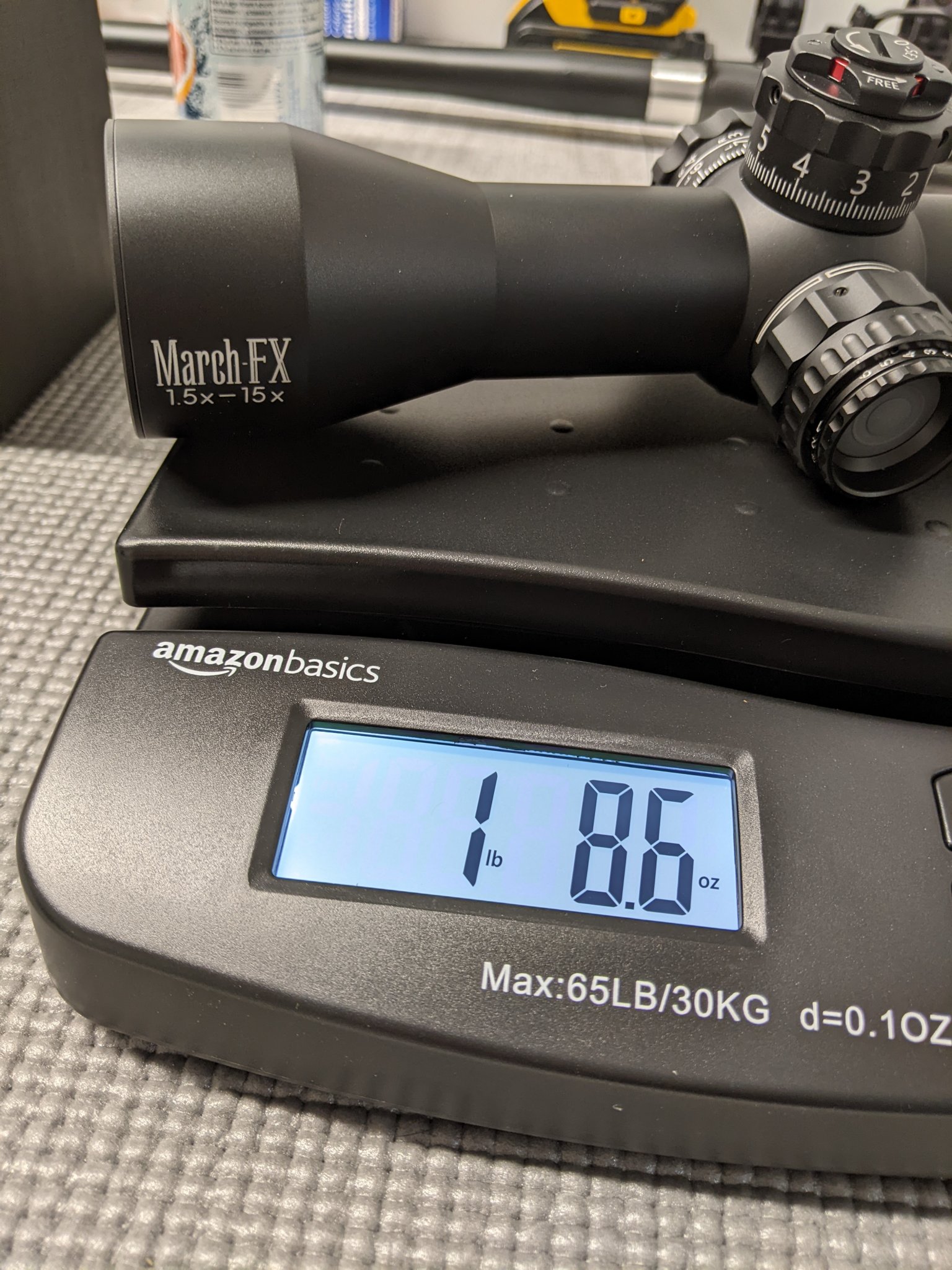

Y’all gon make me buy a 1.5-15x I wasn’t planning on buying! Man those shuriken turrets look tall as fuck though.

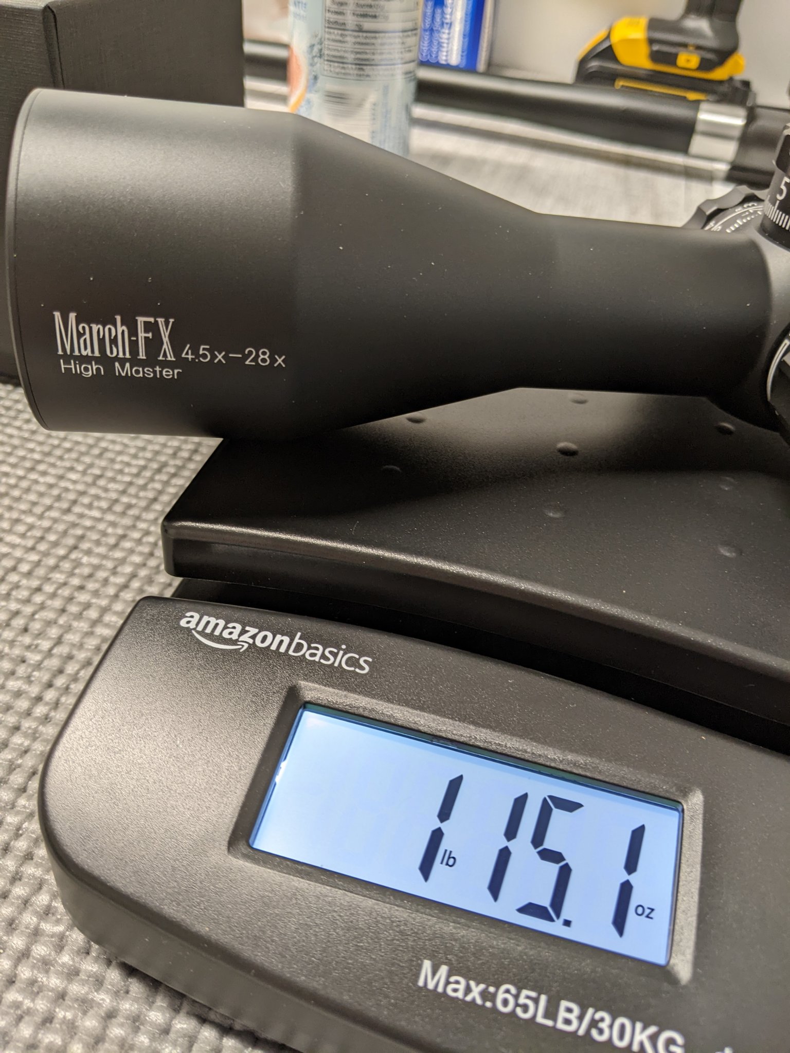

Shame the 4.5-28x52 is over 30oz now.
The turrets don't seem too tall to me. I took some measurements to get a comparison to some scopes I have on hand. Here are the results (note the PST Gen 2 might be a tiny bit taller since I didn't realize the tape measure wasn't all the way to the base of the turret because of the ring).
Low light comparison to my Zeiss V8 last night was very good. Couldn't pick a winner between the two and my V8 is the best low light scope I had. The illumination at the 1 setting didn't have any bleeding. I did notice that when adjusting the illumination dial it is easy to accidentally adjust the parallax.

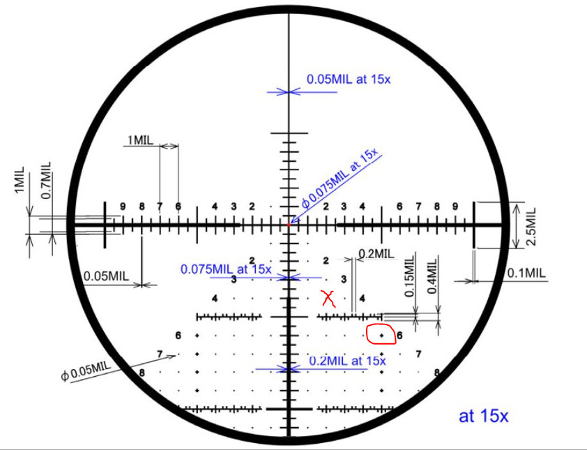

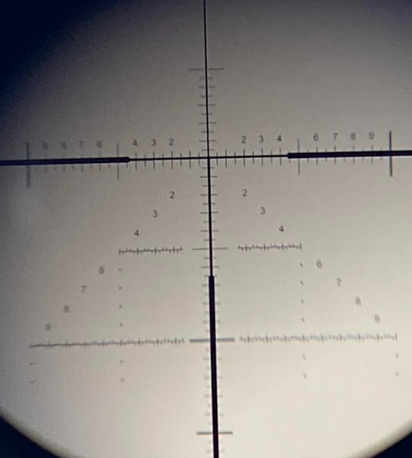

My one gripe so far is the wind hold dots are near impossible for me to see. They're too small even at 15x. No matter how I adjust the diopter and/or parallax I just can't see them unless I have a light background and am really looking for them. I have no idea how anyone can see them on darker background targets. I can see the "+" starting at 6 Mil (circled below) easily enough, but the .05 Mil sized holdover dots are too small for me.
Tried to get a pic through the scope to show you what I'm talking about. This is at 10x pointed at my refrigerator 2.5' away. Best pic I could get.
Yeah, the weight went up by a whole ounce and a bit. From 29.8 to 31.04.
The shuriken knobs do look tall on that scope, because it is so short. We are used to somewhat different proportions, I guess.

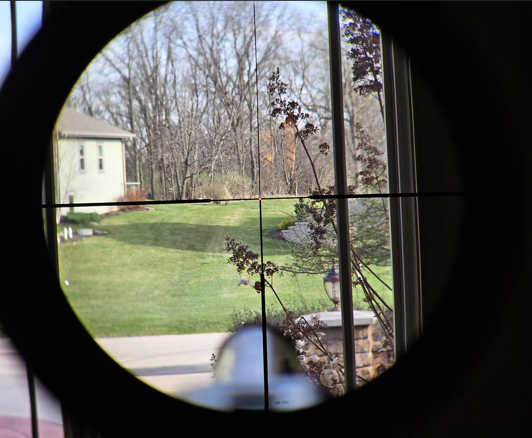

Everything I had been looking at through the scope to this point had been 100ish yards. Looked good. I was just able to go out and look through it at some steel targets at 300 and scope a ridge at 700 and I'm not overly excited about the image quality. Appears to be anything over 8x at the longer ranges looks blurry no matter what I do to try to correct it. Pretty obvious edge distortion too. Took my Zeiss V8 out and at 14x compared it to the March at 15x. Zeiss won hands down. Guess there are some compromises for how compact and lightweight this is and at the ranges I'll use this for most it's really good, just not happy with the image resolution at longer ranges. Bummer.
@Qwack you seeing anything similar to what I'm seeing through your 1.5-15x with the FFP reticle?
Reactions: Glassaholic
Same for me. Disappointing.
I had little time to play with it, but yes I did found the reticle blurry at high magnification if I set the diopter at low mag. I assume it's a compromise thing.
That said, my eyes are pretty good for adjusting, even if I'm 45. My way of adjusting the diopter is by turning it in the "+" range. There, my eye cannot adapt. I then turn the ocular clockwise until I get a crisp view of the reticle.
What I found so far with the 1.5-15 is that I need to do it at higher magnification. If I set the diopter at 12x for exemple, I can back the power down and still have a crisp reticle, my eye adjusting instantly to it.
I found the same thing happens with the 4.5-28, but to a much lesser extent.
Hope it helps
