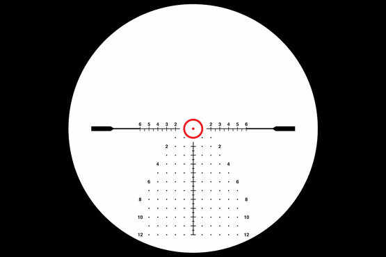

View attachment 8016571I honestly feel like Vortex just nailed it with the Gen III EBR-9 MRAD reticle. It's a good example of when less is more. Some of March's reticles look like early 90's action movies trying to portray a liberal Hollywood's idea of what a high tech super snipery reticle should look like. The TR1h reticle has that a little bit too. The center 1 MRAD area is just a little unnecessarily wazoo. I'd learn to live with it. But I'd never love it.
The EBR reticle design is getting close to max efficiency IMO on low mag range options while still maintaining practical utility. The similar SR5 reticle in the 1-10 Vudu is what finally pulled me from the K18i.

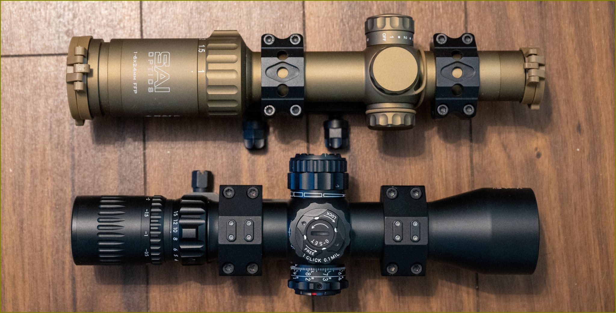

Yes, technically the March is 2.5oz heavier. But it’s also a 1-15. To me that extra 5x is a big deal.
I just wanted to point out that comparing the Vortex 1-10X24 to the March-FX 1.5-15X42 is a little bit wonky. The Vortex has a 24mm objective whereas the March has a 42mm objective. And weighs only 2.5 oz more. The exit pupil at 15X is 2.8mm, and at 10X it is 4.2mm compared to 2.4mm for the Vortex.
Correct, those are much better numbers for the March.

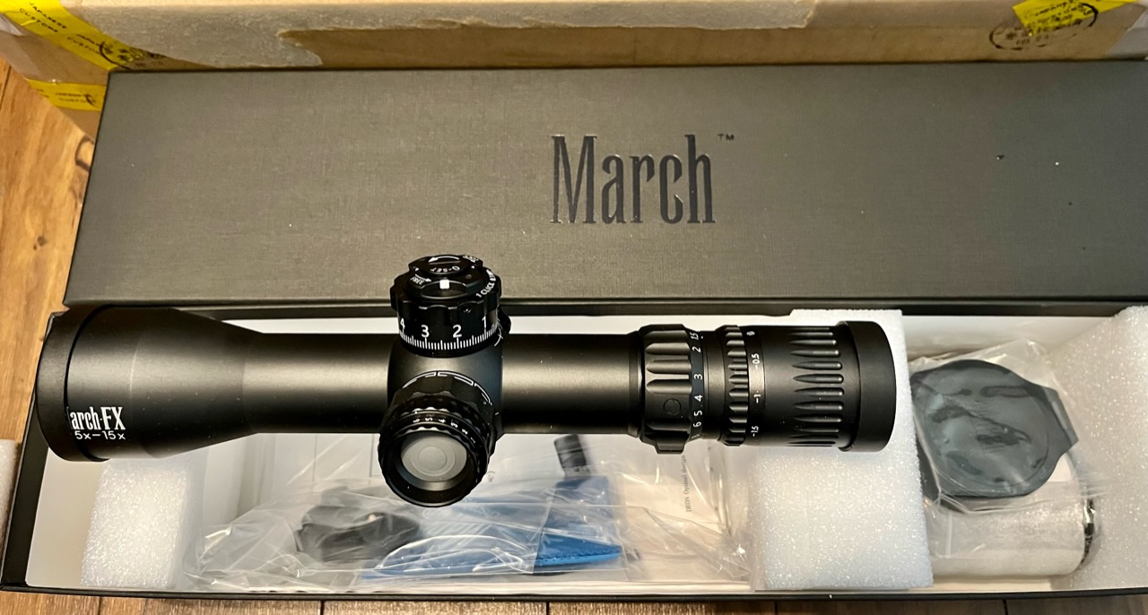

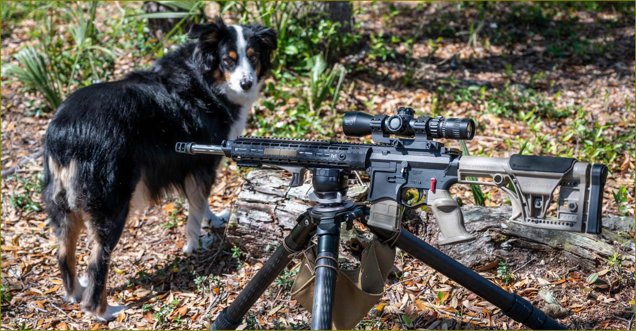

Too late to join this one, right Mountic? Anyways, here is a picture of the SFP March 1.5-15x42, it's a capped mils version with the FD-2 reticle. I've only put a few hundred rounds through it, but I like it so far. If anyone is in South Texas you're welcome to take a look at it
