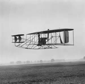

The Wright brothers succeeded at powered flight. They were somewhat self taught engineers. But it took real engineers to take this
And turn it into this
Backyard mechanics that know how to rebuild a Chevy small block can't get it done
It definitely makes sense if you like living in a technologically advanced society.
