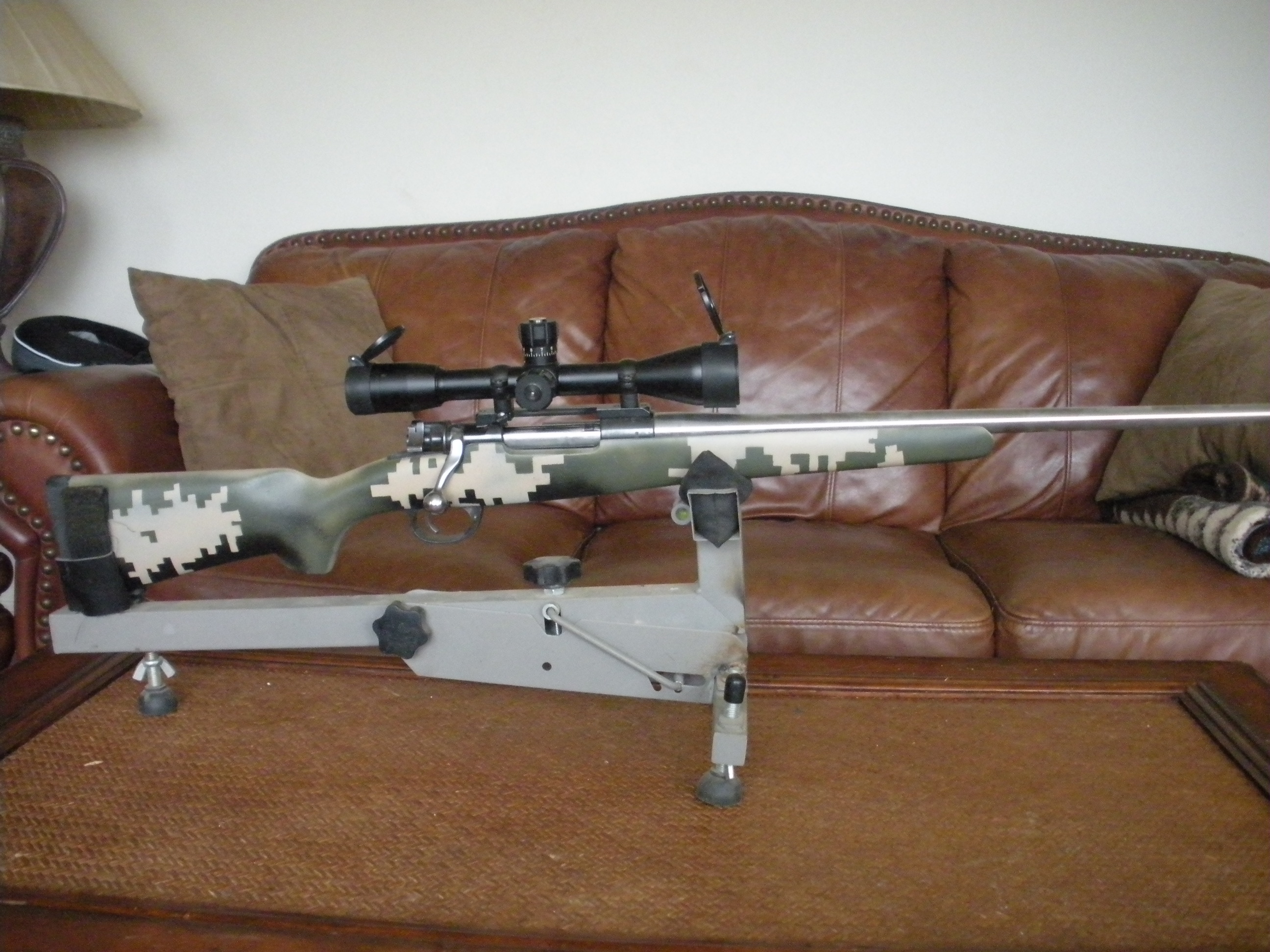

I have a friend that started a mausar project about 30 years ago and never finished it. Anyway he asked me if I wanted it since I was messing around with rifles. I took it and done some internet searches to see what I had. Turned out to be a VZ24. He had had the action trued, a new safety installed, a timney trigger. Bolt handle was redone and was drilled an taped for a scope base he had (leupold). As far as he got was just the action and he had picked up a couple of stocks hear and there. Well I didn't want to put a lot on money into the project so I ordered a Adams & Bennett barrel (short chambered in a 260, 1/9 twist and 24"). I had a smith chamber it in a 260 improved 30 degree (I had the reamer and dies). Put it all together and it turned out to be a shooter Under a moa out to 500. I really pleased with the way it turned out. I'm going to give it back to him. 212.JPG
